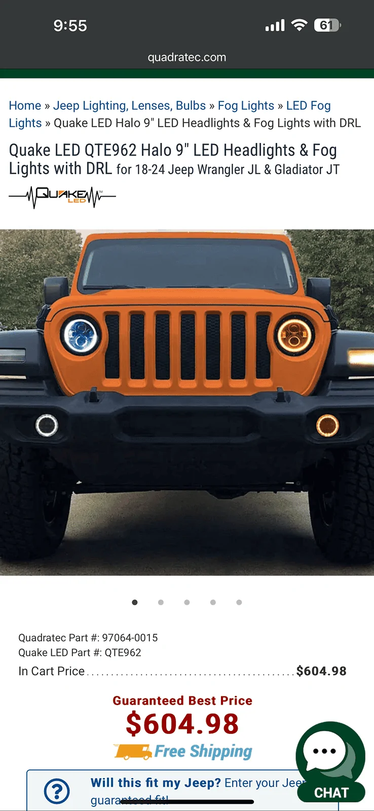

(Quake LED QTE962 Halo 9" LED Headlights & Fog Lights with DRL) & (Morimoto XB LED Fender Lights; Smoked) installed. Everything is working properly and looks great but the halo DRLs are white. Is there a way to make them stay amber like they are when the blinker is on?
Jeep Gladiator How do I get my halos to stay amber? IMG_4257

Couldn’t you just remove the lead for the white wire and put the amber lead from the headlight there? Might be oversimplified but might be worth a shot

While not the same headlight, as I have the Diode Dynamics ones, when I installed mine the halo was white as a DRL and when the headlights were on. Amber when the turn signal was on. Then I got a JSCAN module and thought I better change the settings to LED headlights as mine didn't come with them from the factory. Then I noticed my DRL were now orange. Still orange turn signal, and still white when the headlights are on. Didn't think that would happen.
