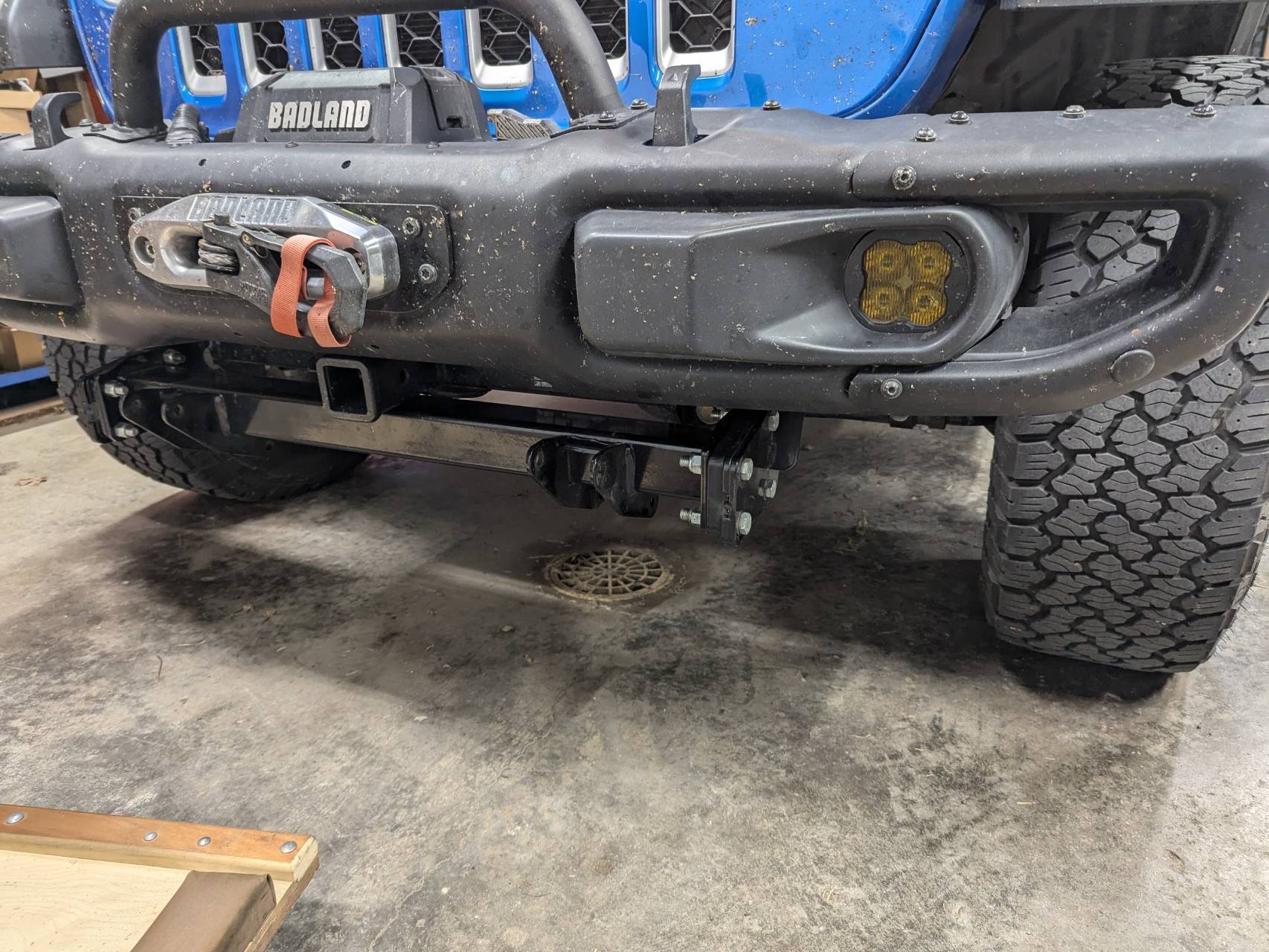

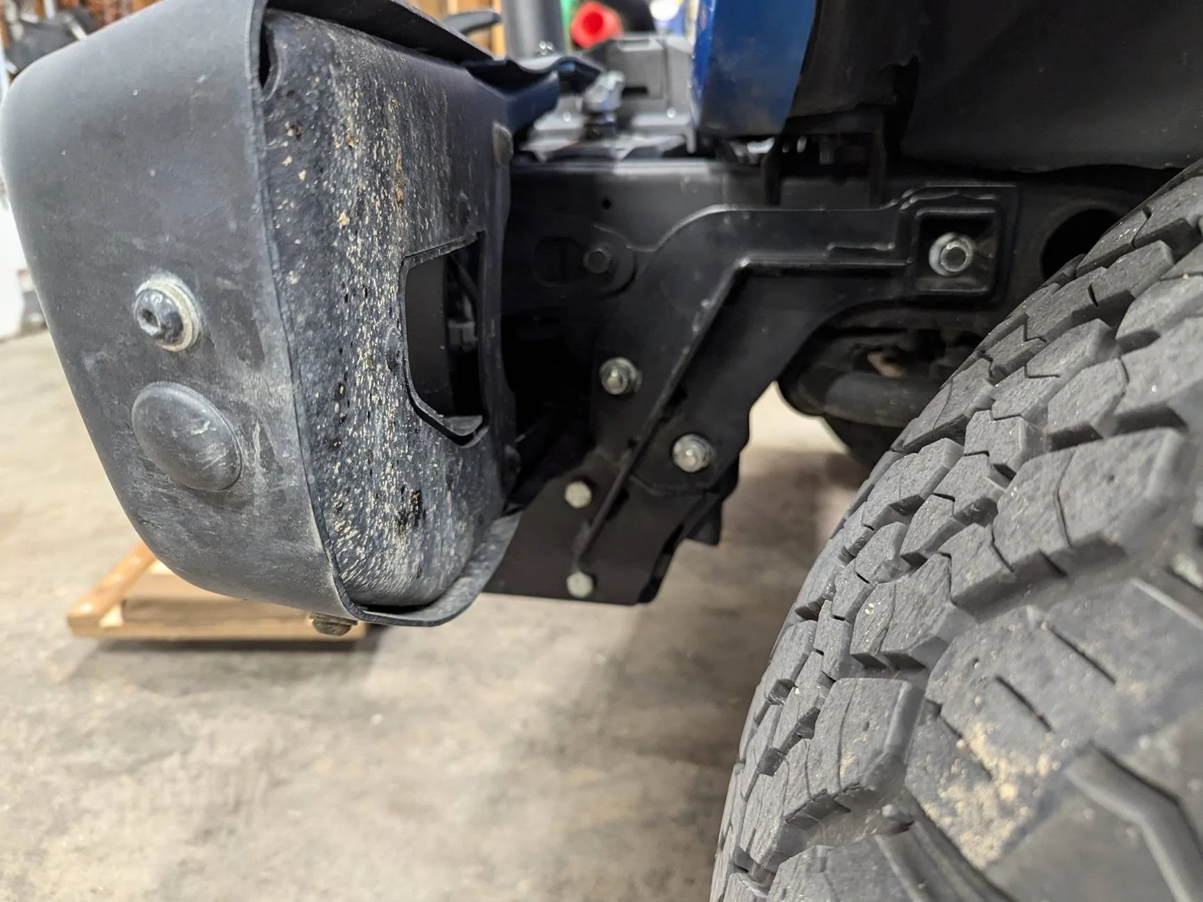

Tell me I don't have more than 100 pounds here - and that's not even counting the power steps which are about 70 pounds per side - part of that weight is on the front springs (I know - I saw a little drop up front after putting them on)
I have a winch that weighs probably 75 pounds (some say 70, some say closer to 80, I think shipping weight is 76-80 pounds), the Bulldog winch plate - not light, the steel bumper (subtract the miniscule amount of weight of the plastic bumper I can hold over my head with one hand), the front Curt receiver, and so on.........I'm way over 100 pounds.
BUT - I did put dual-rate springs under it. They are supposed to give 2" lift,
I got about 0.75-1".

He's got a Mojave - I'd not swap springs on that one. I'd go with spacers.
Otherwise, he's mixing different springs with those shocks. It's a different animal.
One reason if I traded my Overland for another I'd go Mojave is the ride. Even with a snow plow, I'd find some way to deal with keeping the stock springs on a Mojave.
Okay, difference of opinion. But for my purposes, spacers suck.
40,476
53,953
You nailed it right there.
They are the answer for some people and some purposes, not for others.
Rubicon - I'd do spring changes.
I've run spacers - and I've swapped springs. Each was a case of why I was doing it and what my purpose was - how the truck was going to be used, etc.
So really - in effect, we agree.
