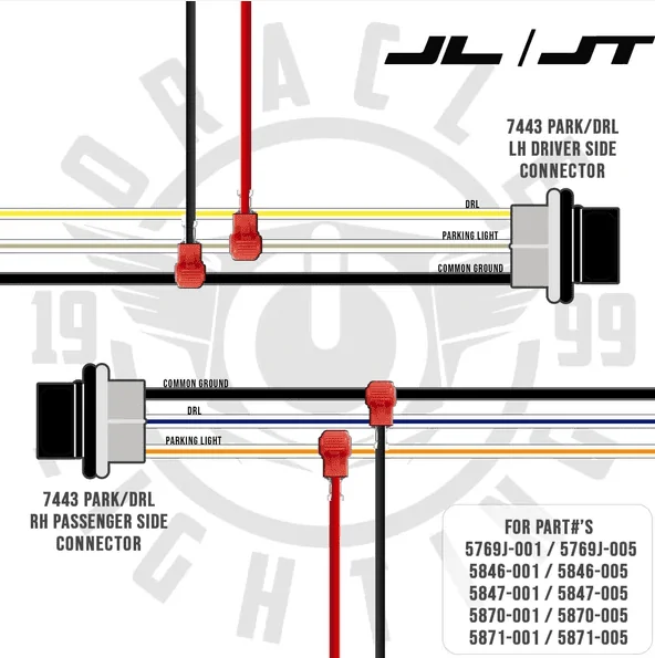

How do you install these to the daytime driving lights?
DRL wire cannot be used as a power source - Tapping into Park Lights will give manual control over LED accessory during daytime driving - LED accessory will turn on automatically in night mode when switch is set to AUTO - For full automatic control over the LED accessory use fuse F52 in the engine compartment fuse panel. You can view the wiring guide below:

I previously had the prerunner’s installed with Halogen DRL/Signal. I’ve swapped that out for a Morimoto LED DRL/Turn Signal. What wire do I tap into with the red prerunner power wire?
Appreciate any ideas!
The replacement DRL/Turn Signal does not replace the factory wiring so the info above still applies ?
