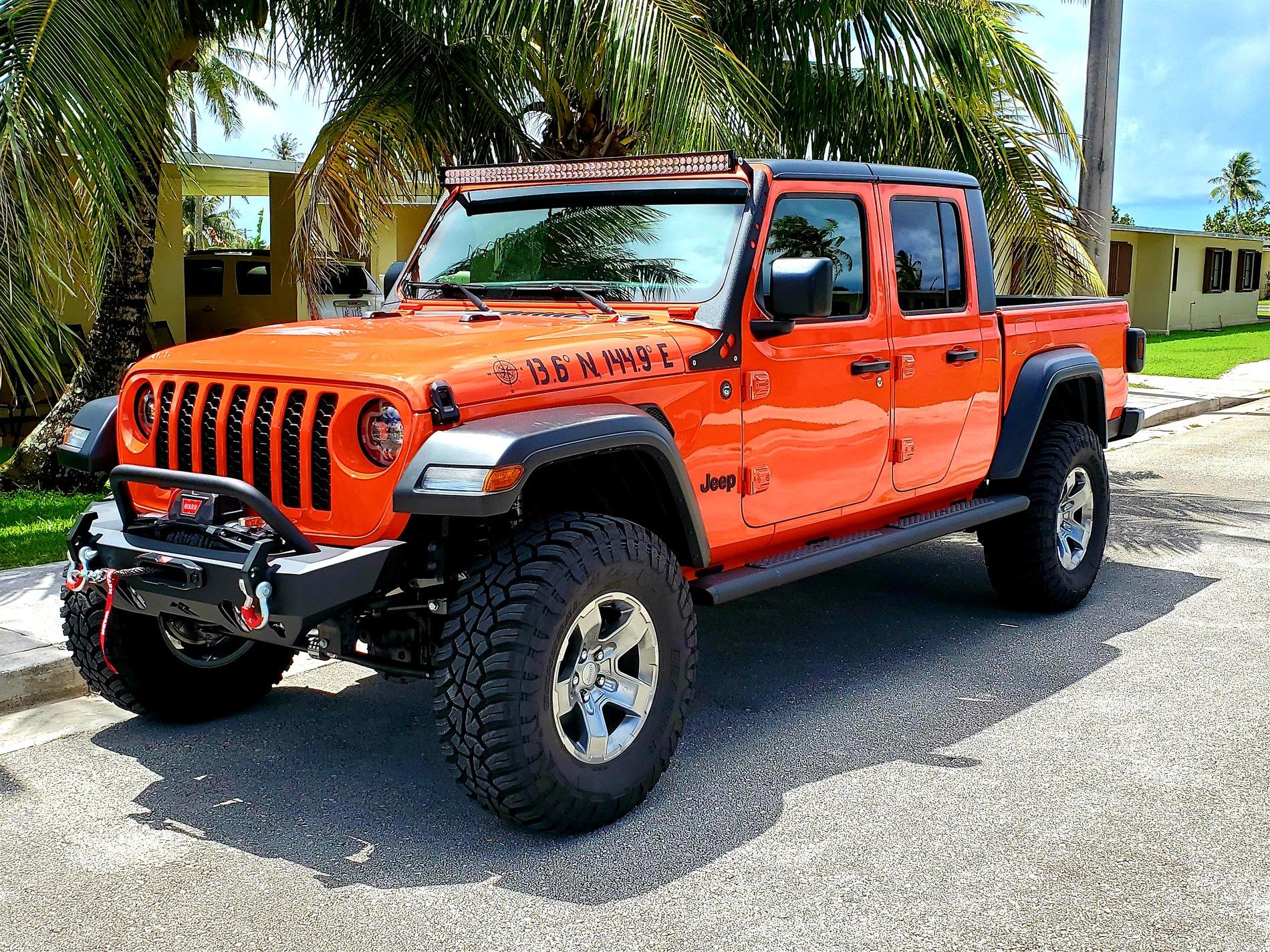

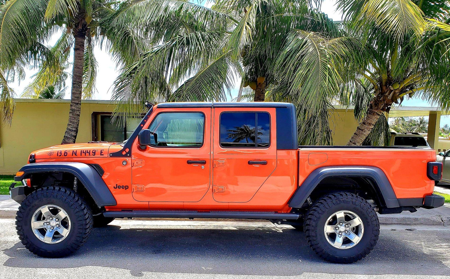

After with 3/4" spacer and mopar lift.
Jeep Gladiator Installing a proper Level Kit 3/4" vs 1 1/2" with the Mopar Lift Kit Daystar How to tips and tricks 20200613_200640
Jeep Gladiator Installing a proper Level Kit 3/4" vs 1 1/2" with the Mopar Lift Kit Daystar How to tips and tricks 20200613_212952

What’s the measurement between your tires and the fenders? Lift looks good

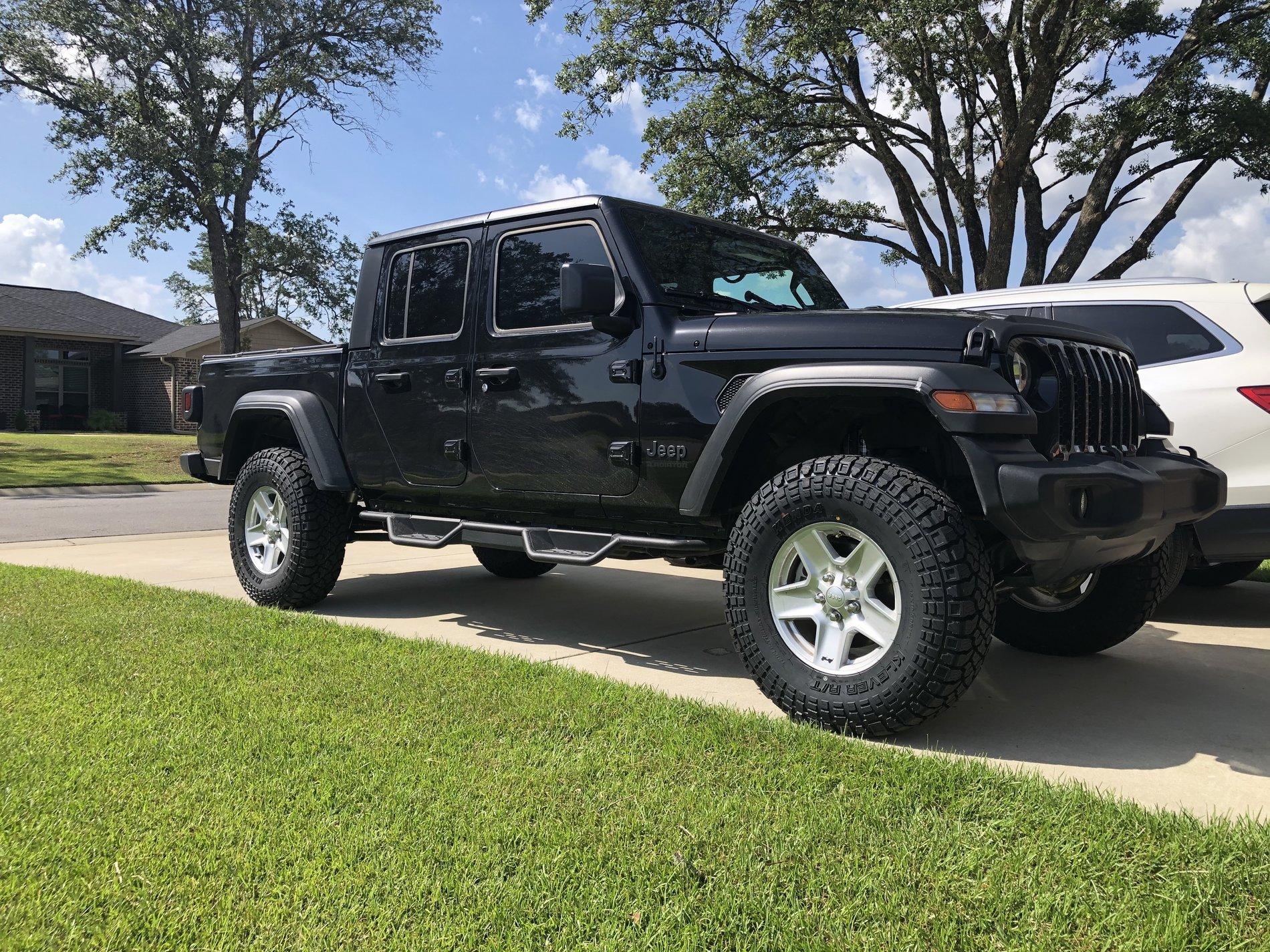

Mopar 2", 3/4 spacer, and 35s measured 21.5" to the front of the metal seam under the body and 22" at the rear. Just installed the other day so it will probably settle a little. If I add a steel bumper and winch I'll probably up it to a 1.5" spacer to keep it relatively level.

Hmmm this topic is what I was pondering for my build and your video has me second guessing my plan to go with the 1.5" daystar on top of the Mopar. I too was counting on winch weight/bumper/winch plate weight along with removing the rake and so the ~1.5" seemed right.....
https://www.jeepgladiatorforum.com/forum/threads/usethis83-gobi-rubicon-project.31205/#post-522603
Thx for watching the video. If you go by measurement its 1.5 to level, but then it looks funny. If you go by looks, the 3/4" looks perfect but measured 1/2 inch low in the front. Depends on your version of level.
Had used the 1.5 spacer, you can see the thing measured 2.1 inches in height. Way too much. They call it 1.5 but is over 2.
3/4 inch looks perfect. Even with all the bumper and winch weight. It only changed it a 1/16 of an inch.
I appreciate the time and care you put in the video. Thank you for sharing. I just ordered the 3/4 JL spacers to have on hand. For flatter angles and better geometry, I prefer less lift everywhere possible. So if the 1.5 (2ish) is not necessary than I prefer to err on the low side. Thanks.
