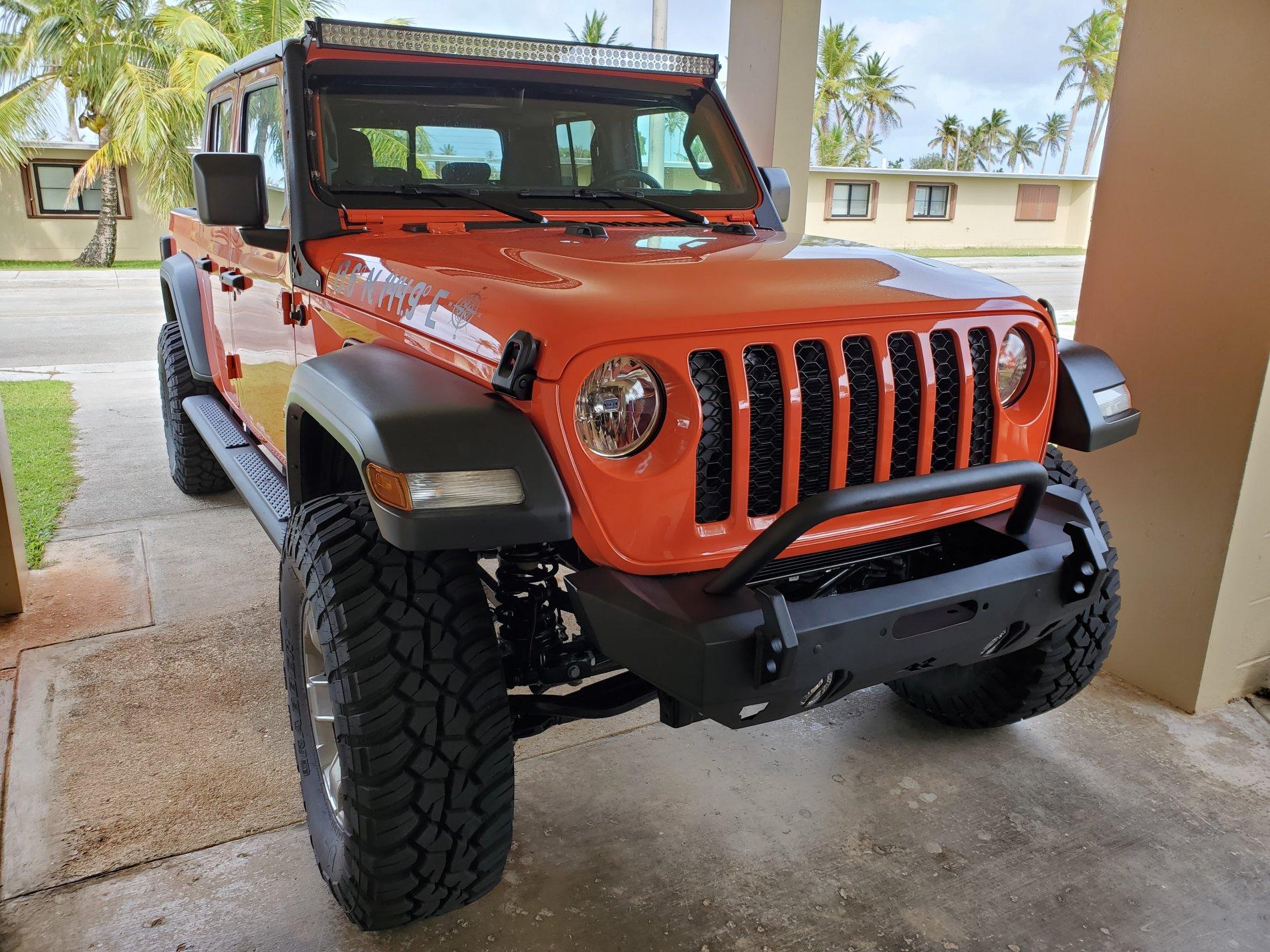

Awesome job on this build! I've got a Sport S on order and have been contemplating doing 35s and the 2" Mopar lift but wanted to see it on another first so I'm glad I stumbled across this build.
Two questions for you...
Did the 2" lift level out the truck so there is no rake?
Why did you add the 3/4" Front HD Spring Pads to the lift? Do you have any pics of how the truck looks now with that?

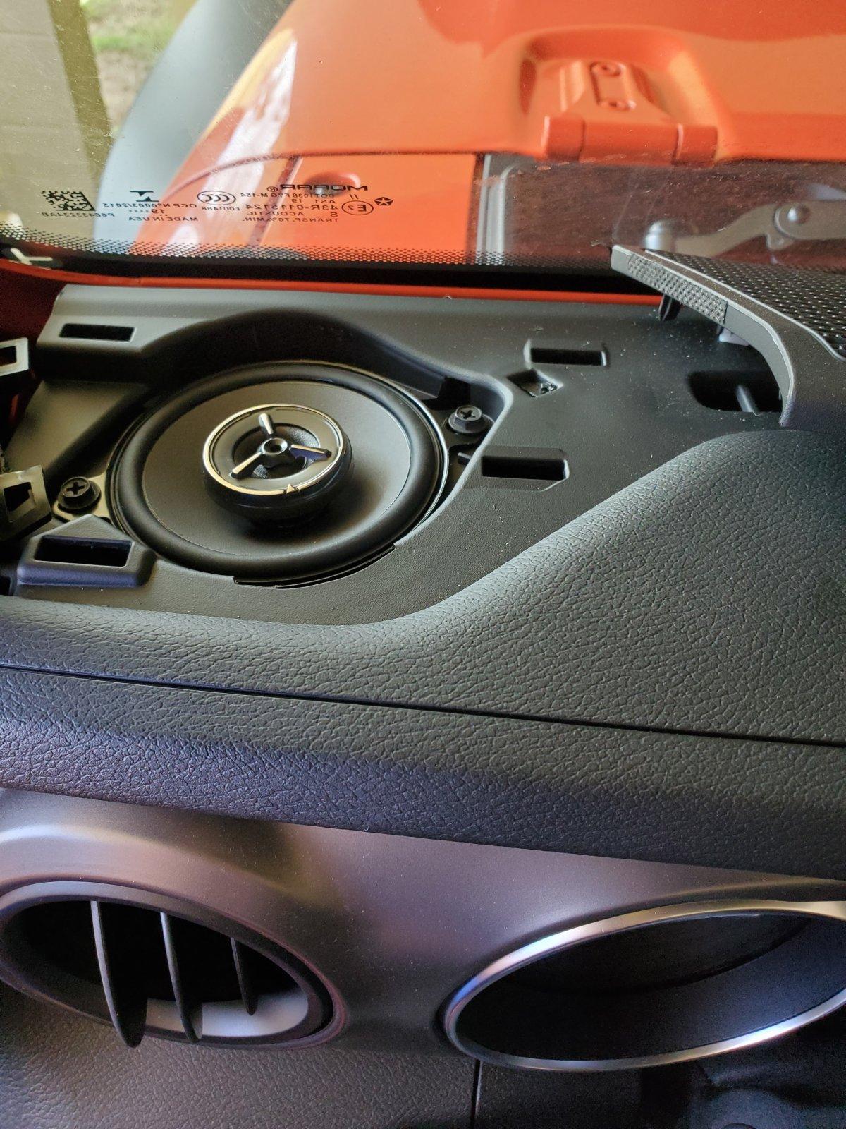

Installed Kenwood Speakers in the dash.
Jeep Gladiator SPORTICON a Sport S built for the Rubicon trail 20200414_125847

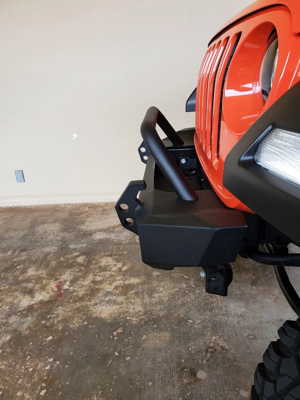

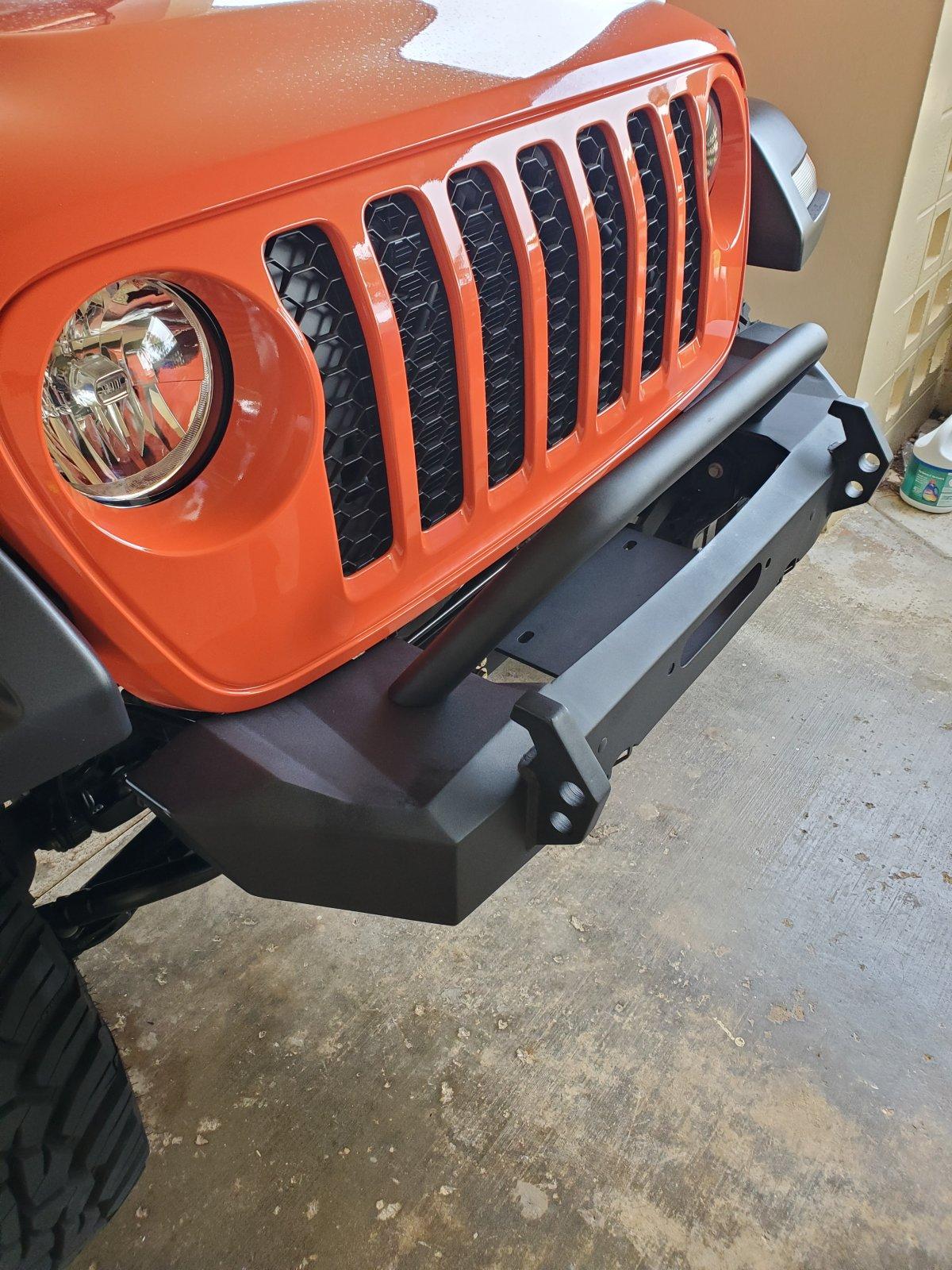

How much was shipping to Guam for the bumper?
Sorry, I just saw this. 100 for the bumper, 50 for the overrider bar. Total was 650.

Do you have the Alpine radio upgrade?
I've read that it's a major PITA to install speakers if you don't have the upgraded stereo.
Can you give a quick overview on how you installed your subs and dash speakers?
Thank you!
Sure can.

Sure can.
Thanks man!
Do you have the Alpine radio upgrade or the basic 7" radio?
I don't have the Alpine and have heard that it's a PITA to add a sub unless you want to spend a ton of $$

Thanks man!
7 inch non alpine
