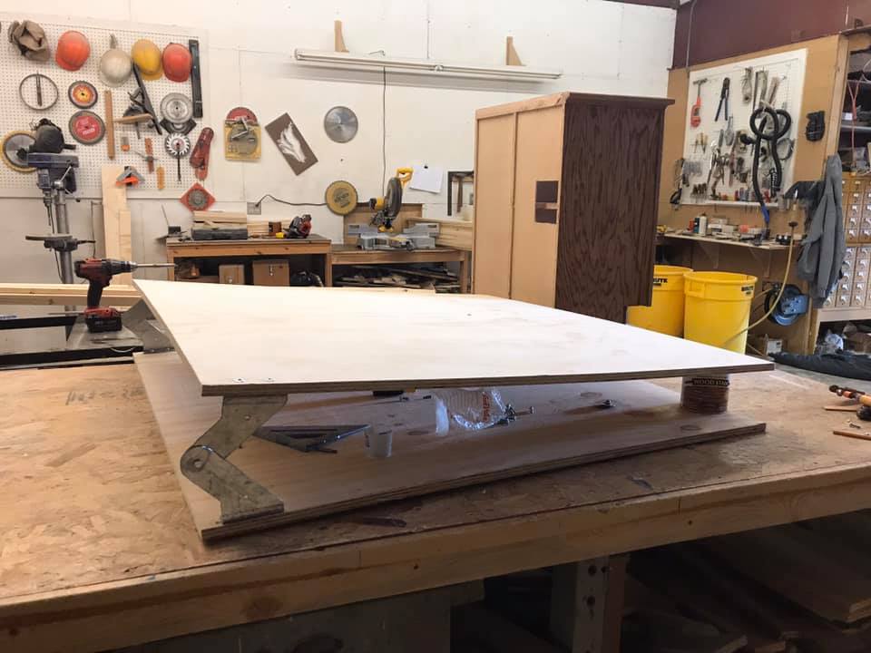

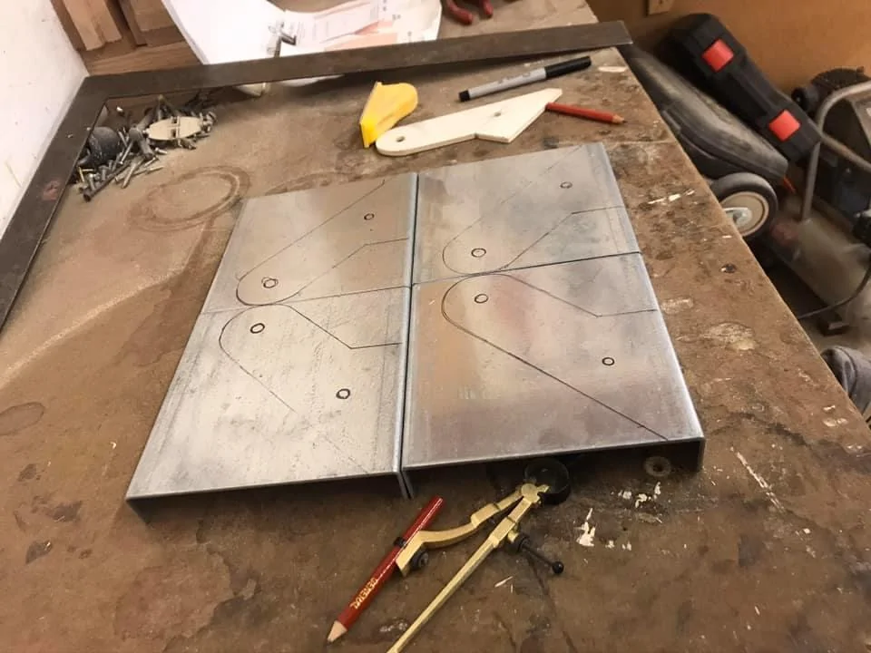

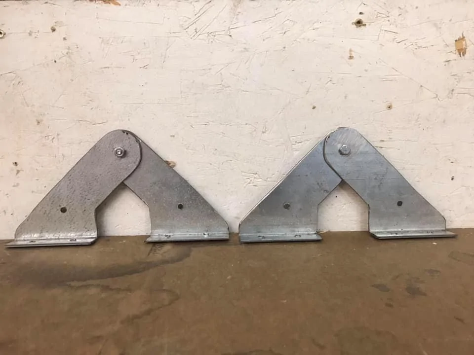

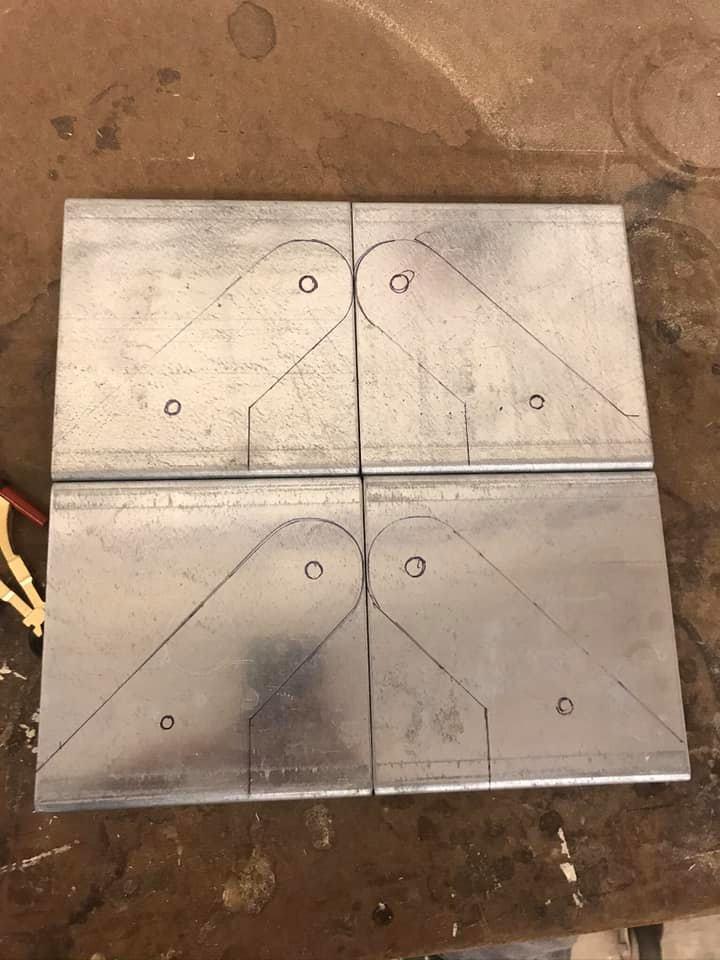

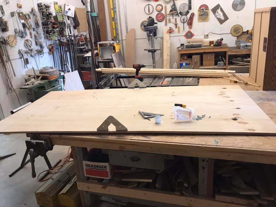

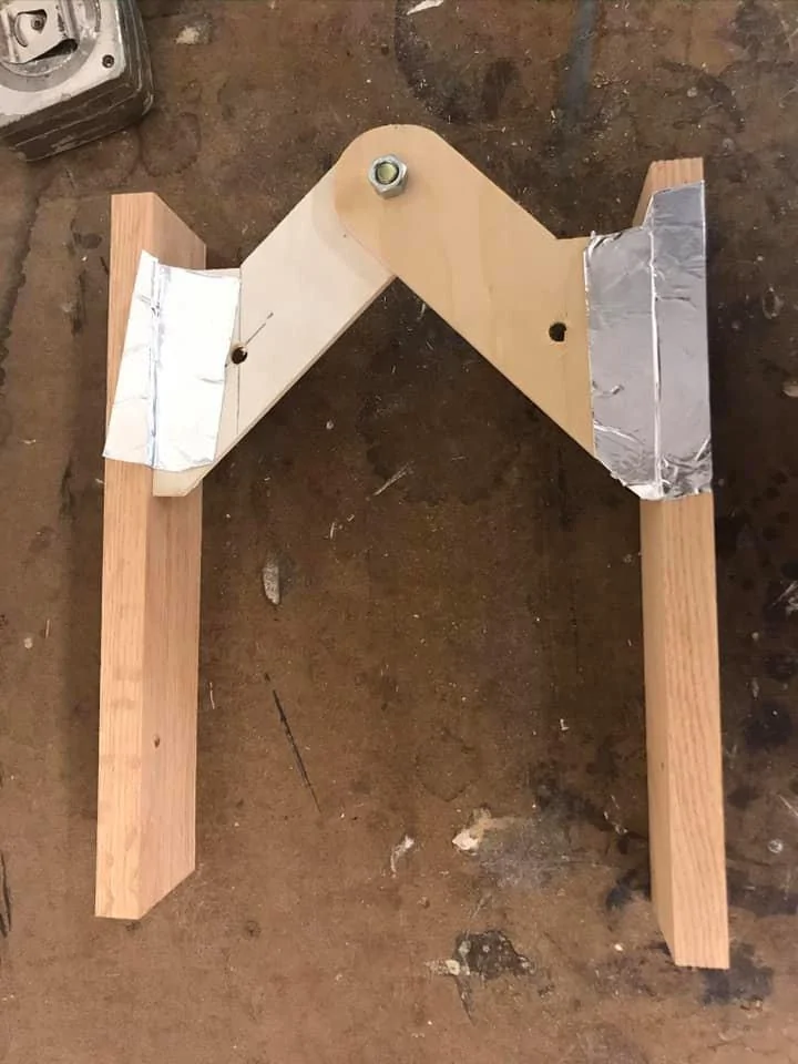

Progress on the Jeep has slowed down some, still have a small list of things i'd like to get done to her yet this winter/spring.
But, what I've been able to focus a little bit of time on is the RTT i'm building from scratch.
I looked online at different hinge options, and eventually decided i could just make a set from scratch. First things first, i built a set of hinges out of 1/4" plywood to verify they would work, after a couple of versions i finally found one that did. So I went to my steel stash and found 4 base plates from 6"x6" post bases.
Then grabbed a sheet of 3/4" AC X Super plywood, an exterior rated cabinet grade plywood to build the base.
I'll be bending the conduit to make the bows on the tent Next week, then comes the time to start cannibalizing my tent to build the cover.
