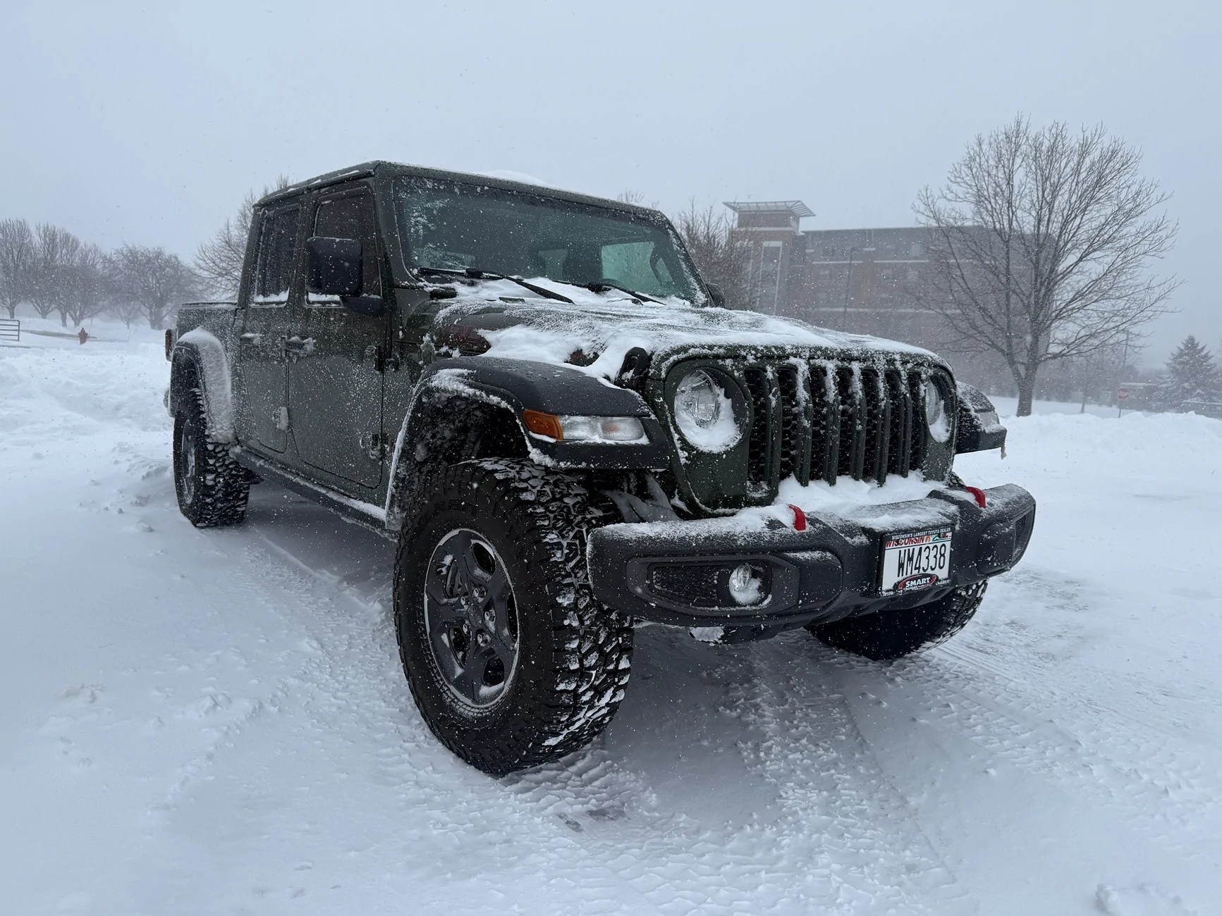

Within a week, we got a surprise snowfall and I was able to take it for a rip still bone stock and knew the Falken Wildpeaks would be my choice when going larger on wheels.

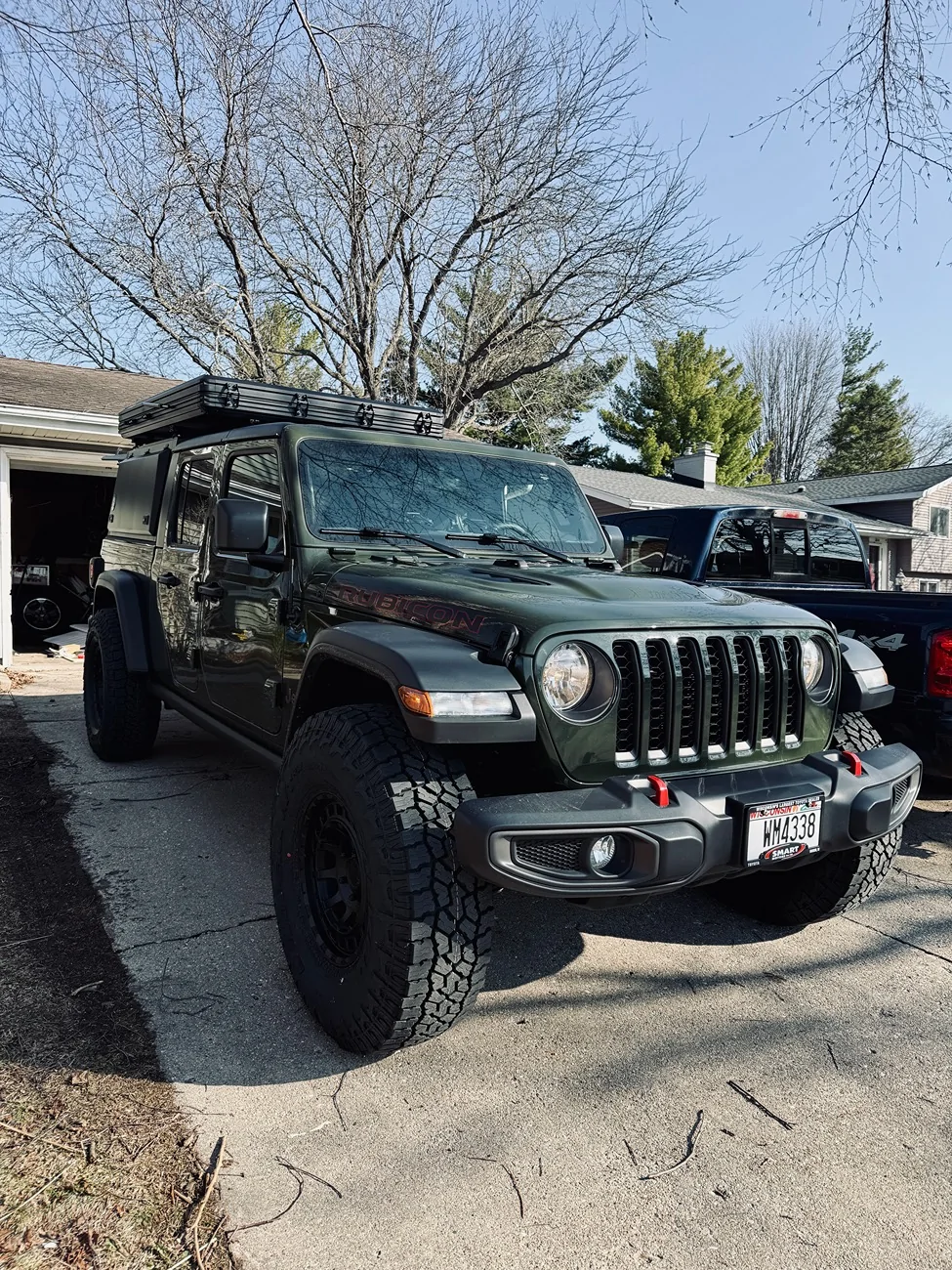

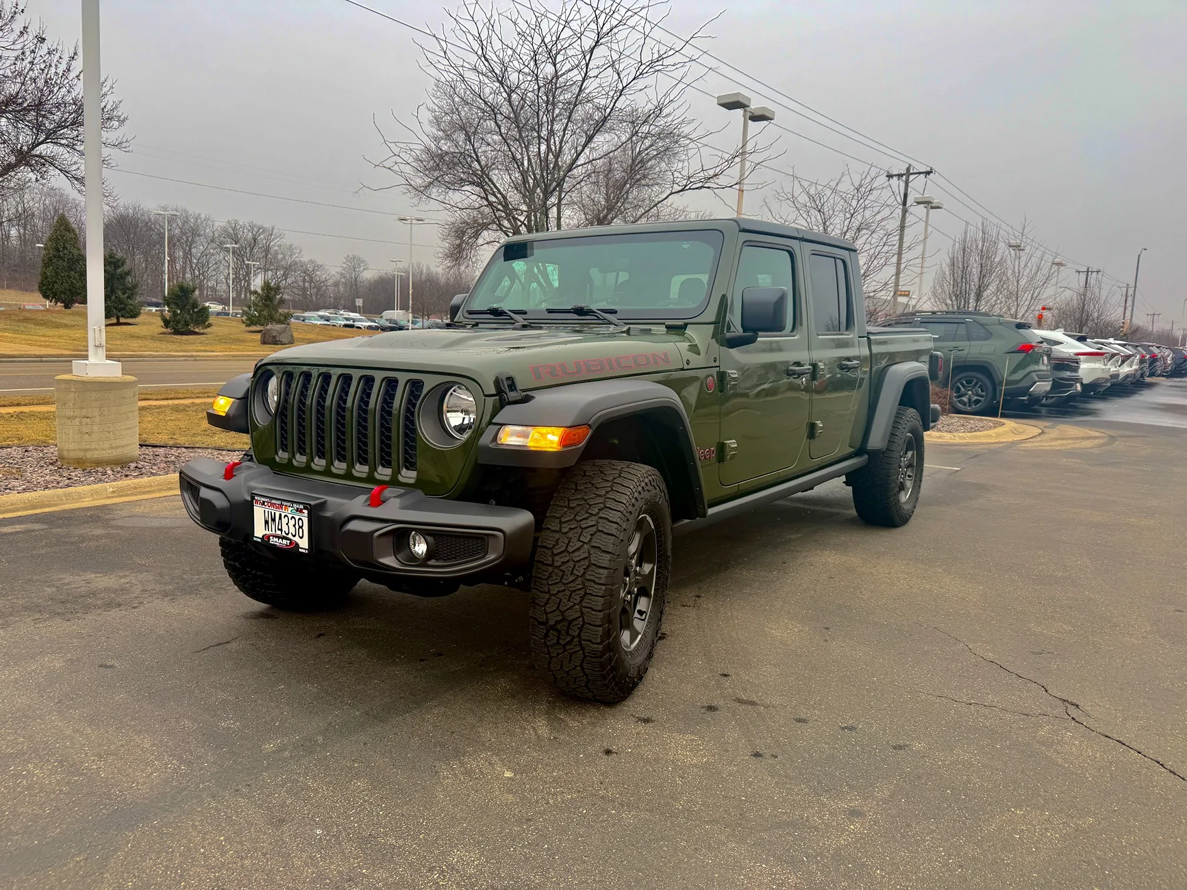

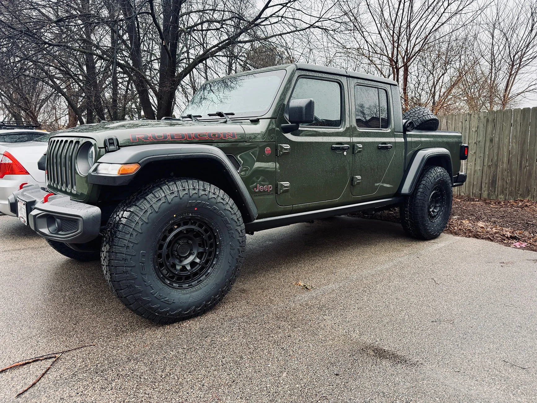

Today, we upgraded to Black Rhino Chamber wheels in 17x8.5 0mm offset with Falken Wildpeak AT4W 37/12.5/17 tires mounted. Will be adding the AEV 2” spacer lift and geo correction brackets next week to give it a little more space. No rubbing so far and I love the look. Can’t wait for the increase in lift. Will run this until I hate it or the shocks give out. May add an HD spring to handle the OVS cap and RTT sitting in the garage.

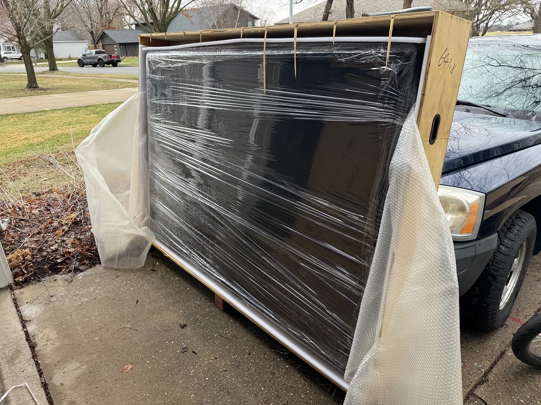

Today was a big day for Clover.

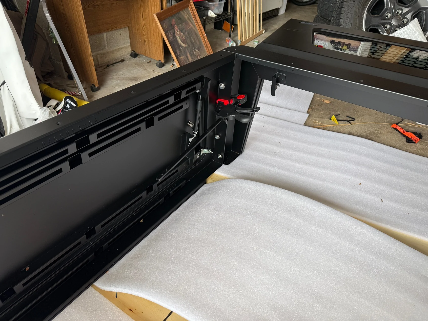

What started as a rainy morning opened up just a little to allow for some garage and driveway building of the OVS Expedition Cap and Topoak Galaxy Pro rooftop tent.
Jeep Gladiator Clover - Rubicon Built for Weekend Adventures and Daily Driver IMG_8554

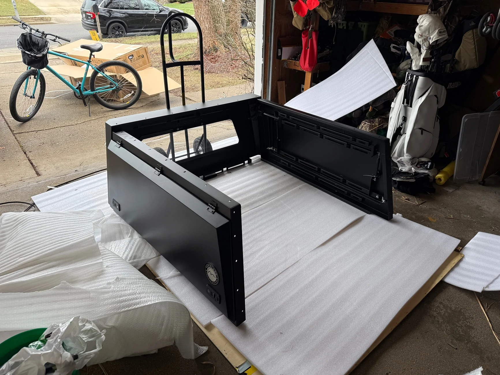

Borrow one of the boards from the tent shipping box to make a floor to work on to save my knees and back a bit. Worked well.
Jeep Gladiator Clover - Rubicon Built for Weekend Adventures and Daily Driver IMG_8559
Jeep Gladiator Clover - Rubicon Built for Weekend Adventures and Daily Driver IMG_8557

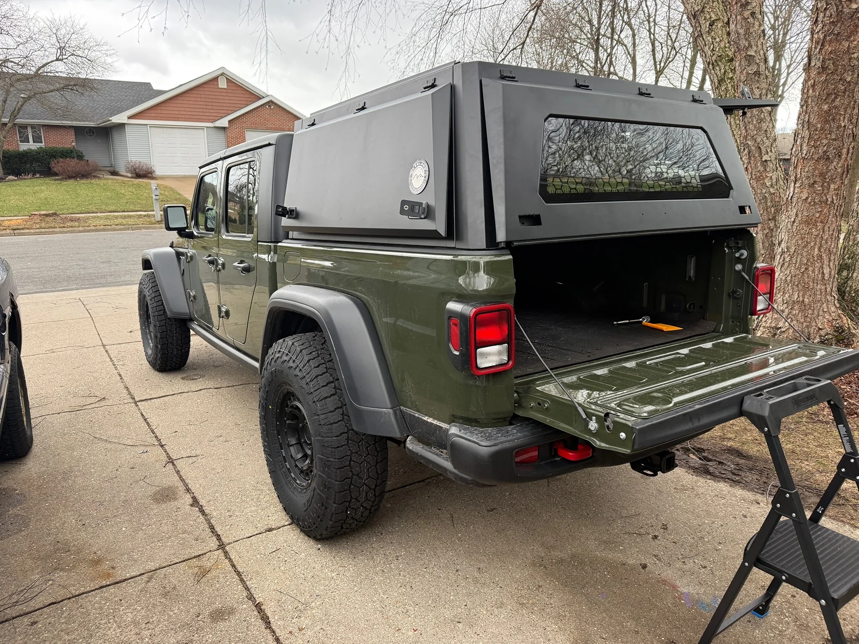

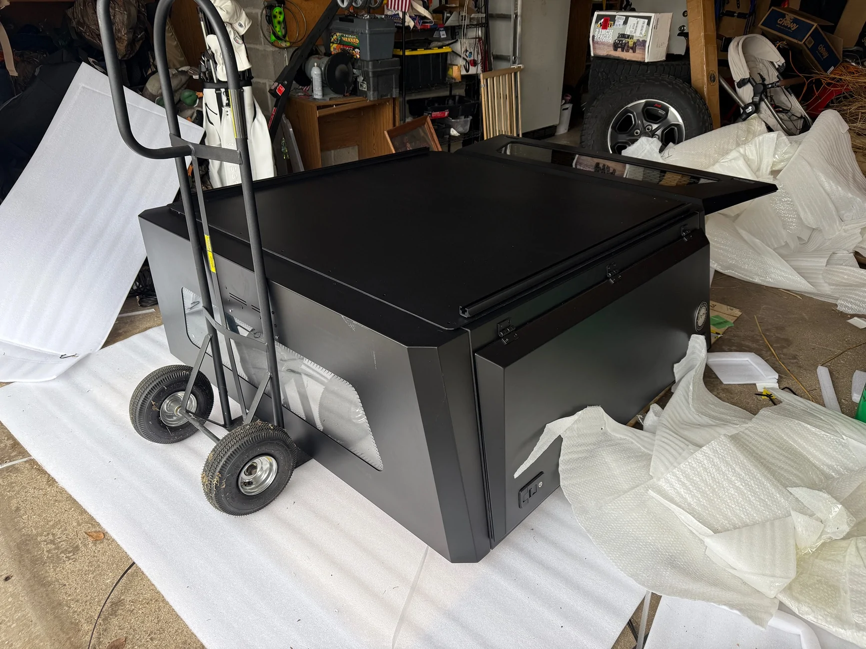

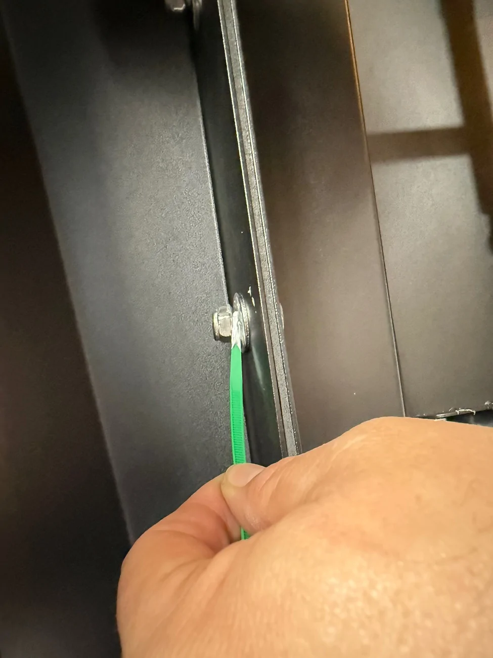

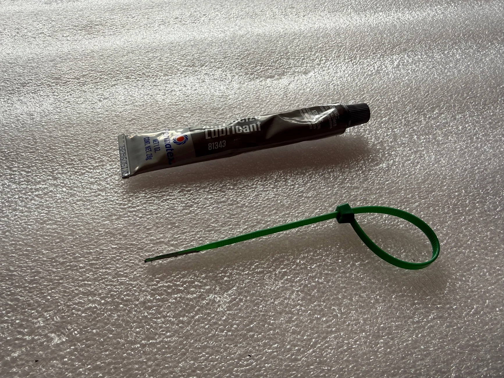

Used clamps to hold it together while I was building to make it easier to line holes up. The hardware is stainless, so had to use anti-seize lubricant and I also used a zip-tie to apply it to the threads as I went along. I only needed help screwing down the alan key bolts on the roof and my wife saved the day.
Jeep Gladiator Clover - Rubicon Built for Weekend Adventures and Daily Driver IMG_8561
Jeep Gladiator Clover - Rubicon Built for Weekend Adventures and Daily Driver IMG_8564
Jeep Gladiator Clover - Rubicon Built for Weekend Adventures and Daily Driver IMG_8563
The kids got curious as to why I was in the garage so long and we got a nice photo memory of the build.
Jeep Gladiator Clover - Rubicon Built for Weekend Adventures and Daily Driver IMG_8653
I needed my wife to help with the roof alan bolts and got some neighbors to help me load it onto the bed.
Jeep Gladiator Clover - Rubicon Built for Weekend Adventures and Daily Driver IMG_8565
Jeep Gladiator Clover - Rubicon Built for Weekend Adventures and Daily Driver IMG_8569

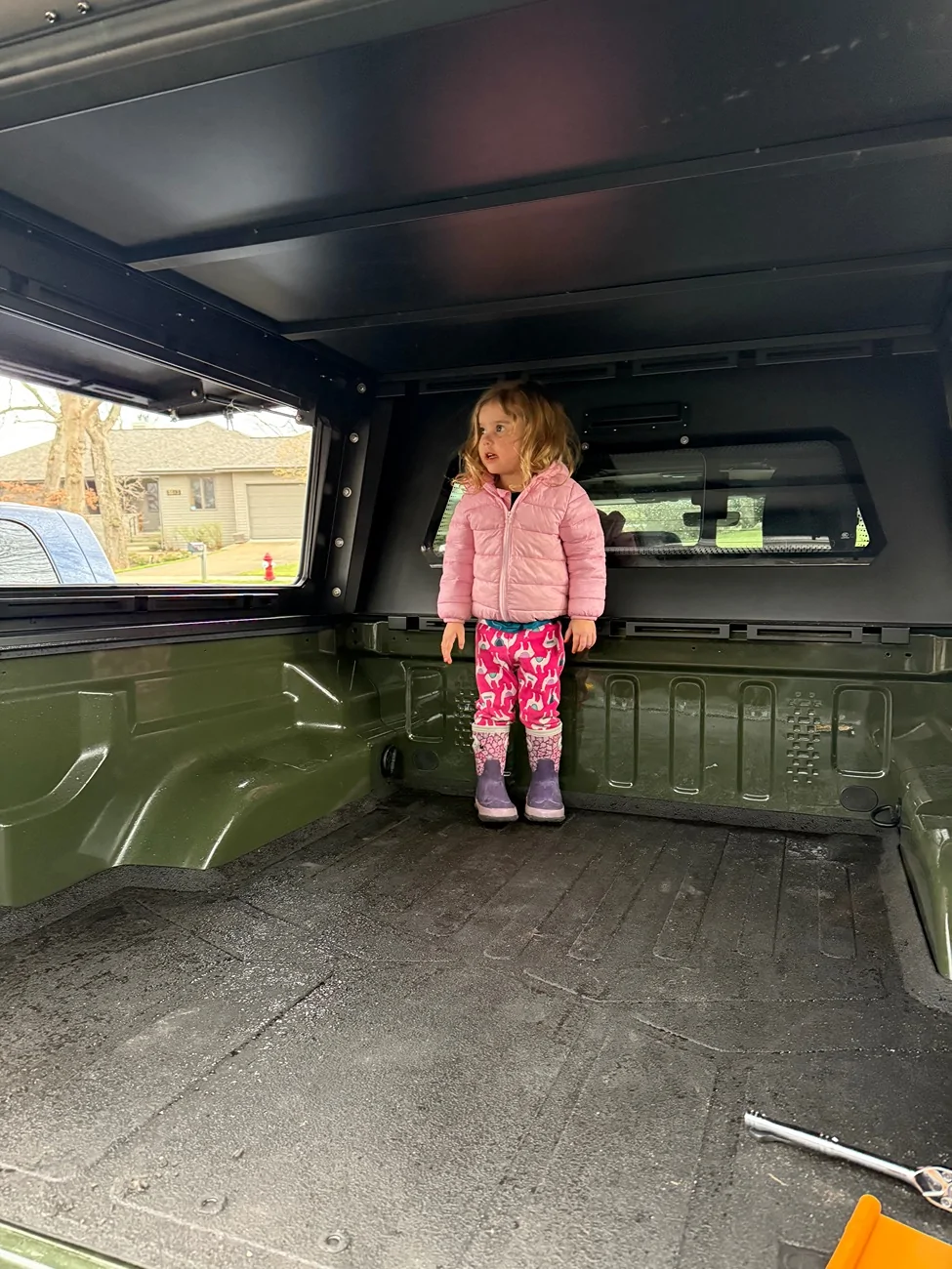

My younger daughter called it, “my house.” She’s gonna love it.
Jeep Gladiator Clover - Rubicon Built for Weekend Adventures and Daily Driver IMG_8658

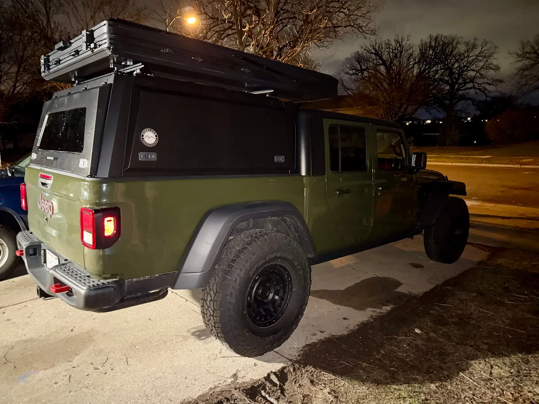

I got the roof rails mounted and called over my neighbors again to mount the tent.
Jeep Gladiator Clover - Rubicon Built for Weekend Adventures and Daily Driver IMG_8575

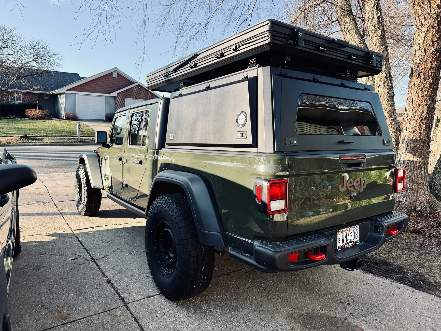

The days project took longer than expected, but I am very pleased with the result so far. Looking forward to taking new photos in the morning under full light to see how we did.
Jeep Gladiator Clover - Rubicon Built for Weekend Adventures and Daily Driver IMG_8586
Perfect!
Jeep Gladiator Clover - Rubicon Built for Weekend Adventures and Daily Driver IMG_8587
AEV 2” Spacer Lift goes on this upcoming week. I also have an overhead molle rack to get installed.

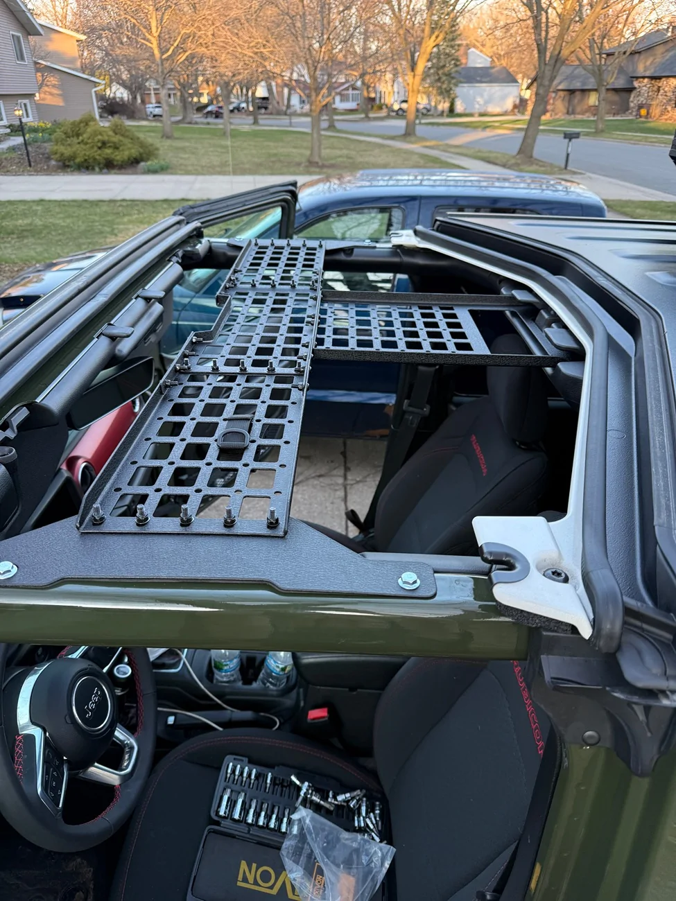

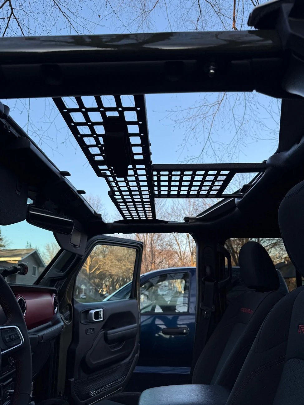

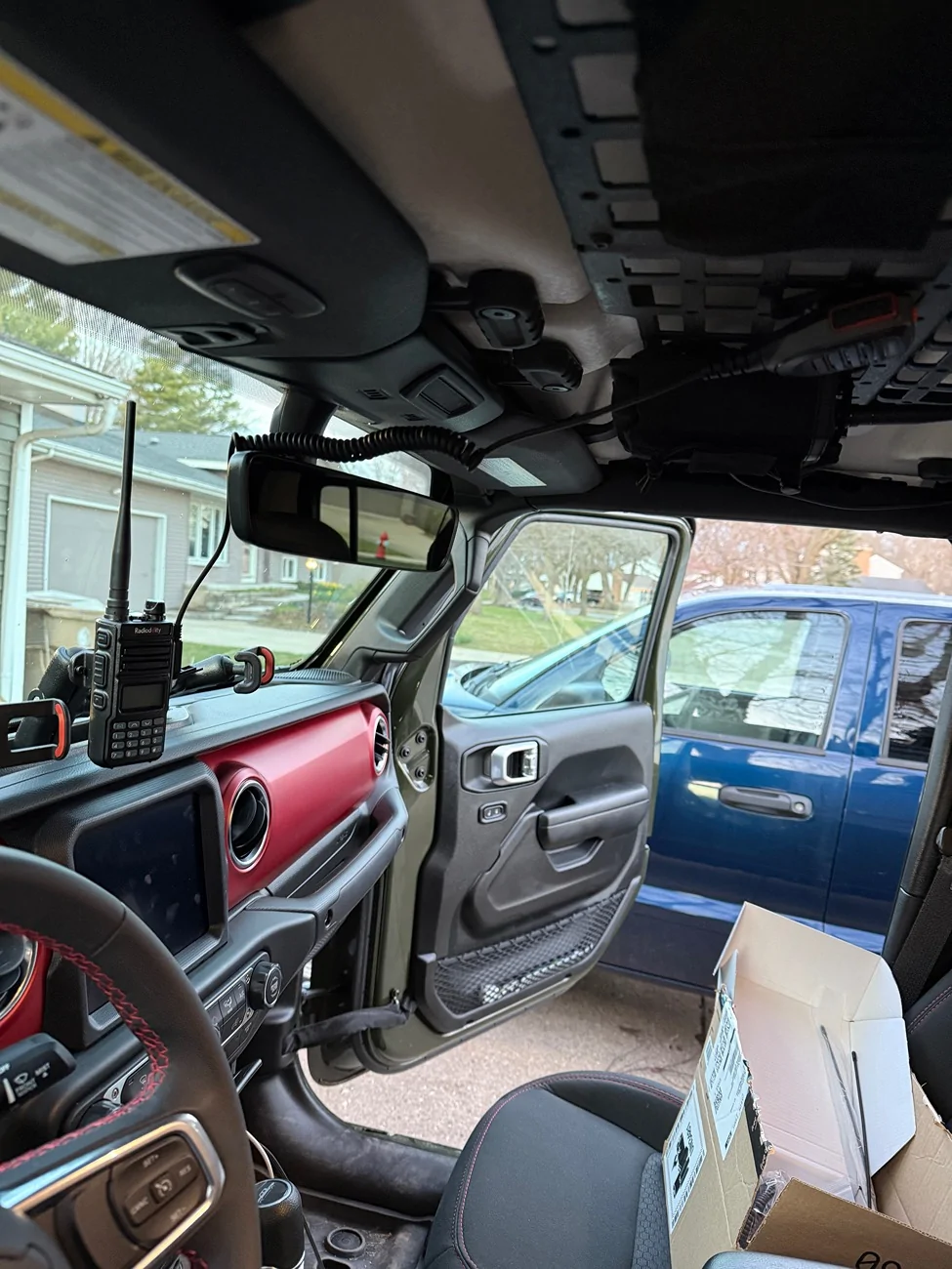

Next, I installed the Amazon overhead molle rack to support the Starlink Mini, handheld radio, flashlight, and whatever else I decide to store with that system. Pretty straight forward install and good videos on YouTube for reference.
Jeep Gladiator Clover - Rubicon Built for Weekend Adventures and Daily Driver IMG_8591
Jeep Gladiator Clover - Rubicon Built for Weekend Adventures and Daily Driver IMG_8592
Bolts on the outside come with the kit and the Jeep has holes there already. The 4 bolts that hold on brackets for the covers come out and then back in the hold that piece. Finger tightened the most outside panel until bolted into the Jeep and then tightened those down as my final effort.
Jeep Gladiator Clover - Rubicon Built for Weekend Adventures and Daily Driver IMG_8594

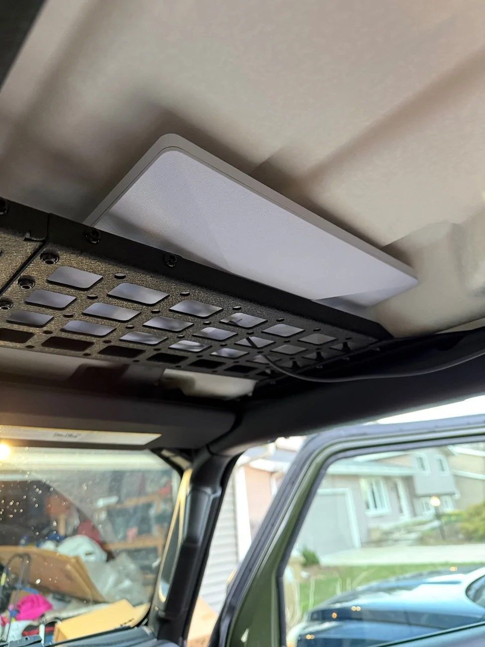

Starlink Mini just sitting on the rack. I’ll think up something to hold it in more, but I haven’t even heard it rattle yet. Maybe look through the boxes all this stuff came in and see if there is a foam wedge or something I could zip tie in place to secure it better for piece of mind.
Jeep Gladiator Clover - Rubicon Built for Weekend Adventures and Daily Driver IMG_8595
Went with two Radioddity handheld GMRS radios (got license) and am hoping they serve my use case for when in a convoy or needing a ground guide. One radio mounted off the dash and the other sitting in a molle holder on the rack.
I like it so far. Seems solid and I don’t notice it when driving. Love the modularity it adds to the cabin.

Can you post a link to that Molle setup for future reference please? And how close is it to your head when in the cab?

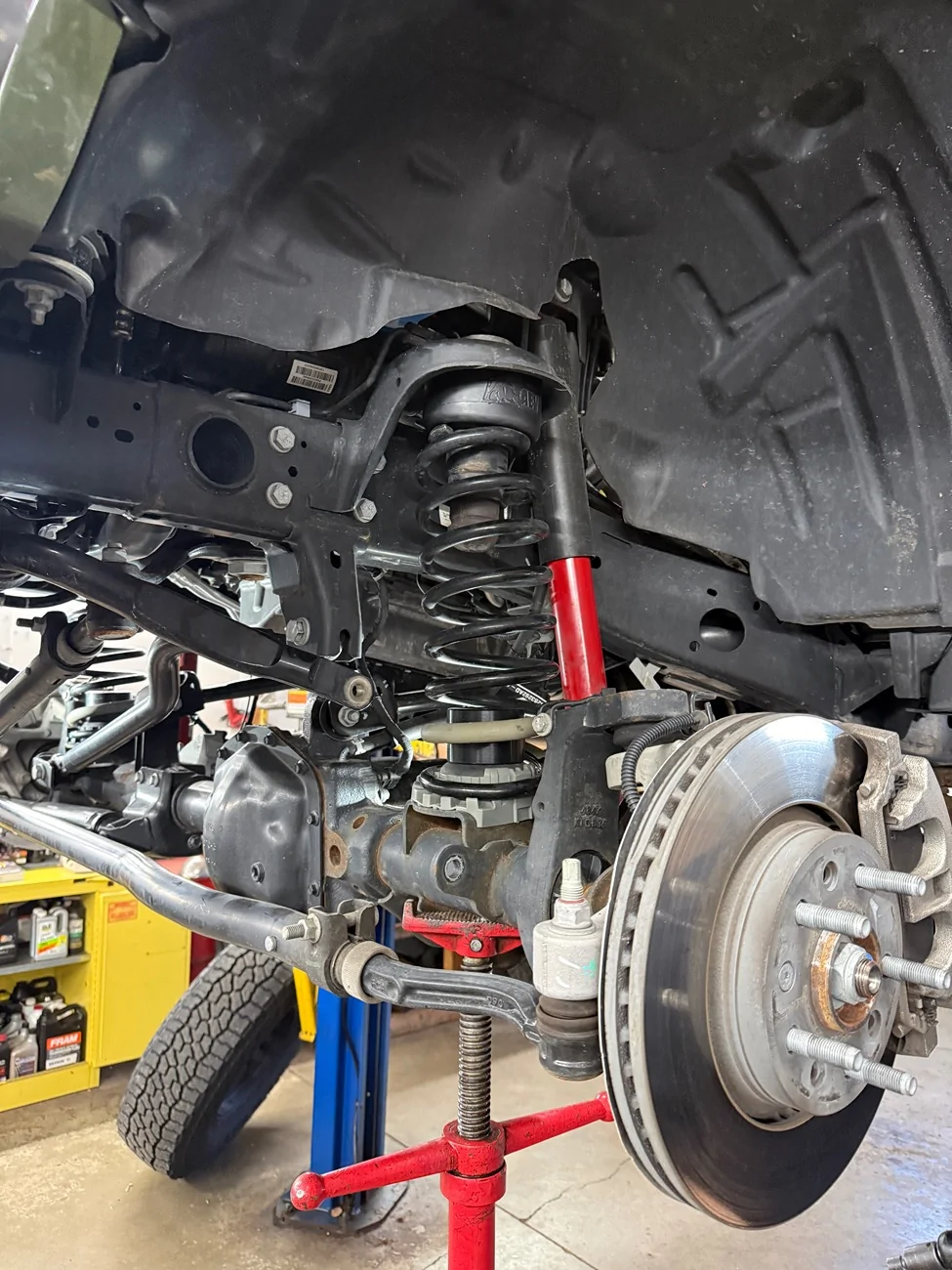

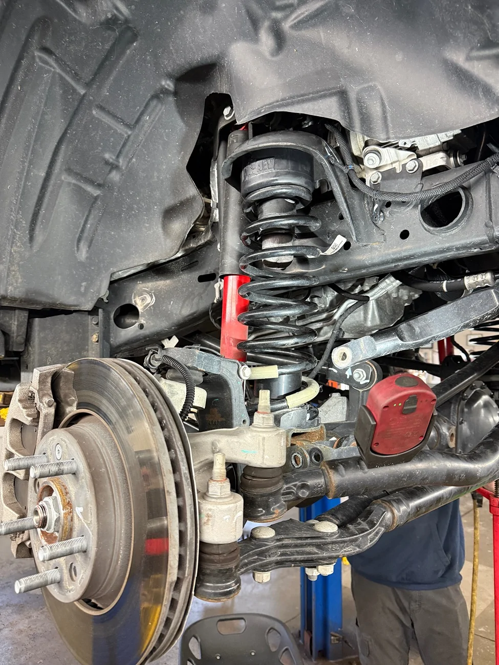

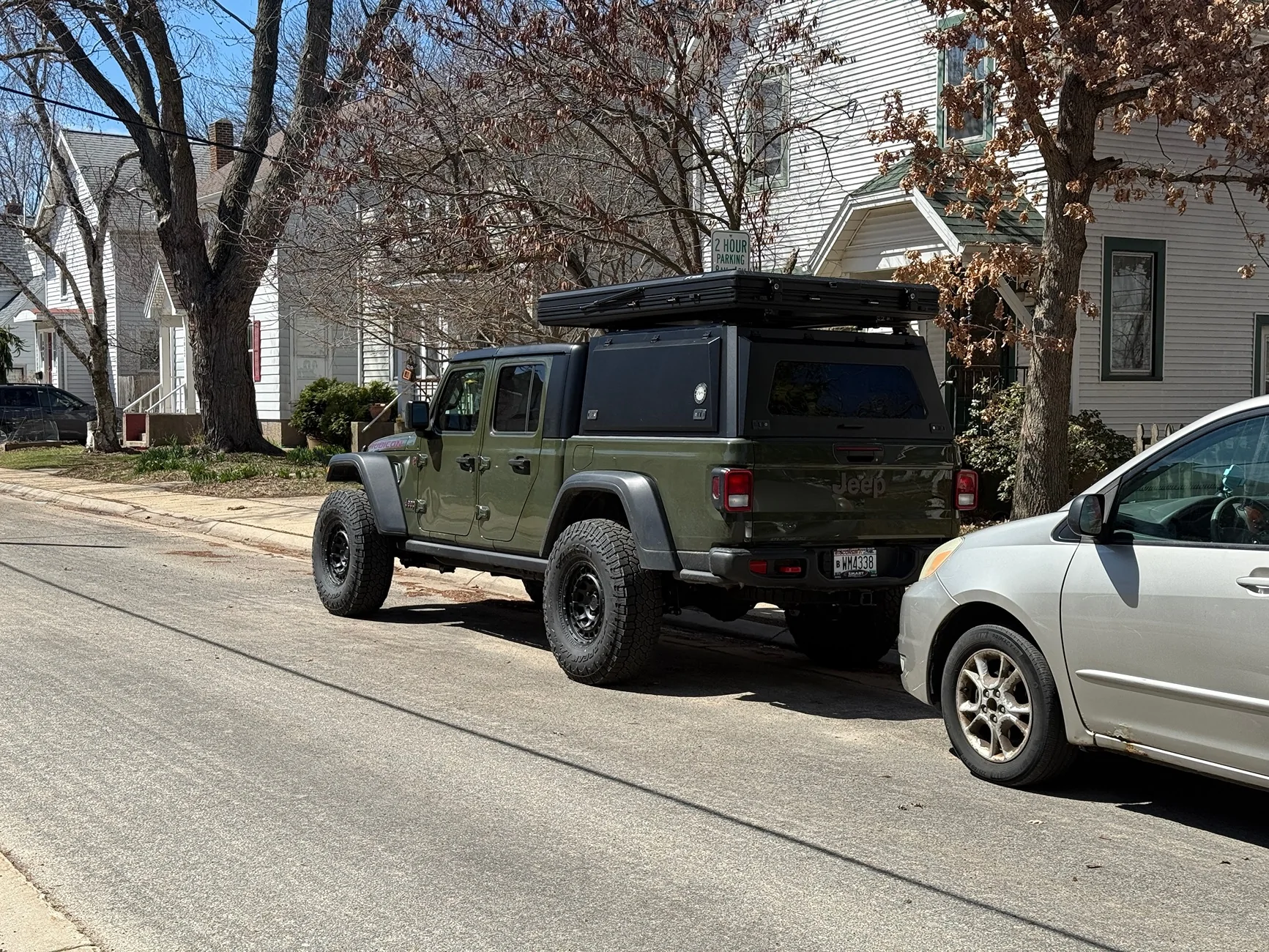

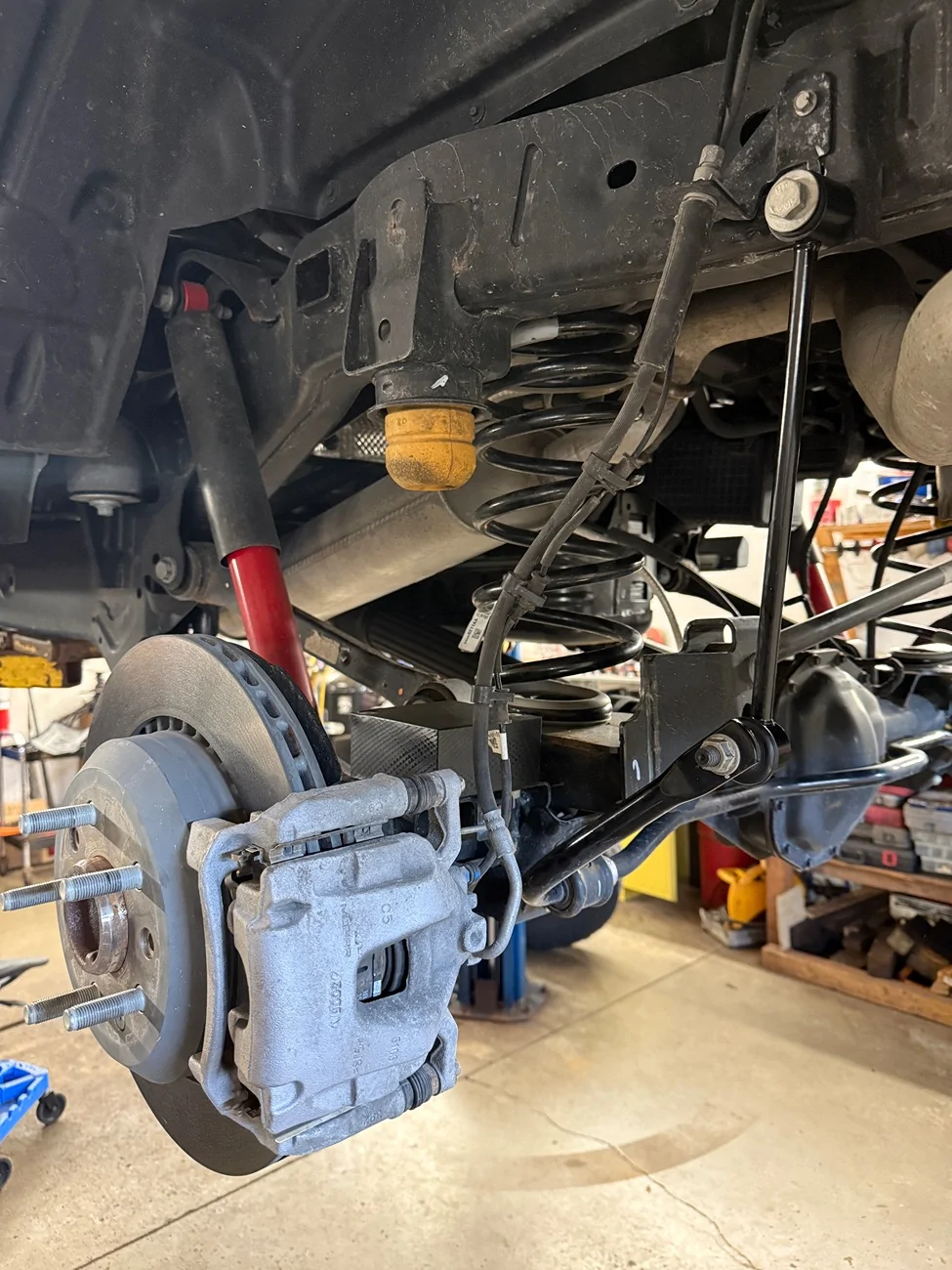

Got the AEV 2” Spacer Lift with Geometry Correction Brackets installed. Holy cow. Feels like stock and the change from the 37s and no lift to this is massive. The truck just feels like it should now. I can only imagine how impressive an expensive suspension lift would feel.
I’ll run it like this until I decide I need more, or until enough component parts fail to make slow upgrades worth it. Very impressed so far.
My local mechanic installed it for 6 hours of shop time.

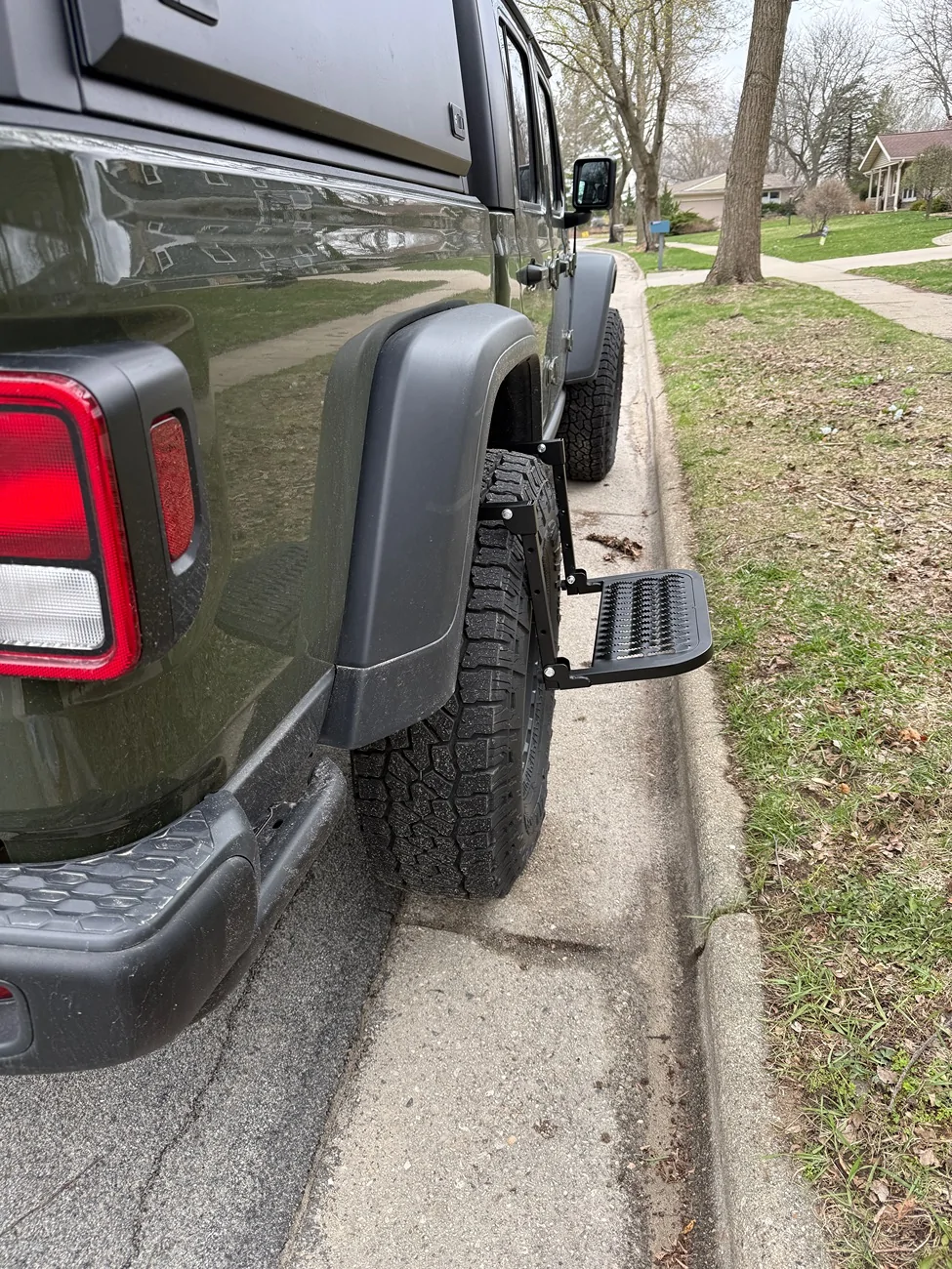

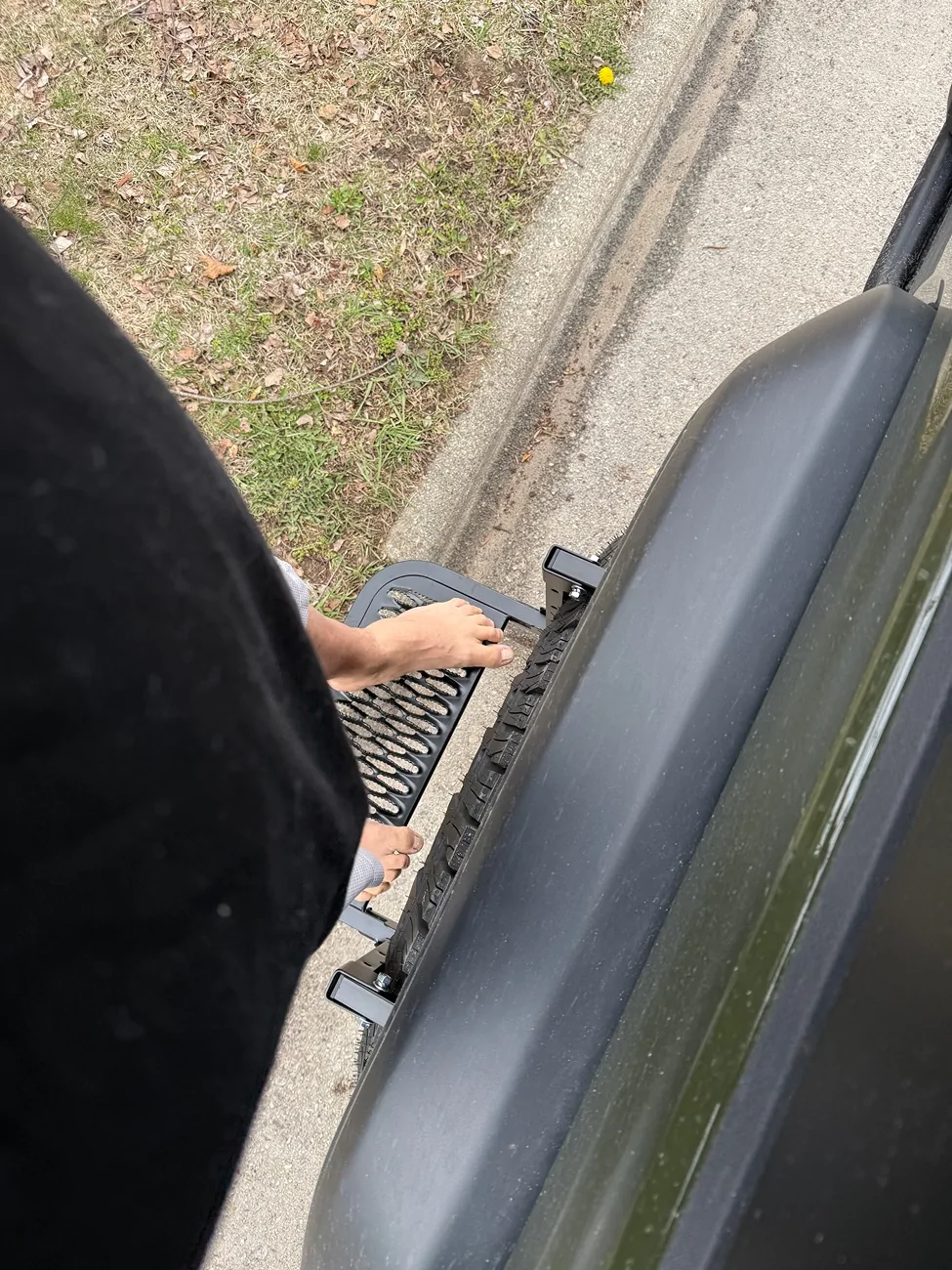

A small step for man, a giant step for a man on 37’s.
This will have many uses to include holding the diesel heater on cold nights.

Second picture. OW.
Also, where did you pick this up?
