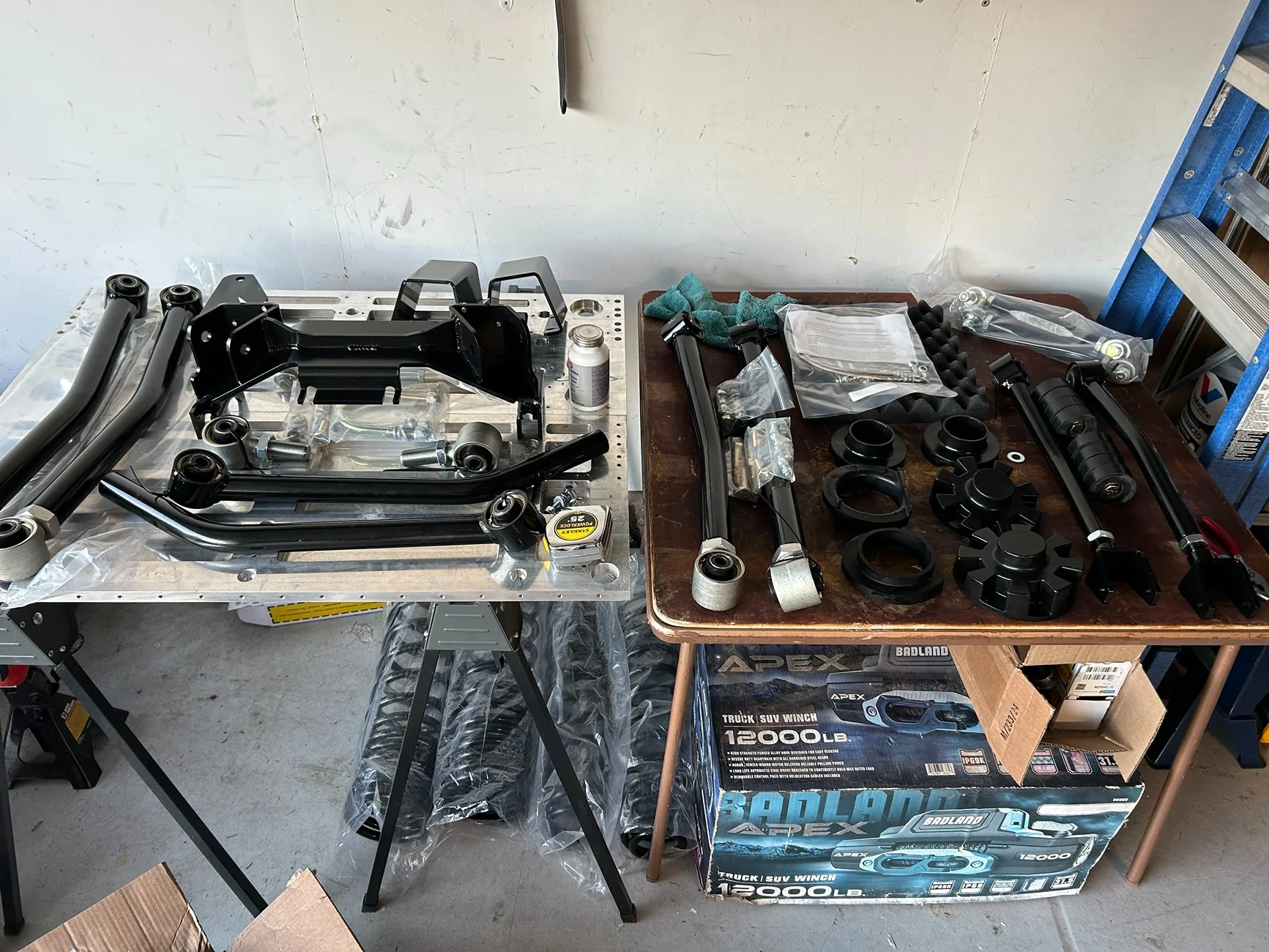

So now just waiting one one box from RK. I should be doing the lift and steering this weekend! 🤞

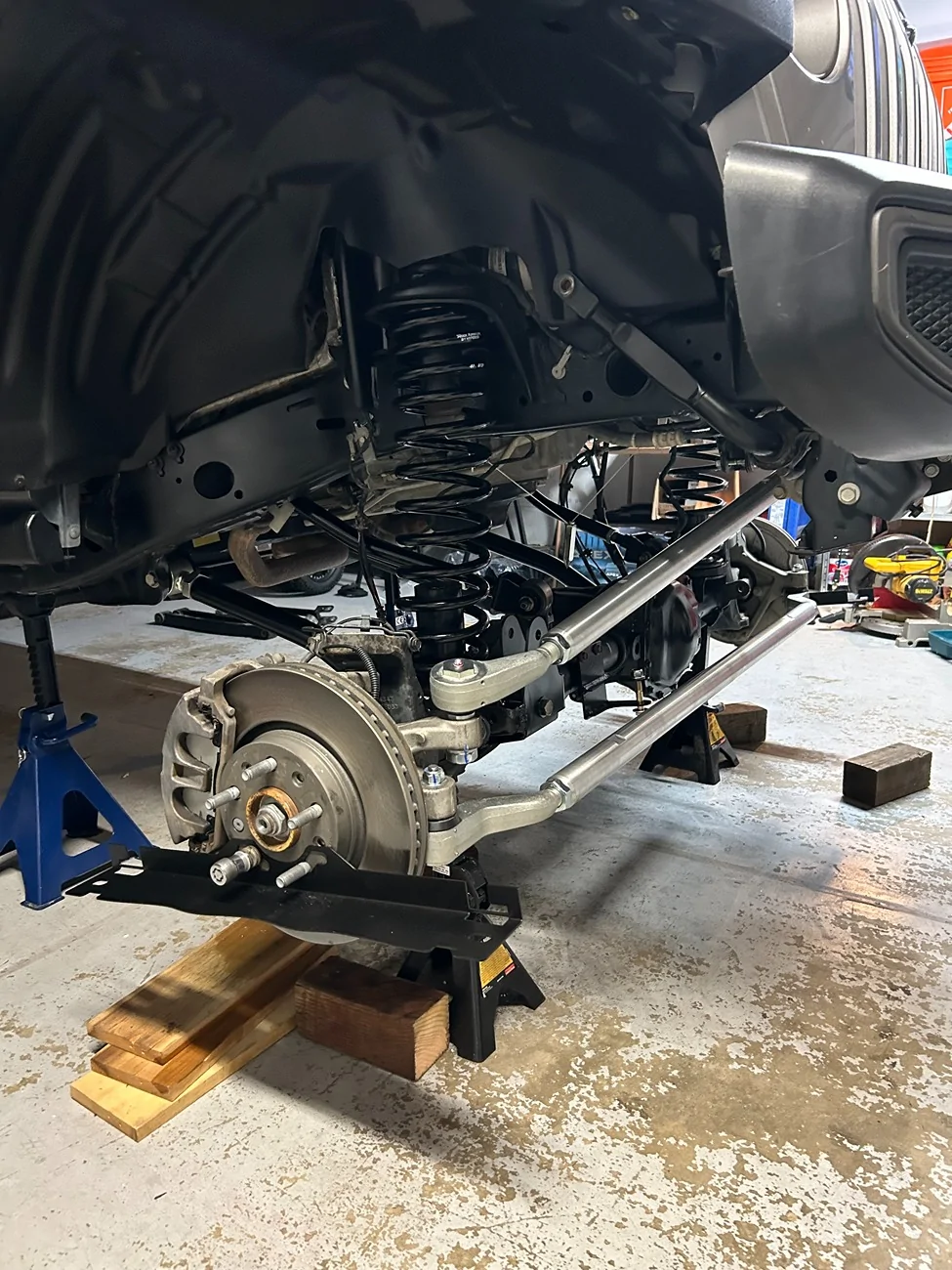

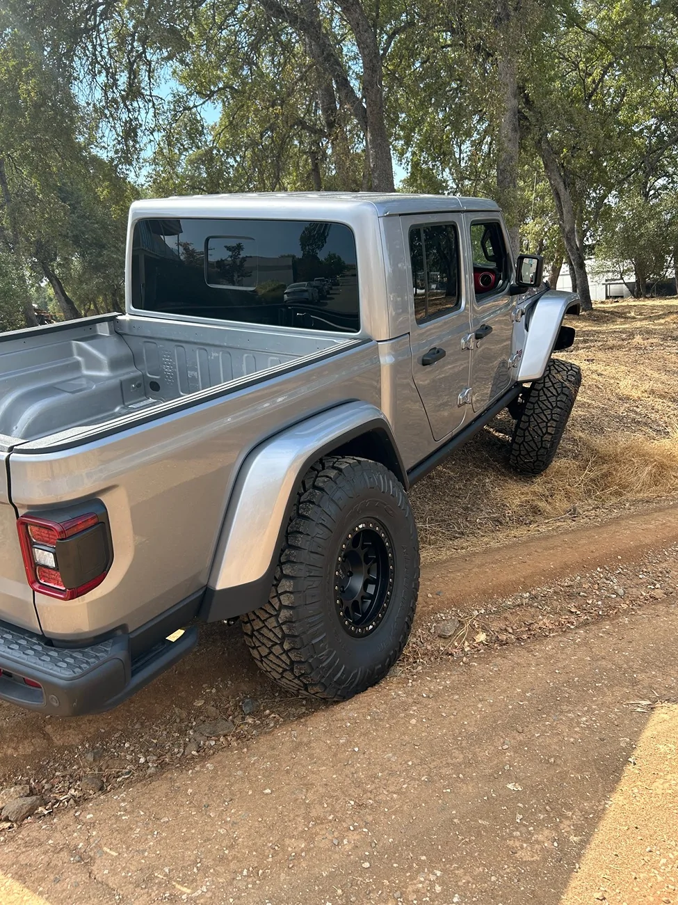

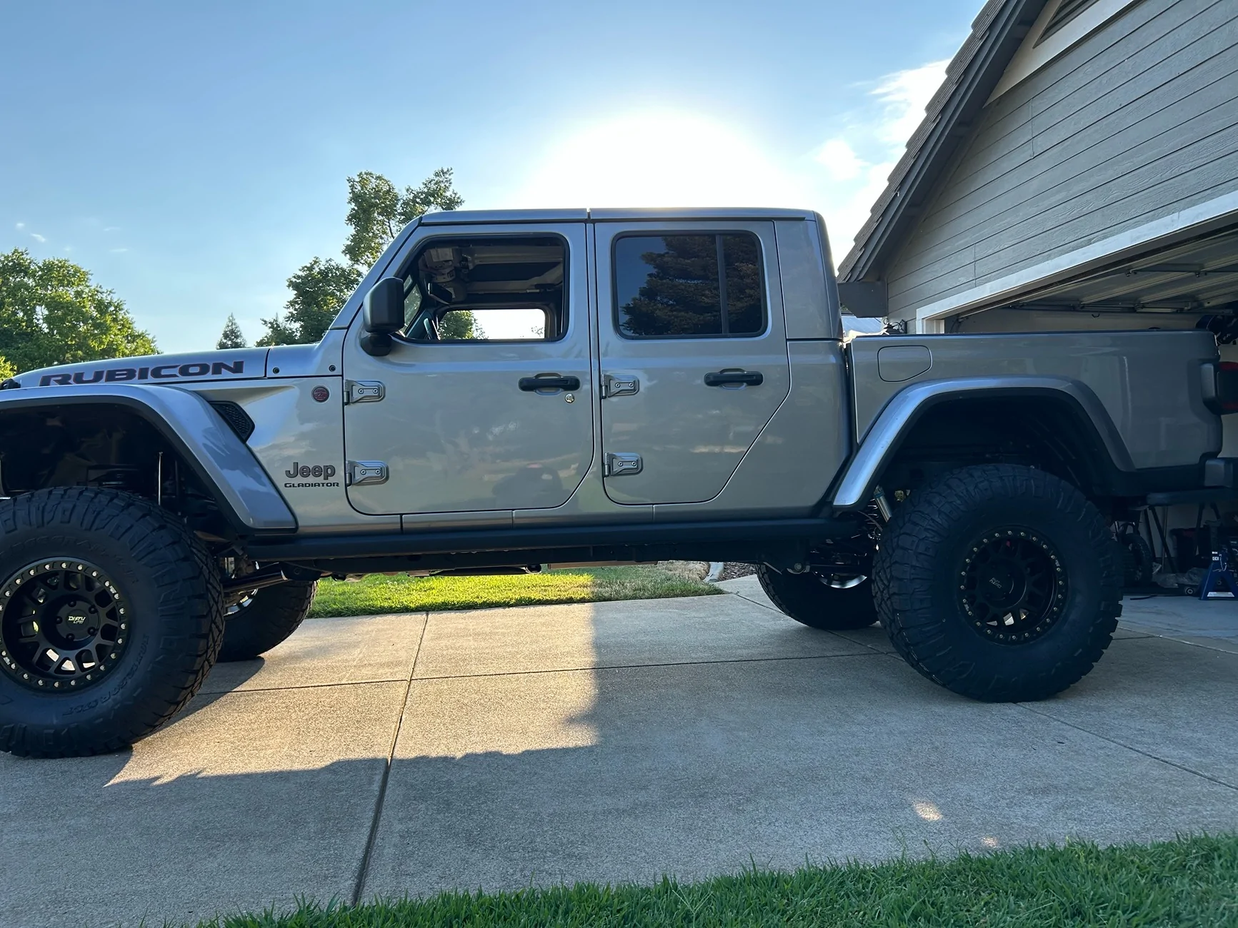

Took two long days but got the full lift and steering installed! The lift went really well just a lot of stuff to do at once and i think i got up and down at least 1000 times lol. it drives super well zero bump steer im going to get a proper alignment tomorrow and post some more photos!

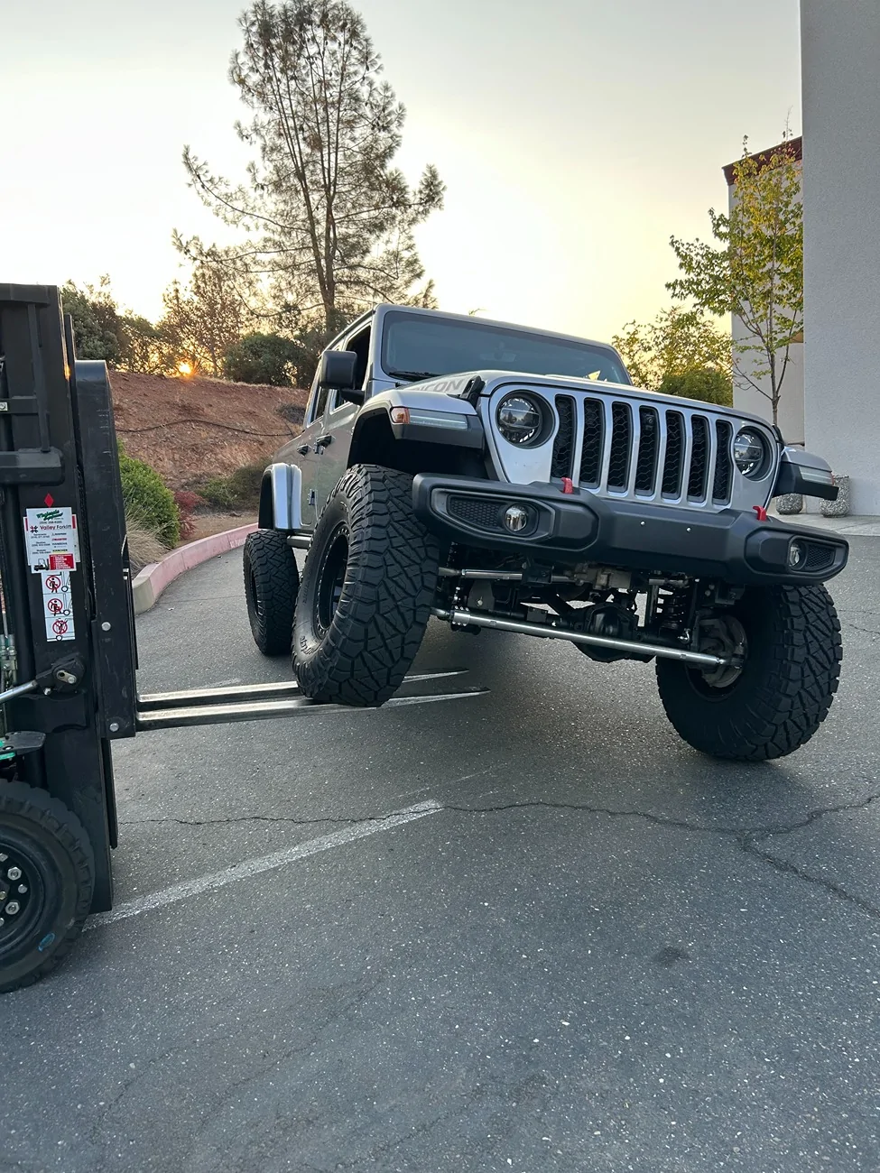

silly me forgot to disconnect the sway bar on the first pic. also i have the Adams 1350 installed now and did another forklift test with the swaybar disconnected this time and my font wheel was off the ground like 36in with the rear still planted! the Rock Krawler flex is crazy! I'm going to do more testing soon!

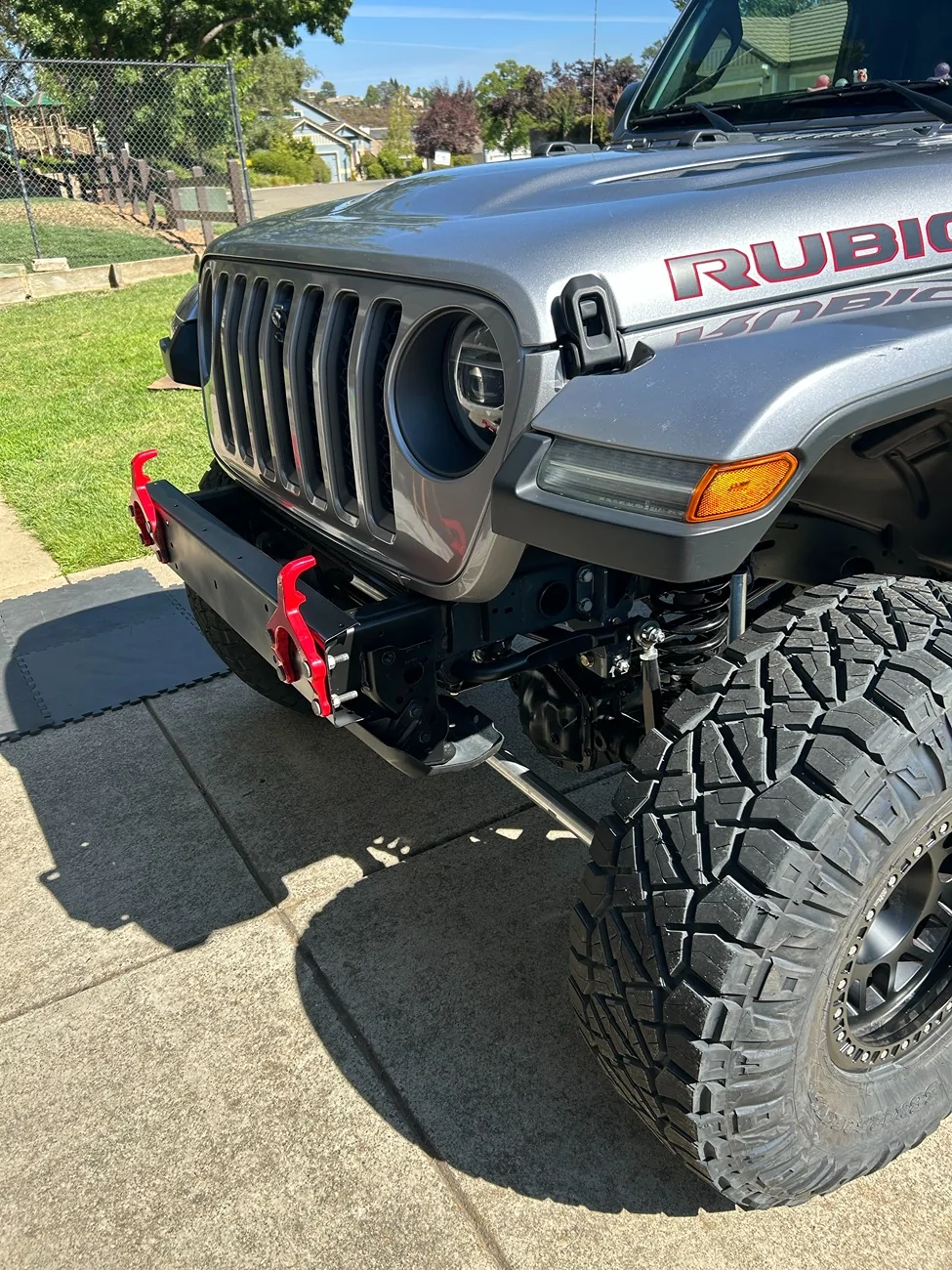

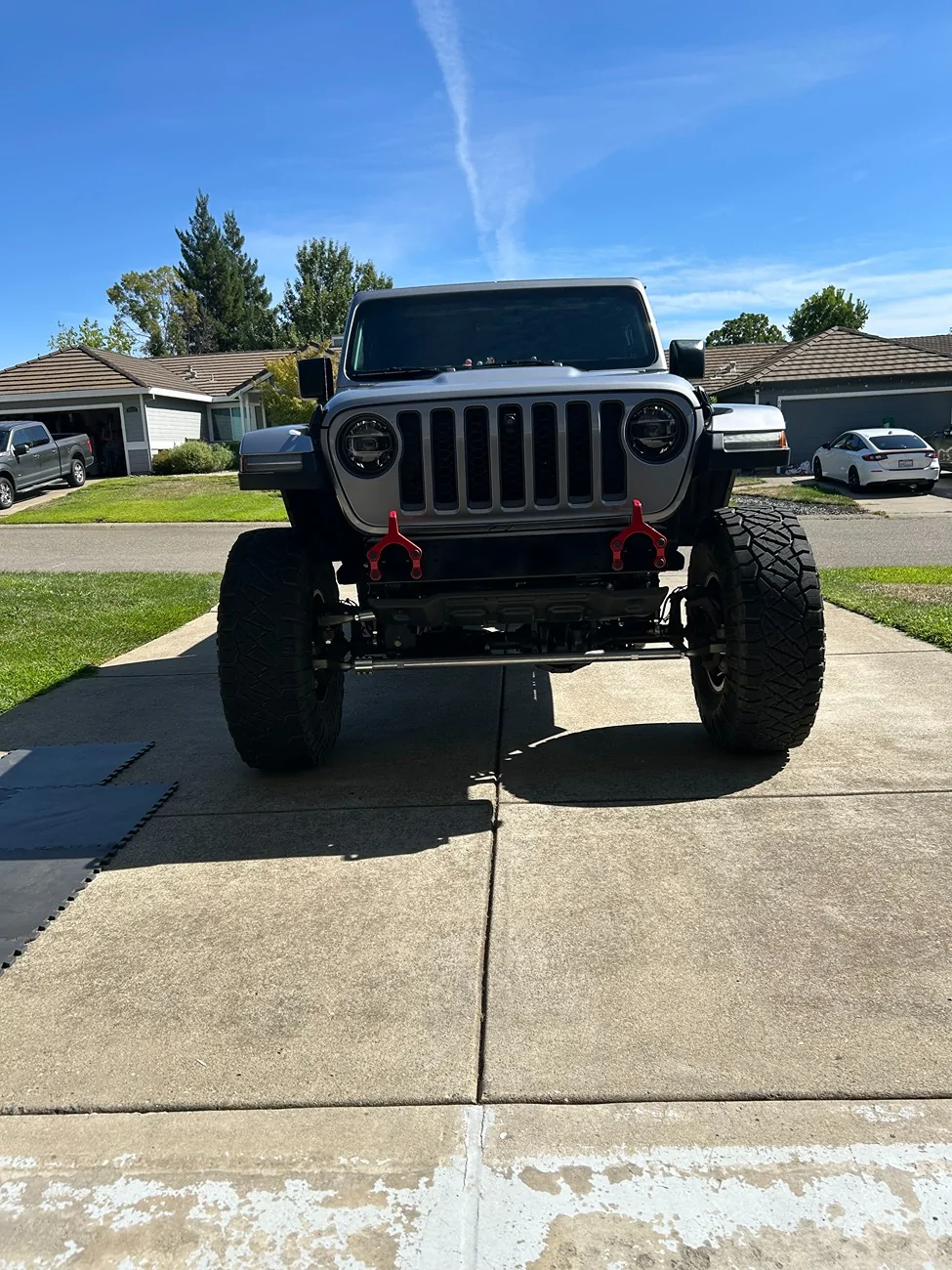

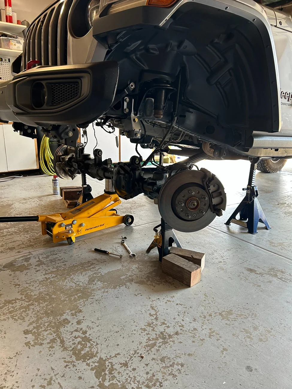

Ok so i had to get rid of the front bumper but my pockets are pretty tight right now from buying synergy knuckles and balljoints so i chopped up the oem plastic one. whatcha think?
Aint fancy but functional, and it works

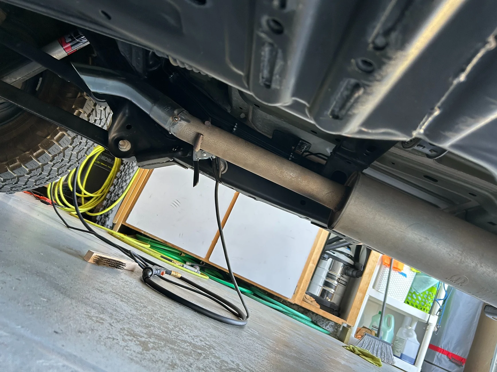

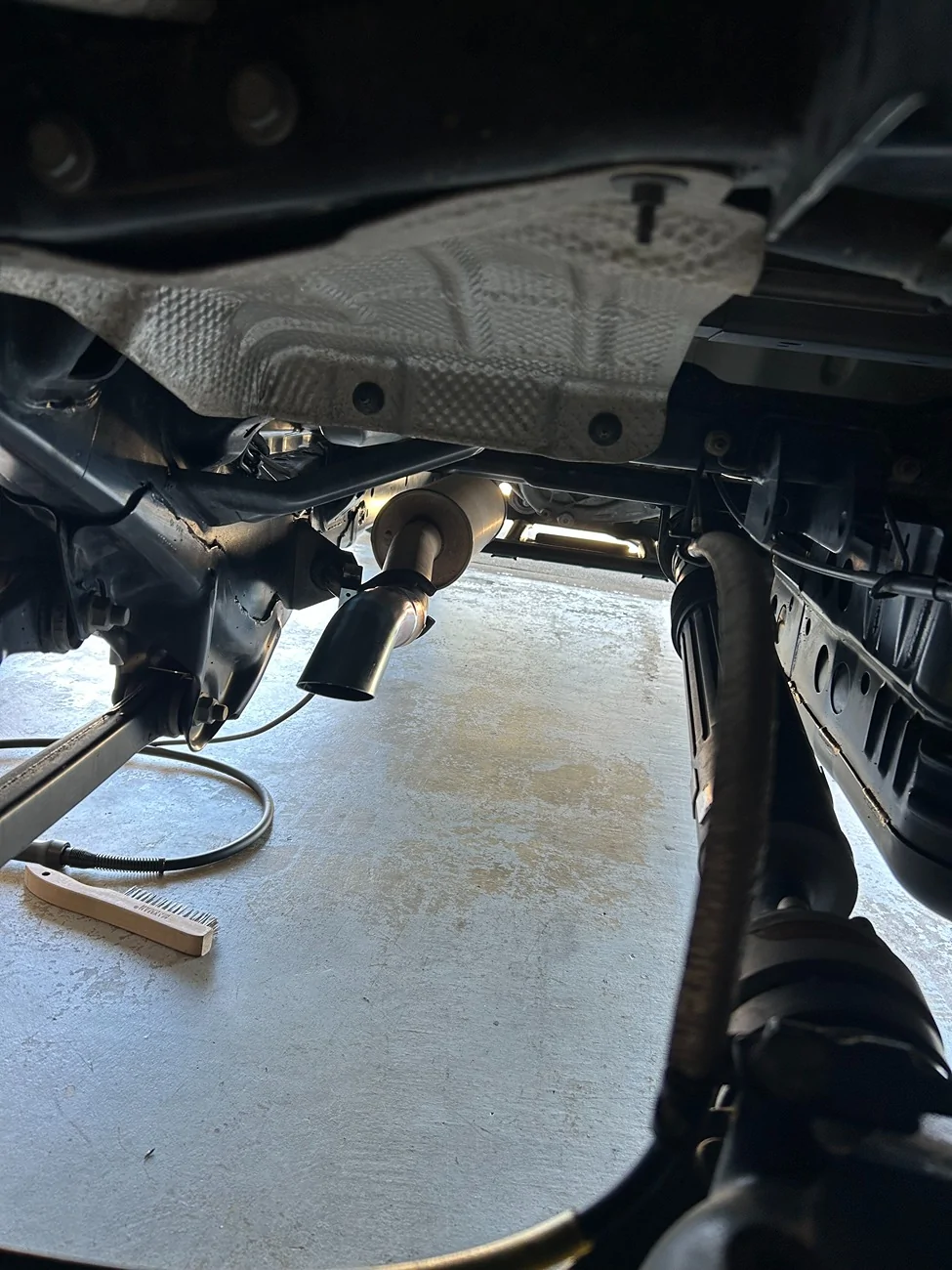

A quick and super easy way to gain exhaust clearance. I cut it right at the muffler and welded on a $10 turn down tip from AutoZone. keeping the first resonator its not really loud and is very quiet at cruising speeds. But man you can really hear how hard that v6 is actually working on small hills or getting on it. makes your realize how heavy the JT is when you make it a bit louder.
Since your intending on crawling this thing I'll share my experience with the stock exhaust. That round resonator is the main snag point when traversing over a ledge. I have dragged the frame and then snagged the round bottom edge of the resonator causing exhaust leaks 3 times. Once i seperated the flange at the y pipe and twice it pulled at the manifold hard enough to force me to replace the drivers side manifold gasket. PITA
My solution was welding in the dynamax resonator in place and leaving the stock muffler and then cutting the tiny rear resonator off dumping the exhaust behind the rear axle. Its hardly louder than stock and keeps fumes farther away. Just some advice from someone who's using their jt in similar fashion.
