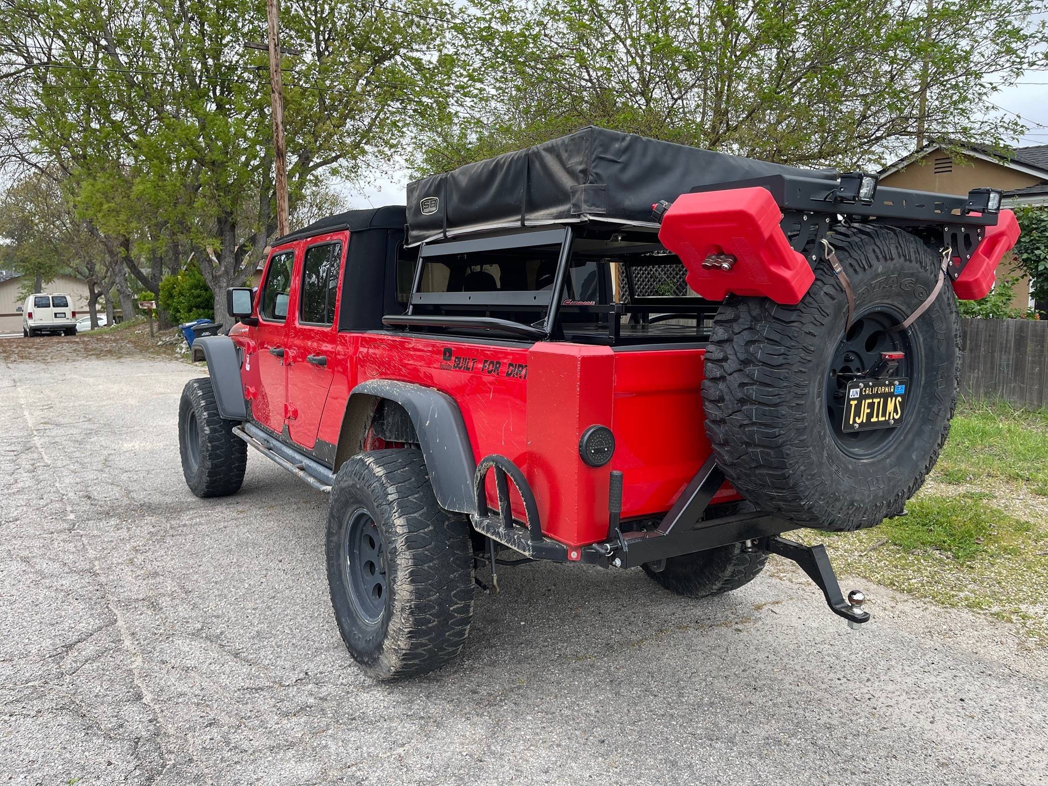

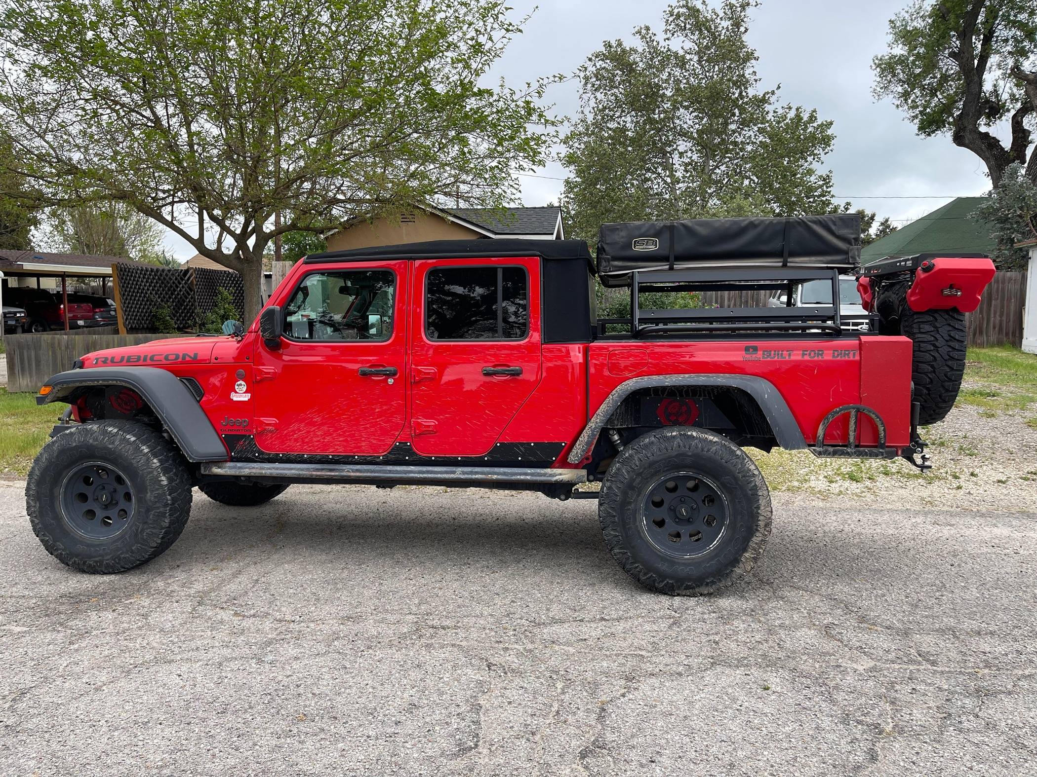

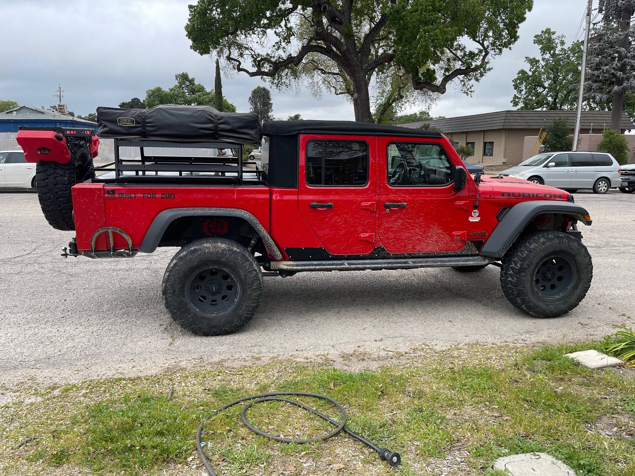

Paint was chipping real bad on my bed rack so I finally got it powder coated and back on the JT. First time having it back on with the tent and the spare tire. Ready for some adventures again

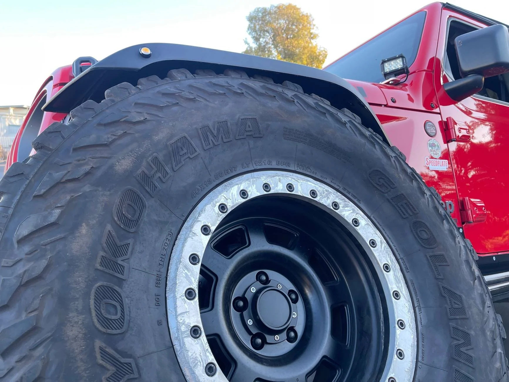

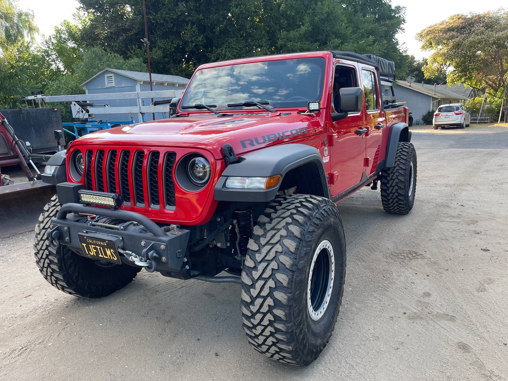

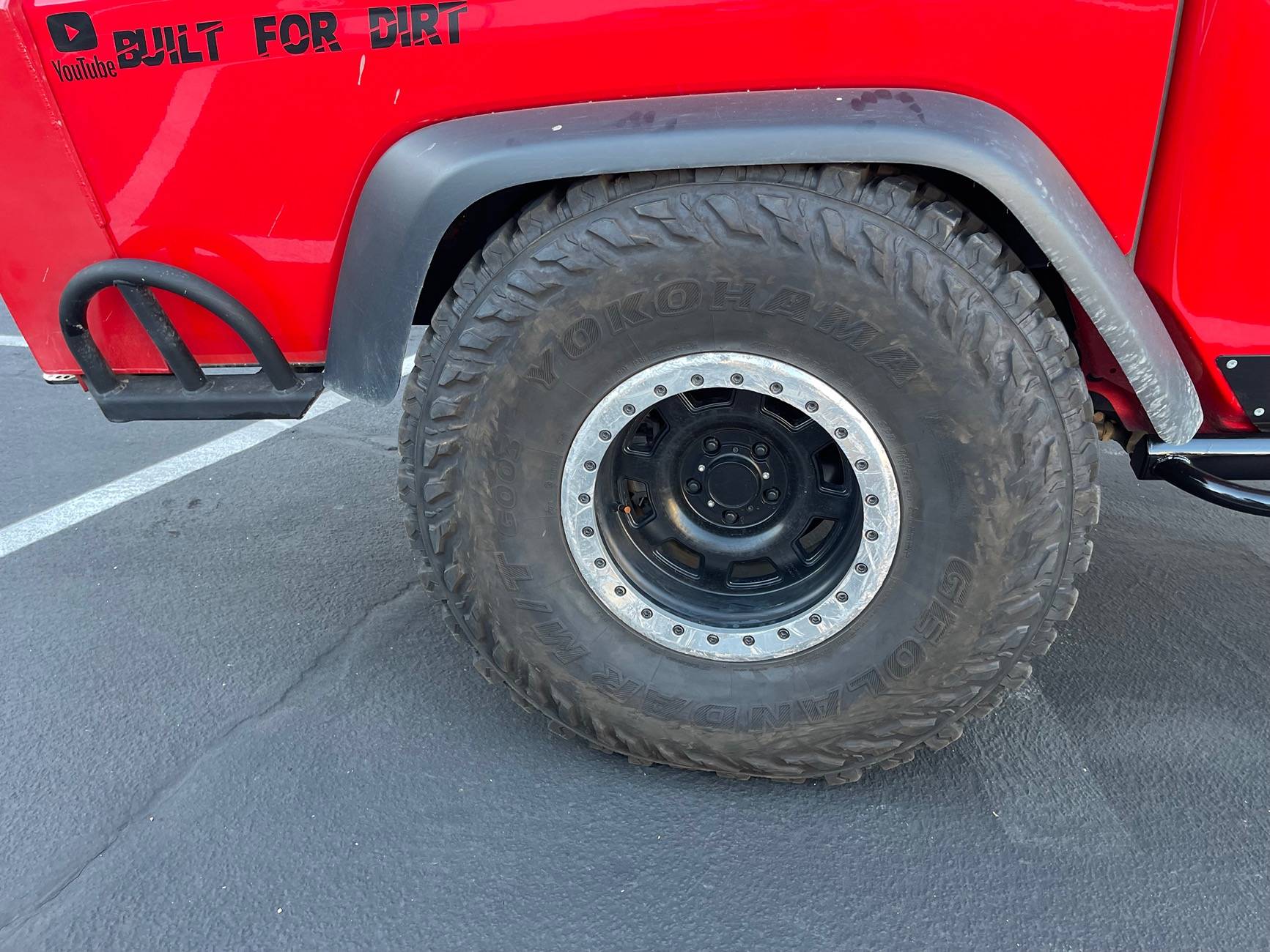

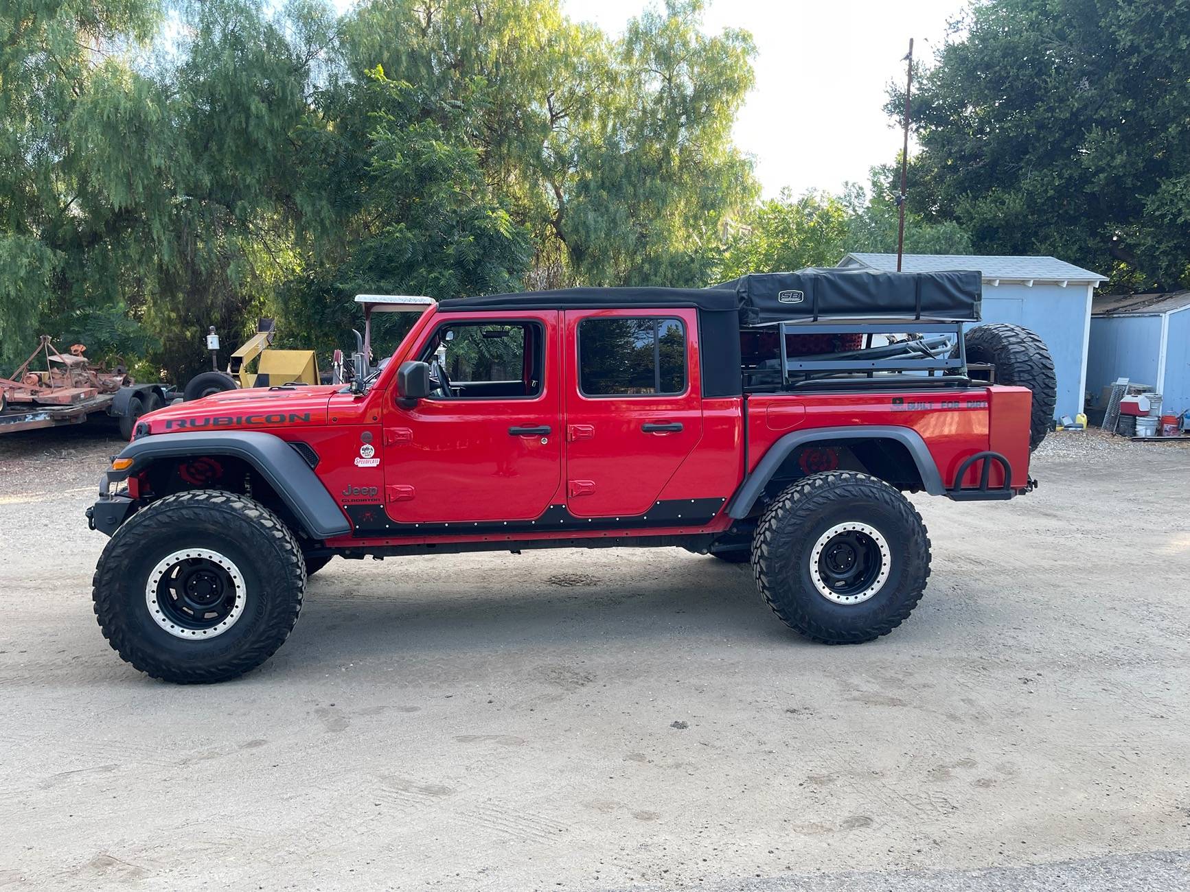

Too good of a Facebook marketplace deal. 40ā€ Yokohama MTs on Side Tracked bead locks with TPMS already installed. Have to modify the sliders so I took them off for now and need to do the front fender chop. Getting a weird shimmy only at 40 mph so need to go back through the front end.
I honestly didn’t think going from 38s to 40s would be this big of a leap but WOW totally transformed the truck and I can’t wait to get it out on the rocks.

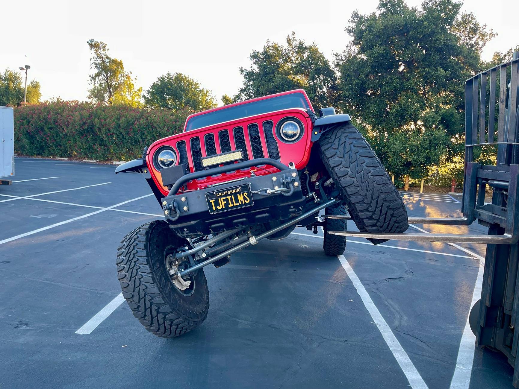

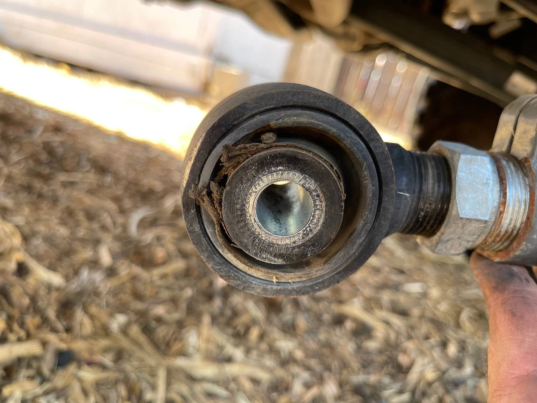

Might be time for some new control arm bushings…
Ouch. I’ve been there. Johnny joints make me mad. It just keeps happening. I couldn’t be happier about my change to Teraflex Alpine IR (independent rotation) arms. Zero maintenance and they hold up.
