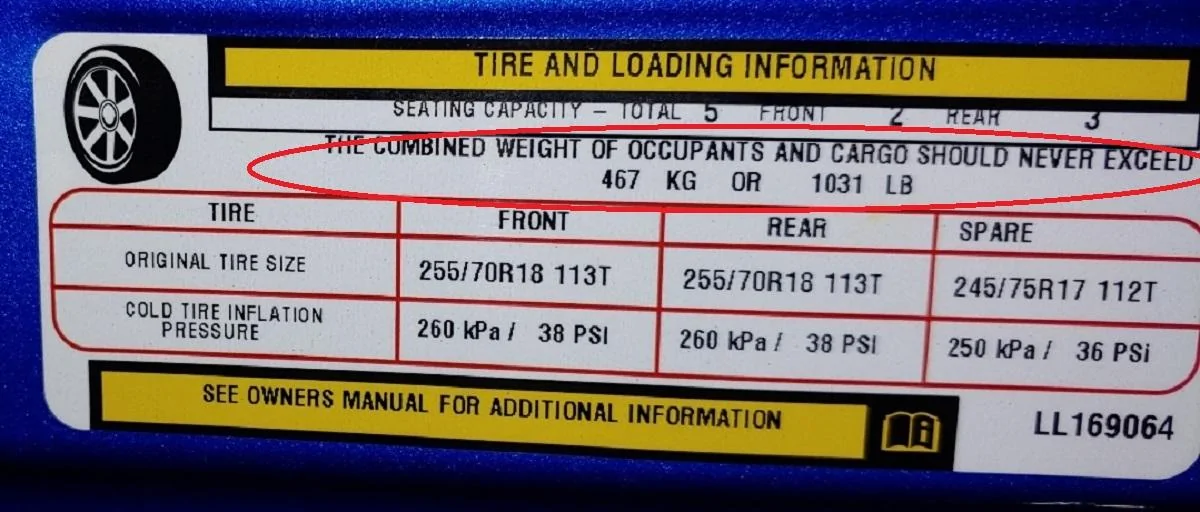

Payload is also part of ur tow weight,
Payload is what can be on the truck's springs and axles.
Payload is not connected in any way to what you can tow.
If you can tow 6,000 pounds and your payload is 1,100 pounds, you can have a tongue weight of 600 pounds leaving you 500 pounds for yourself, your dog, your cooler with beer and your wife.
You can tow 6,000 pounds regardless of your payload.
Your payload is 1,100 pounds in my example regardless of the weight of the trailer behind you.
You can't say that the tow limit is 6,000 plus whatever the payload is, nor can you say that because you have 500 pounds of payload you can only tow 5,500 pounds of trailer.
