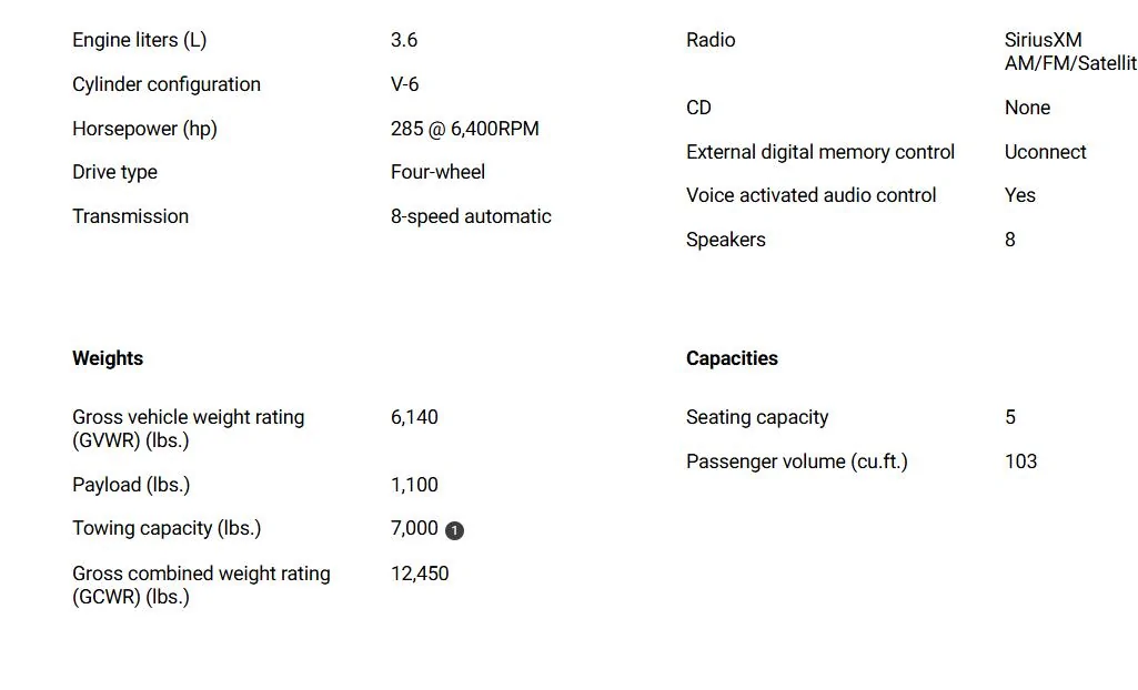

I looked up the specs for a 2025 Mojave X and it's rated at 7,000 pounds towing -
https://www.jeep.com/gladiator/specs.mojave-x.html
Jeep Gladiator Tow Capacity - Double Check the Math 1745863182944-1i
The payload is for a stripped down Mojave X - tonneau cover, bed liner, other stuff take away from that 1,100 pounds- mine is 840 if I recall correctly.
Sport S is 6,00 pounds
https://www.jeep.com/gladiator/specs.sport-s.html
Willys is 6,000 with a lower payload of 950 (before options - LOOK AT THE DOOR STICKER) -
https://www.jeep.com/gladiator/specs.willys.html
Rubicon and Rubicon X - 7,000/1200
https://www.jeep.com/gladiator/specs.rubicon.html
