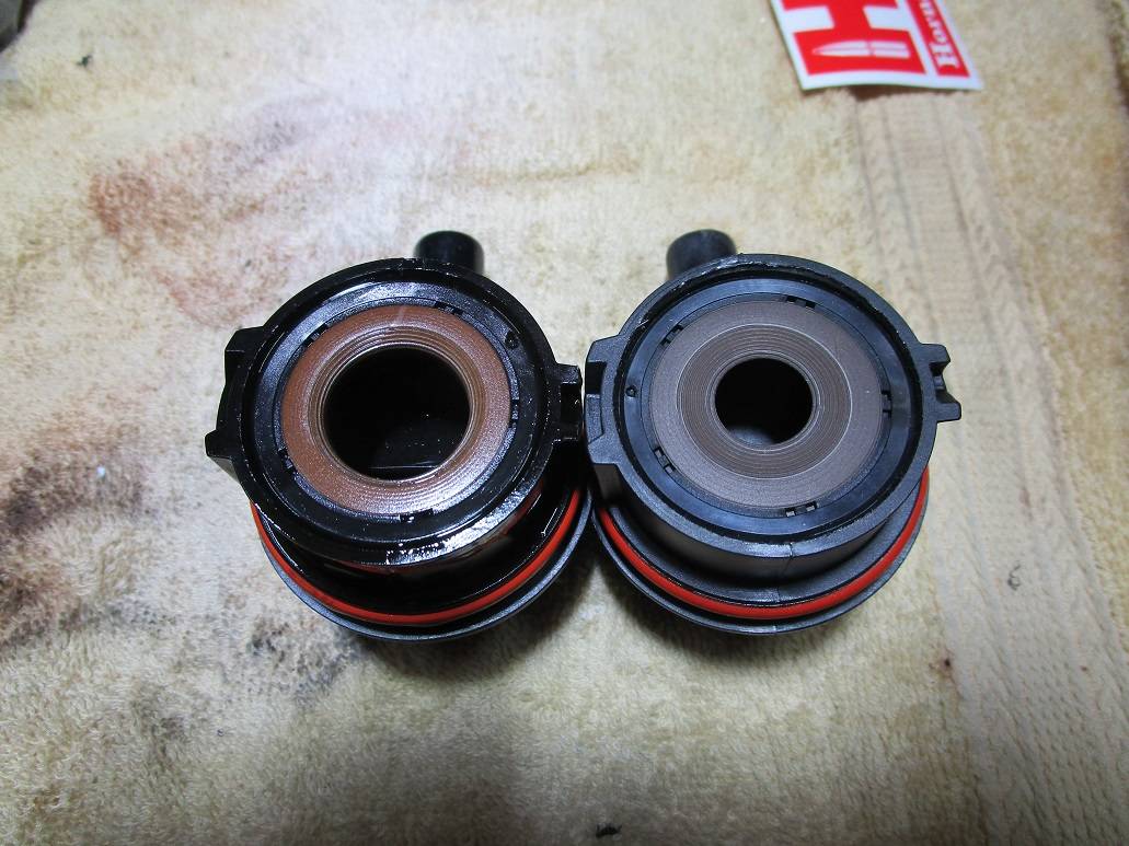

When I first herd spark knock on my 3.6 I was amazed at how bad it was even running high octane gas
What totally eliminated the spark knock was a UPR oil catch can. I have not heard any knocking after in installing oil catch can. Oil mist contaminates the air fuel and lowers the octane
I have also just installed the updated PCV valve (old valve on the left)
In 600 miles I will check and see if the new PCV valve reduced the amount of oil collected in my oil catch can
