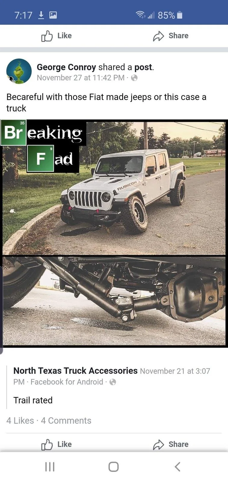

Front Axle Disconnect. I was reading up on what this is since the gladiator is my first Jeep. Essentially allows the front axle to not spin when in 2H to save MPGs. They have to cut a hole in the axle tube which they say can weaken the tube. This led to me reading way too much about FAB Deletes.
That was exactly my initial impression. They may have been doing the mod when this failure occurred. Personally, I know FAD has bad press from the YJ days, but this one is a different design (electrical vice pneumatic). I plan to leave it alone unless we have solid evidence that it is a serious problem to my use of the vehicle for overlanding.

For lurkers or those not familiar with the disconnect -
Actually the axles still spin - the idea is you don't spin the carrier, thus don't spin the ring gear, pinion and front drive shaft.
You split the right axle into two inside the right axle housing.
The left axle still spins in entirety, spinning the gear inside the carrier and the inner half of the right axle spins counter to the outer half, which is still connected to the right front wheel. You spin the carrier gears, the spiders, not the whole carrier. Only hub disconnects or locking hubs would allow the axles to not spin at all.
The mechanism to split the axle may vary but that's not where the strength or weakness is. It's the axle housing no matter what the "motor" is unless the whole disconnect is somehow self-contained inside the axle tube.
The idea is the same vacuum or electric - you have to have a device that moves a collar or sleeve to disconnect the two right axle "halves" or parts. That's similar to how the shifting happens in a manual transmission. Sliding a splined collar either locks the two pieces together, or sliding it off one part, unlocks them. So you have to get inside that axle tube to do the work of connecting and disconnecting that right axle.
The electric is more modern, less complex, but the axles will still work the same and be as strong or as weak.
I've not dug into the JT system or anything in the last few years but in other days, the axle housing or tube still had to be weakened either by it being two parts with a "box" between where the shifting took place, or some way to get in there and move a collar or sleeve - in any case you no longer have a single tube without any interruption.
