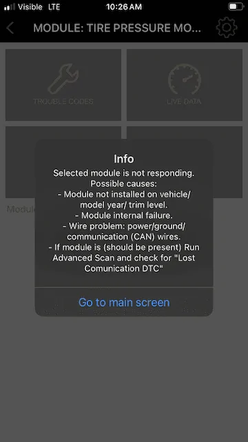

Issue is that when I go to the Modules page for the Tire Pressure Monitor, this is what JScan comes back with:
Jeep Gladiator JScan TPMS Thresholds - TPMS module not responding? IMG_2306

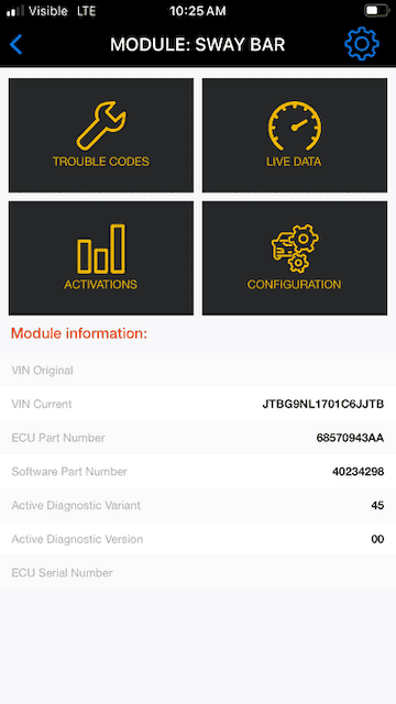

It can read other modules:
Jeep Gladiator JScan TPMS Thresholds - TPMS module not responding? IMG_2305
I did not verify before making the adaptations that the TPMS module could be read.
If this module should be readable, are there some other steps that I need to do to get it working?
