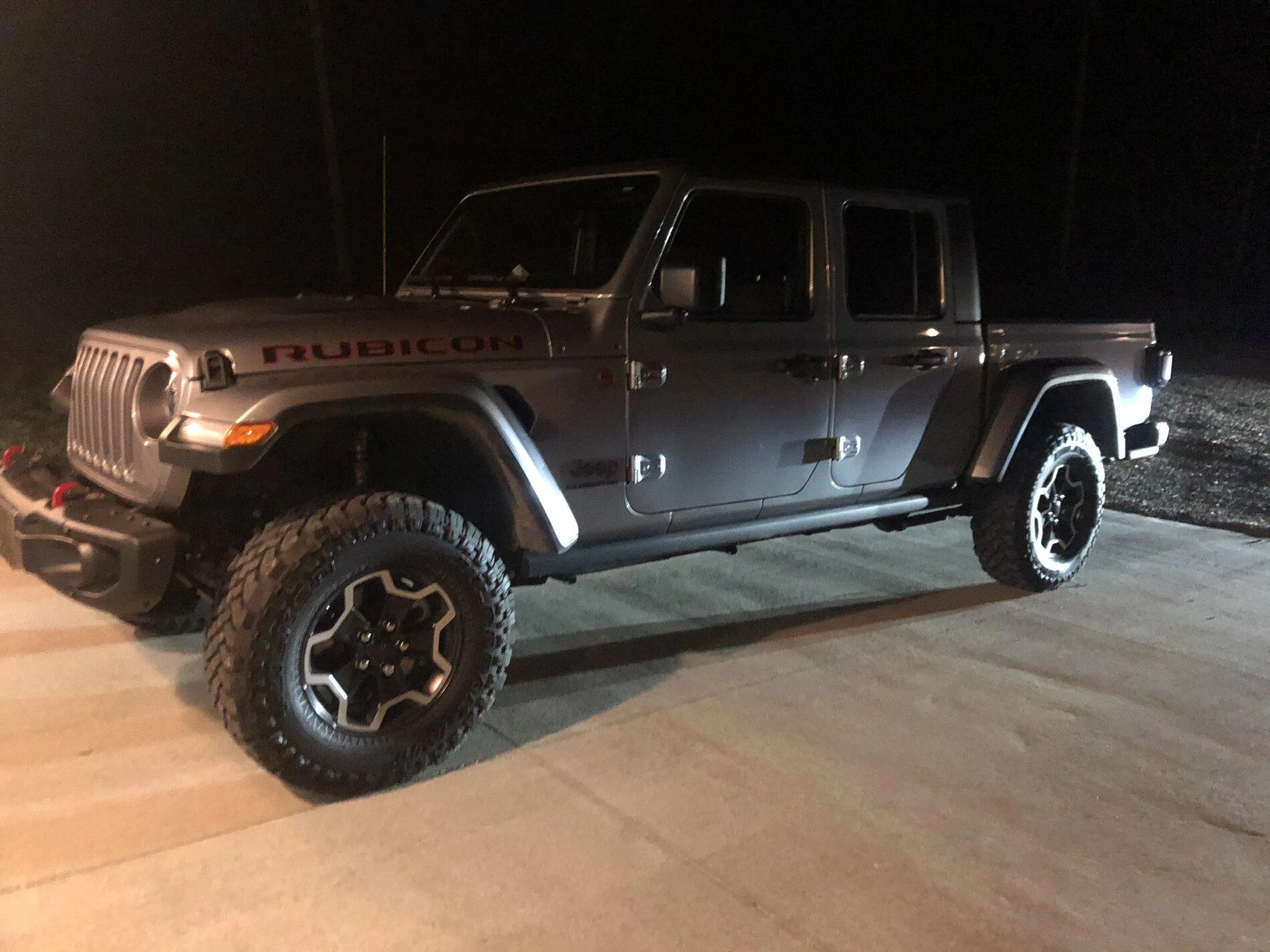

I installed the leveling kit the following day. It’s not huge, but parked next to a stock JTR, it’s a noticeable difference.

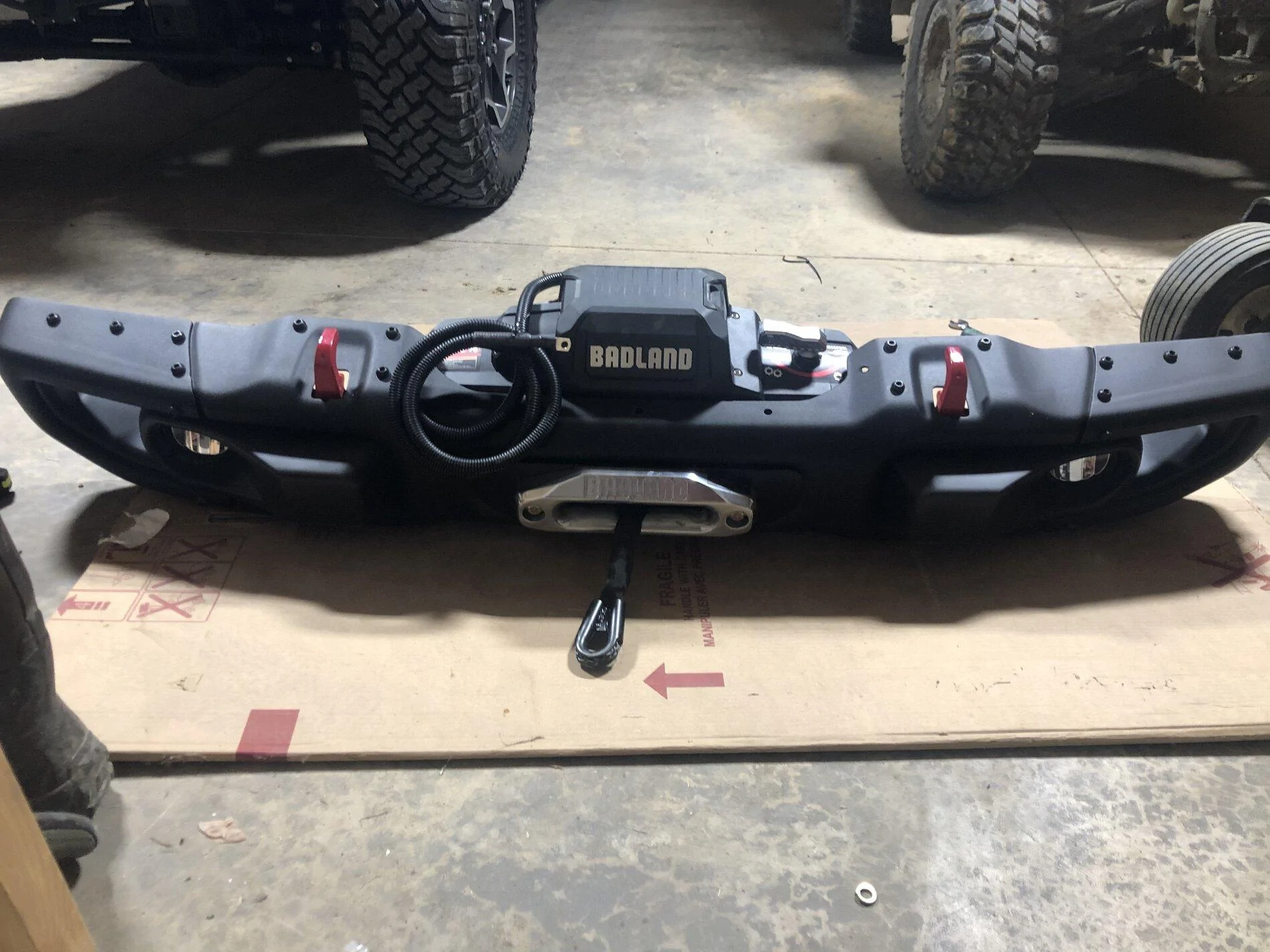

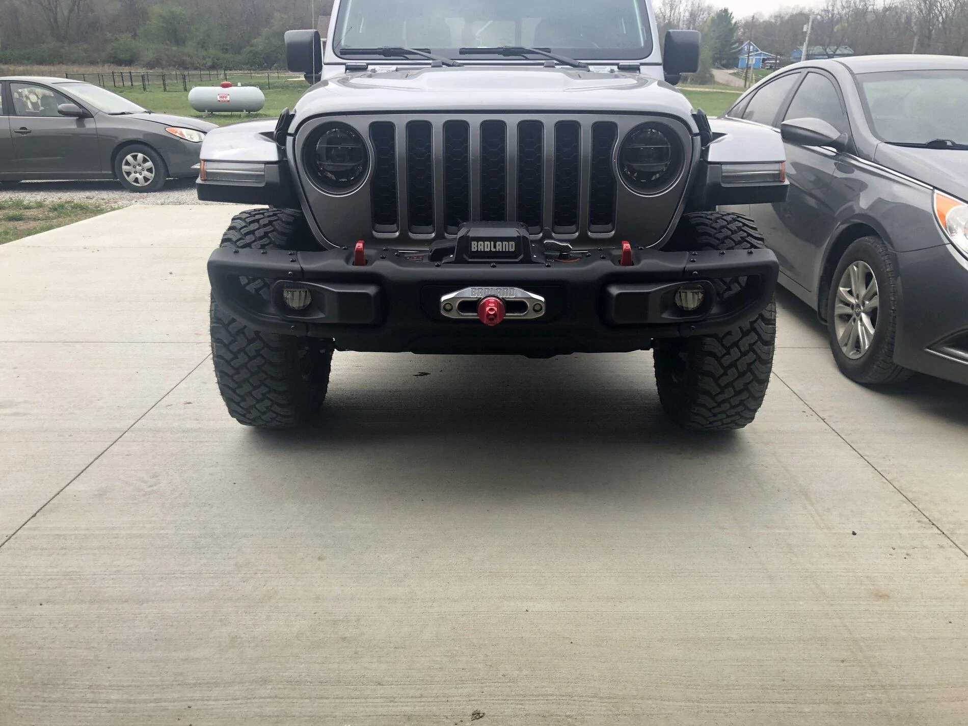

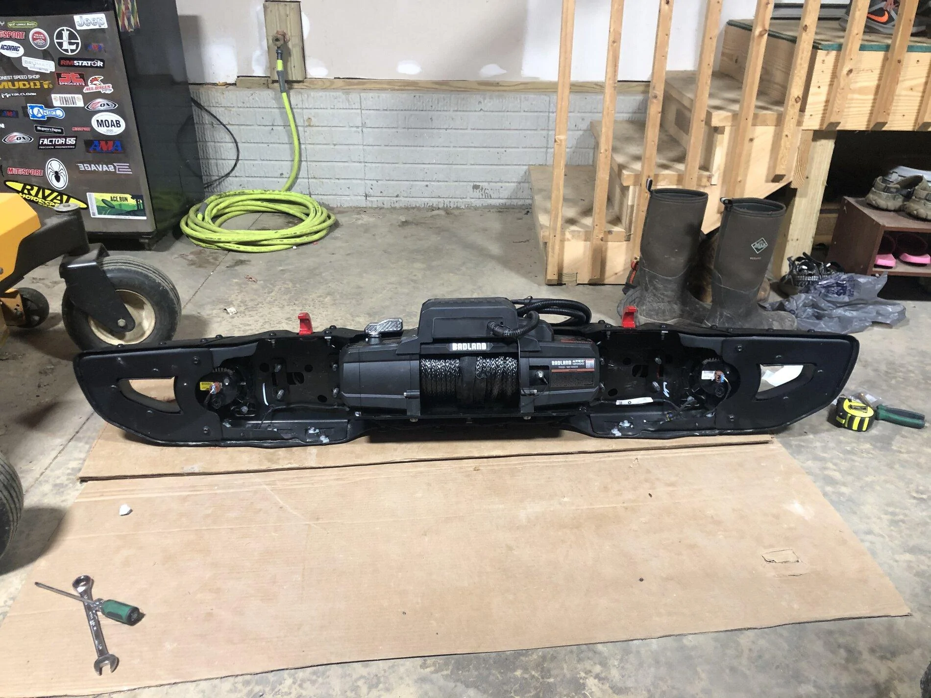

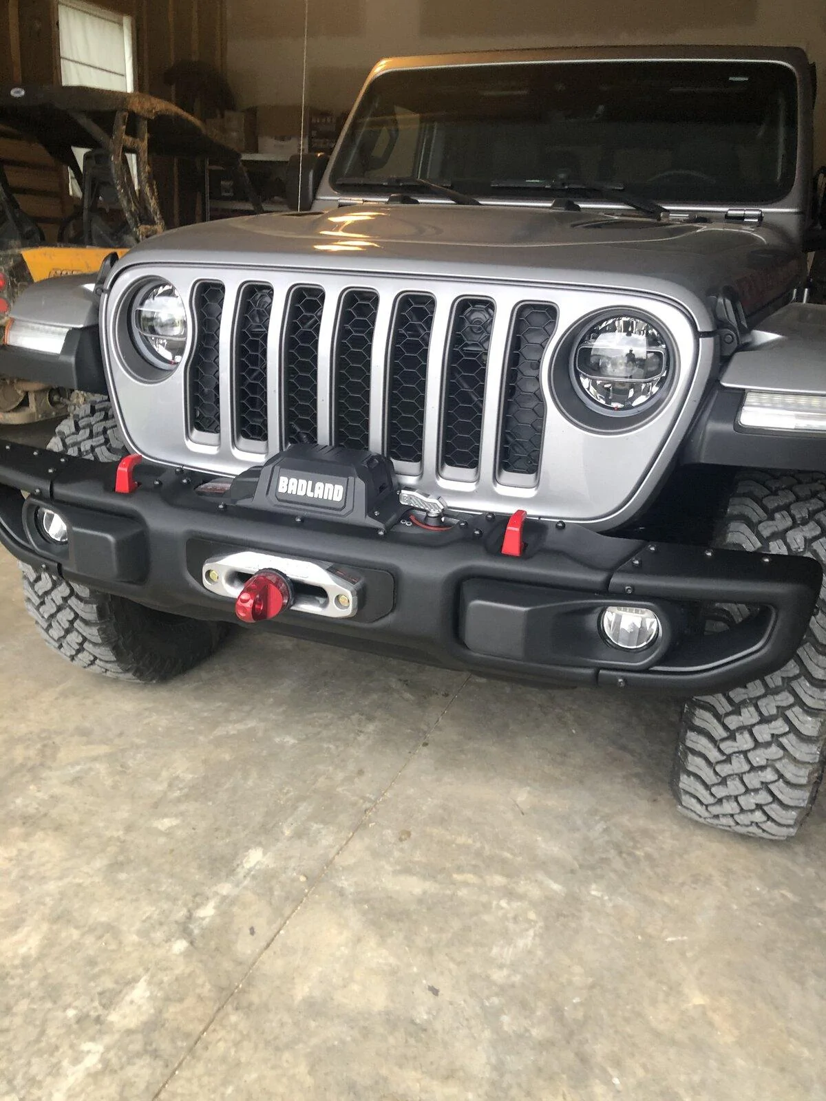

This week, I took advantage of a harbor freight sale, and purchased a badland apex winch. It fits nicely in the mopar steel bumper!
Jeep Gladiator JTR “budget build” 58D01AE5-515B-4F09-A03A-F35E74883B5A
Jeep Gladiator JTR “budget build” 65799764-4136-40B4-B727-5E5B5306CE19
Jeep Gladiator JTR “budget build” 916AB4C3-3BDB-42FA-99C4-5191DC163DD9
Jeep Gladiator JTR “budget build” 4A82ECE6-61DD-4B15-8AF1-94BA000DBB22

Looks good!
whose winch plate did you use?
It’s from rock hard 4x4.
Its very stout. All the holes and brackets lined up well and went together very smoothly.
The supplied bolts were about a 1/2” too short when used with the badlands fairlead.

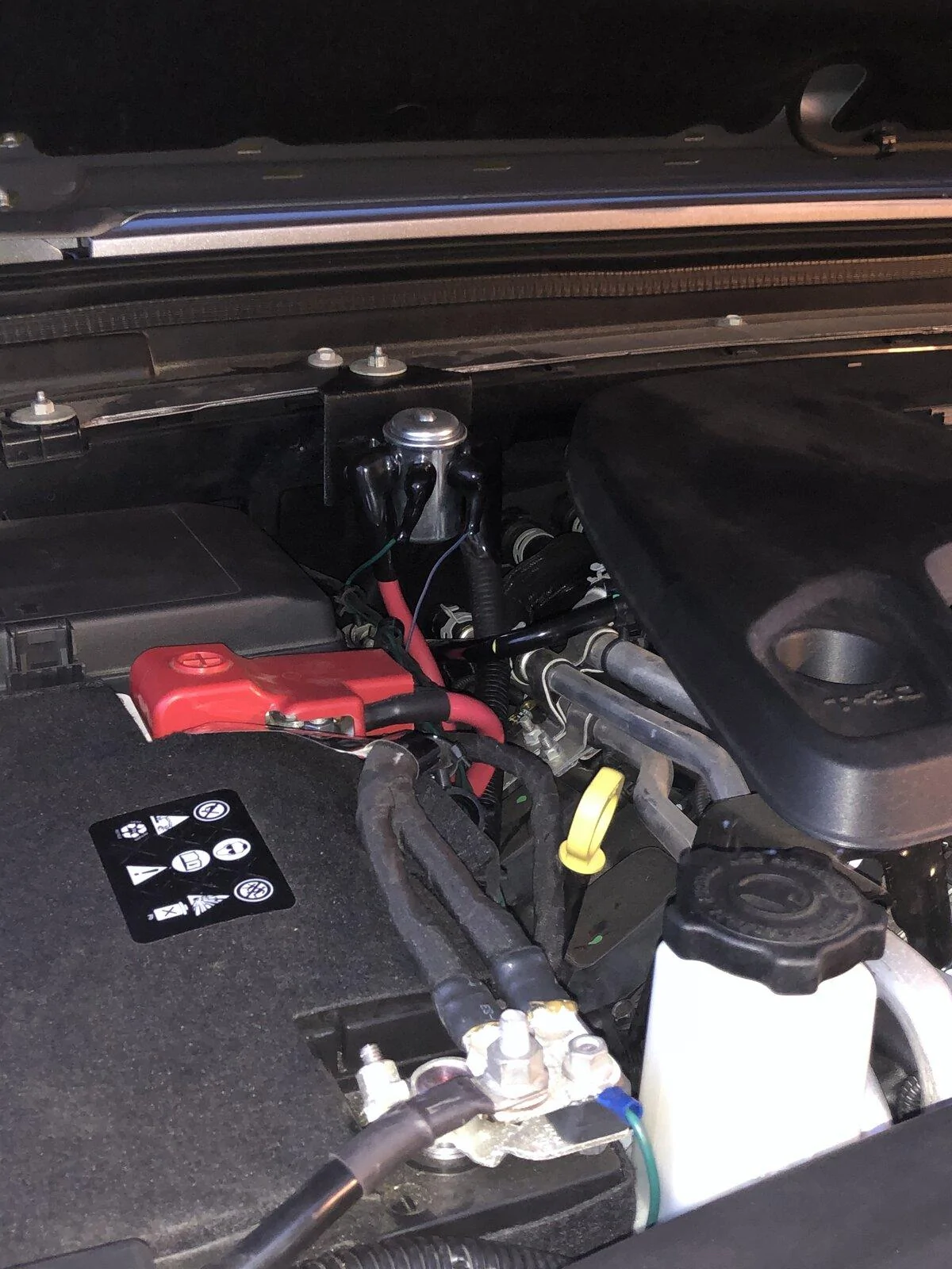

The harbor freight winch came with a stout manual power interrupter, but I really wanted to utilize my aux switches. I found a warn power interrupter (solenoid)) that I installed over the weekend. We made a bracket from left over steel and raptor lined it. It’s working great so far!
Jeep Gladiator JTR “budget build” 4C5129EF-4E69-4283-93EB-8F30062CA1FA
