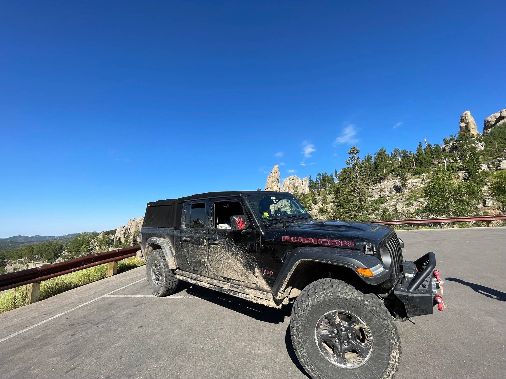

Hi all!
I have a stock rubicon gladiator. It's time to lift it! I am thinking around 3"/3.5" for a lift and I want the biggest tires possible with that. What would that be? 38s? I know I'll need to regear. It is also manual... not sure if that matters?
Any recommendations would be helpful.
Thank you!
