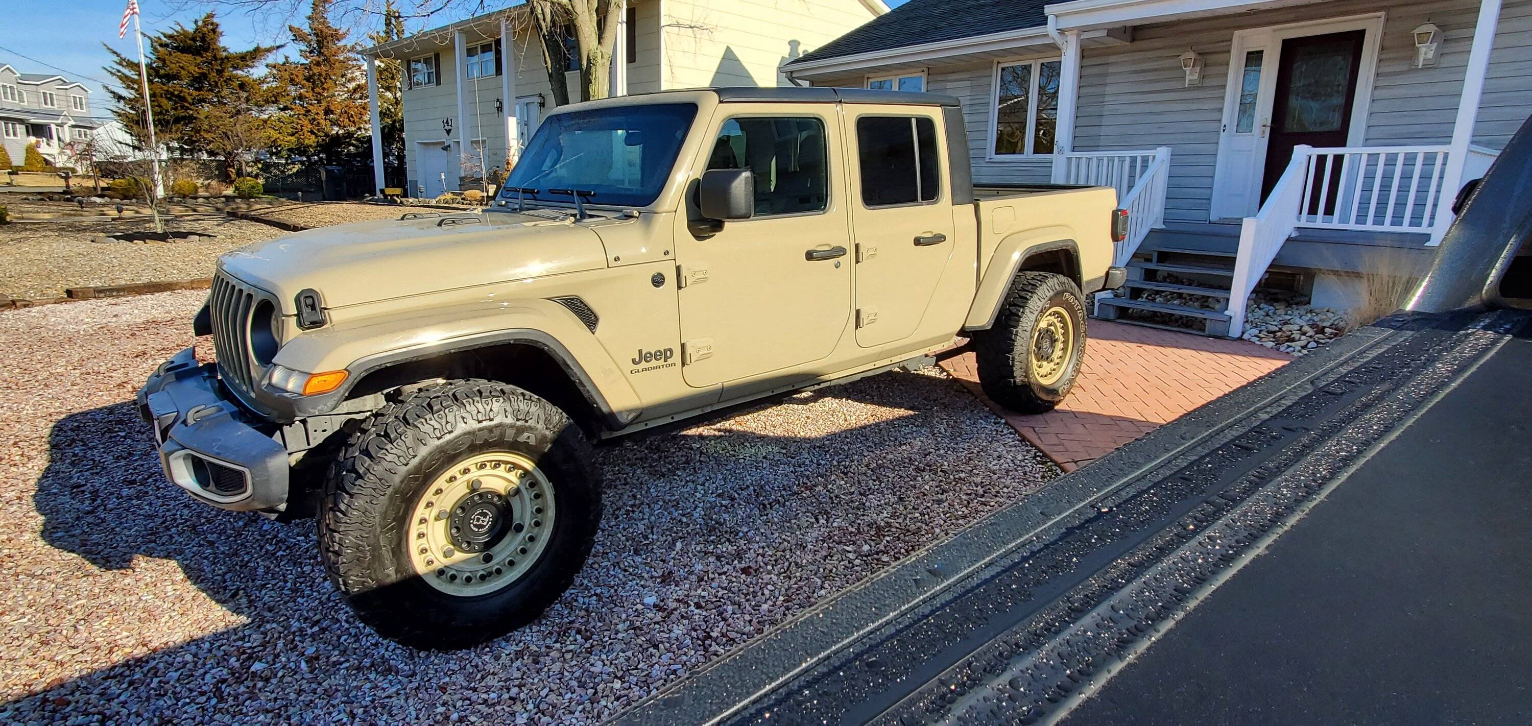

I love the way my truck looks, the wheels where what caught my eye and made the whole look of the truck.
But the wheels stick out too much...
Currently I have Black Rhino Armory 17x9.5, ET-18 with 35x12.5.
They make the same wheel 17x8, ET30. I am wondering if they will fit my truck with the same 35x12.5 tires without problems.
My truck is leveled but not lifted (yet).
Anyone know if the 17x8, ET30 with 35x12.5 will rub?

I prefer arounnd a 0 offset. They do stick out, but minimal maybe 1.5". My new black rhinos are a 0. And I had the equivalent on my stock wheels which were a +44, so I ran a 1.75" spacer which was the equivalent of a 0. Which is why I chose to stay in that area when buying my new wheels just ditched the spacers.
Not a fan of a major major negative offset or a high positive offset personally. Black rhino has a bunch of new wheel options starting the year off right, unless your dead set on the Armory's. Loving my new Barrages on a 0 offset
But if you're set on that much of a positive offset I believe you should be fine to answer your question.

This particular wheel only comes in 17x9.5, ET-18 and 17x8, ET30. I want to stck with this wheel. My truck reminds me of the Humeers I would ride in when I was in the Corps...

Definitely a nice wheel and I agree at one point considered them myself. Black Rhino has dropped a new wheel each month for 2023. All look amazing too. killing the wheel game lately on these new releases in my opinion. The Atlas in January, the Barrage (ones I have) in February, and the Alpha in March now.
