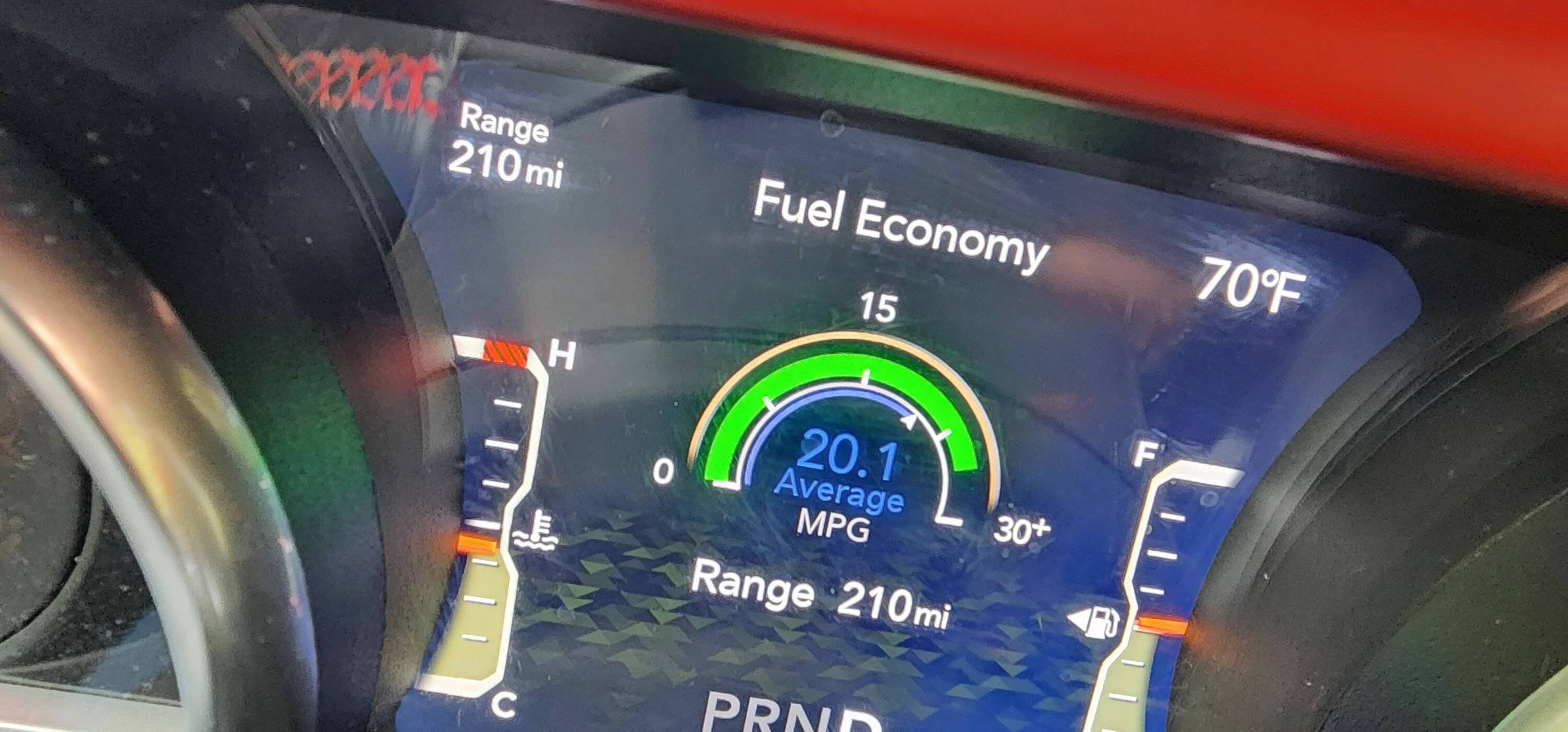

Got the extra half quart in, only difference that is measurable is the oil pressure now sits at 30 on idle as opposed 27 but I know that means nothing in the grand scheme of oiling the engine.
That isn't going to change oil pressure because the pressure depends on the pump pushing a volume against a resistance. You can't add or remove oil and change oil pressure at idle. Consider it a fluke, unrelated to 1/2 quart of oil in the pan.
In other words - 5 quarts vs. 6 quarts vs. 4 quarts - no difference in pressure - the only time it could matter is if you are getting the engine hot enough that the oil temperature is getting high and the viscosity drops. Can't see 1/2 quart making a big difference in oil temperatures, either. Otherwise half the vehicles in the world would be running hotter oil because that's how many aren't right at that "full" mark on the stick.
