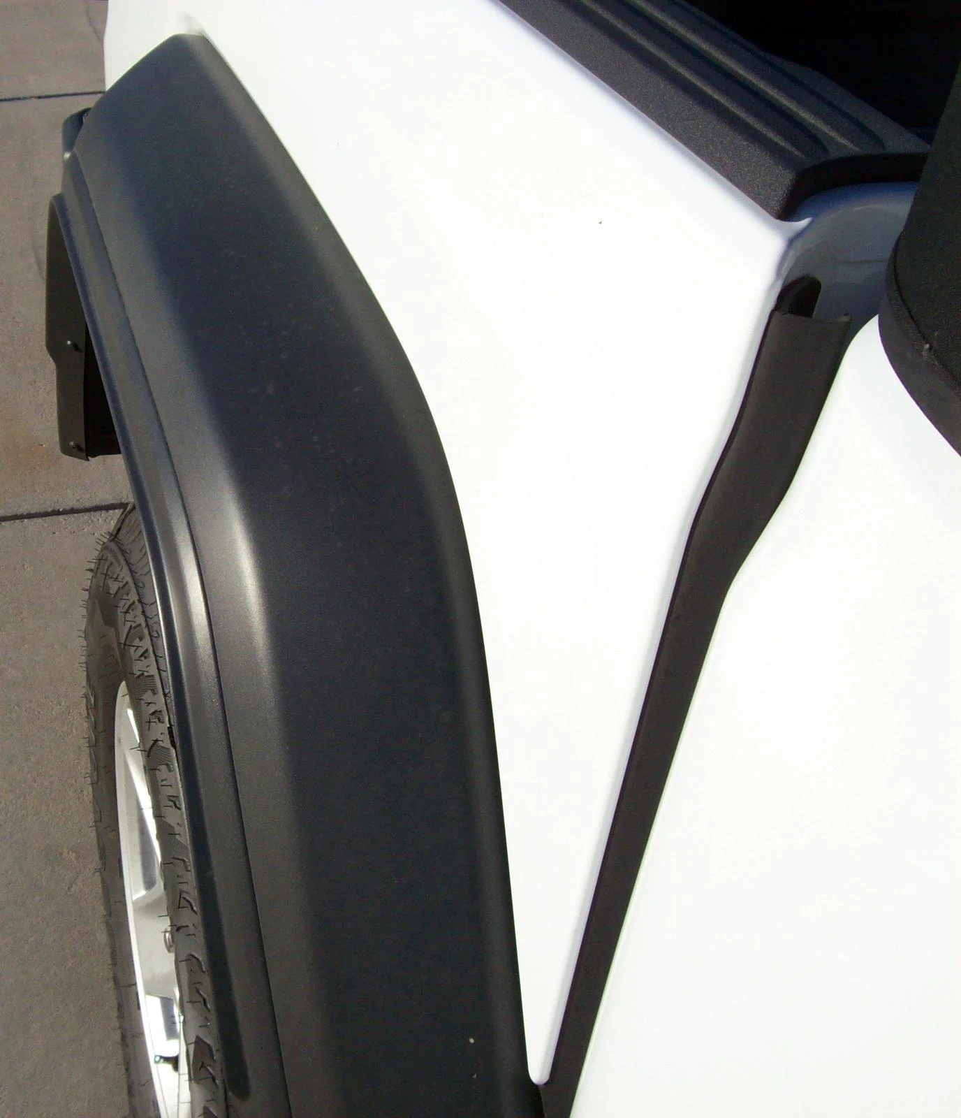

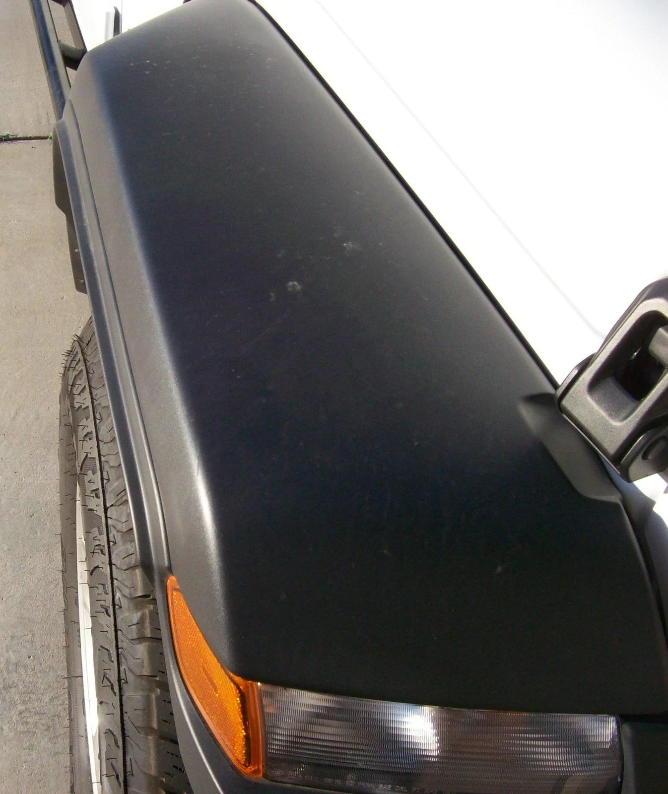

I prefer open or limited slip over a locker in snow and ice. If one wheel spins, you may not want the other spinning too, or you will slide sideways. I have done a lot of hunting with open diffs and in snow, and have found this setup to work for me. I do prefer the things the max tow option gives me. On the dealer's lot, look for the little flares sticking out of the fenders, giving another half inch or so width to the fenders.

here are photos of the front and rear max tow fenders
Jeep Gladiator Max Tow? 101_1596 (2)
Jeep Gladiator Max Tow? 101_1597 (2)
