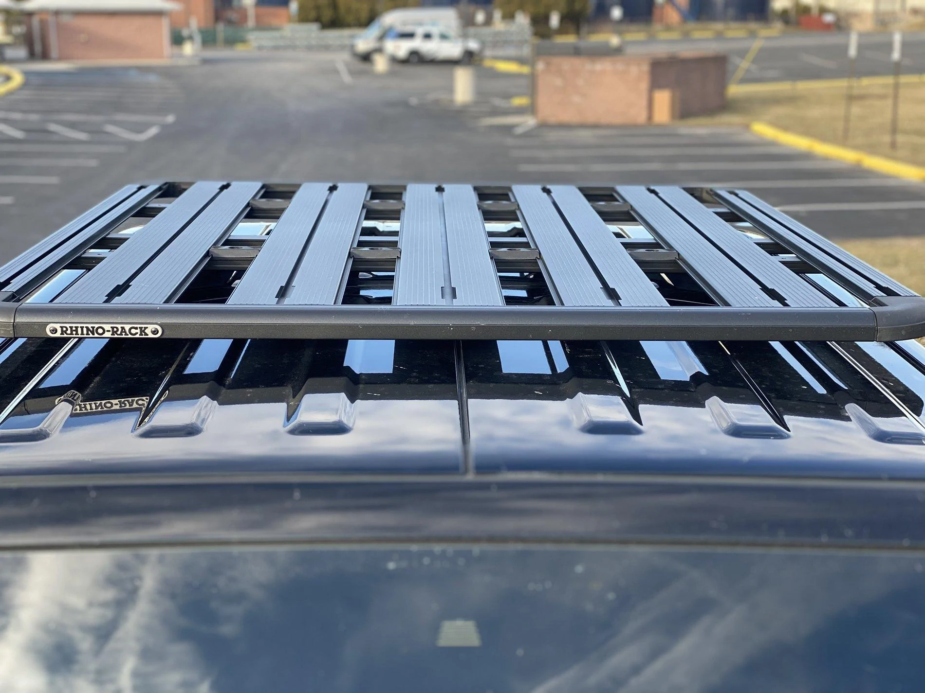

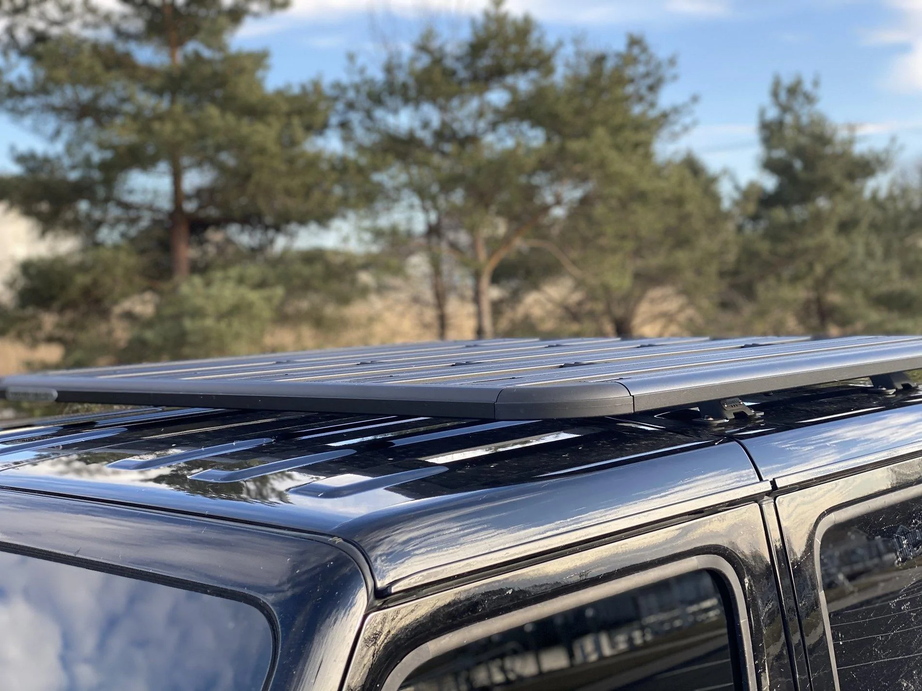

I second this request lol

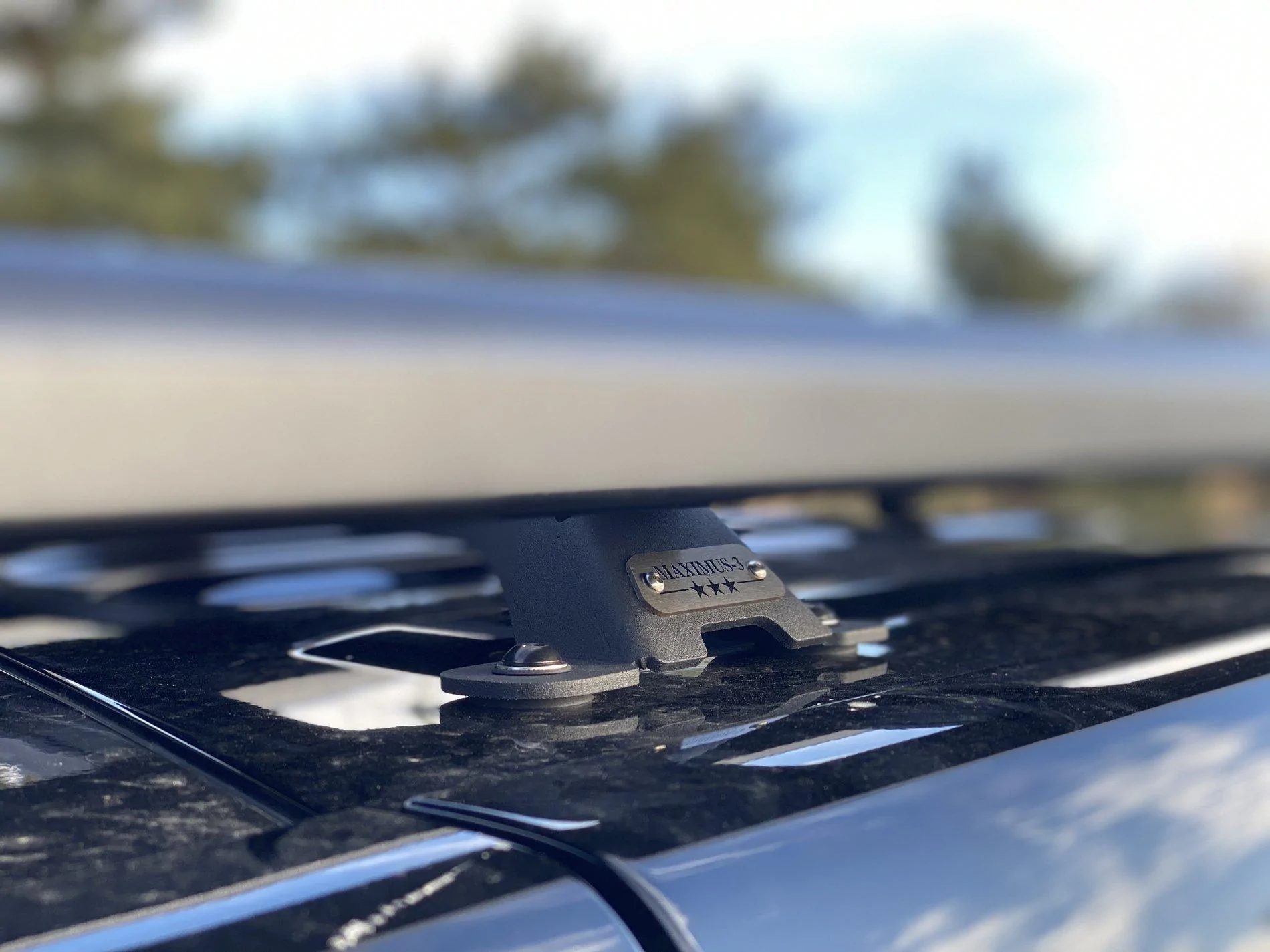

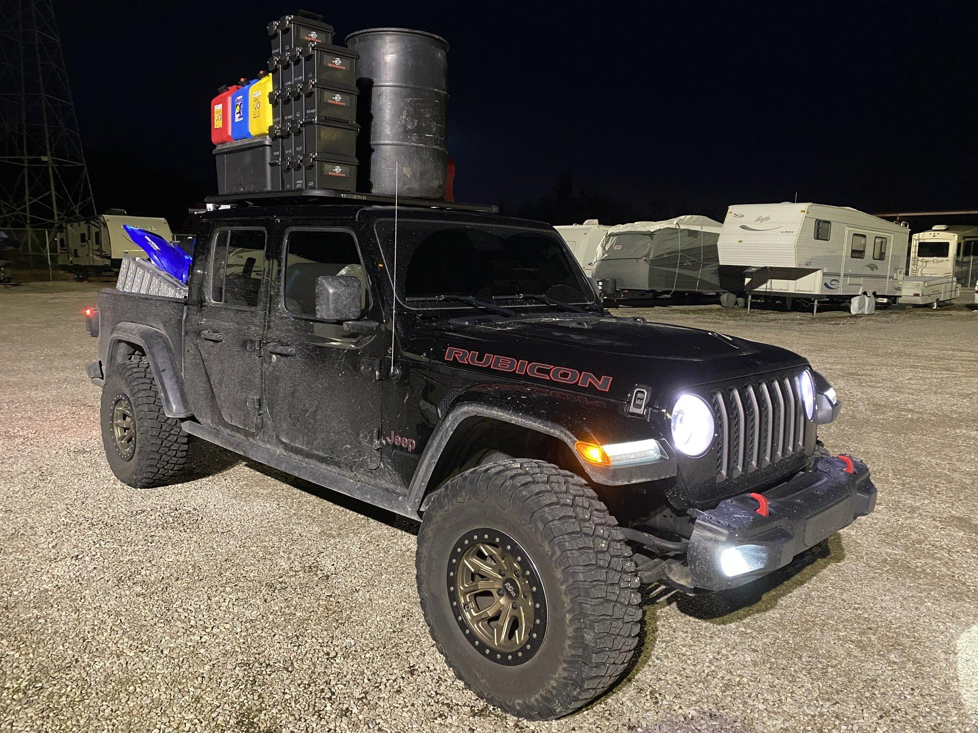

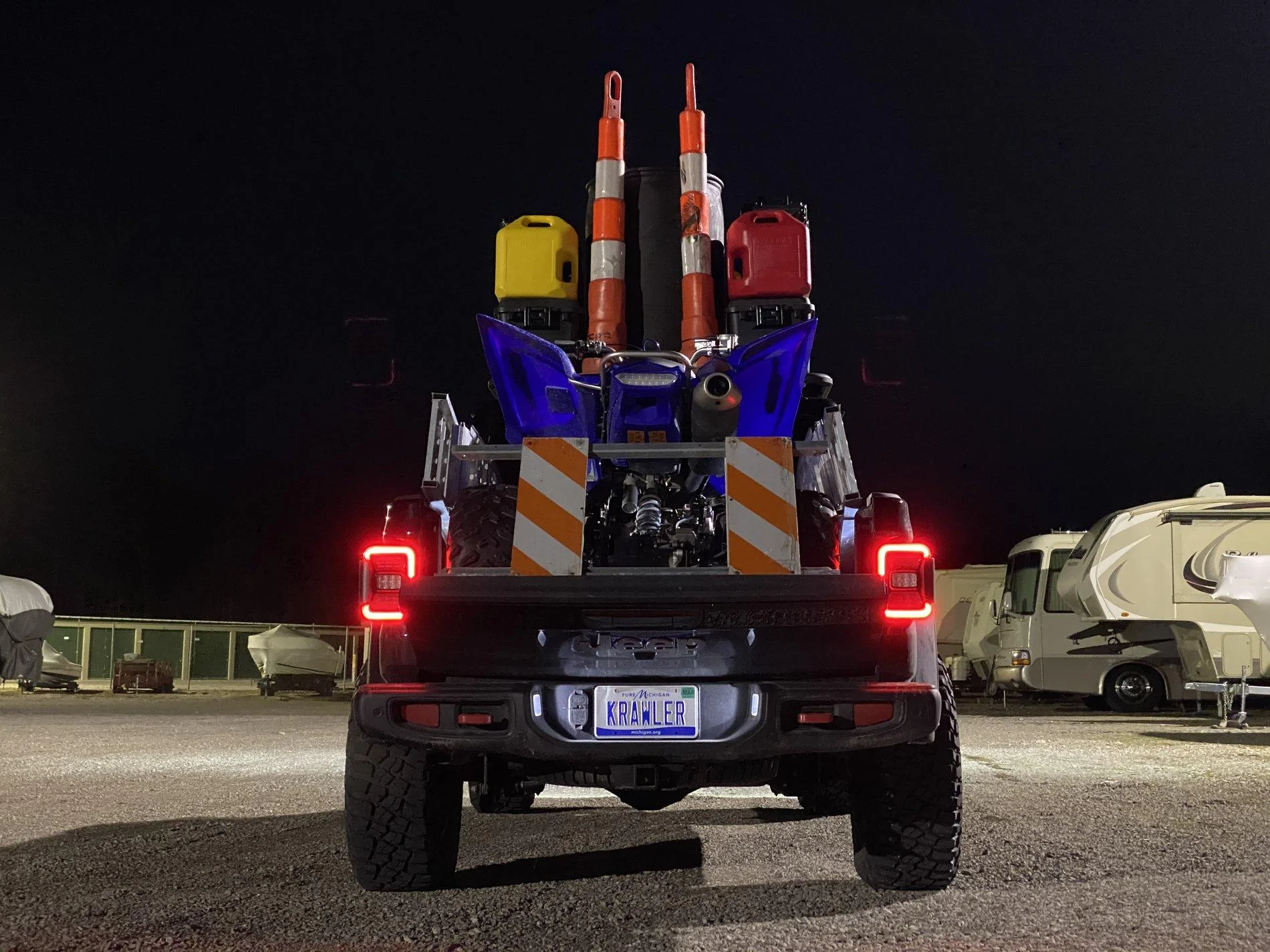

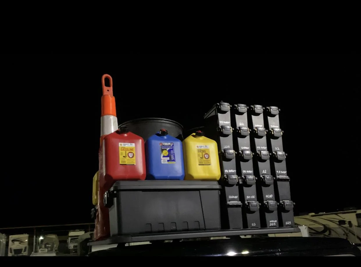

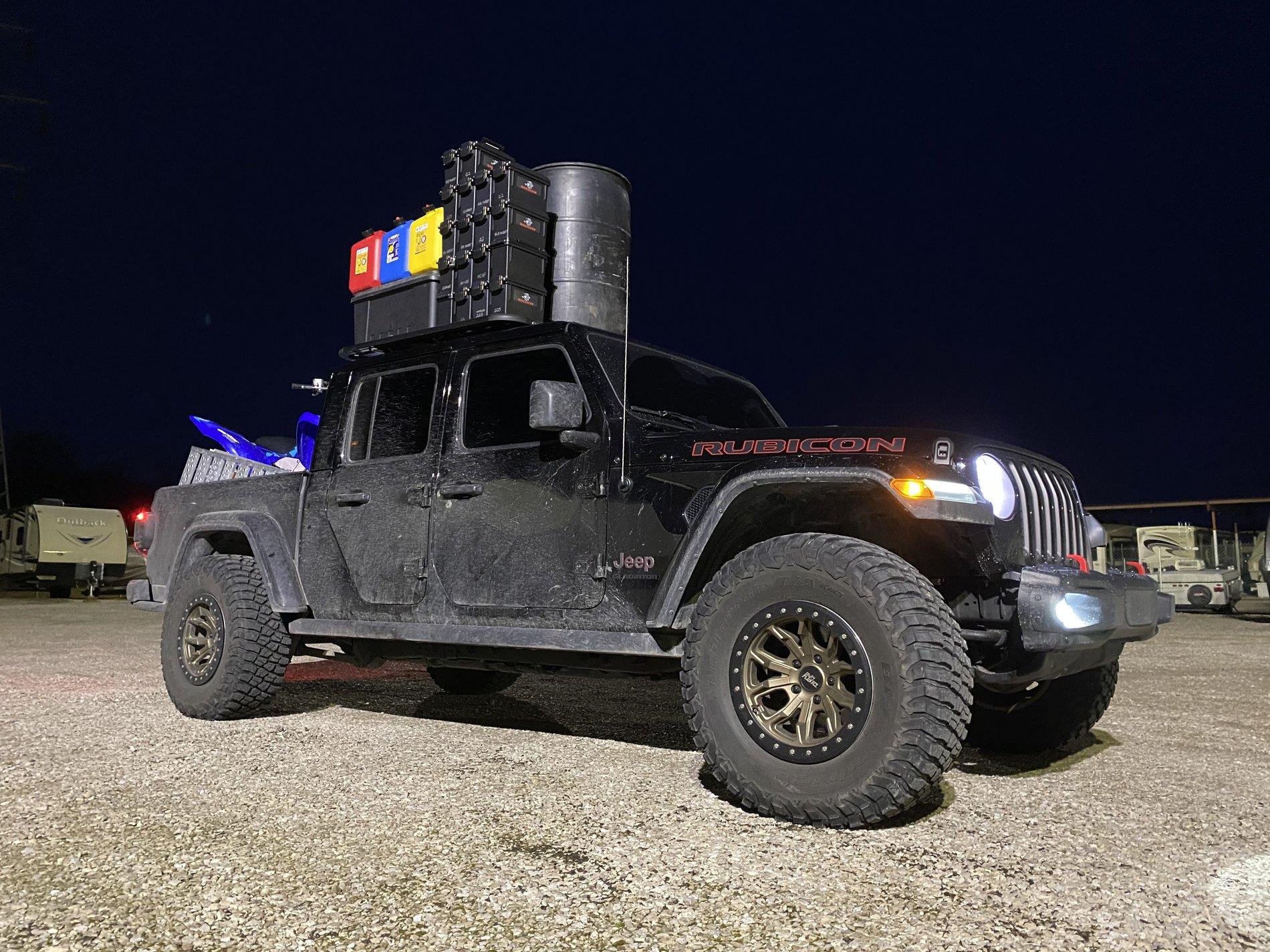

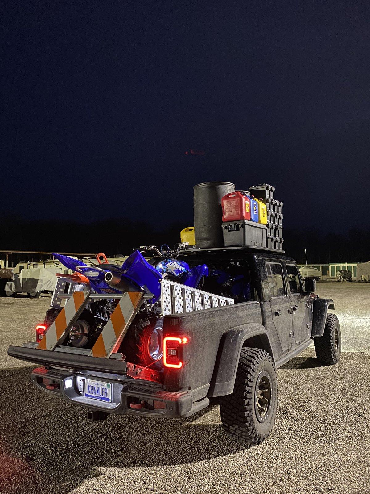

working on the full install & review videos.
it’s really dark inside so hard to see, but here’s a couple.
These are actually on their truck with no doors or roof.
I’ll try to get much better pics.
follow Gladiator Gang on YouTube for the latest content.
Jeep Gladiator MAXIMUS-3 Roof Rack STAGE ONE 01D6E9C2-14B9-4495-A3A7-E181ED53ECBC
Jeep Gladiator MAXIMUS-3 Roof Rack STAGE ONE 0E34822A-B274-4694-A8BB-90D8B1374882
Jeep Gladiator MAXIMUS-3 Roof Rack STAGE ONE C67C3CF6-6EA0-4ECA-912B-10B9C7C54504
Jeep Gladiator MAXIMUS-3 Roof Rack STAGE ONE E6FE76E8-5466-4130-A7B9-C302334E3A3F

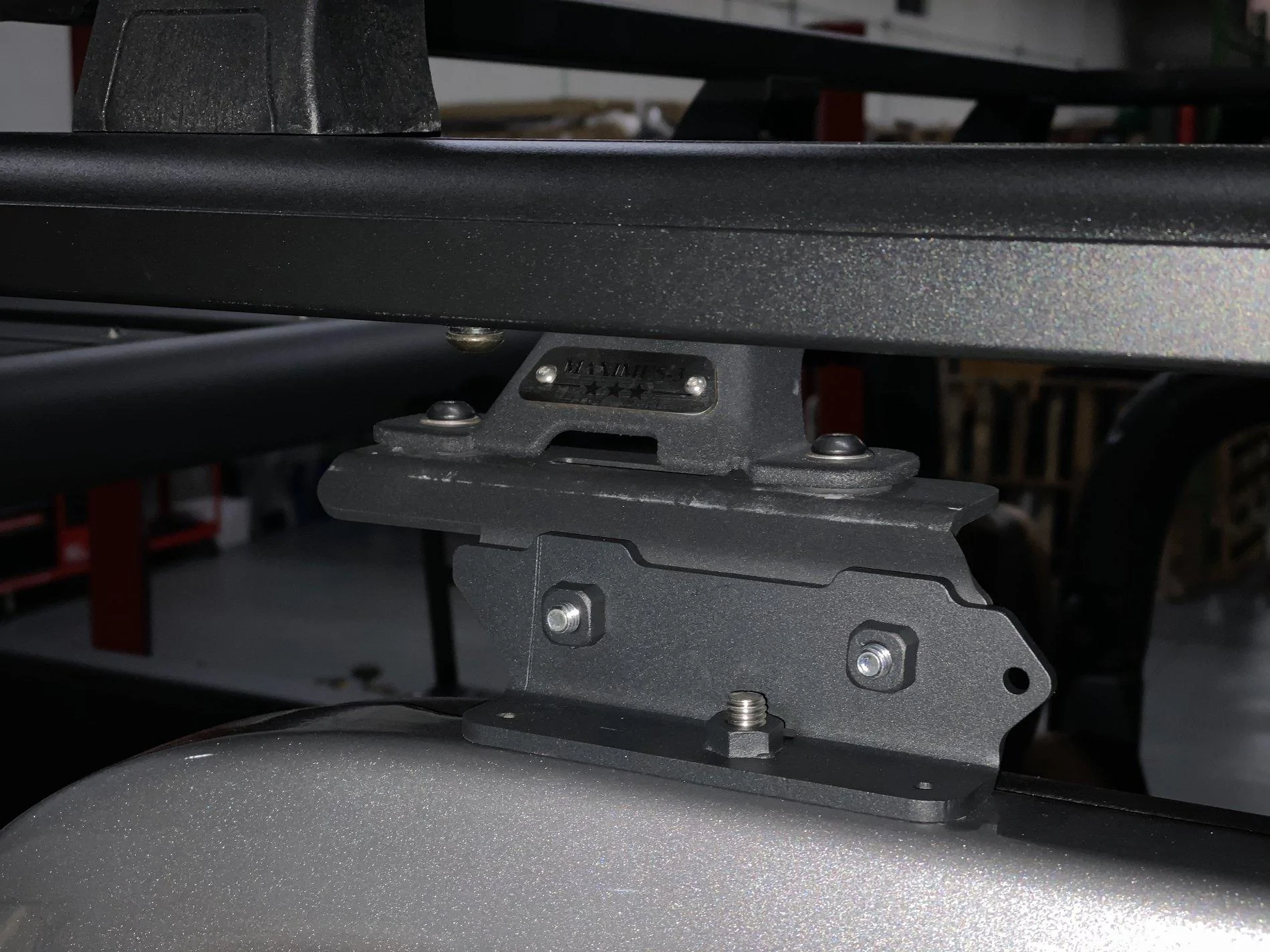

No way I'm drilling holes through my hard top. I don't need a roof rack that bad. Waiting (im)patiently on the Overland Rack, though.

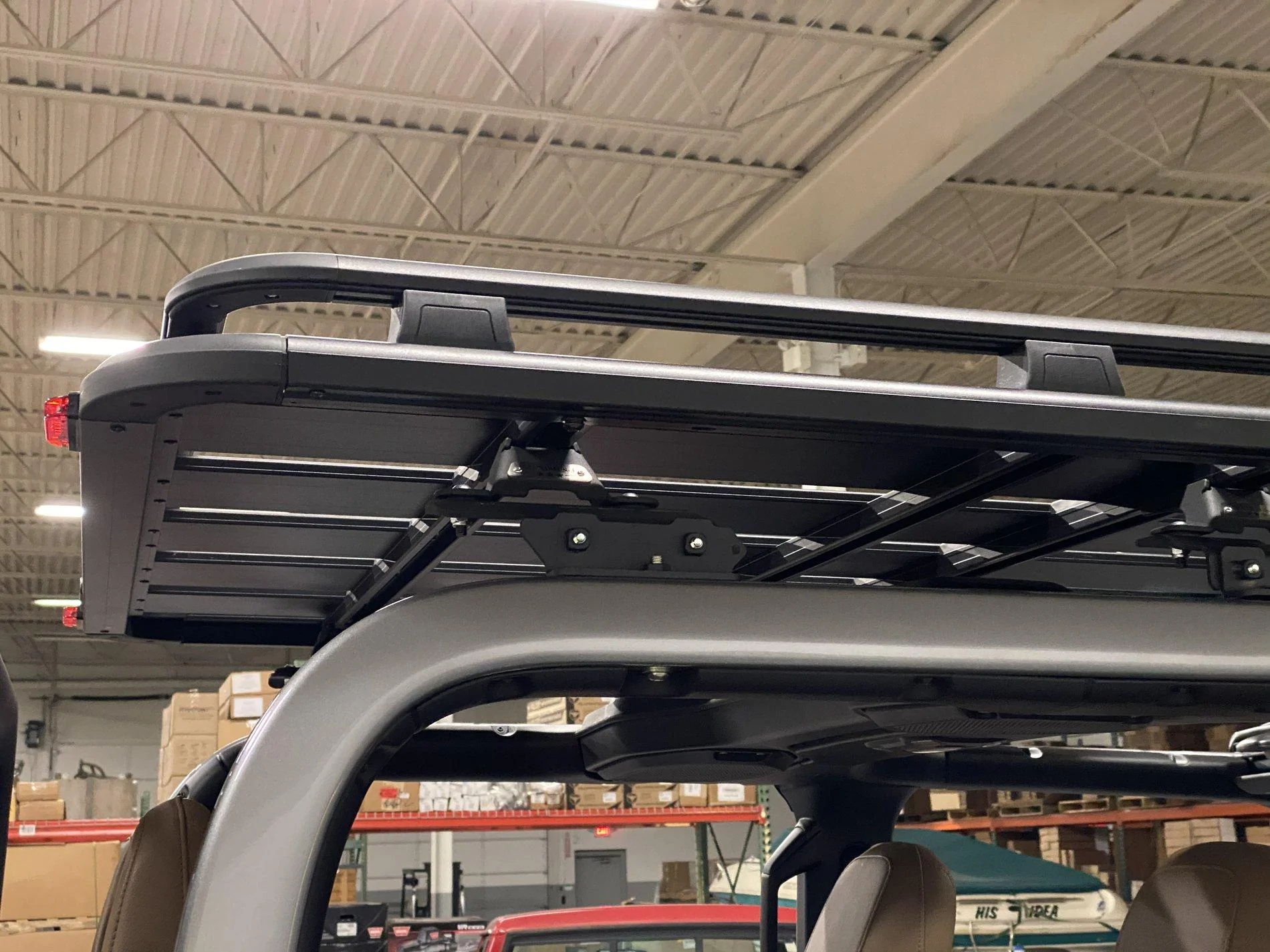

That was exactly how I felt, but they’re small holes and you can easily plug them with rubber plugs and you won’t be able to see them (too high) on the roof.
OVRLND_G8R
Cory
Jan 8, 2020
143
196
New York
2020 Jeep Gladiator Gator

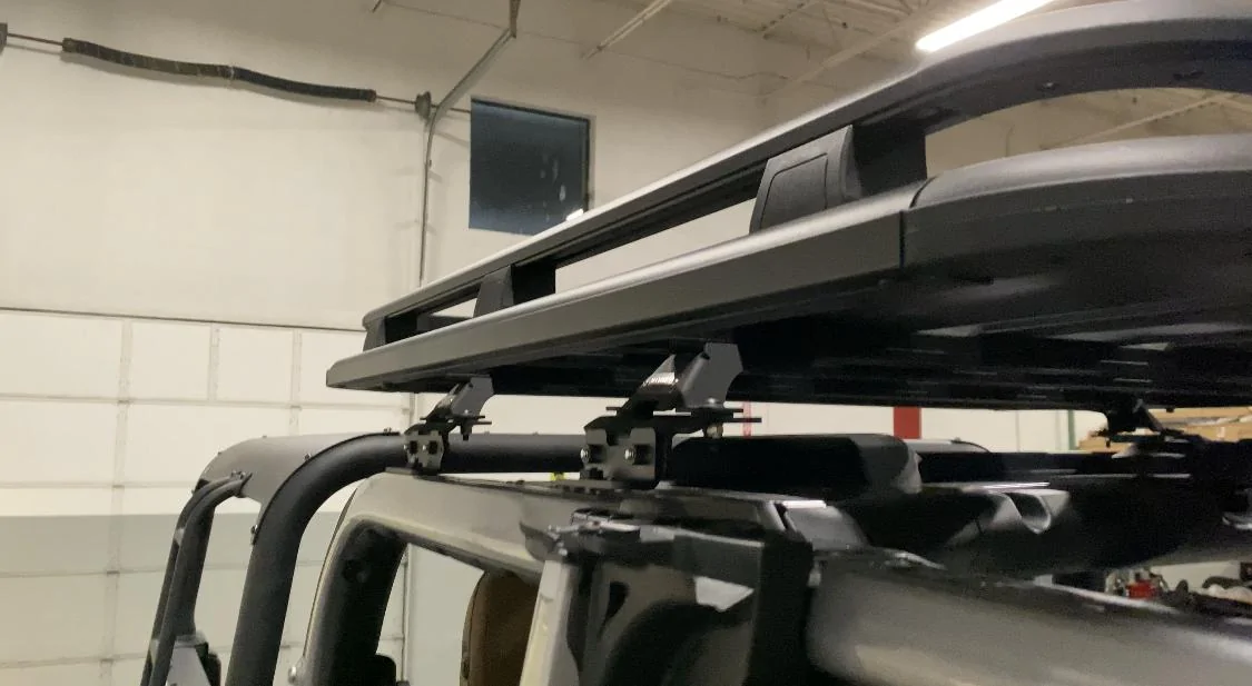

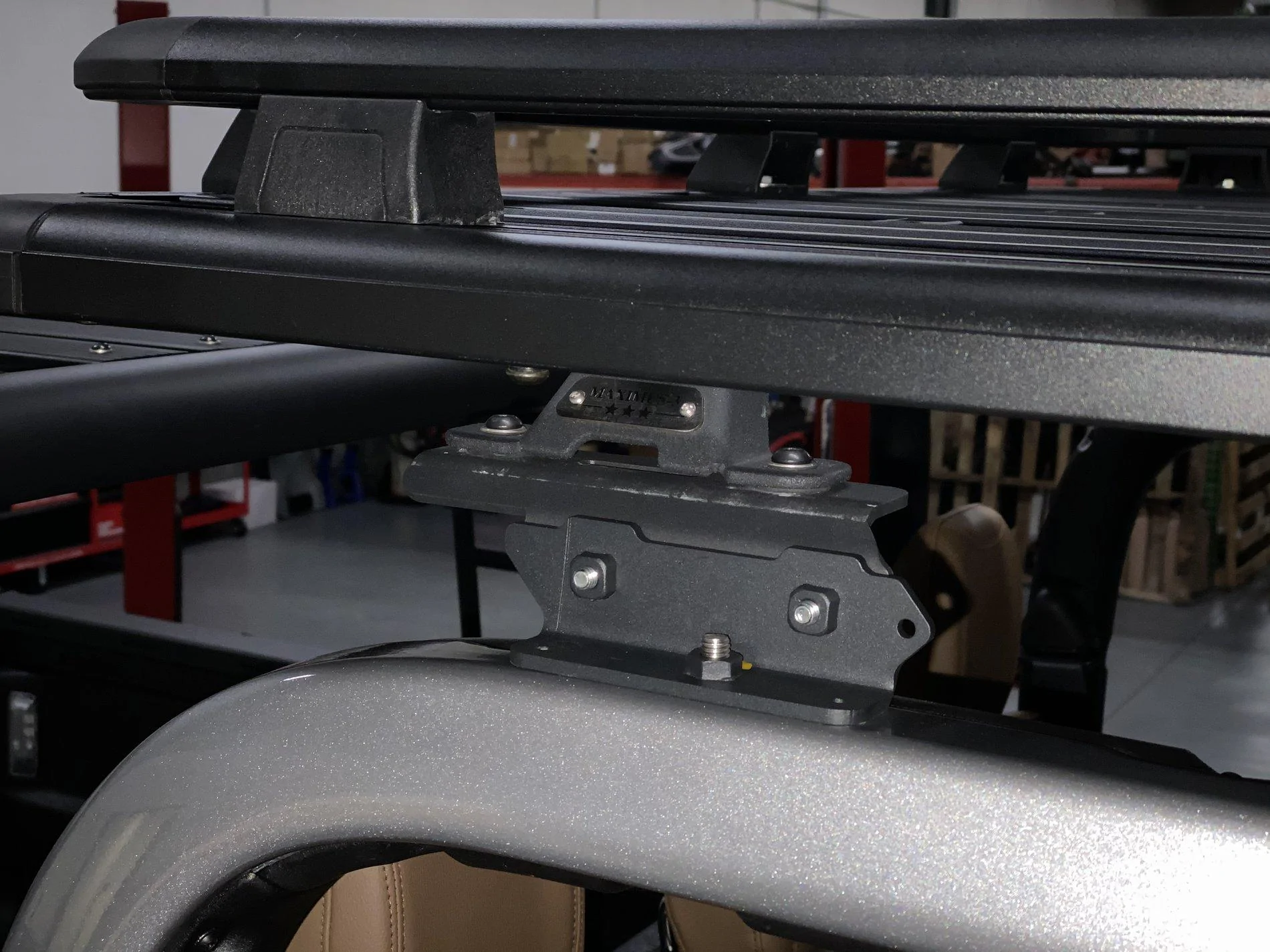

Thanks for the pictures. So each time you want to remove the roof. You need to unbolt those two screws per bracket. Pull rack off, pull roof off, then reinstall the rack. Doesn’t look too bad

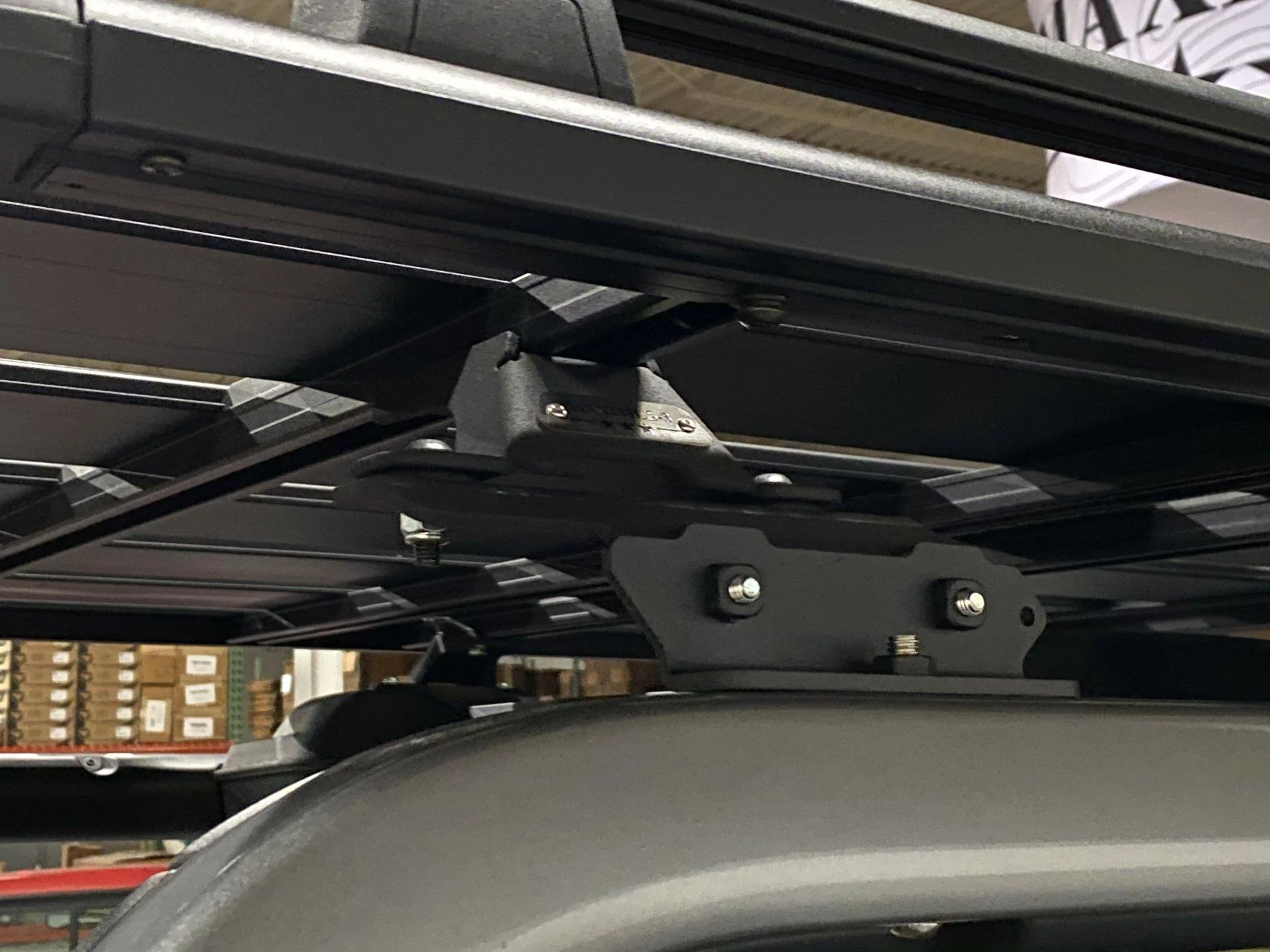

So the mounting hardware goes through the roll cage and then through the hard top to he fastened one the other side of the roof rack’s mounting point?

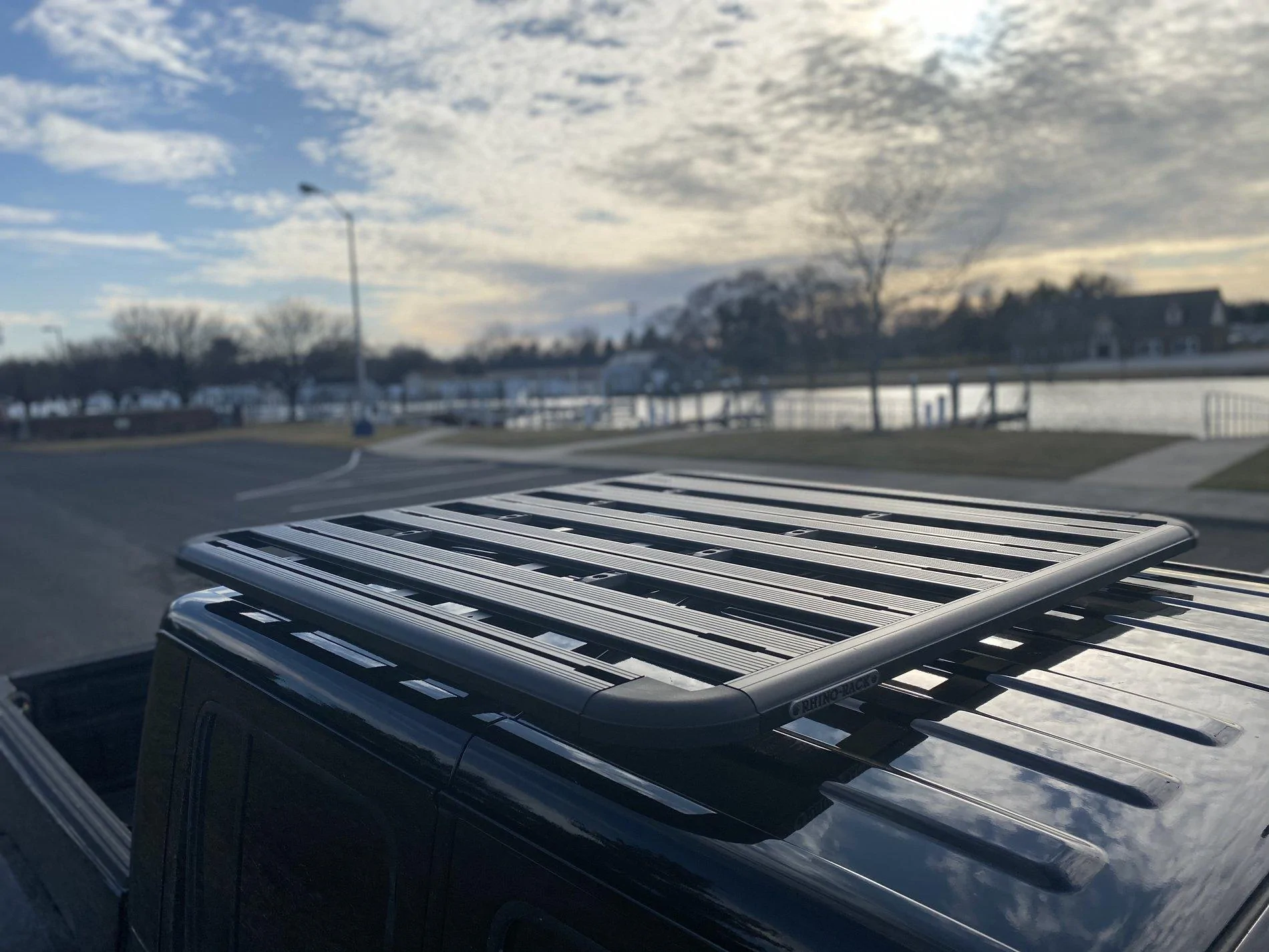

Yes, or you have the option of just removing the 4 bolts that go through the sport bar and leaving the hardtop and rack as one.
Either way, whatever works for you or your time frame.
well, the lower parts attach to your sport bar. Then the “Legs” bolt to the lower parts that are attached to the sport bar. Then the roof rack attaches to the “Legs”.
