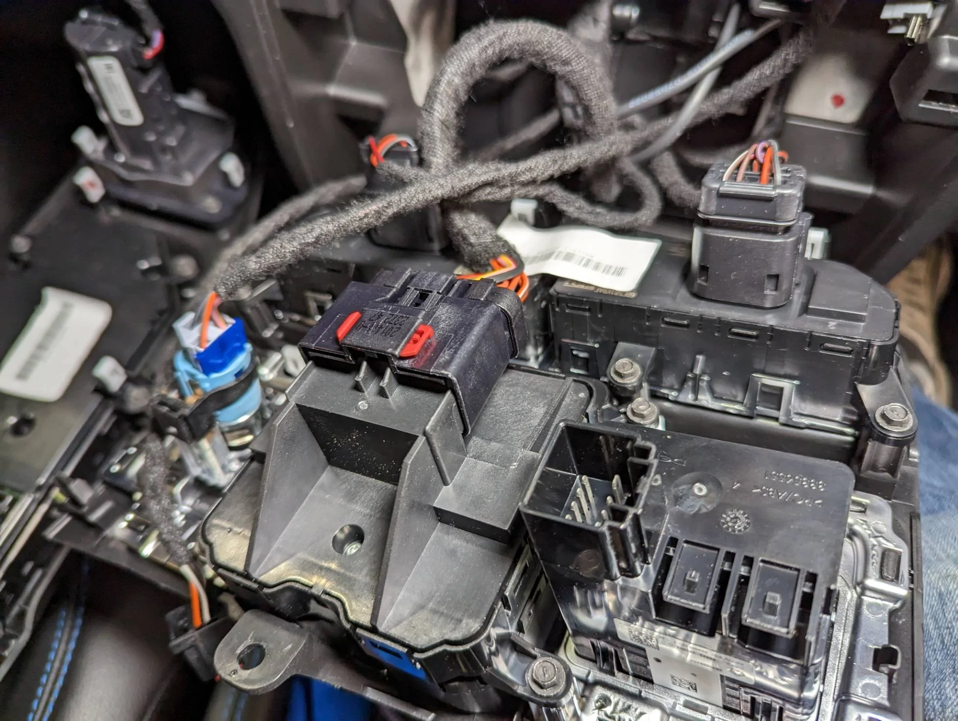

Be media hub you mean the USB ports to the right near the glove box?
That's not really the hub - that's just ports. There are cables that plug into the back of those ports.
As far as swapping, I've had the things all apart and I see no way to swap things around even semi-easily.
the #1 USB port there is how the radio is updated when new software updates come out.
The blue is the 12v outlet.
Big cable in the middle is for the window switches (with the red latch on the connector)
What is disconnected is the USB ports, etc. The other connector that is in the upper right in the photo the way the photo is showing is the aux switches.
Appreciate the picture, that is helpful.
