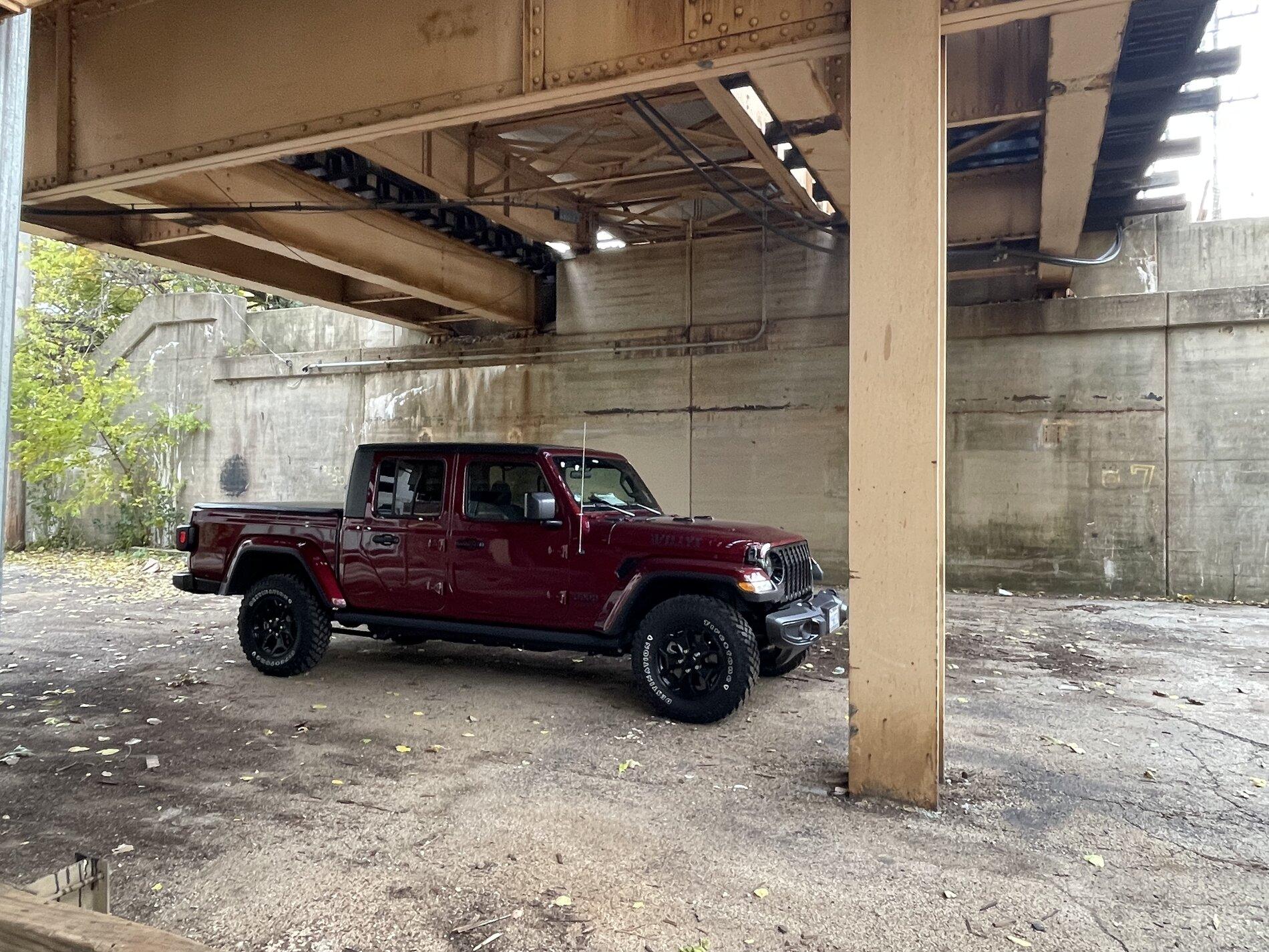

Has anyone done a Mojave takeoff suspension on their sport s? I picked up a 2021 snazberry Willy’s and came across a Mojave take off for sale. He has take offs for Rubicon suspension as well but I’m leaning towards the Mojave suspension. He has the shocks and springs and was wondering if there was anything else needed like the lower control arms or upper control arms, Spring isolators or sway bar links? Has anyone done the swap on their gladiator?

No on the control arms although throwing on the Mopar lower control arms would be a cheap improvement to caster. The sway bar links I'm not sure, check parts to see if Mojave has a different part number on those.
You will need to I believe drill out the mounts for the shocks though as they take a different size.

Any updates? What kind of lift did you see with the springs
I never ended up going with it still deciding what to do I’m leaning towards a Clayton kit with fox shocks
