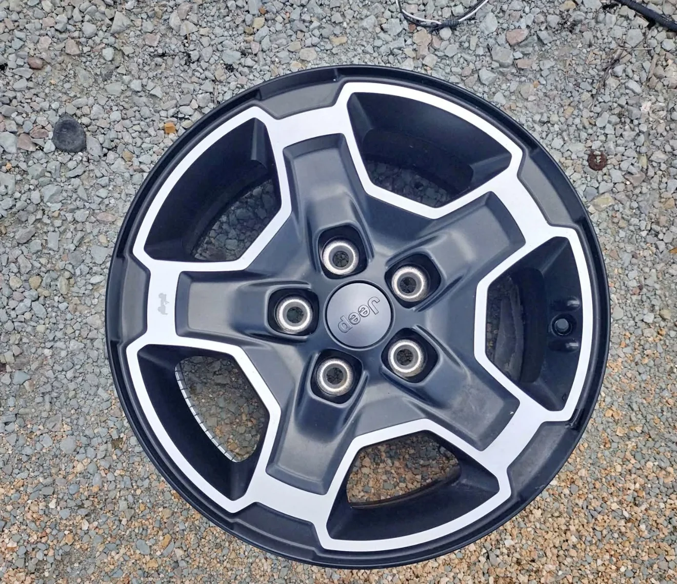

I just got some Mojave wheels. I know a 285 will not rub. My question is will 295 or a 305 rub the lower control arm. I’ve looked and most of what I’ve seen are after market wheels. Any help would be greatly appreciated.

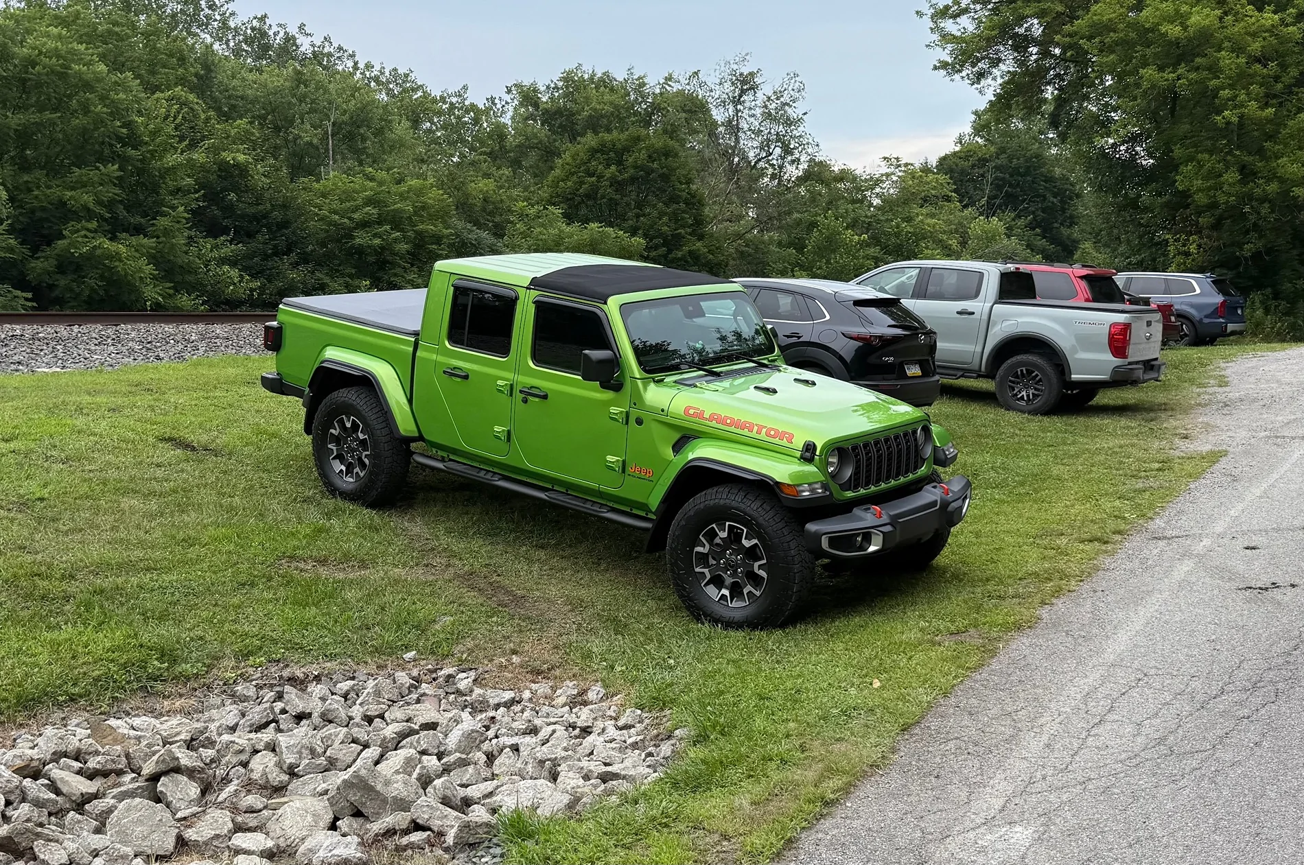

I think you should be fine, I also think you go 285/75 , I am running 35x11.50x18 on my sport s mine does have the max tow package on it. I have the 1.5 TeraFlex kit on mine.

yeah. I don’t have the max tow. I have narrower axles. That’s my concern. That extra little bit can cause rubbing. I went through that with my 2012.
