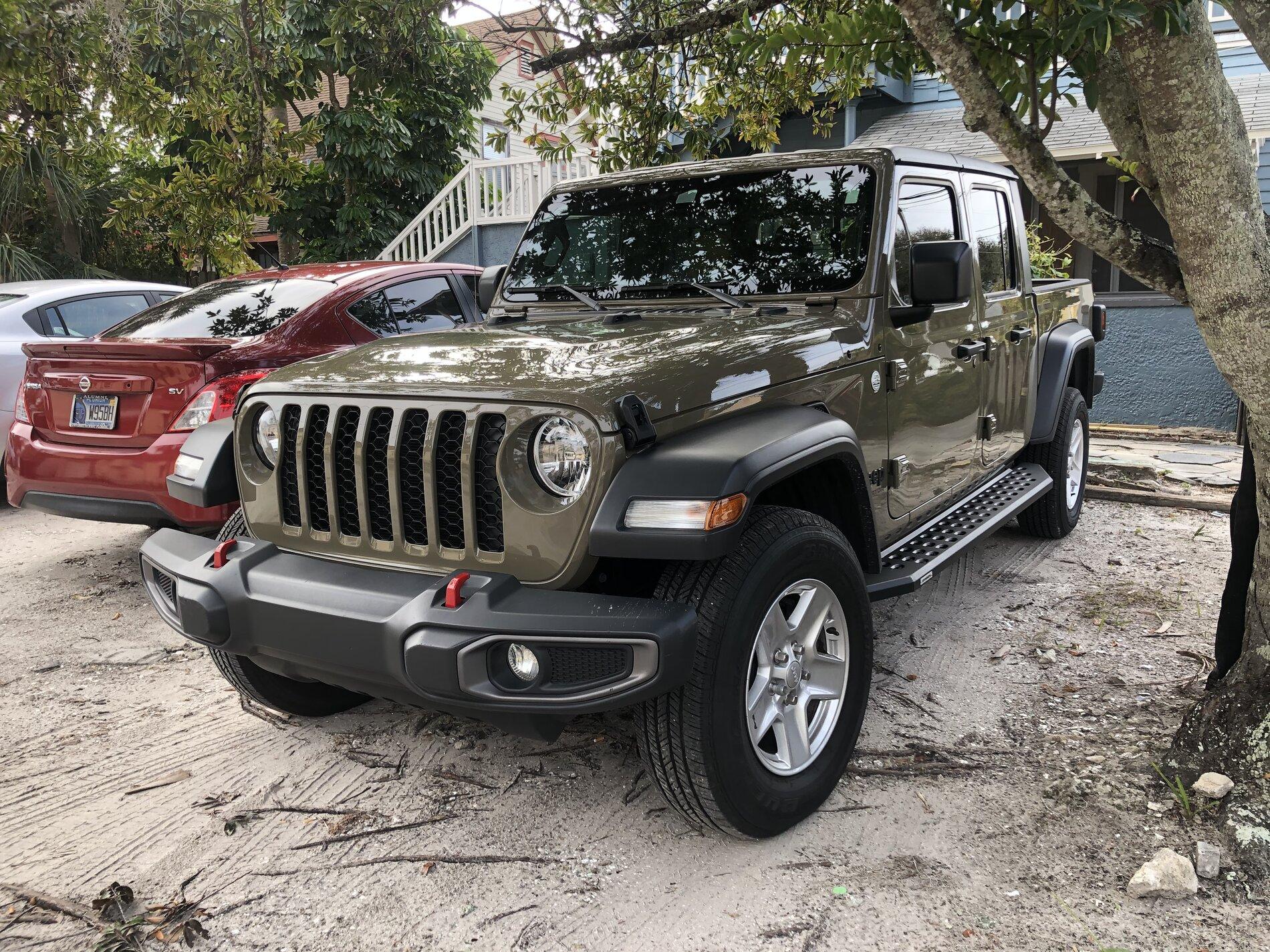

Hello peeps, this is my first post. I just got a 2020 Gladiator Sport two nights ago. So what I am reading is that the Mojave wheels have an offset. Would Mojave wheels work on a sport model gladiator and if so. What size tires could I get with no lift/no body mods. Thank your for your time and experience!

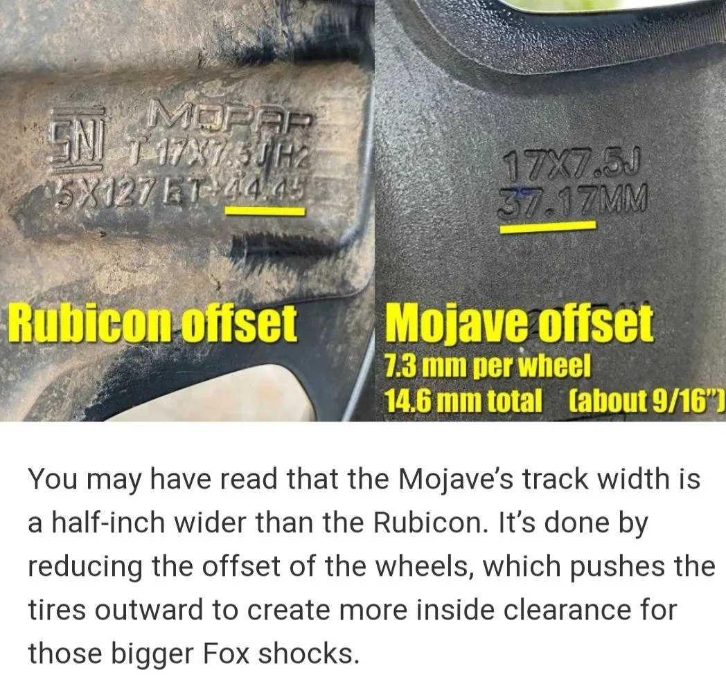

Thanks guys. So the Mojave has an offset. Due to not truly understanding wheels and offset. How much further would the Mojave wheels stick out compared to stock.
.29"
