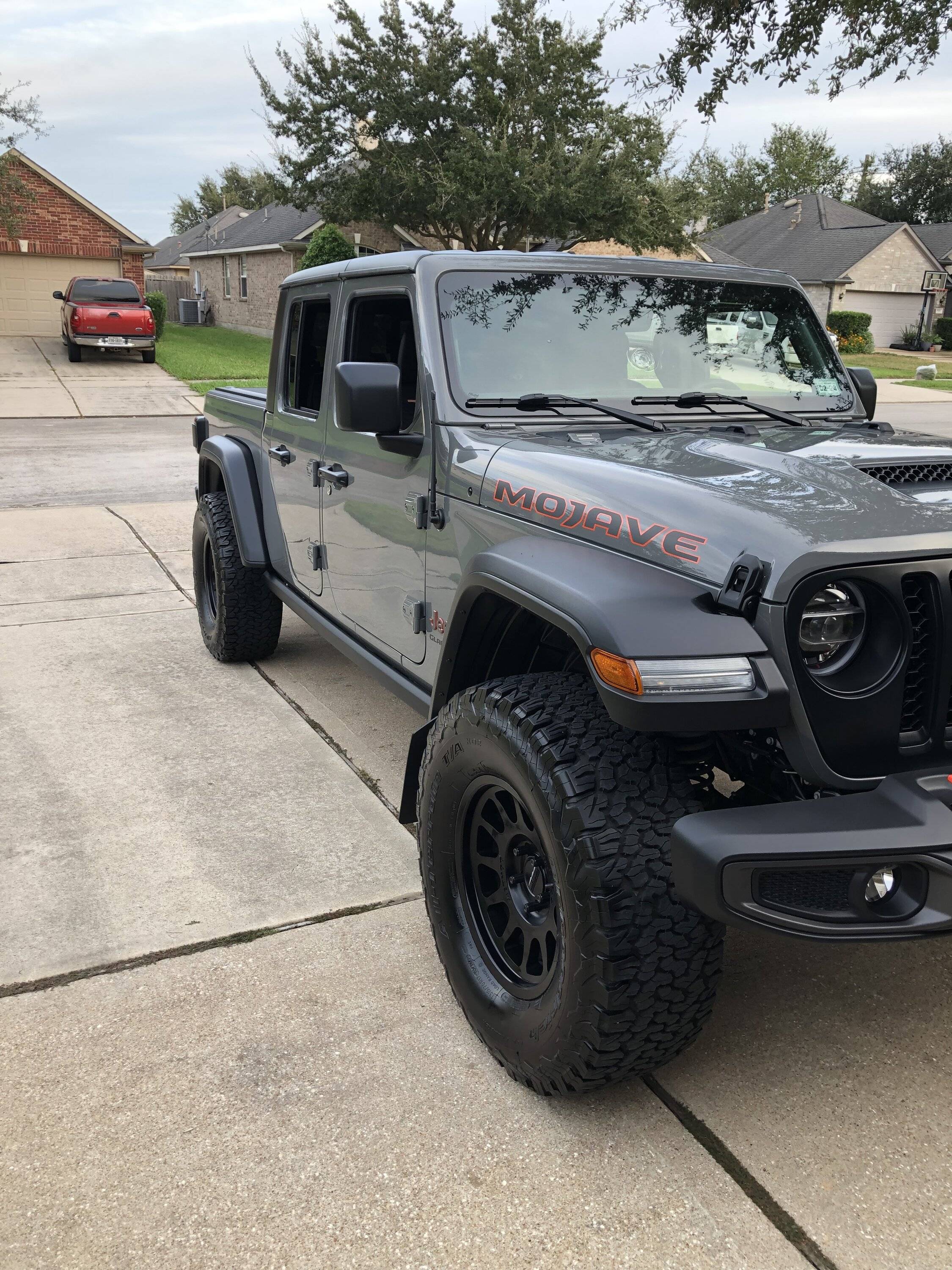

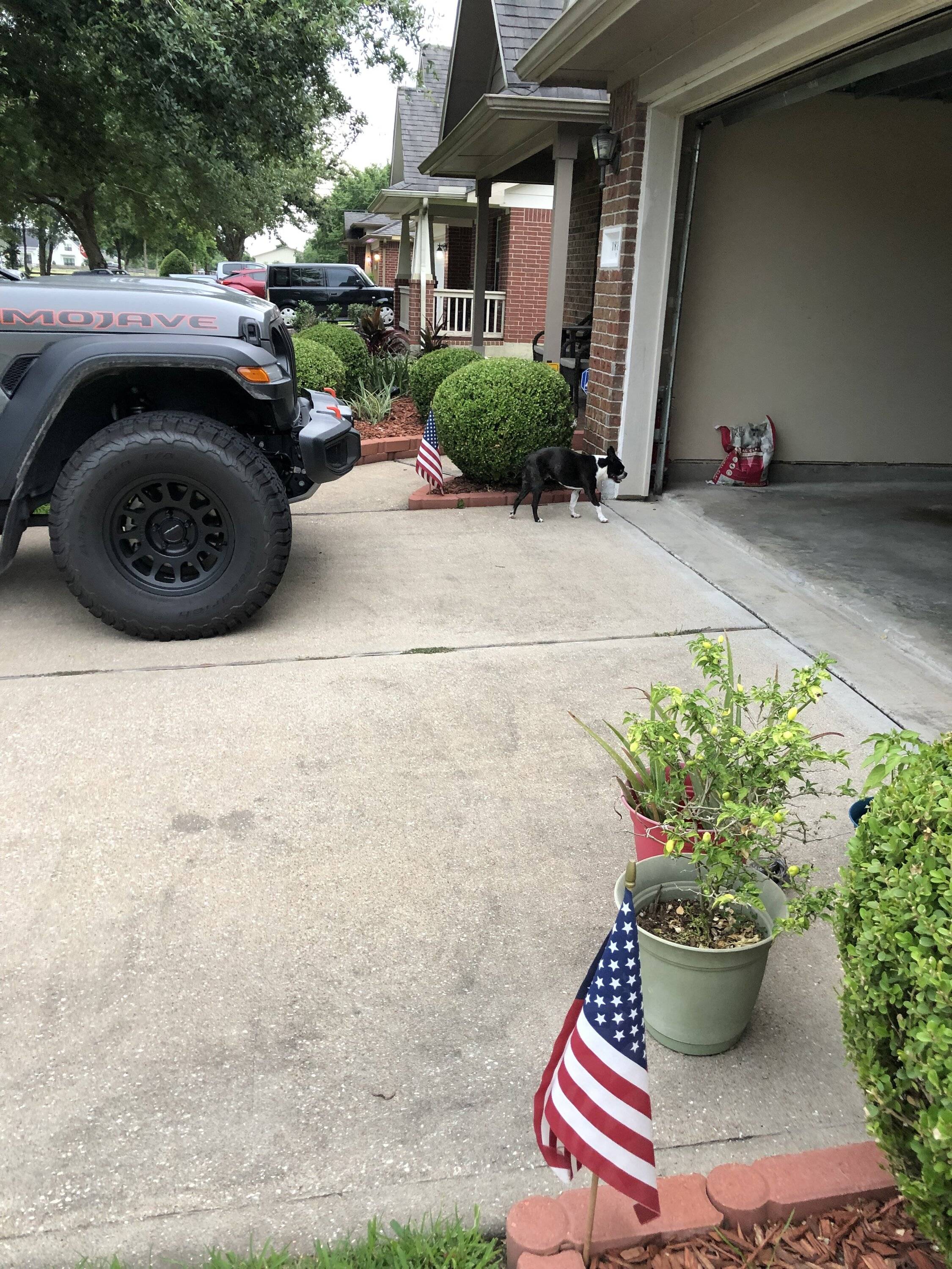

17x8.5 Method 703 with zero offset and 35x 12.5’s for reference on stock height Mojave

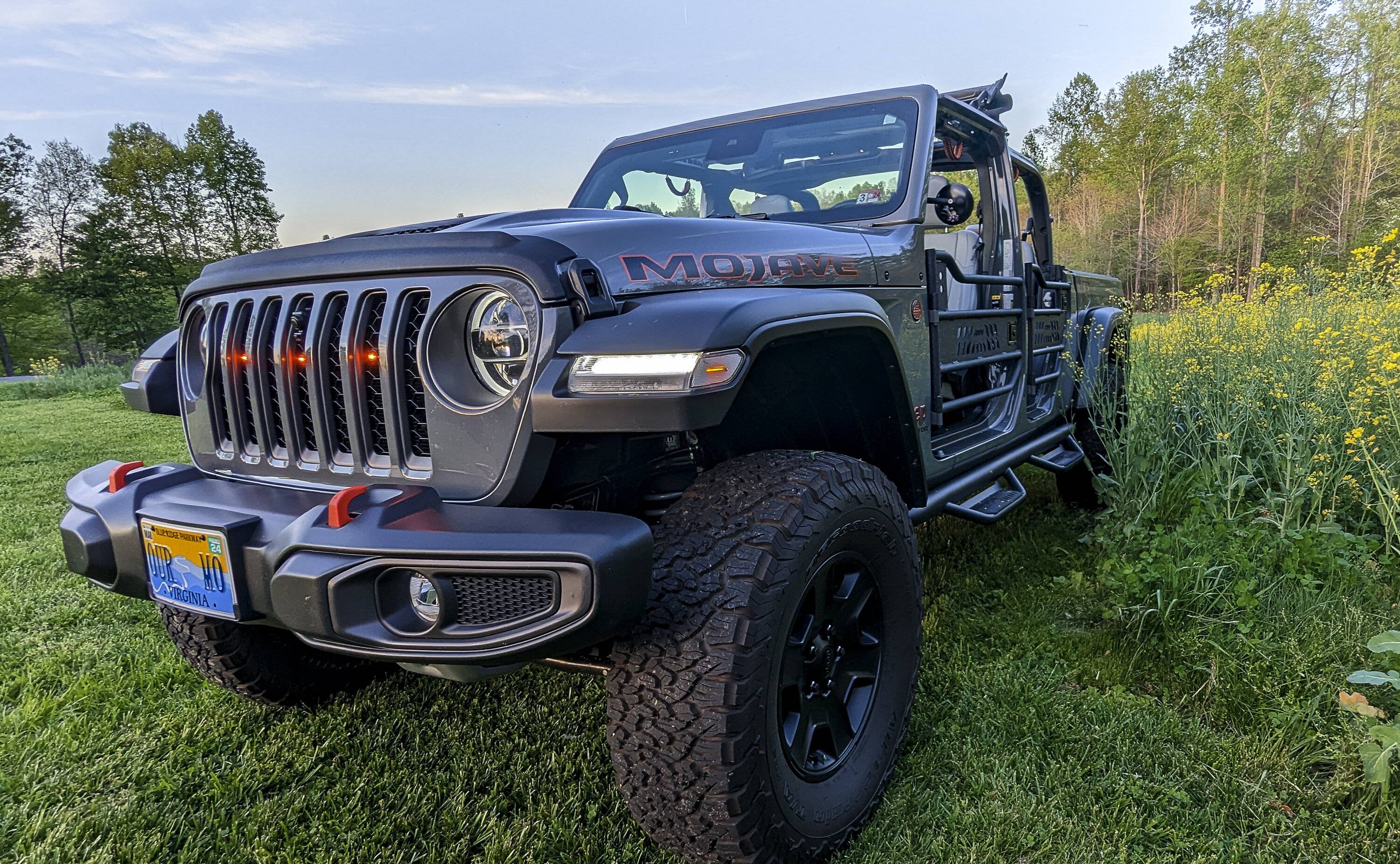

If you don’t want as much poke or want to keep it as close to stock, kmc has some nice wheels with +18 offset

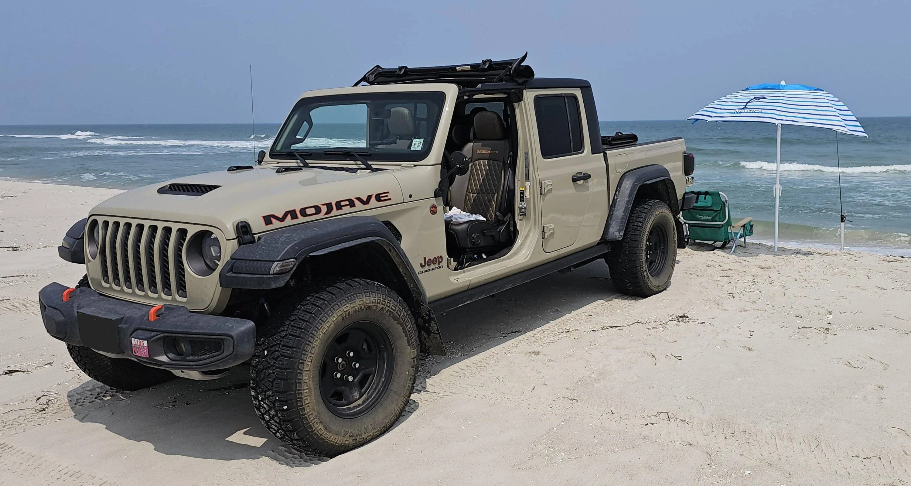

17x9@+6 with 315/70r17s. I wasn't a huge fan of the excess poke so i covered them up with XR fender flare extensions

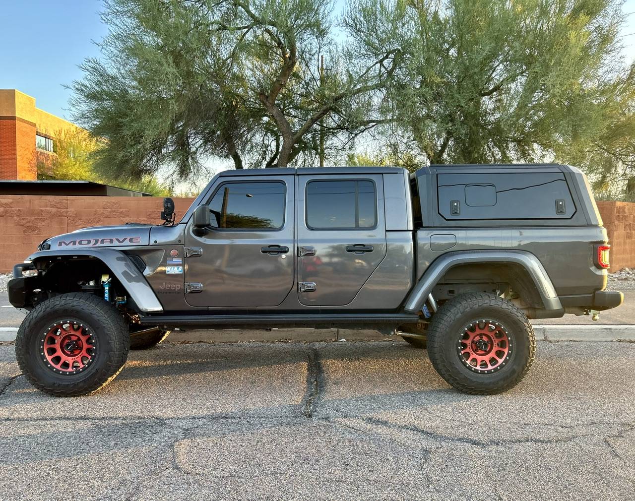

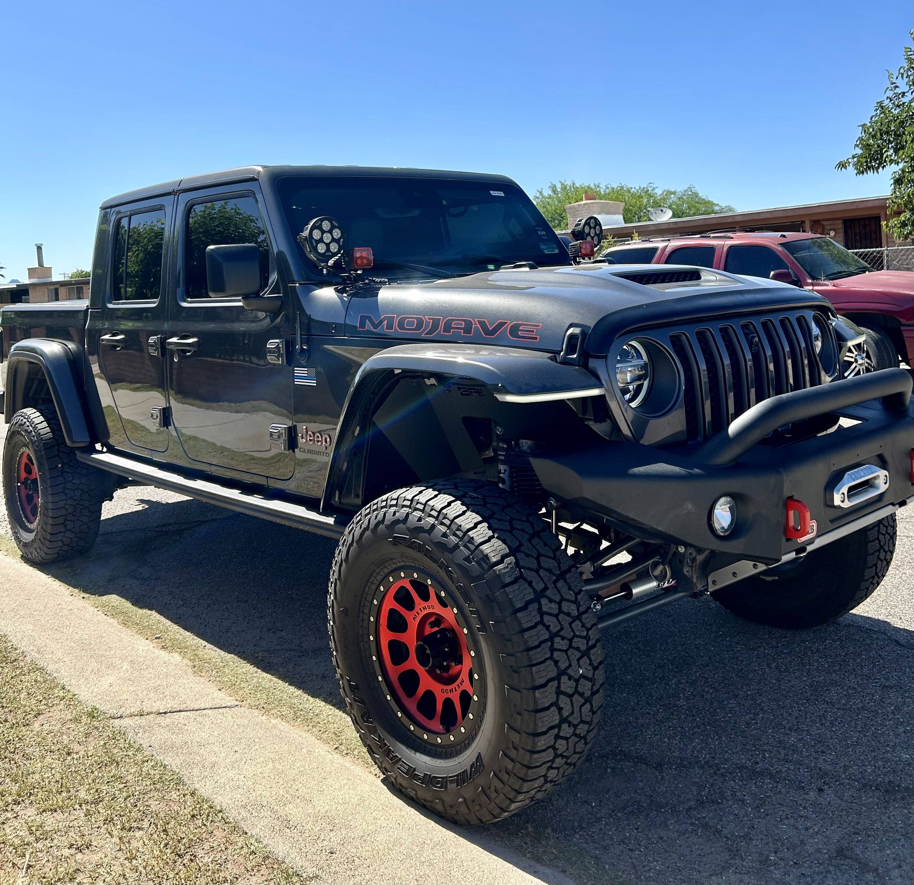

3.5 Metalcloak Lift + 0 Offset, 4.75 BS. Method NV305 Limited Edition, 35s :jk:
