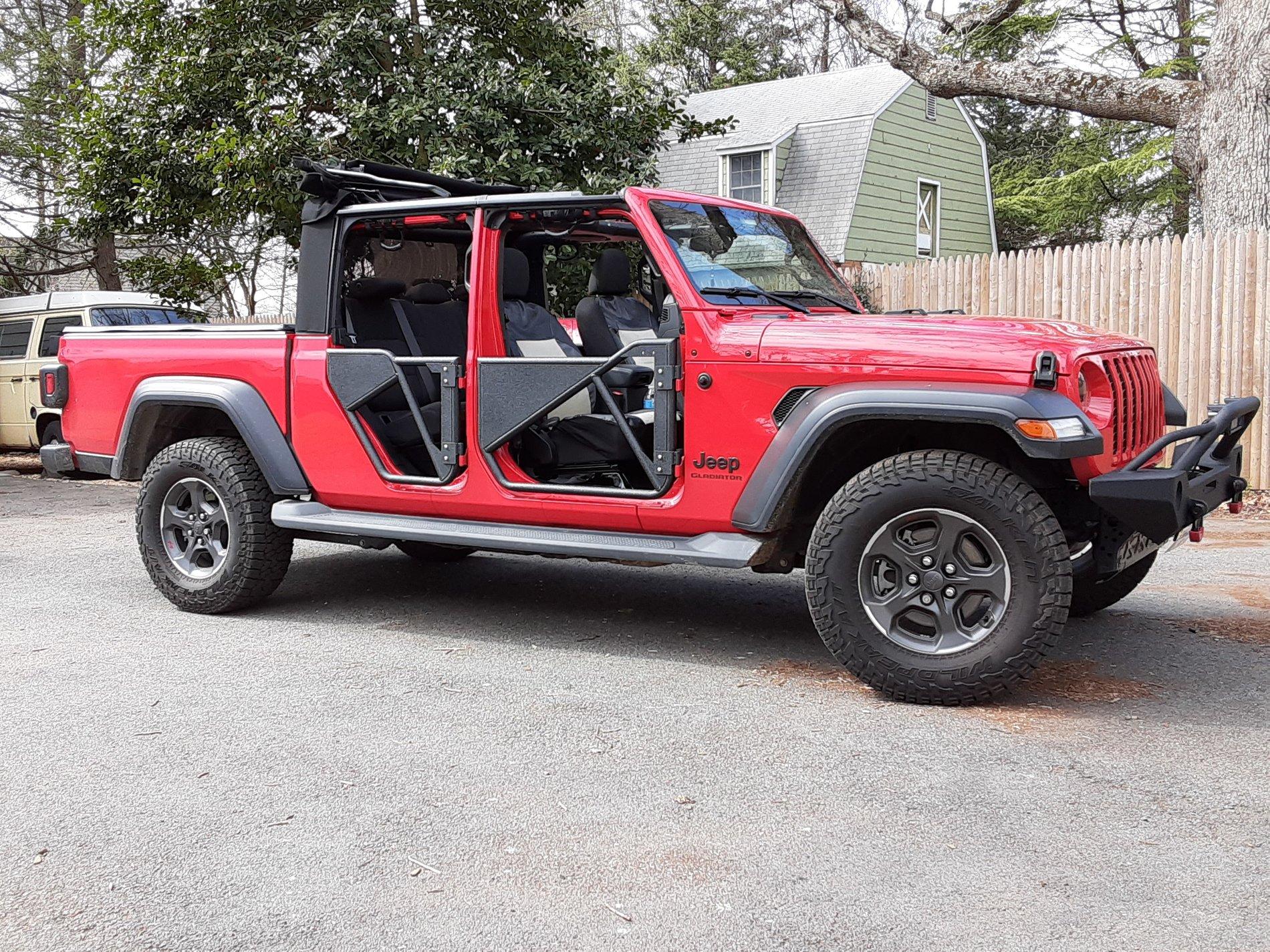

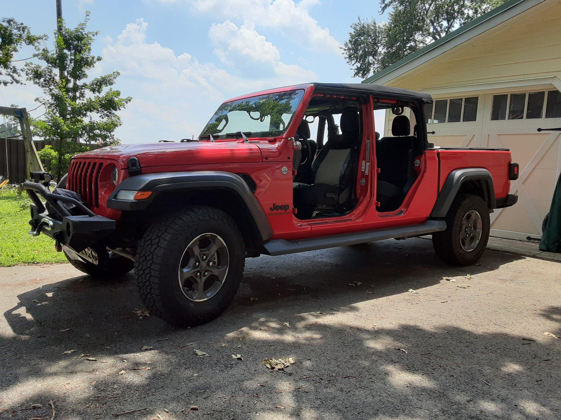

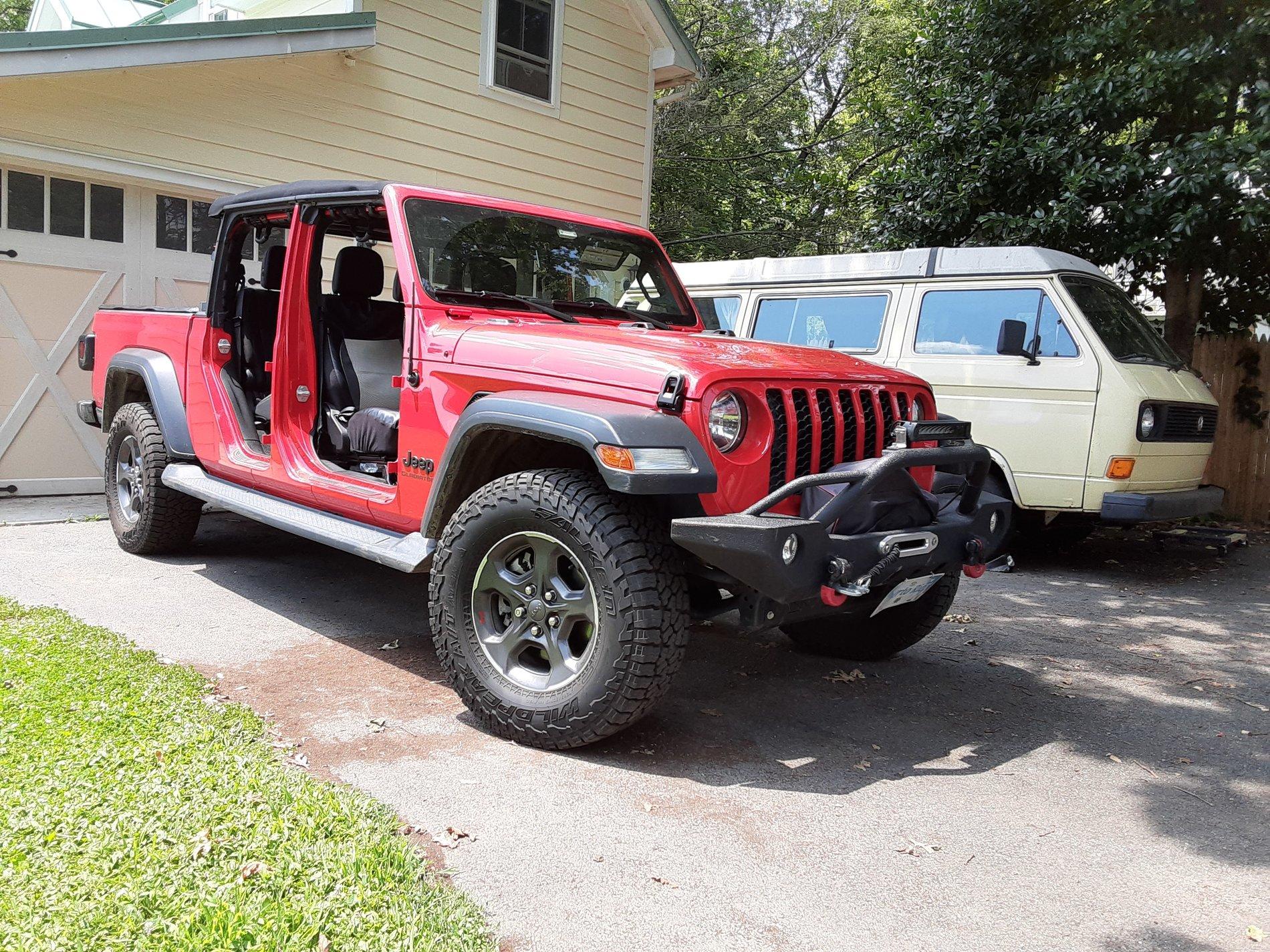

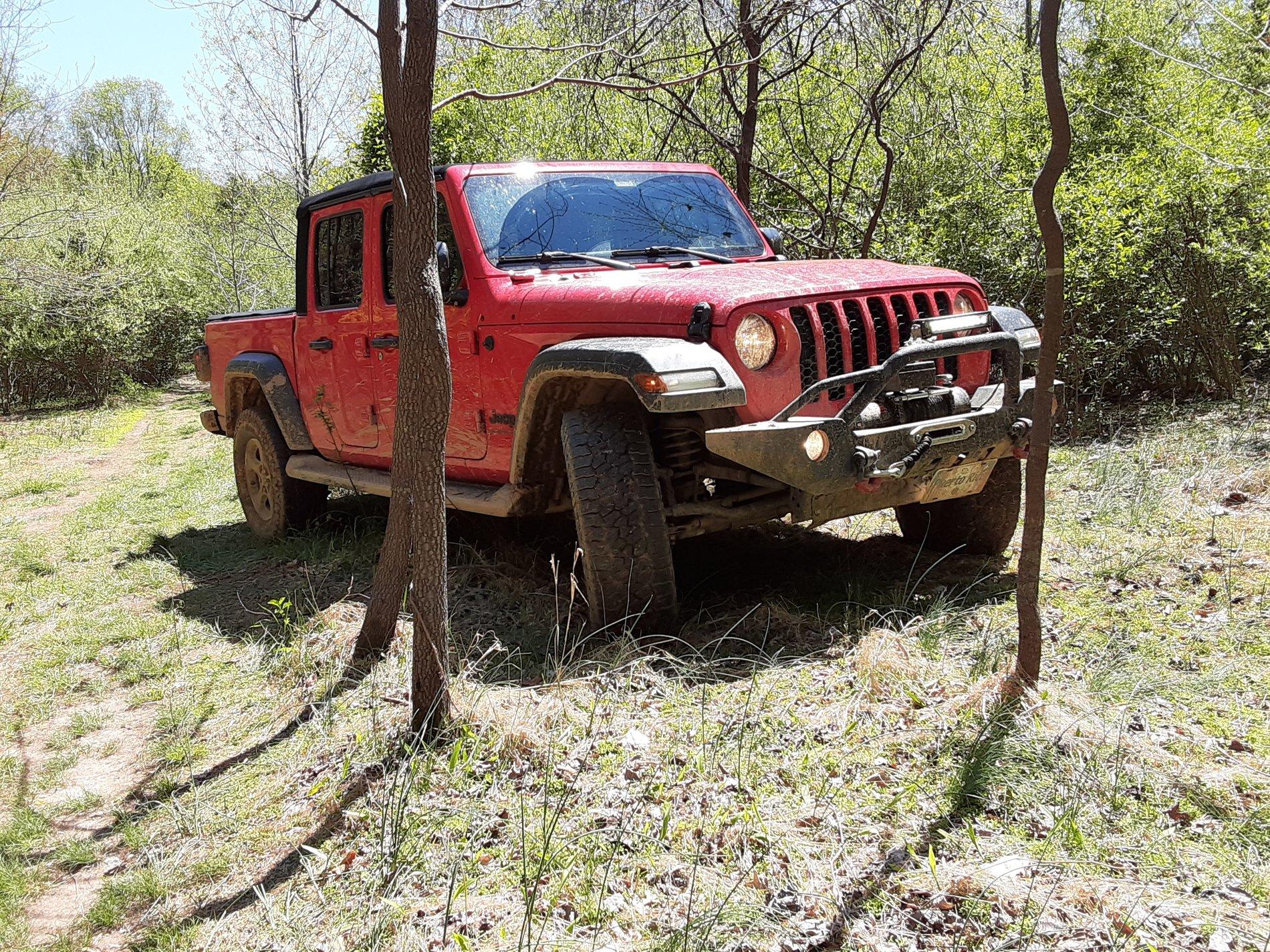

I like the build you're going for. On my Sport S, I put some Rubi 285/70/17 and the bumper is a Barricade Adventure HD that I picked up as an Open Box for just under $150 - https://www.extremeterrain.com/barricade-jeep-gladiator-adventure-hd-front-bumper-jg1184.html
It didn't seem too heavy. Then a couple shackles and winch from Ebay
-op
Jeep Gladiator Mopar Steel Bumper on Sport S 20200705_134837
Jeep Gladiator Mopar Steel Bumper on Sport S 20200705_134807
Jeep Gladiator Mopar Steel Bumper on Sport S 20200422_133906
