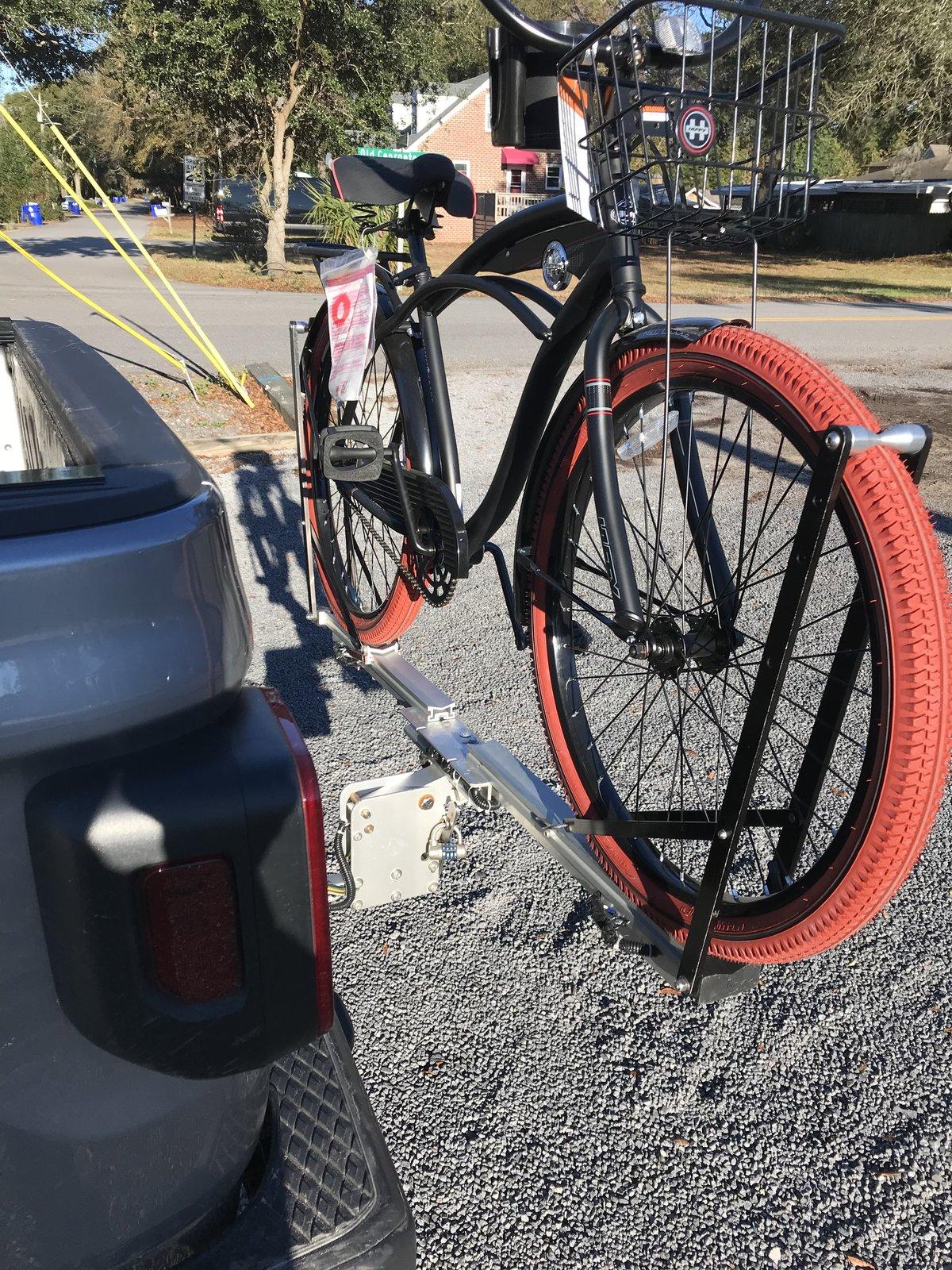

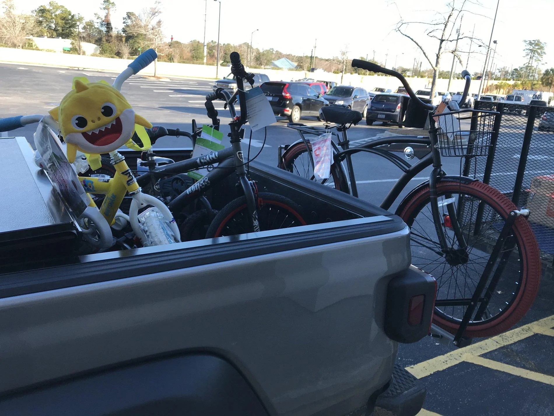

Hey @Ctanley suggest that you make certain that you have flat washers on both sides of the 2 bolts that hold the tonneau in place at the front of the bed. As long as you have flat washers in place there will be no way any thief could break in from the front or that the bolts will come through their brackets. And yes you are right, difficult to haul bikes in the short bed with the tonneau in place or even folded forward. I have a single bike rack and also a 3 bike rack that plugs into my trailer hitch. And with both racks when I drop the tailgate it does not hit the bike racks. Paid Walmart just $48.00 years ago for my 3 bike rack, was on clearance.
See my post in the Merry Christmas thread to see a picture of my 3 bike rack. Was hauling 5 small bikes in the bed in the attached picture for my yearly Christmas deliveries plus another big bike on my hitch mounted rack. A hitch mounted rack really is the way to go if you ask me. And I suggest adding a full set of lights to your hitch mounted rack like I did. Really don’t want to have someone rear end you and then try to say it was your fault since they could get see your brake lights through your bike wheels. And fabricating the light bracket, bolting the lights to it and wiring it up adds to the fun.
