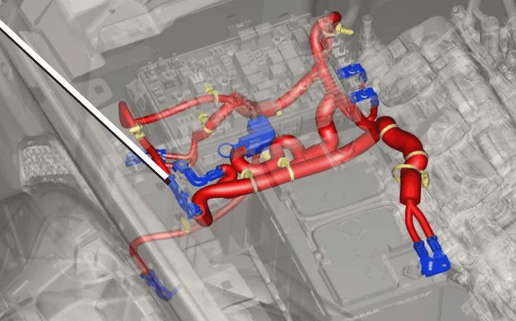

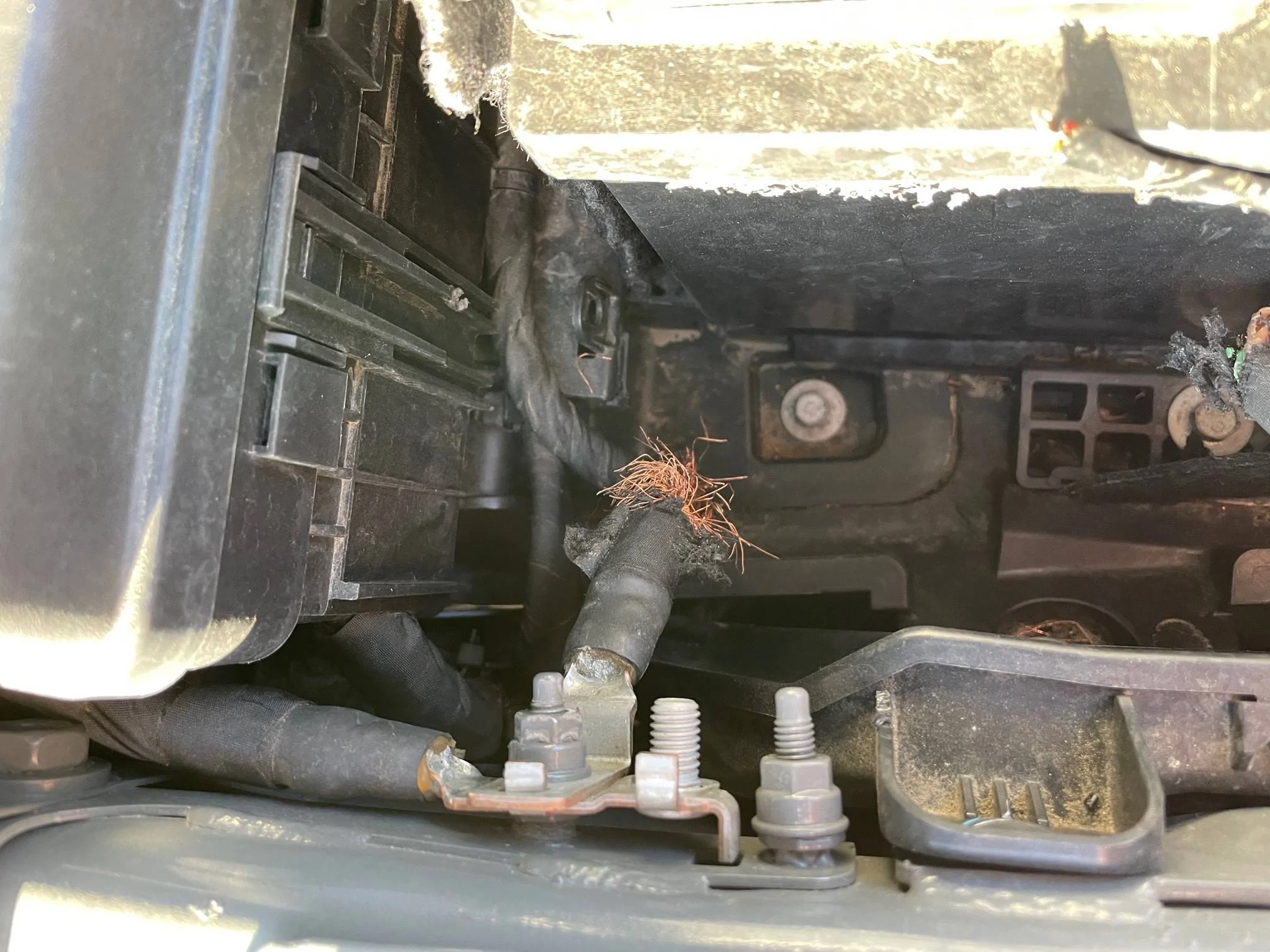

Hi community, I discovered I had a pesky rodent living and "chewing" next to my battery, he got about 1/2 through my body ground wire. I haven't had the time to trace this wires path, nor, can I identify a part number on the cable. I was hoping someone would have knowable of this cable, and can offer a Mopar part number for its replacement and possible offer experience with the job. Thank for your time! Brian

It looks like theres a little slack in the wire. Perhaps you could cut out the chewed portion and re attach the wiring. May save you a bit of time messing with tracing the cable

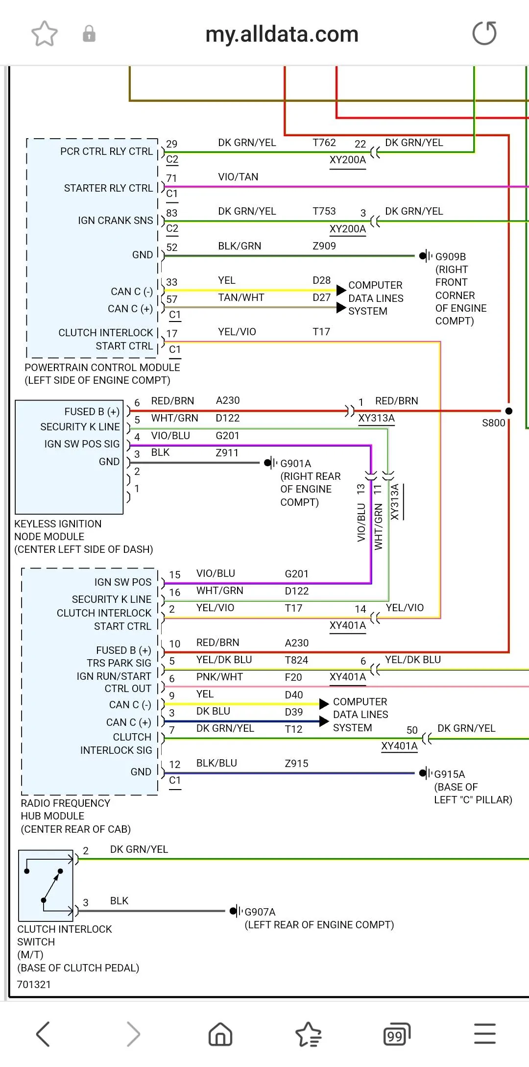

What year, model, options, and automatic or stick.
Trying to find what ground that is until I'm able to look at mine.

OK this is a 21 gladiator rubicon 3.6 auto, originally did not have the bed outlet but i added it... nothing put in that area thought. I have tried to trace it and i fell its going to the negative lead on the battery.
It does look like the battery ground.
