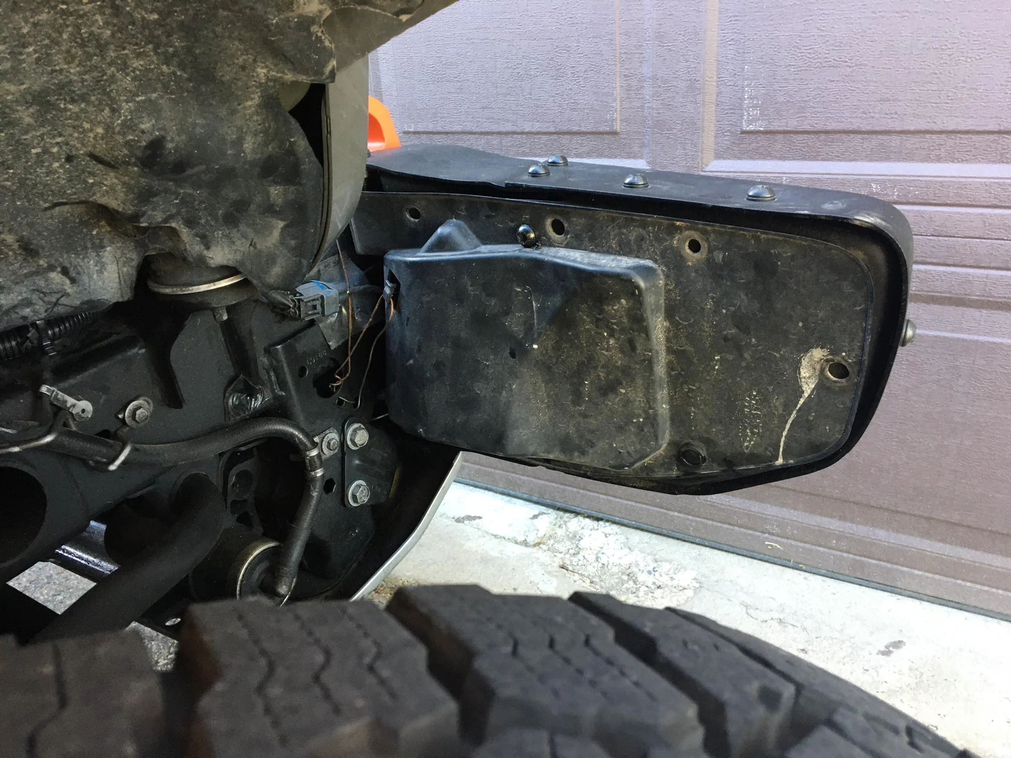

this is a Rubi steel bumper on my Mojave. don't mind the steel wire.

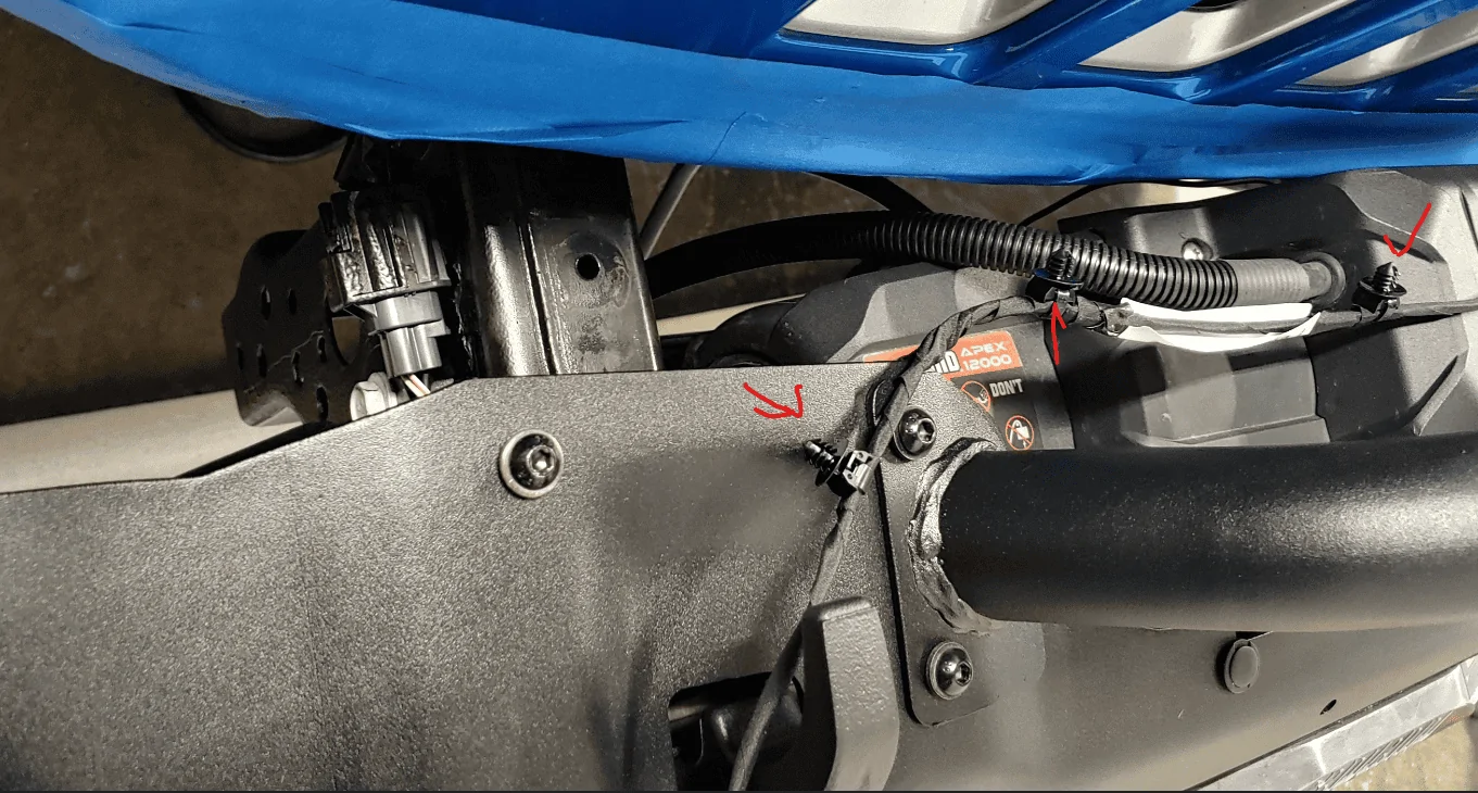

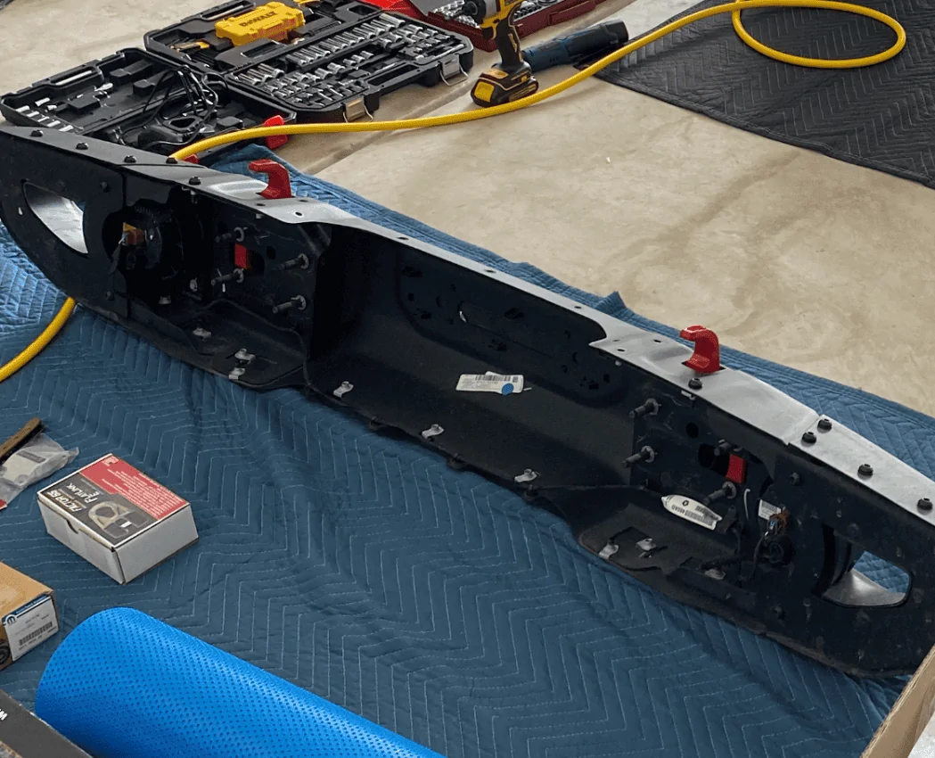

Thanks, but what I'm needing is how and where the harness crossed the bumper from connection at the frame on the right, across to the left side. Need to see where the clips go that hold the harness to the bumper as it crosses the bumper from right to left.
Like - where do these clips go, and exactly where does the factory fog harness run in the bumper
Jeep Gladiator Need photos of steel bumper fog harness 1661450526658
I know where it plugs into the truck harness - the new harness is plugged in, but where to route it through the bumper........

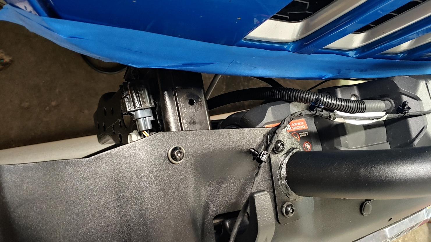

I have this picture from a while back. Might have to zoom in a bit, but its the best I have.
Jeep Gladiator Need photos of steel bumper fog harness bumper zoomed in
40,514
54,044
Bingo! Perfect, thanks. That confirms the middle part that I finally figured out by centering the harness on the bumper below - and it shows very well that other spots which are all but hidden by the winch, receiver and other @$#%@ I have installed.
Note to self - next time, install at least part of the harness clips THEN put the bumper on.
Anyway, got it, harness clipped except for a couple I have trouble getting to with the bumper installed (I'll get them, I see the holes now) and thanks again.
