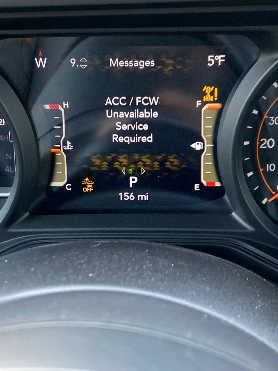

What is the production date of your truck? If it was an early '24 build........this is a classic case of what they call Lot Rot.
It sat for an extended period of time without sufficient run time and the batteries didn't have a proper charge over that time. New batteries should resolve the issues you're experiencing.
Sucks it happened and is deminishing that new car joy. Good news, easy fix and free.
Lot Rot is a real thing. I used to work at a Chevy/Geo lot in college, and the number of "new" cars with dead batteries was amazing.

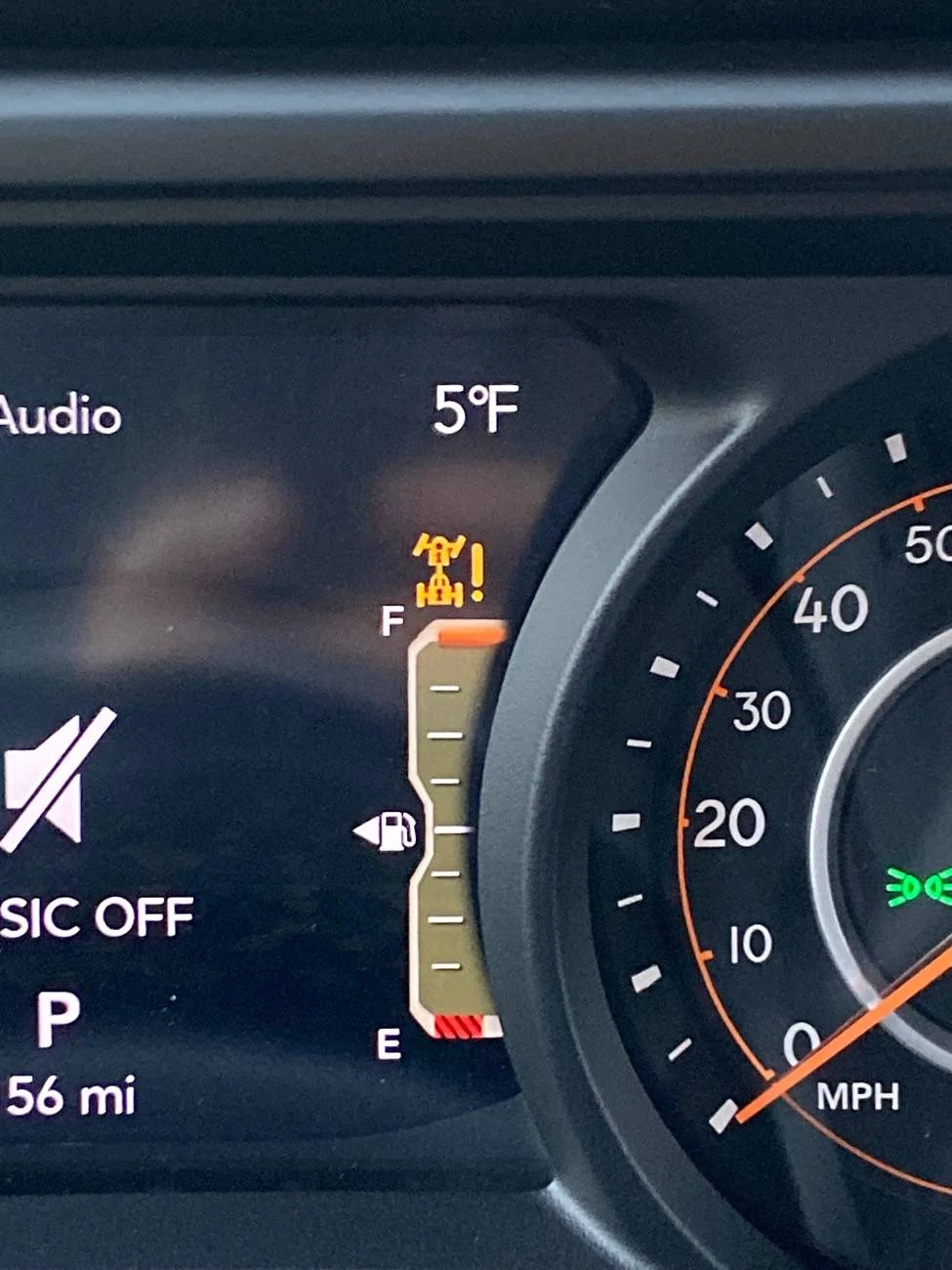

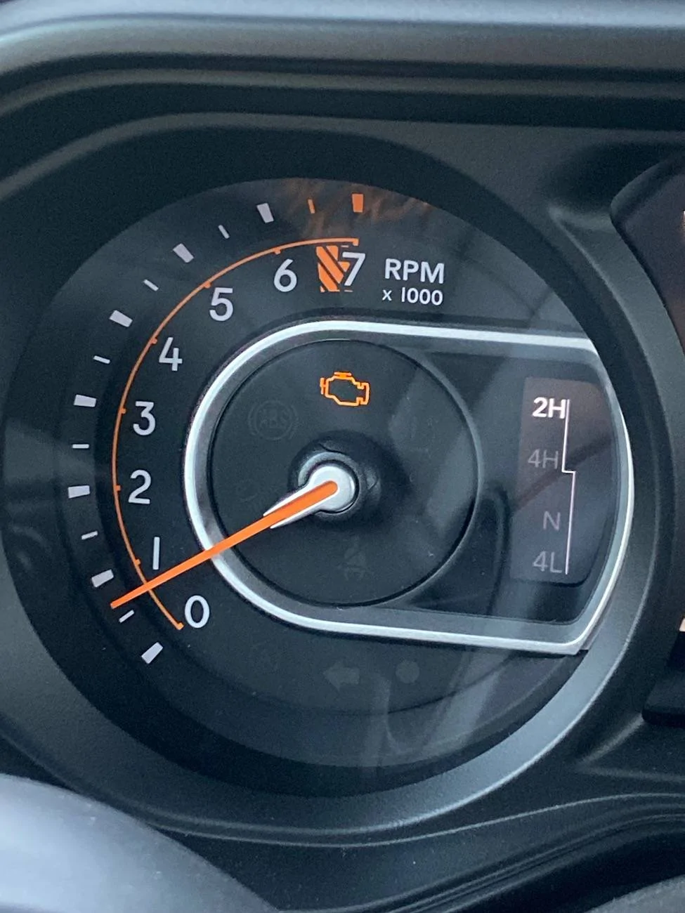

UPDATE - Turned out to be a loose ground wire on the DASM (Driver Assistance System Module). Dealership said this is their first time experiencing this. Tightened the wire and tested for 30 minutes. Issue resolved.
Happy it was an easy fix!
