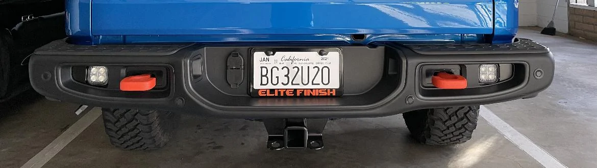

$350! Rock bottom price for a perfect condition OEM steel rear bumper with parking sensor holes!

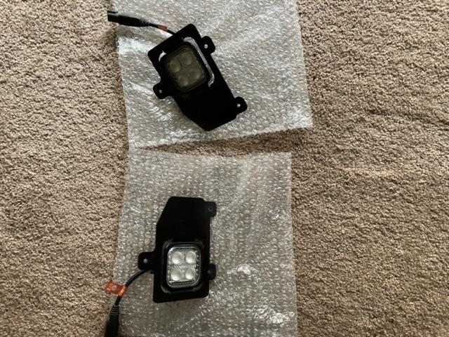

The plastic bezels and brackets for the sensors are present and the license plate lights from the factory plastic bumper pop right in to these brackets. They are the same.
