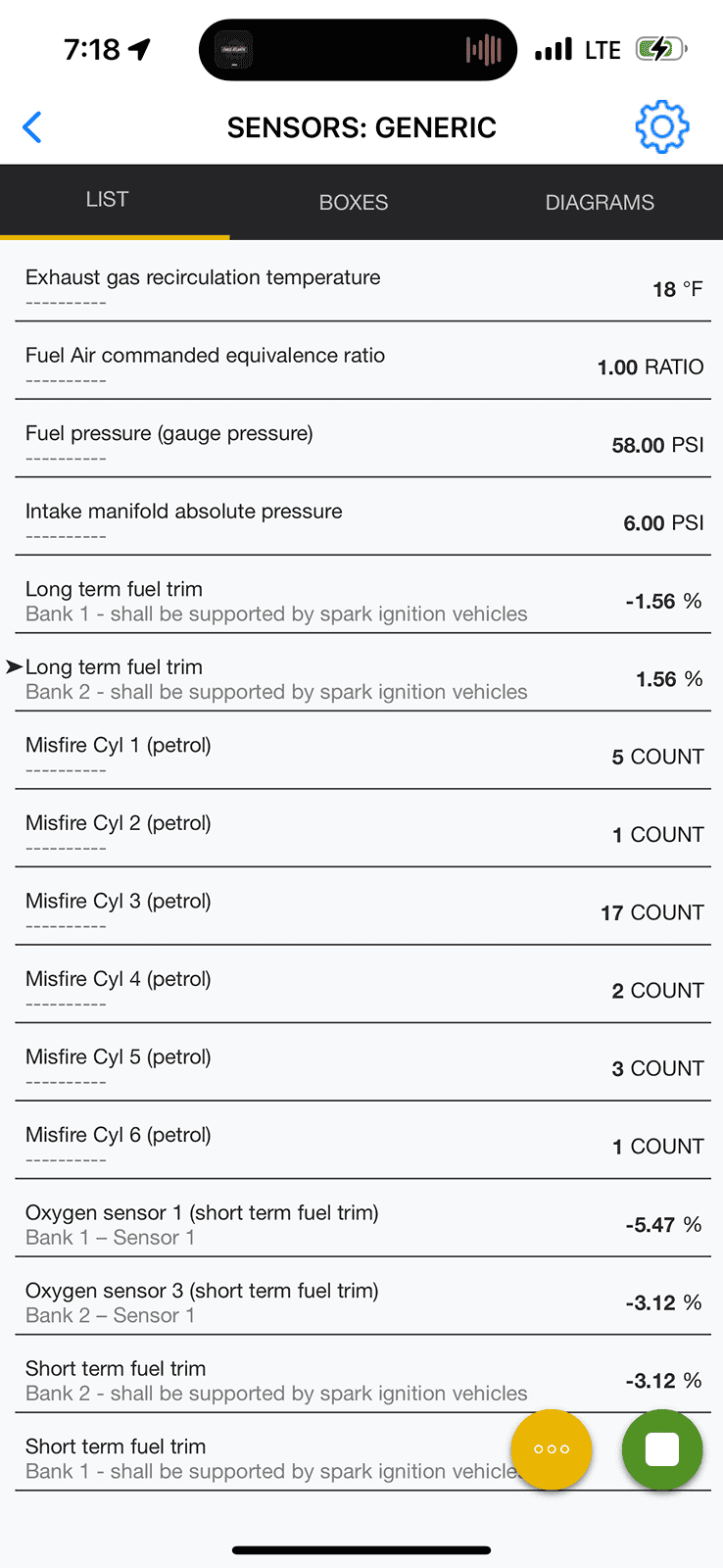

This was one of my JScan screen shots
Jeep Gladiator Oxygen sensor IMG_3456

Does the negative fuel trim on bank 1 indicate anything In relation to bank 2
