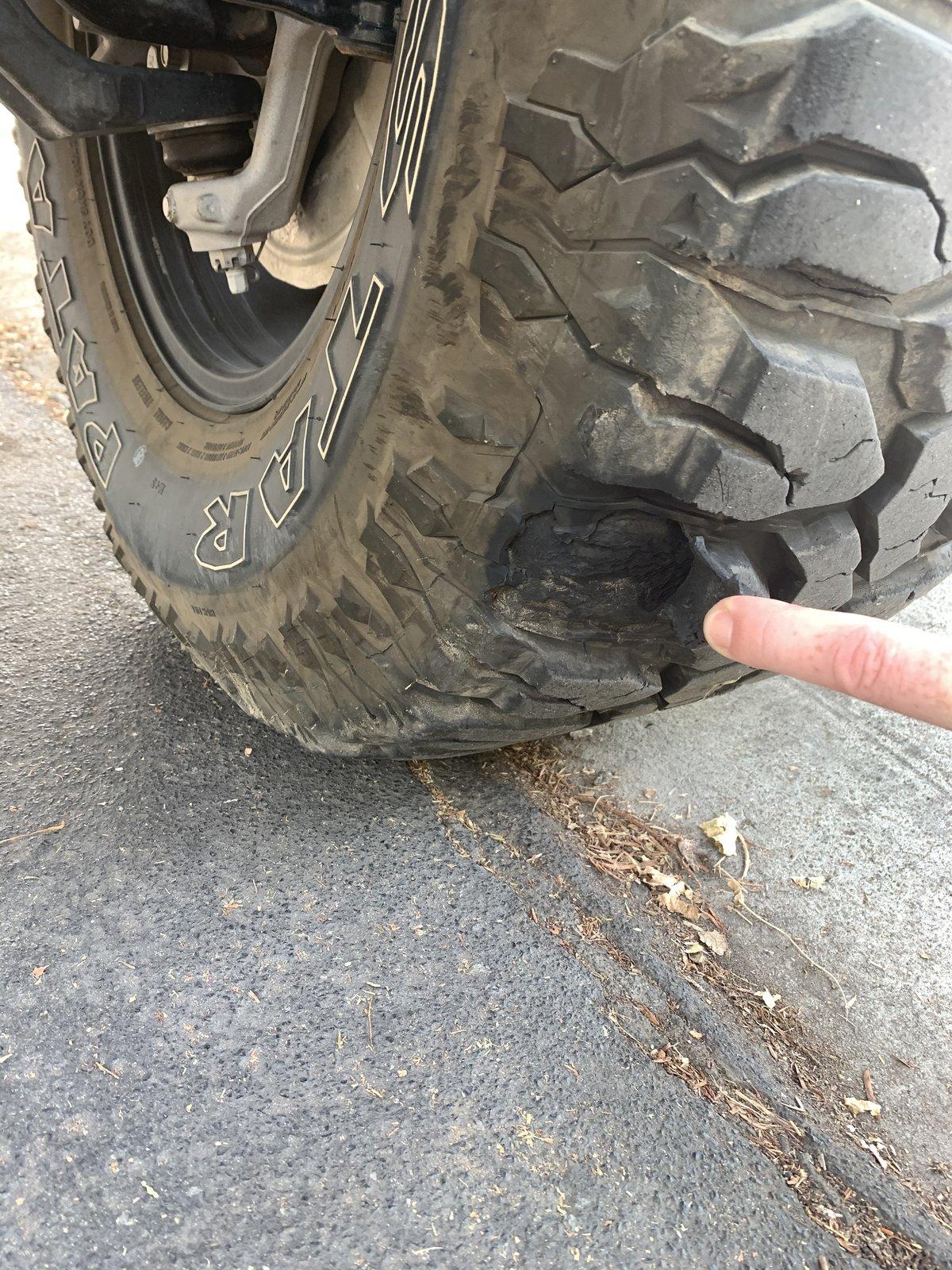

Khockey02, that tire does not look safe. I would recommend getting it changed our ASAP. Please let us know if we can help.
Thanks, I’m actually at your Santa Clara store now trying to put together a set of KO2s

Is this normal? Or dangerous? The tires have about 8,000 miles and a fair bit of wheeling. This is the worst of them, but there are several lugs and other features completely missing or severely damaged. The discount tire guys are earning every bit of that $20 lifetime maintenance keeping these balanced.
Time to pull that tire out of rotation (literally). How much meat is in the carcass where that lug tore off? I would run it on the rear axle at the very least. What a mess.
