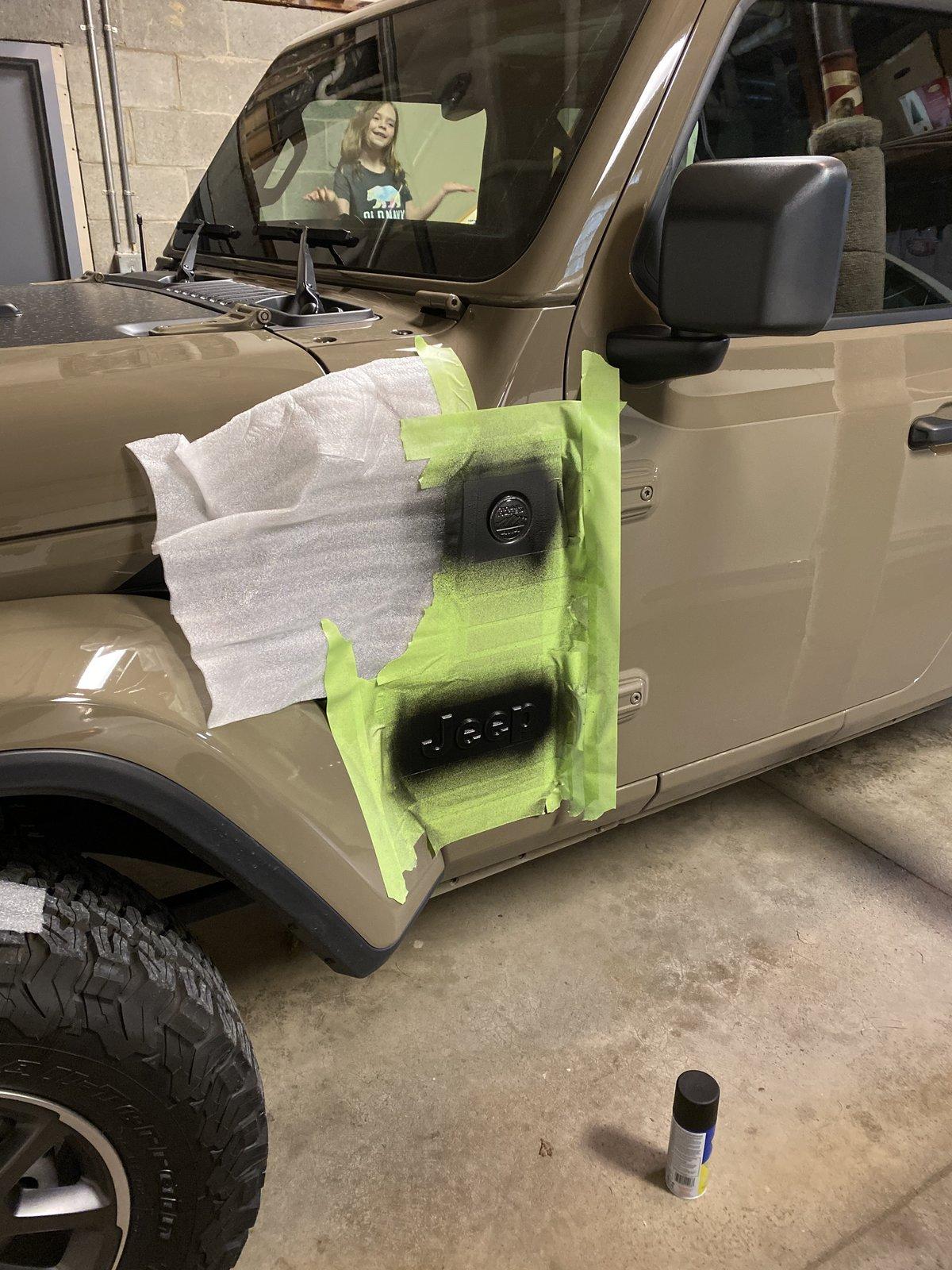

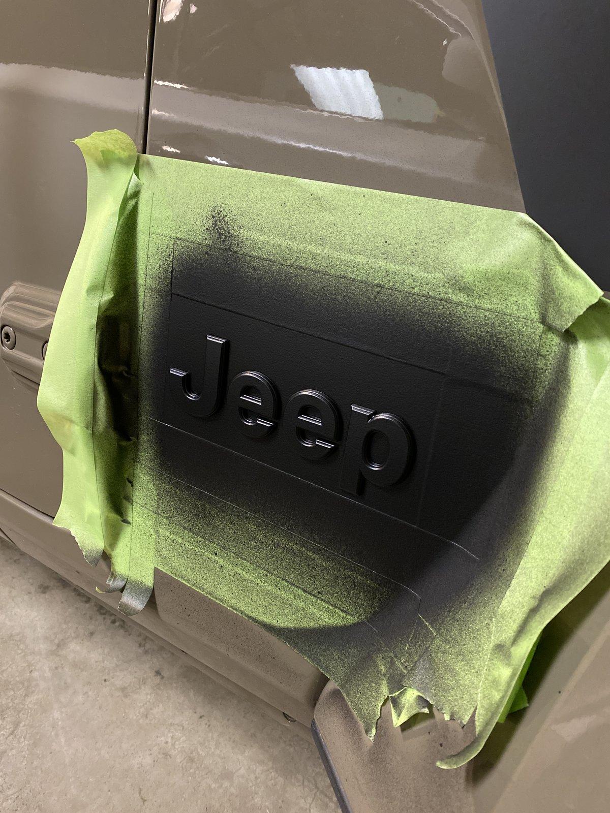

The 4th coat has been drying about an hour. I still think I see some wet pd in the cracks so I’m gonna give it another hour to be safe. Hope this crap peels off like it does in the vids I’ve watched lol.

depends how thick you went on the coats but I usually have used 6 or so coats. I've always had it last years on emblems and such and always look good. Lasted a year or so on the wheels on my 600 whp bmw, saw some HARD abuse. still looked good as new when I peeled it to sell the car. I'm considering dipping my entire jeep with a spray gun instead of wrapping it

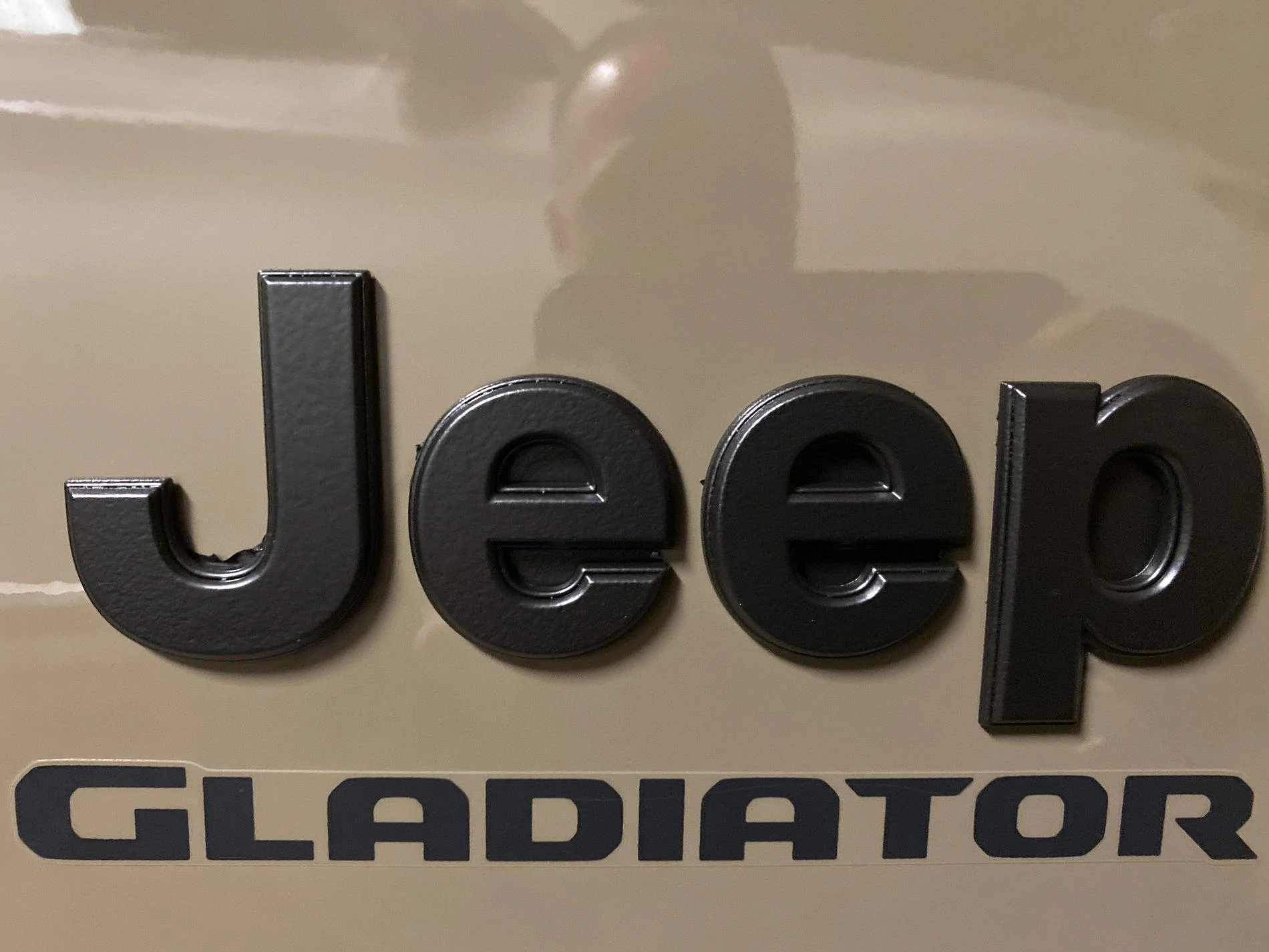

So here’s what’s left after peeling off. What’s the best way to clean up the J and inside the e’s and p? I’ve read toothpicks work but it’s 1145pm and I don’t have one lol.

I used toothpicks

Yea. Might have to pick some up today. I think I let it dry too much before peeling. Some articles mentioned to peel it while it’s a little wet. Gonna do the other side and see how it turns out.

Toothpicks are recommended. I had wooden kabob skewers. Making sure to apply enough coats from different angles at the same distance seemed to do the trick for me.

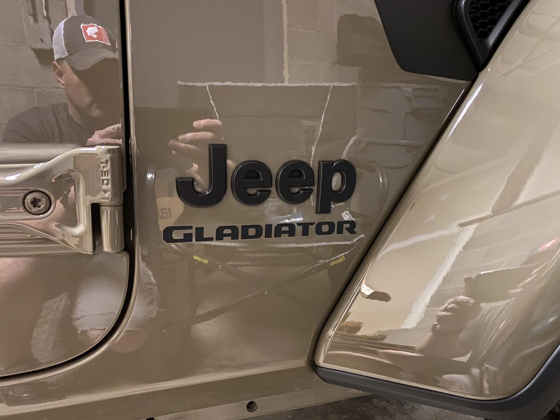

It peeled off much better this time. Still had a minor hiccup with some of the extra falling on the P and adhering to it. I’m leaving it as is for now.

Looks great!
I would grab that little bit off with a tweezer.
