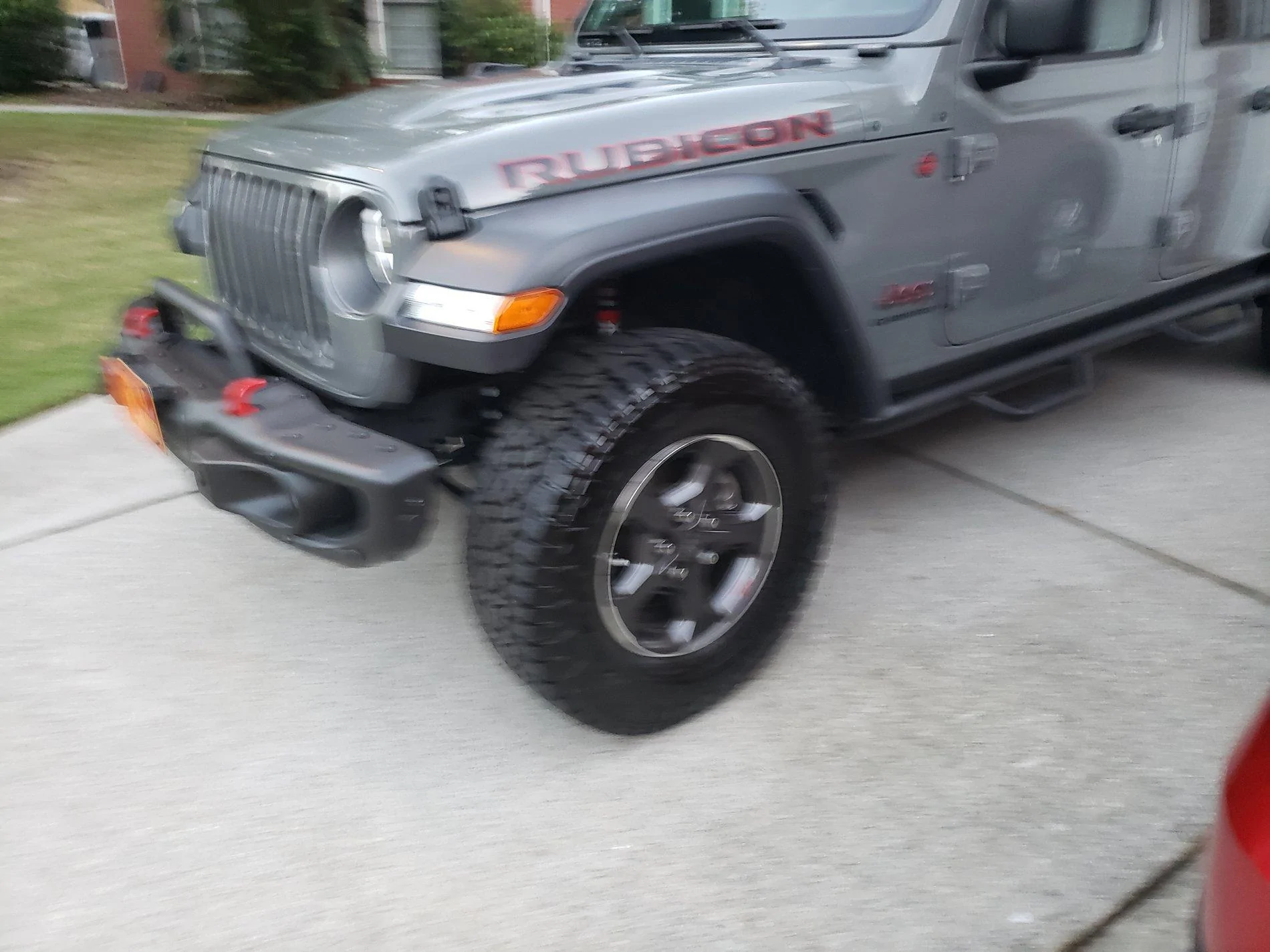

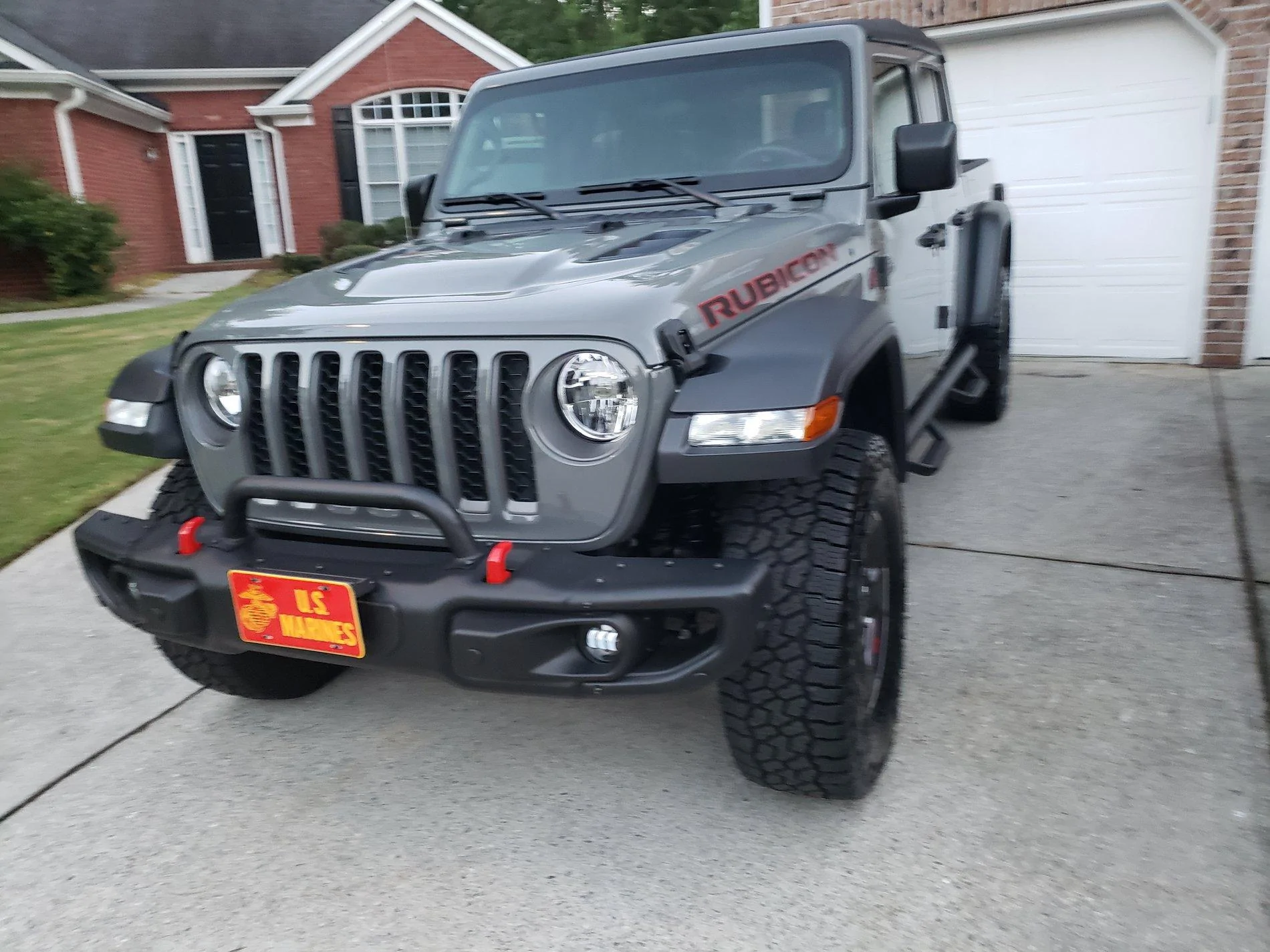

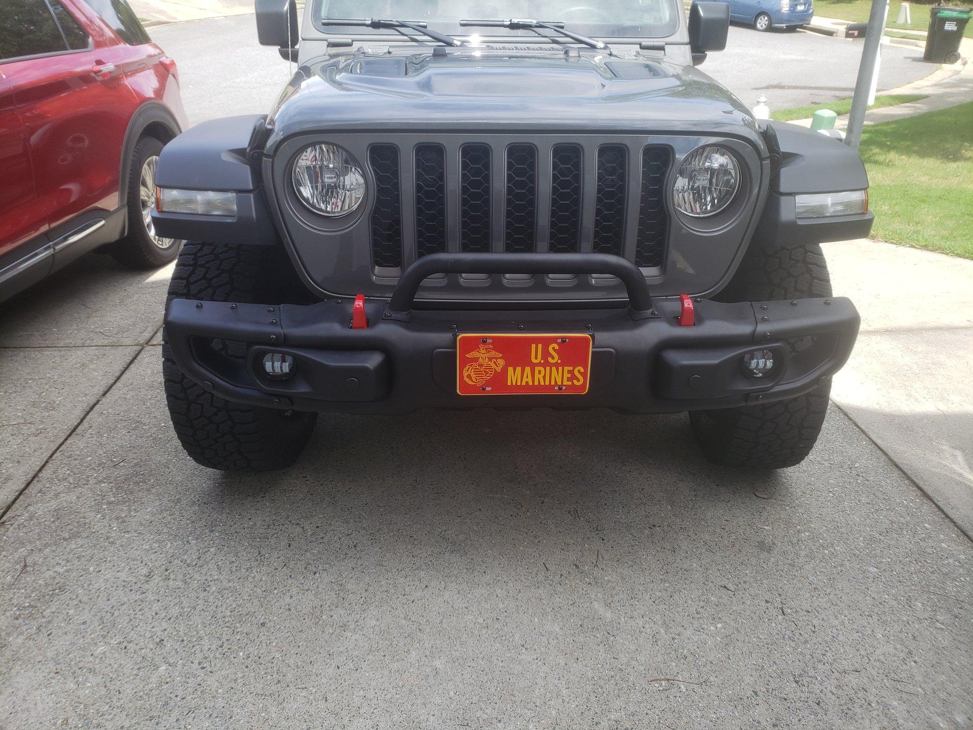

OSOKUSMC
Matthew
Aug 5, 2020
Georgia
Military
I bought this one from ebay. It is great in my opinion. Have a winch on the way and with very slight modification, I used the original steel skid plate underneath. Mine actually came with the correct led fogs and connections though.
Jeep Gladiator Push bar or hoop to stock bumper 20200905_195505
Jeep Gladiator Push bar or hoop to stock bumper 20200828_145746
Jeep Gladiator Push bar or hoop to stock bumper 20200905_195509
