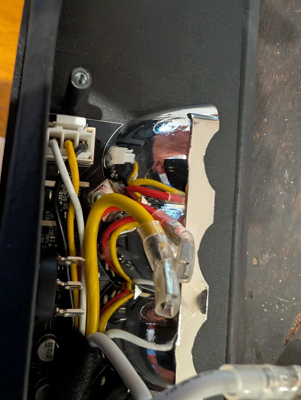

So I'm rewiring my lightbar to use my A-Pillar grab handle VOSwitch JL 800. First pic is of the wires after I removed the built in SPDT switch for going between off, white or amber. I looked at the wires connected to the switch and I swear on all that is holy, the white wire went to the side marked "I" for the white lights and the yellow wire went to the side marked "II" for the amber lights; made perfect sense- yellow = amber, white = white. I decided to connect the red power wire to the white wire to run one circuit to the VOSwitch using the existing 2 wire cable. Then I'm going to add a single wire connected to the yellow wire for the amber lights. Just connected the red and white with a crimp connector and tried it out with my 12v test supply. AMBER LIGHTS LIT UP! Checked yellow wire with 12v and WHITE LIGHTS LIT UP! Just sharing.for information (and sh!ts and giggles) sake, if anyone else has this lightbar and wants to rewire it.
NOTE: I wanted to rewire to an aux switch system so I would get an immediate visual cue of the switch lit up if I turned the Jeep off with it still on when I started it again The built in switch has no indicator light and I was blinding people going to work one morning. Luckily before I got very far, a Wrangler flashed his lights at me several times and I figured it out.

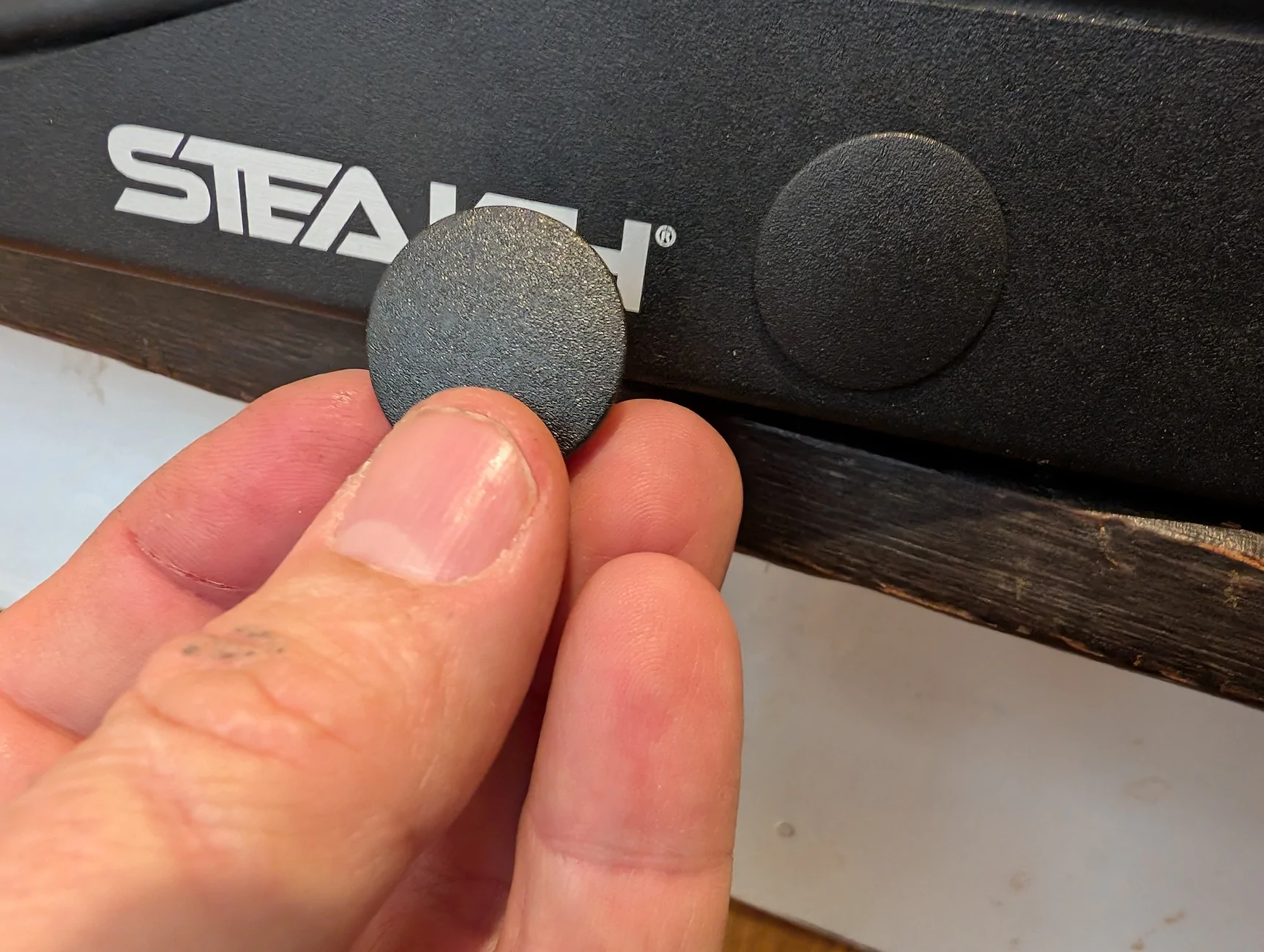

(Second pic just showing what front will look like with switch removed and plastic plug in place.)
