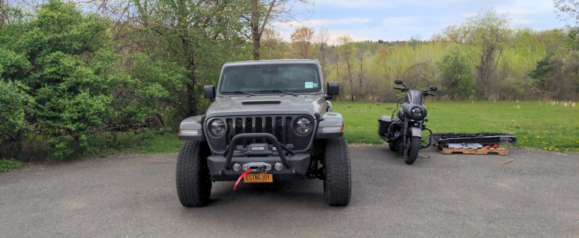

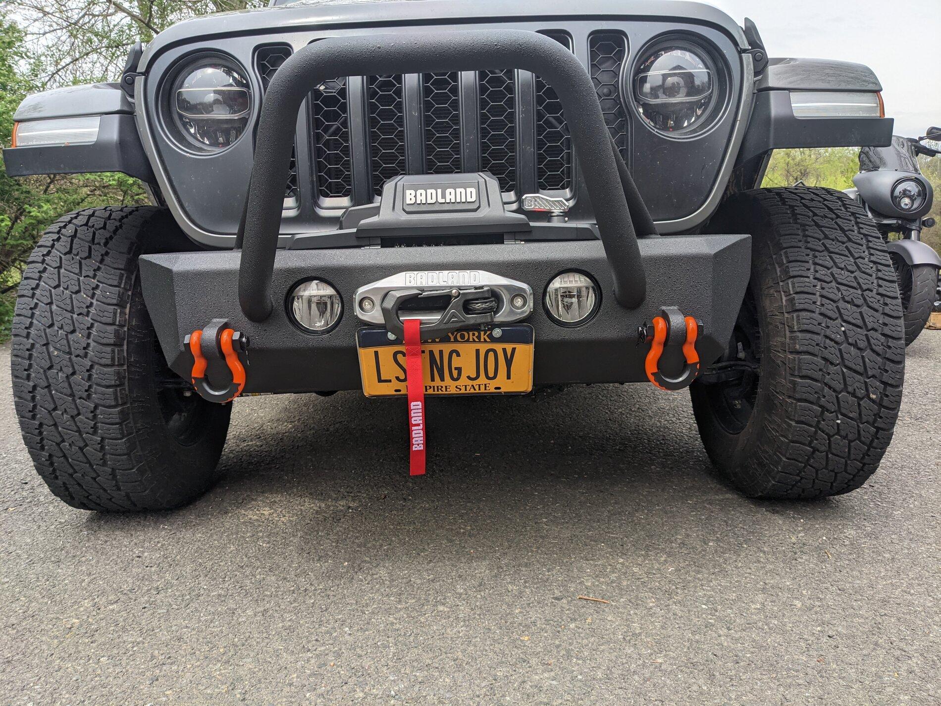

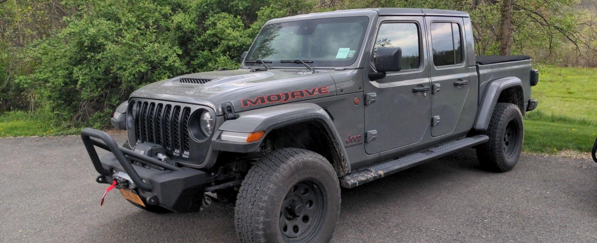

Installed the Reaper Gravestone F2 yesterday. Took probably 3 ours all told.
This thing is rock solid, great bumper. Looks awesome too.

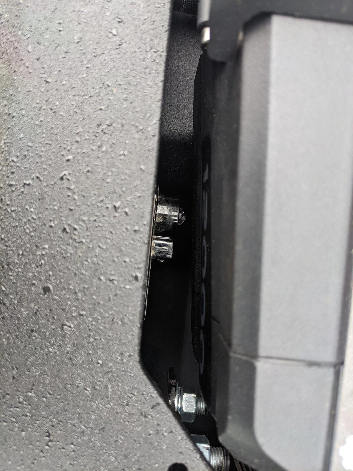

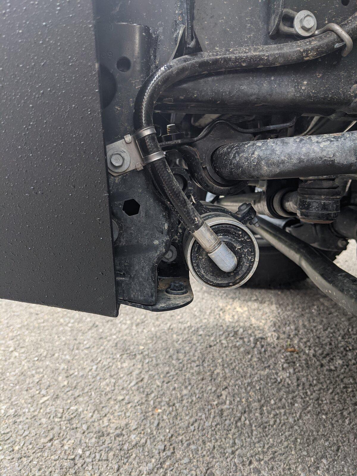

Couple issues: Kyle at Reaper and I spoke, and they weren't sure about fitment on the Mojave, specifically the stock skid plate. It had to come off entirely, but the bumper now leaves the shock reservoirs exposed. I am going to cut the stock skid plate down to a strip a few inches wide and then mount that up on to the remaining exposed stock mounting bolt locations.
The other is that the stock fog lights are too deep where the plug is located and the winch wouldn't fit with the fog lights plugged in. I am going to need to find either non-LED foglights or aftermarkets that are slimmer or just have the plug located lower.
Overall though, super pleased.
