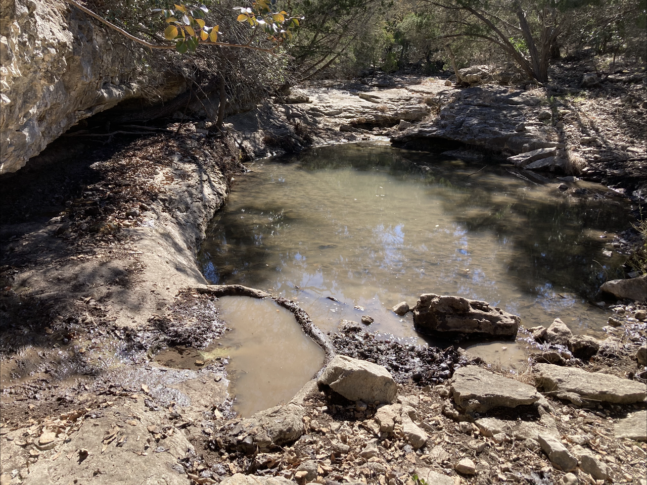

My ranch has massive flint deposits and is covered up with different stages and makings of Native American artifacts. I’m guessing it was caught up in a little mud and got thrown in there.
One of my springs flows into a bowl the natives carved into the rock before it overflows into the riverbed and there are several big mounds a little up the hill from it. I even found buttons off of union uniforms in the pile. its remote as heck and very isolated. We have found much more that will remain secret for sure. I can confirm the natives in this spot came in contact with at least 3 Spanish expeditions over various time spans. 👍🏼
It is an excellent spot with caves and grottos and maybe someday peoples will find my caches of goods.

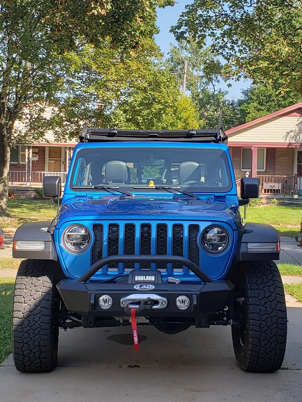

I had just cleaned some leaves out so it is muddy.

I thought Aux 3 and 4 were only 15 amps, while 1 and 2 are 40 amps. I would assume you'd want higher amps for a winch, or am I wrong ? I don't have a winch, just thinking out loud...
I didn't have the factory aux switches so I installed the Lasfit aftermarket switches. I believe all four switches are 30 amps. Also, you probably can't run a winch directly off the aux switches since winches can pull upwards of 400 amps. I wired my aux switch to a battery isolator relay. The aux button just turns the relay on, which basically makes a direct connection between the battery and the winch. The winch comes with a manual switch you can install so you can disconnect from the battery. I did it this way so I could turn it on and off from within my cab.

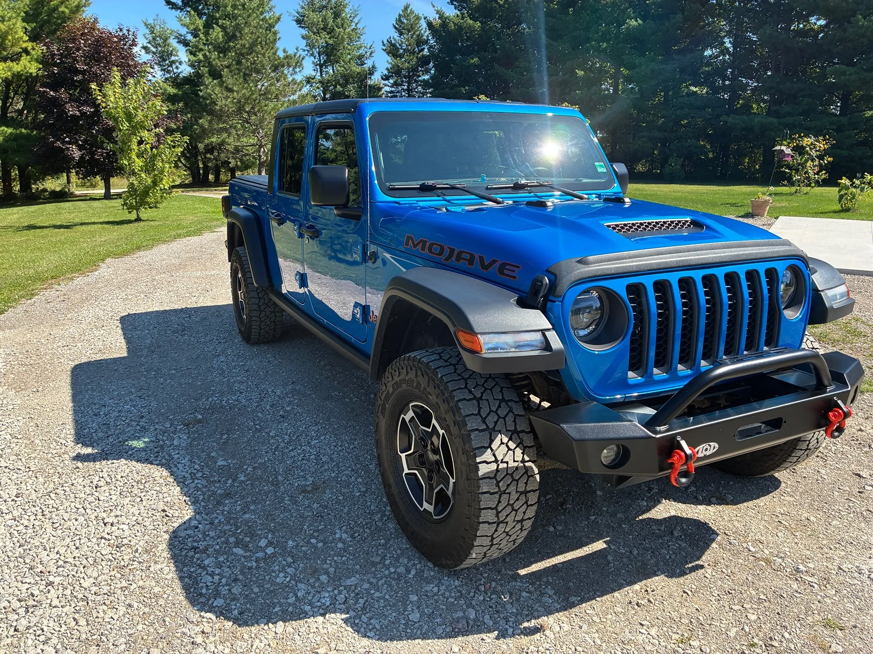

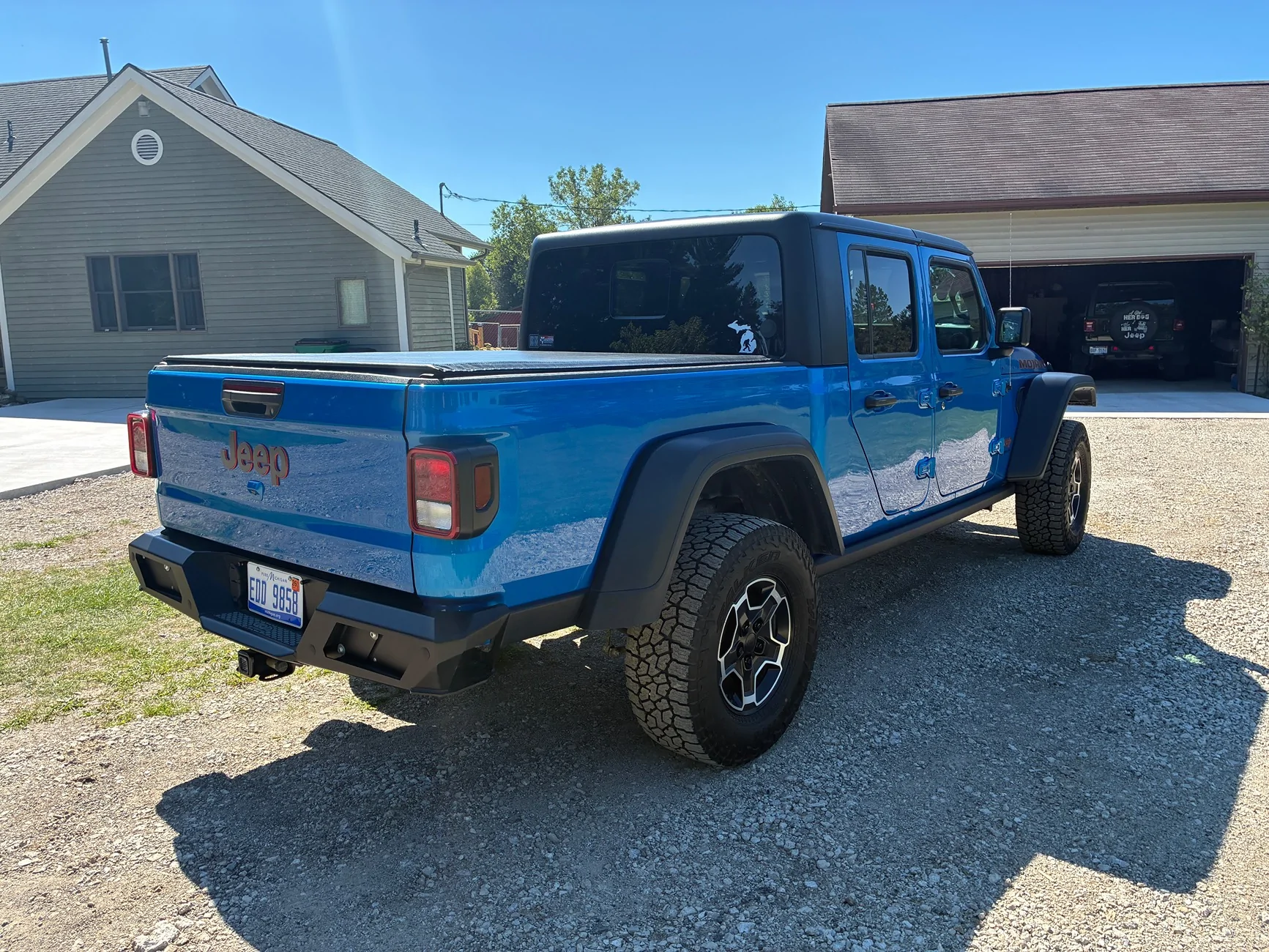

Looks great! I got the LOD mid width for mine and the destroyer rear bumper as well. I don’t have a winch yet, but I will. I called LOD before I ordered mine and she said that if I come and pick them up they would be 30% off, brand new. I live in Michigan, they’re in Indiana, my wife needed to travel to Indiana anyway, so I went with and picked them up. They are fantastic people at LOD and I would recommend these bumpers.

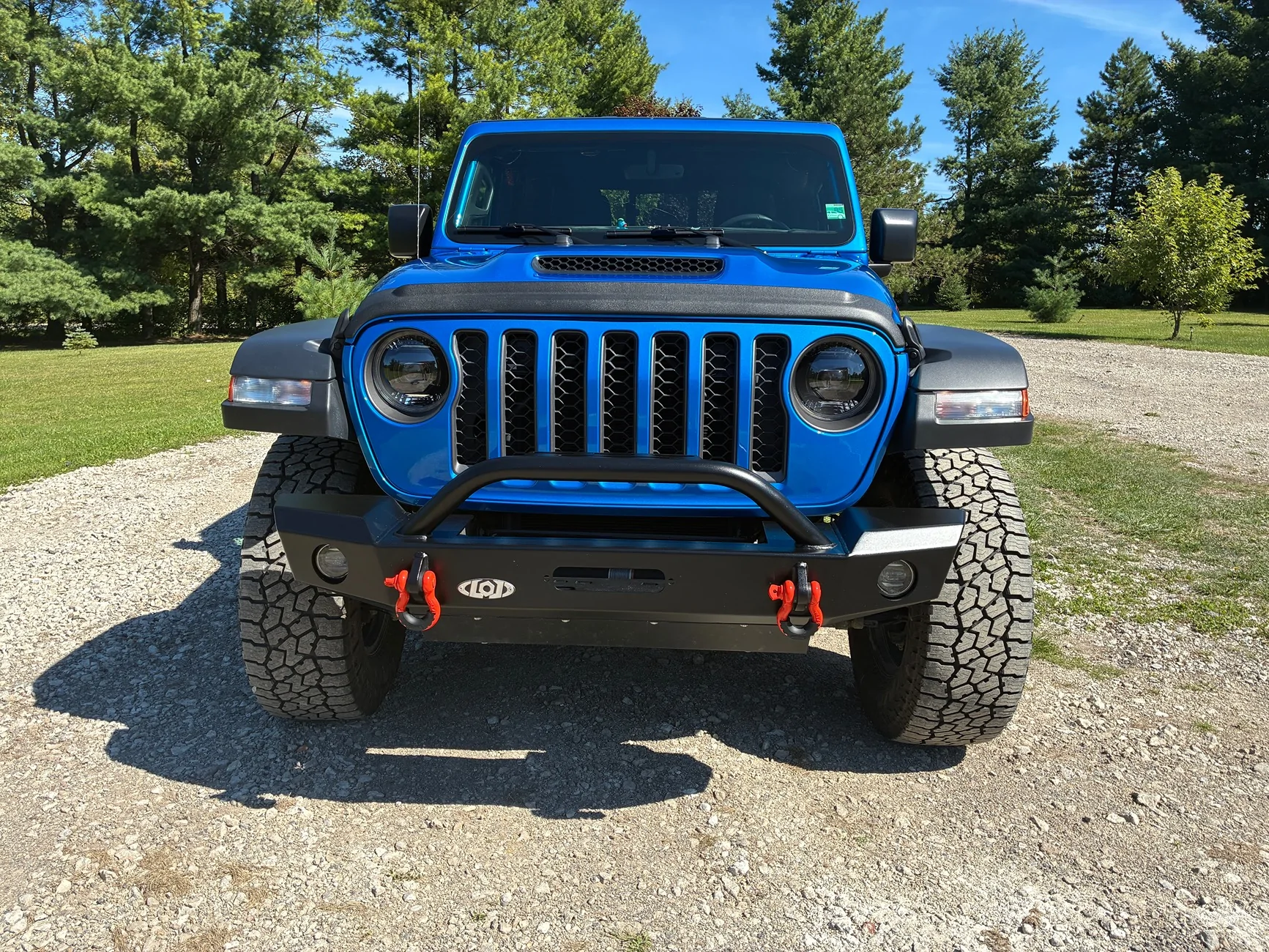

I really like my LOD bumper, durable, mounts the winch lower, takes hits.
It has started to rust at the welds though, probably wasn't zinc coated before the top coat went on. Very minor, but something I'll have to address this year.
