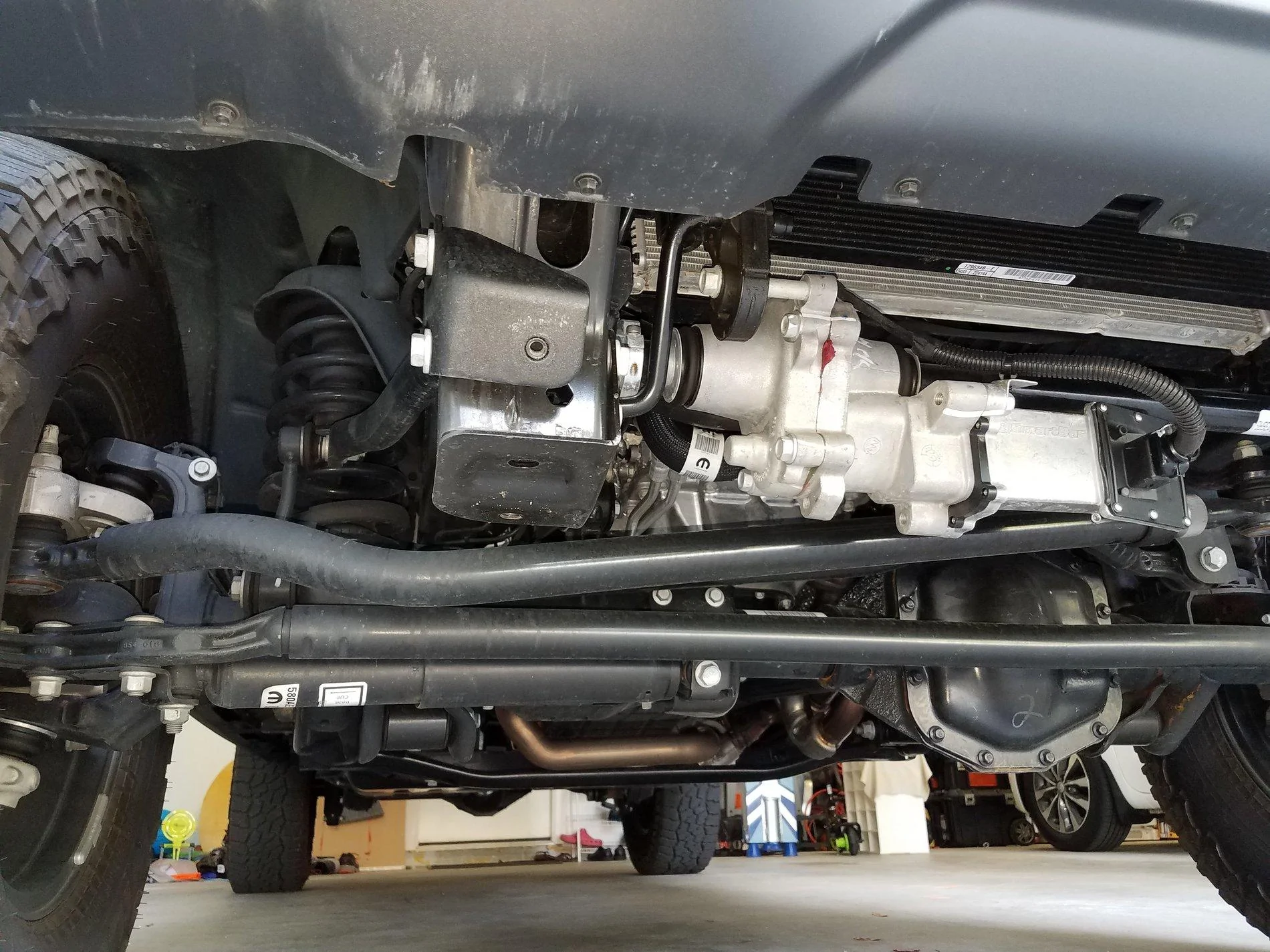

There are a lot of videos on bumper installs, I have the Rubicon, so the metal skid pad is different than the sport. Also, the plastic wind reflectors are not on my truck
Jeep Gladiator EAG Bumper install with Apex Winch 20200720_201555
Jeep Gladiator EAG Bumper install with Apex Winch 20200721_163012
Jeep Gladiator EAG Bumper install with Apex Winch 20200721_165054

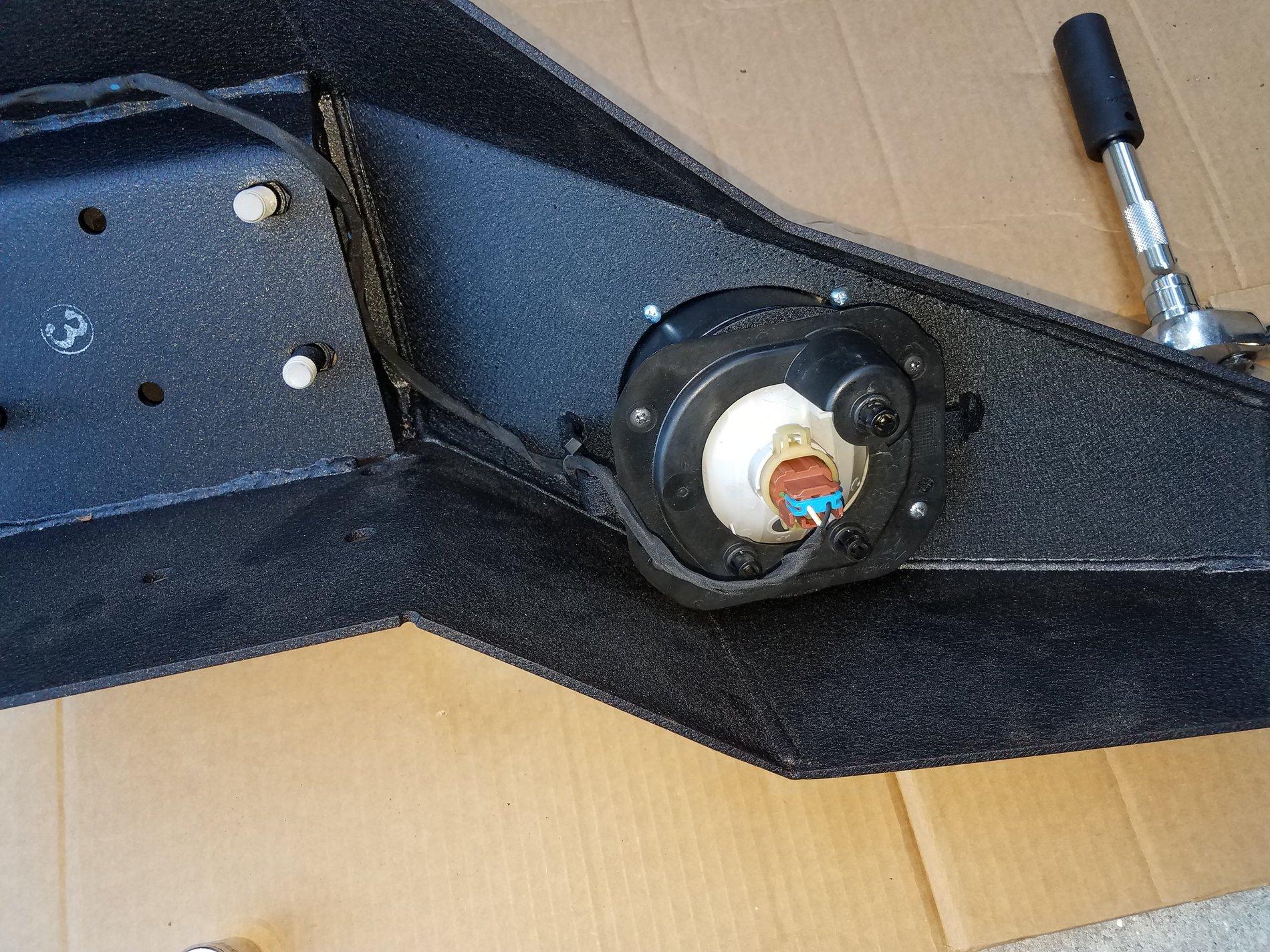

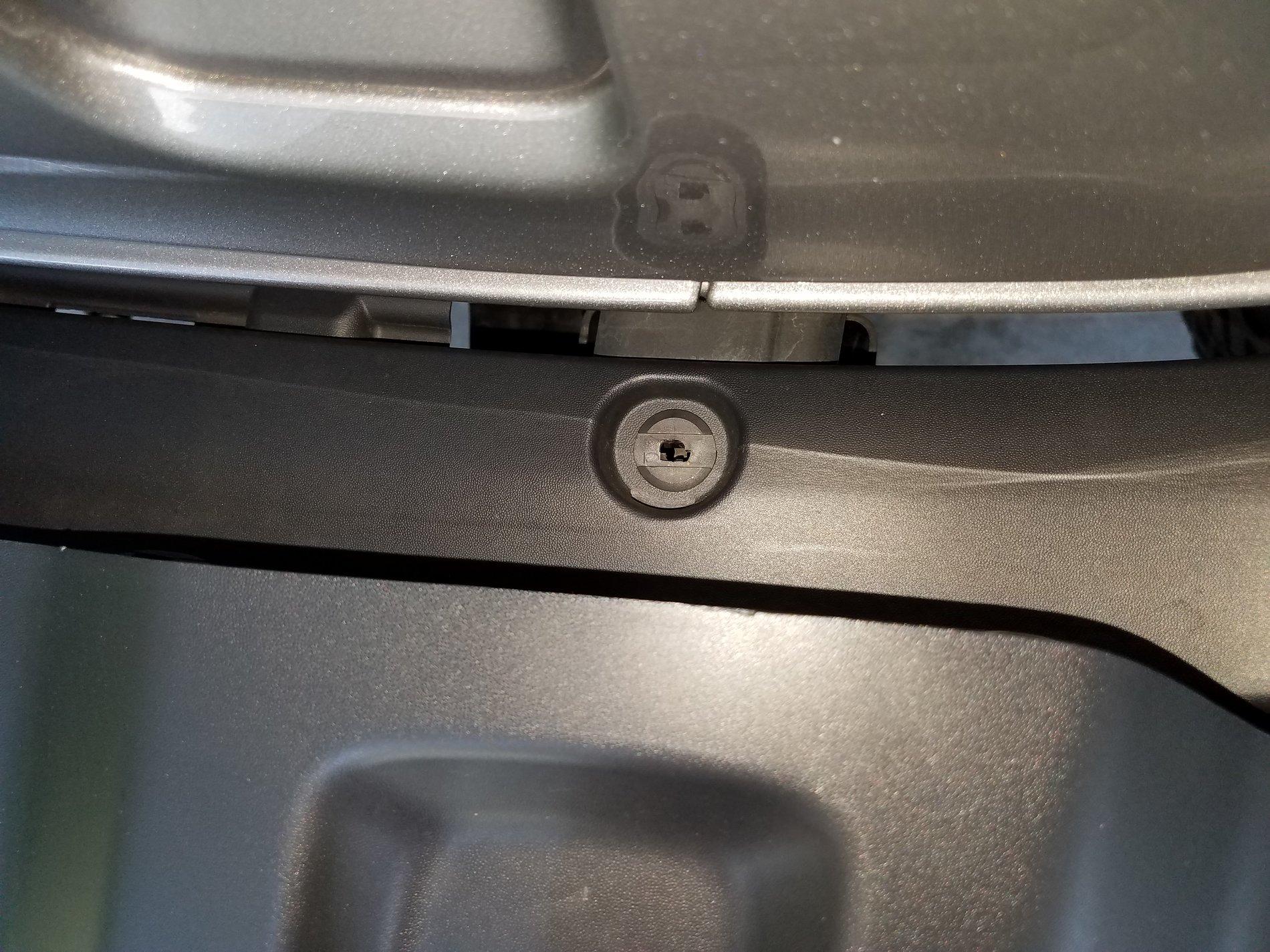

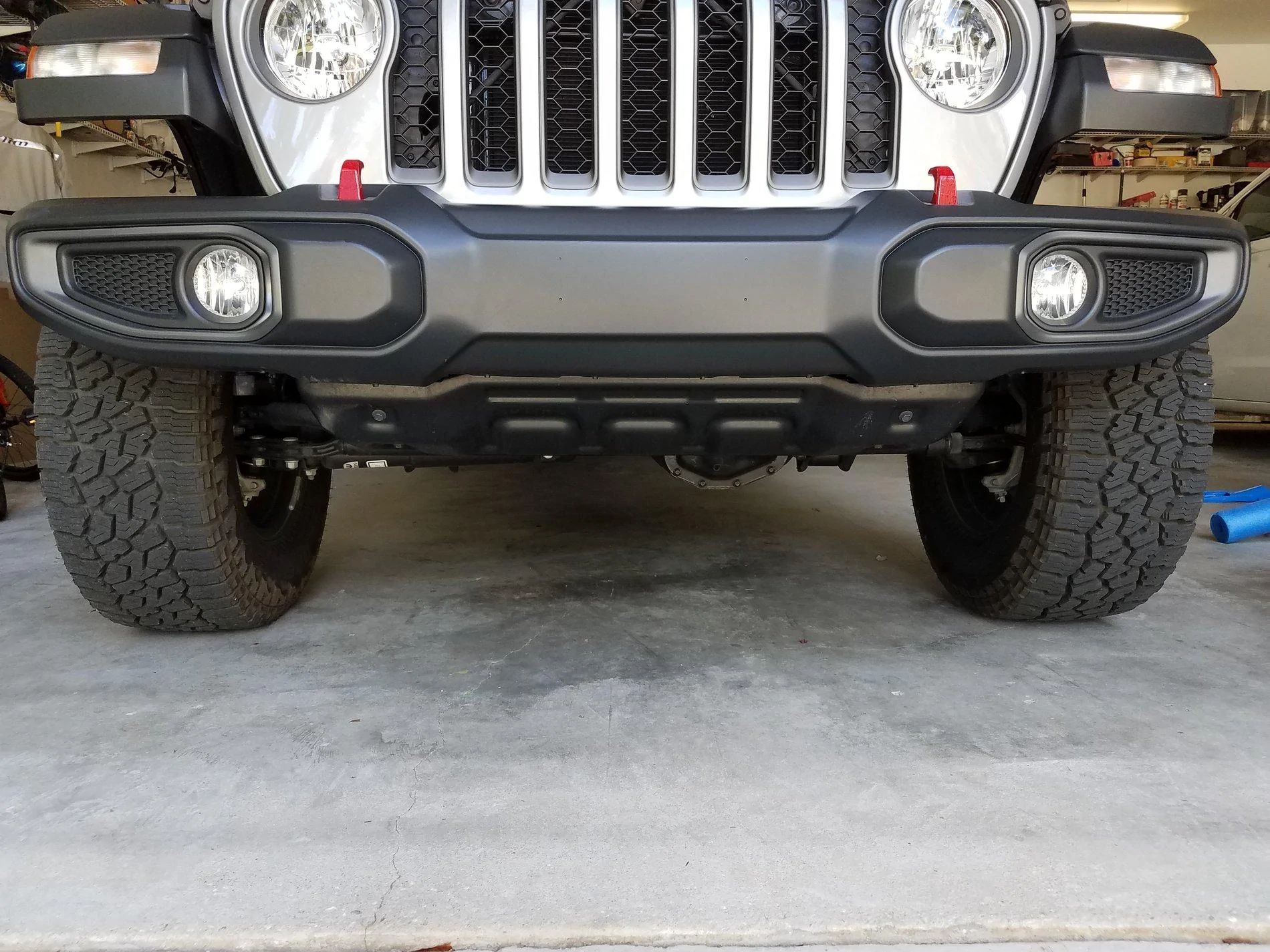

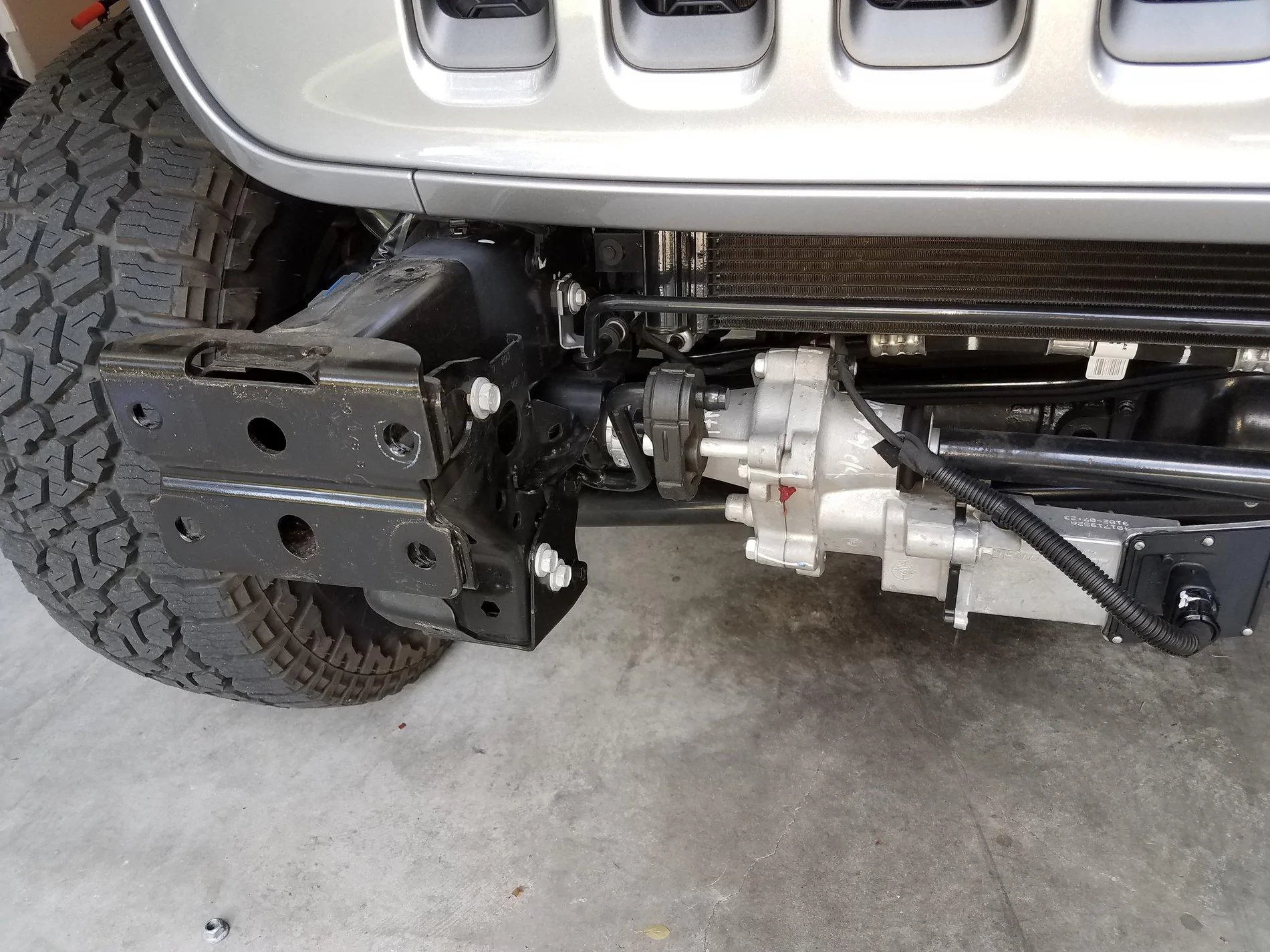

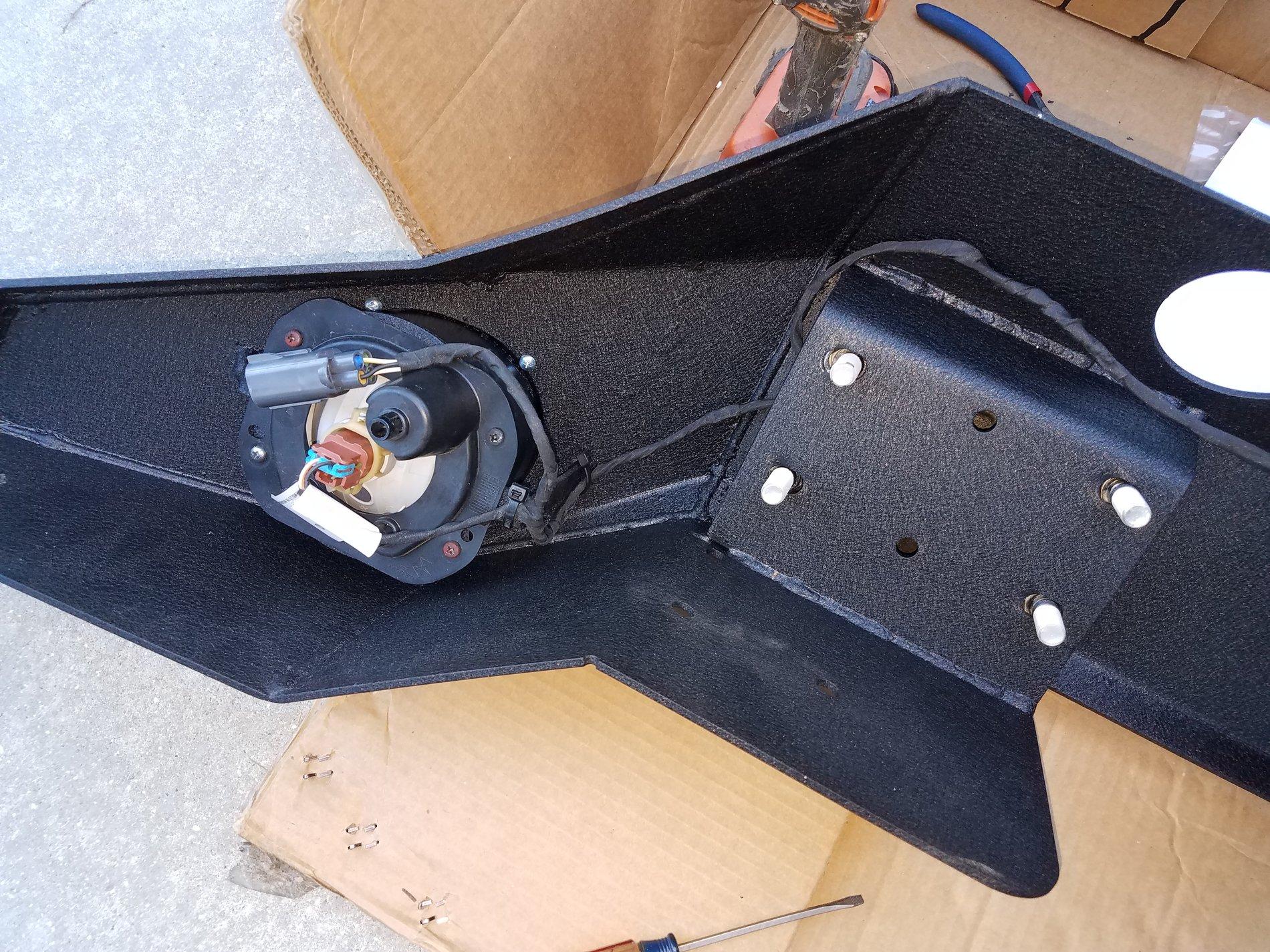

4 bolts and the skid pad is off. 2 plastic push pins at the top, then 8 18mm bolts, disconnect fog lights and the bumper comes off. Remove the fog lights and install on new bumper.
Jeep Gladiator EAG Bumper install with Apex Winch 20200721_165120
Jeep Gladiator EAG Bumper install with Apex Winch 20200721_171721
Jeep Gladiator EAG Bumper install with Apex Winch 20200721_182656

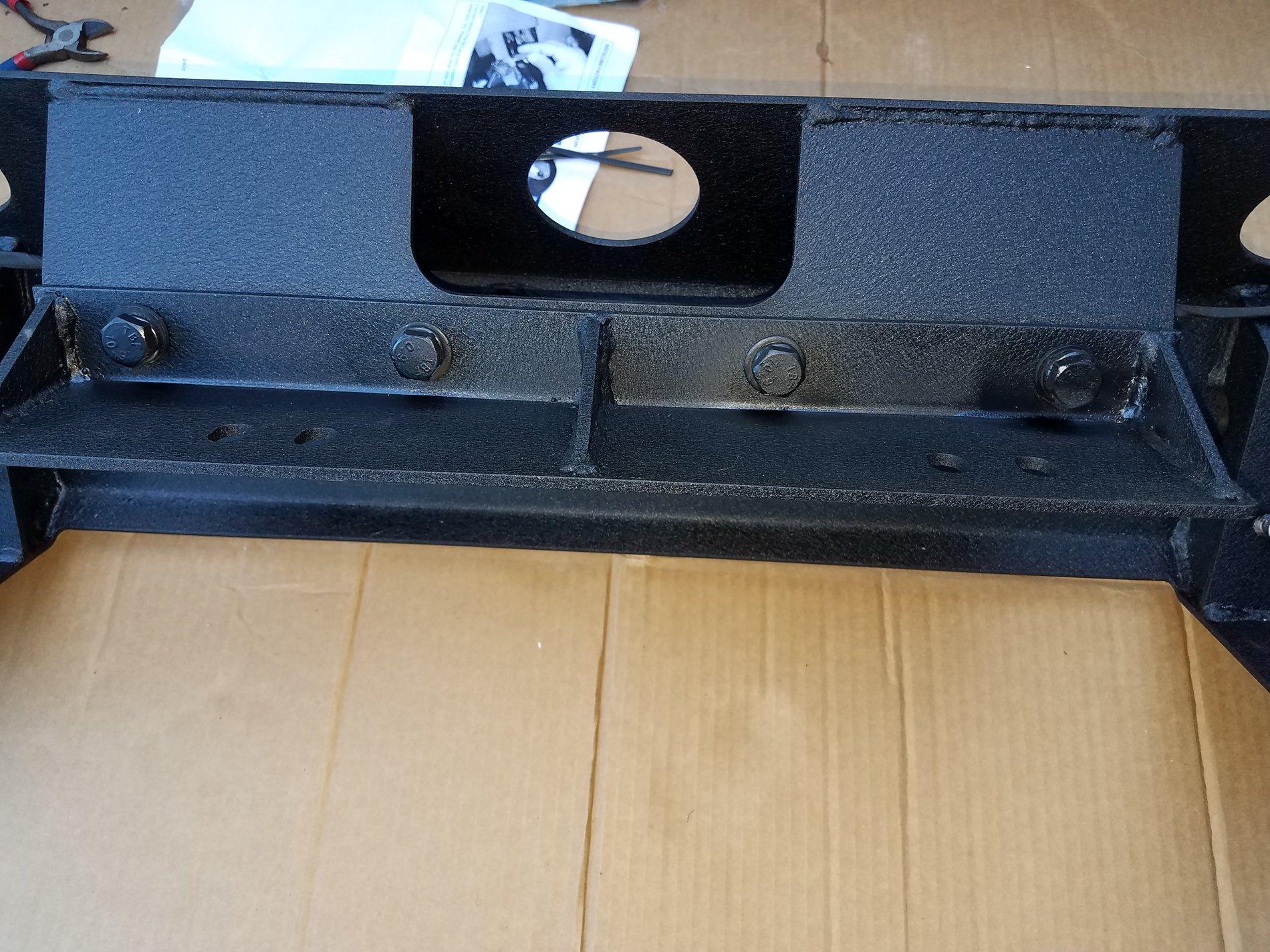

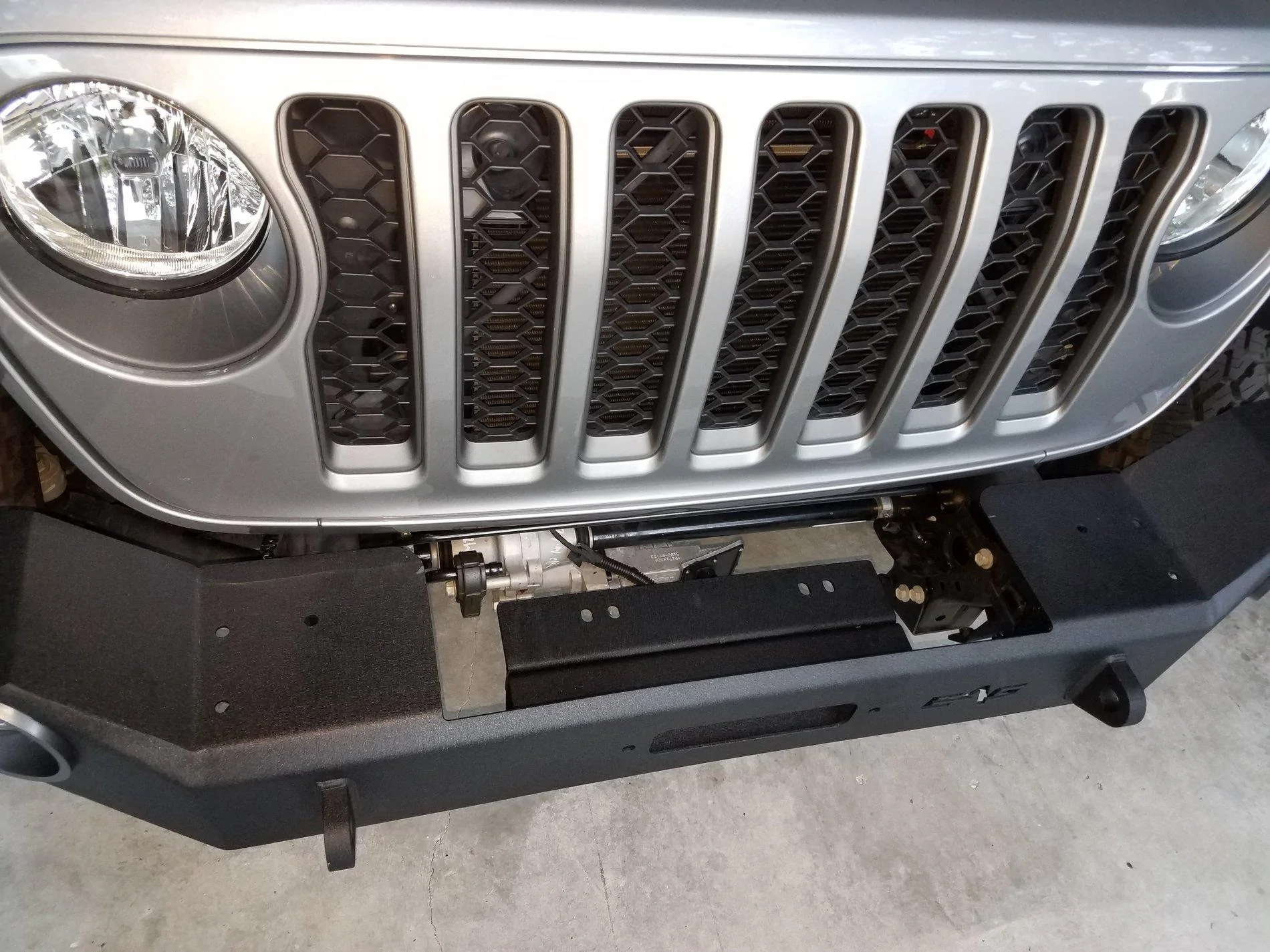

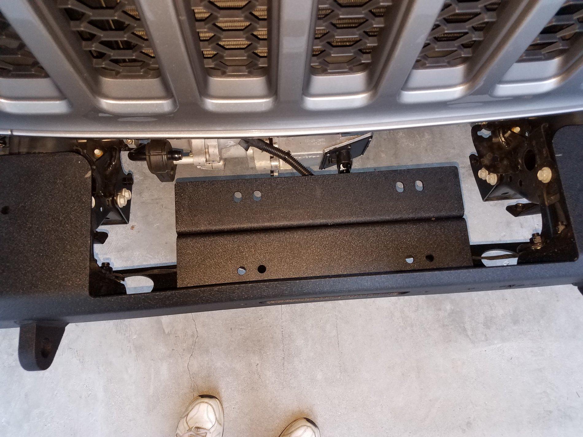

Bolt together the winch plate and install
Jeep Gladiator EAG Bumper install with Apex Winch 20200721_182700
Jeep Gladiator EAG Bumper install with Apex Winch 20200721_182704
Jeep Gladiator EAG Bumper install with Apex Winch 20200721_190702

Open area for winch. Reinstall skid plate with no need for modifications.
Jeep Gladiator EAG Bumper install with Apex Winch 20200721_190906
Jeep Gladiator EAG Bumper install with Apex Winch 20200721_190910
Jeep Gladiator EAG Bumper install with Apex Winch 20200722_070026

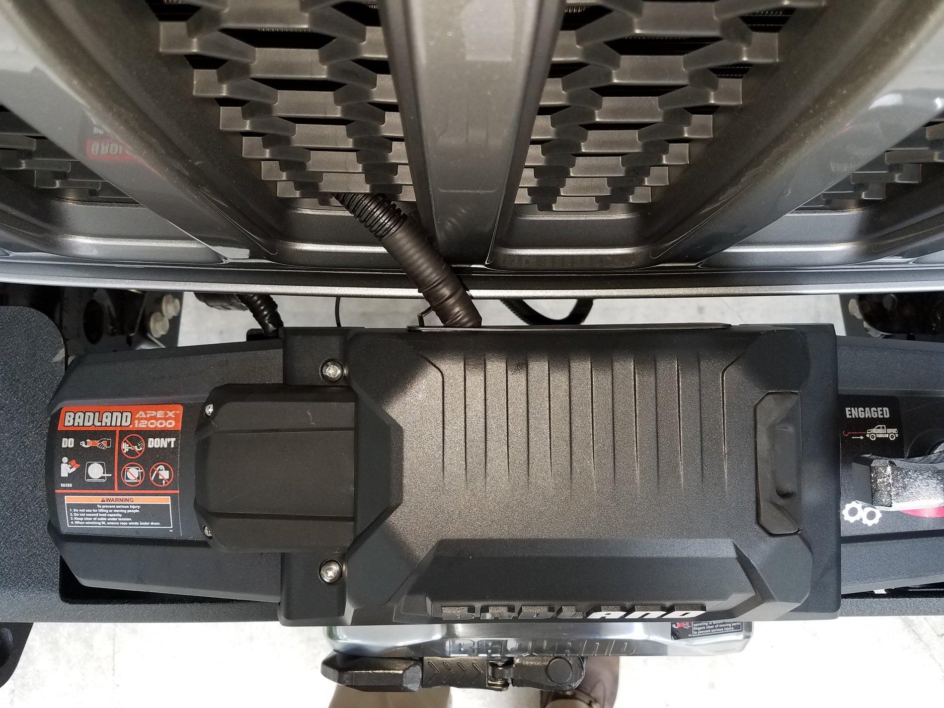

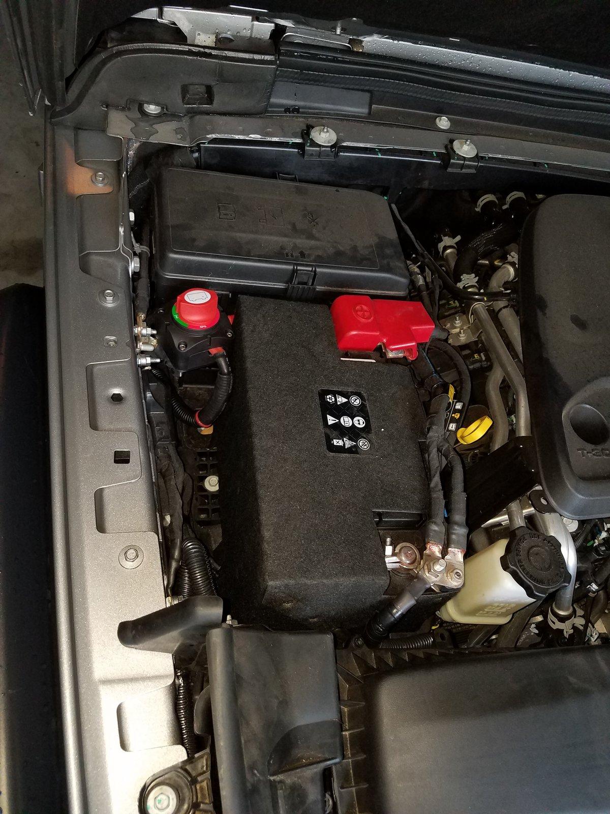

Wiring with shutoff.

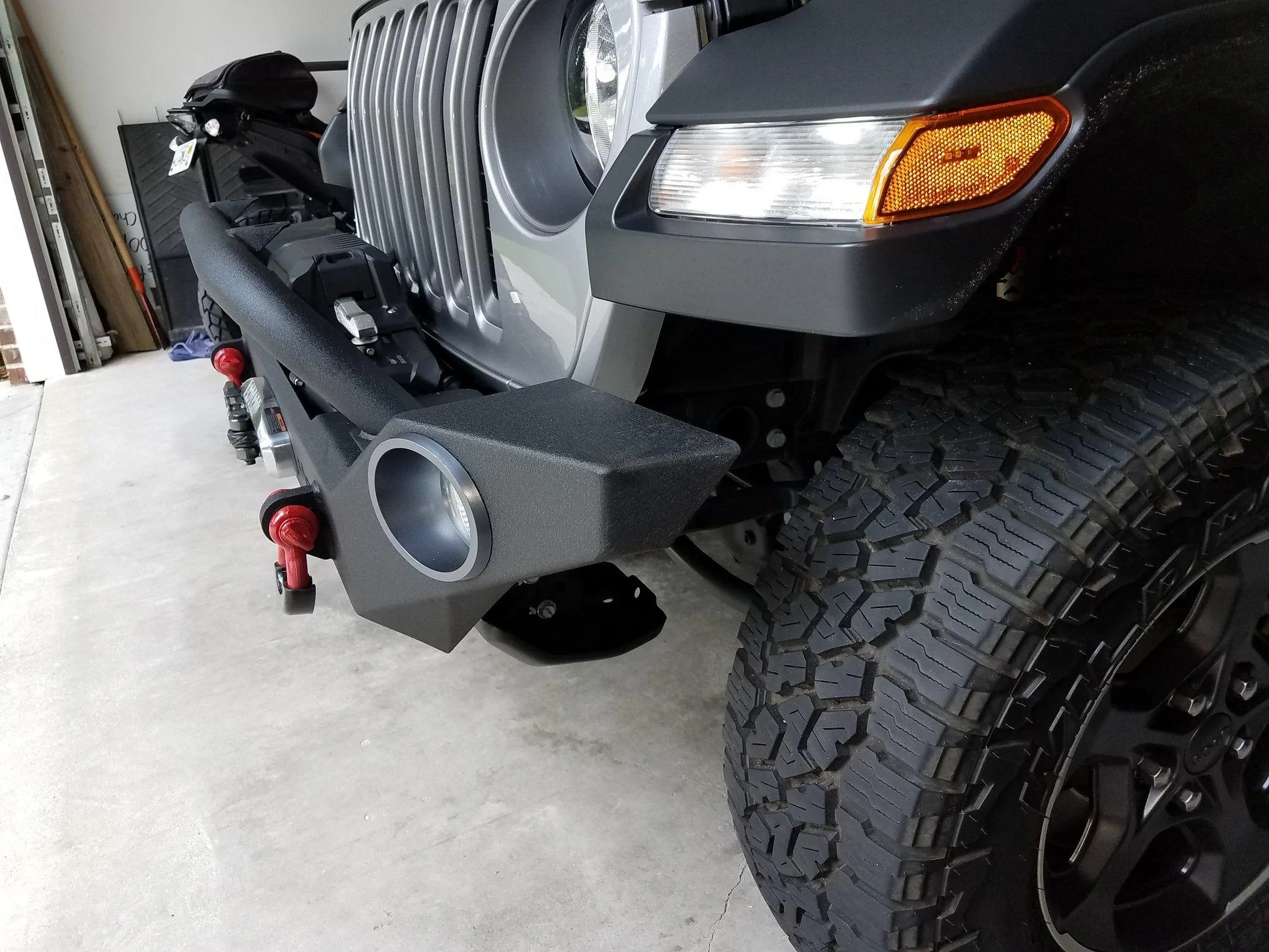

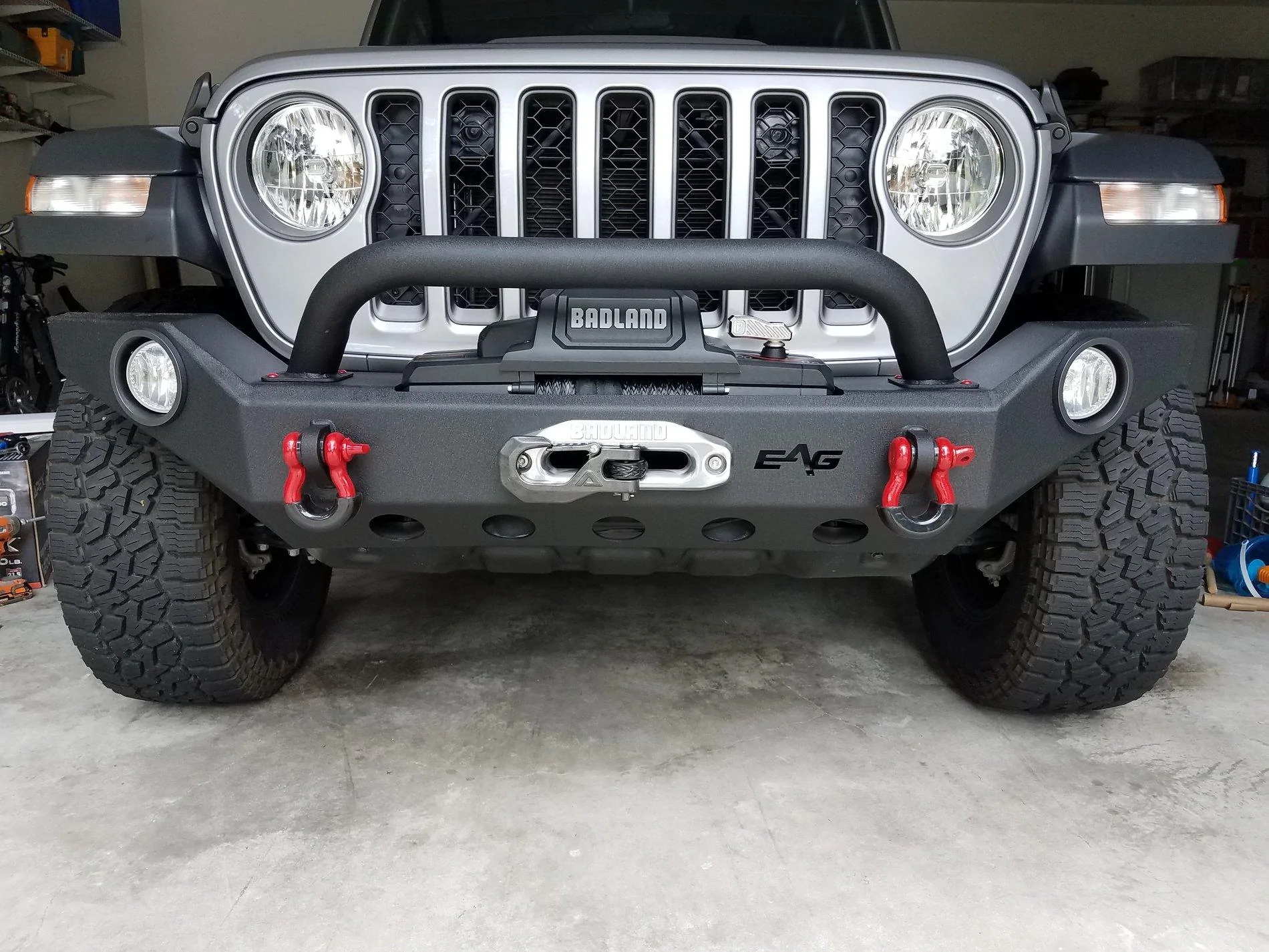

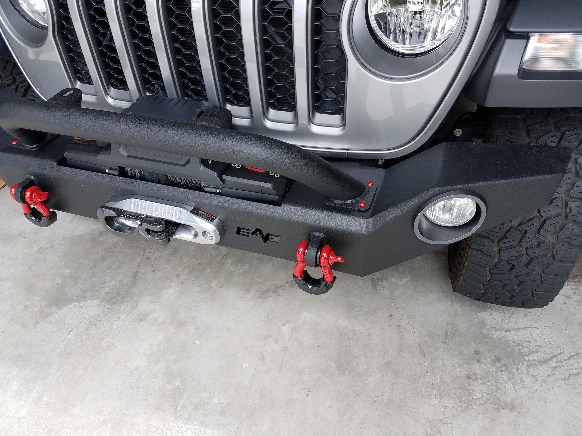

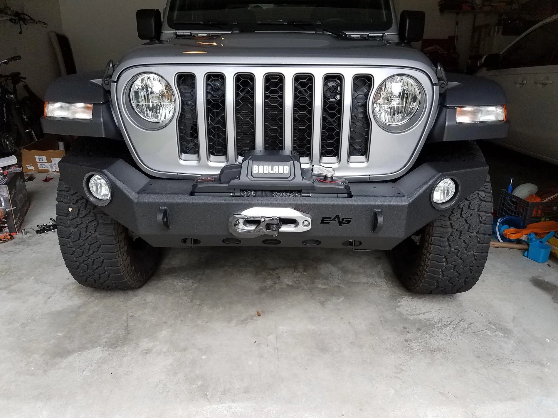

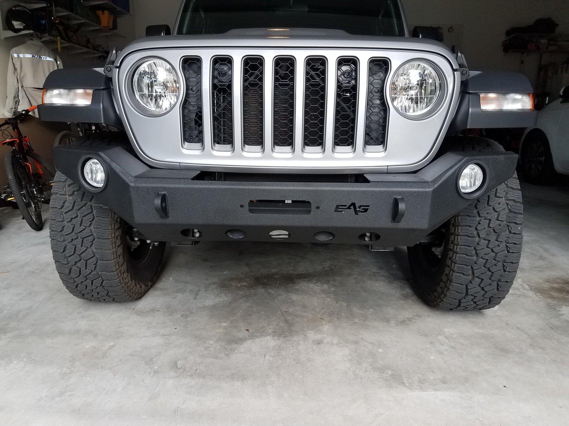

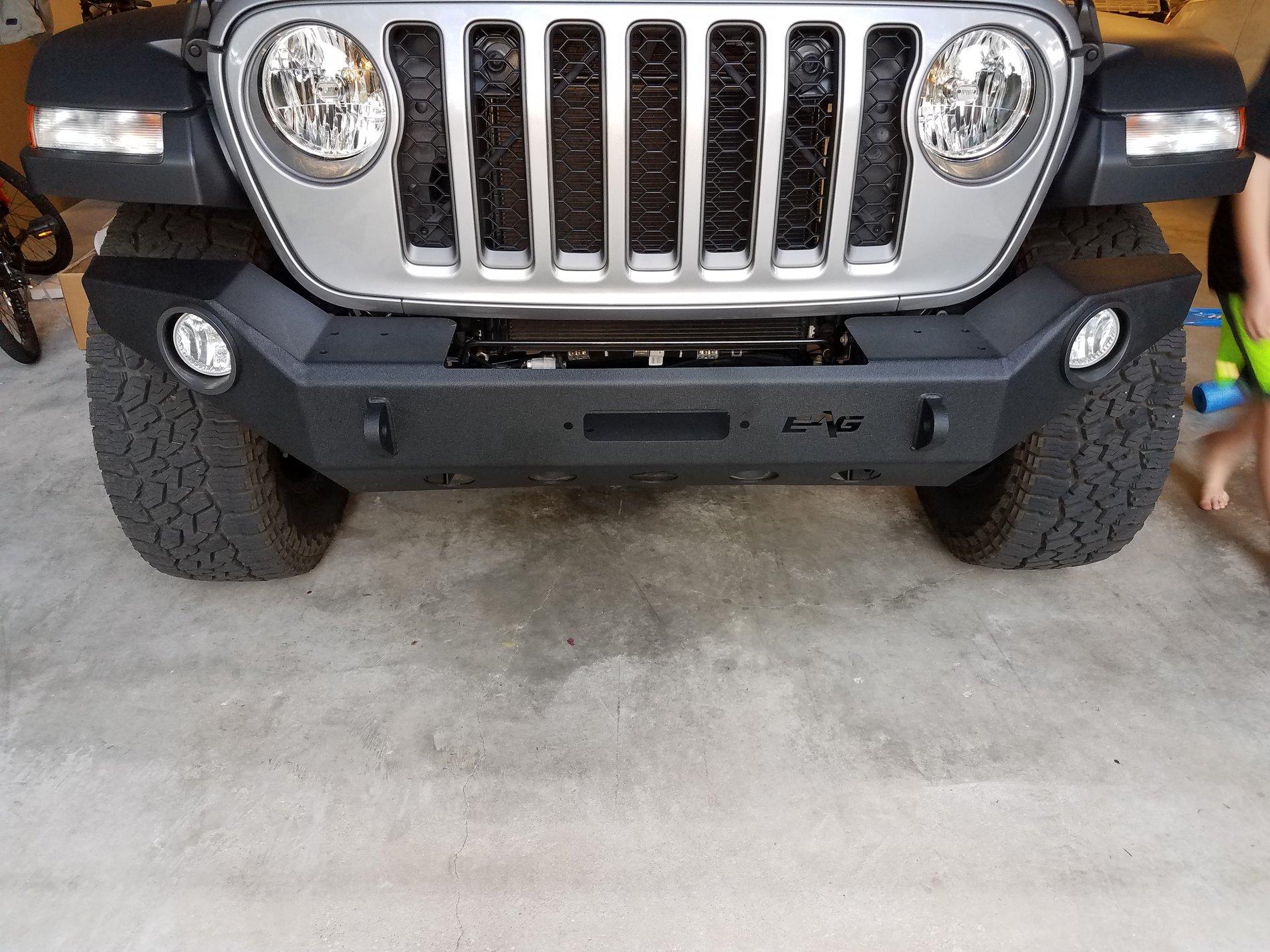

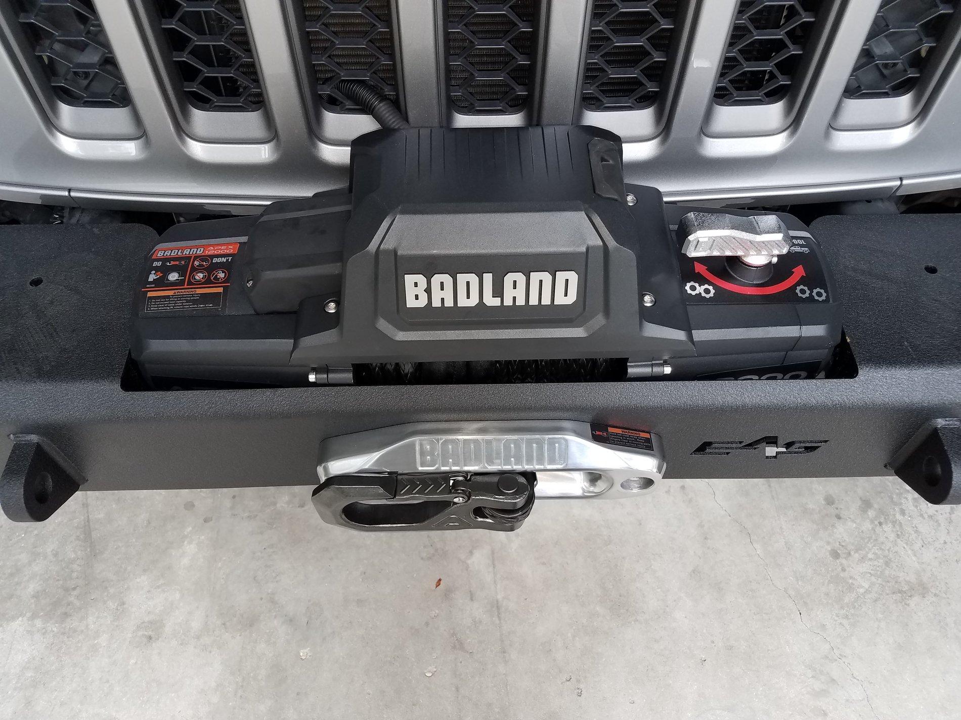

Finished up the details.
Jeep Gladiator EAG Bumper install with Apex Winch 20200725_114844
Jeep Gladiator EAG Bumper install with Apex Winch 20200725_114852
Jeep Gladiator EAG Bumper install with Apex Winch 20200725_114858

I don’t care shat anyone says the red bolts mounting the bull bar is s nice touch! Size of winch is nice doesn’t block too much airflow.looks great and reasonable also!.....Jack

Thanks for this. Getting ready to do this. Any more info on the power hookup/battery cutoff switch?
