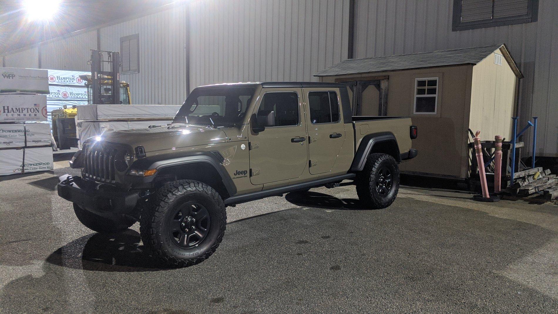

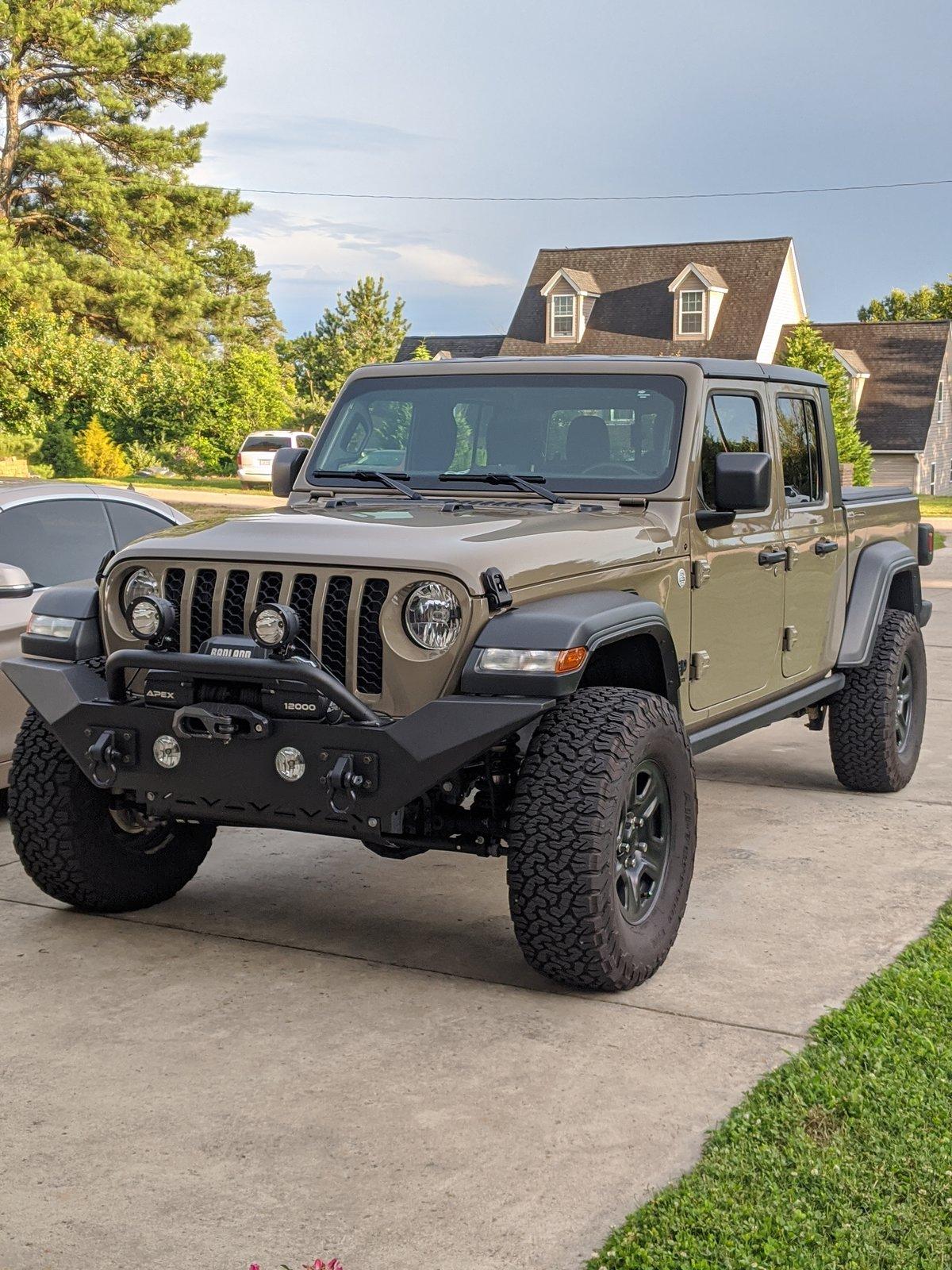

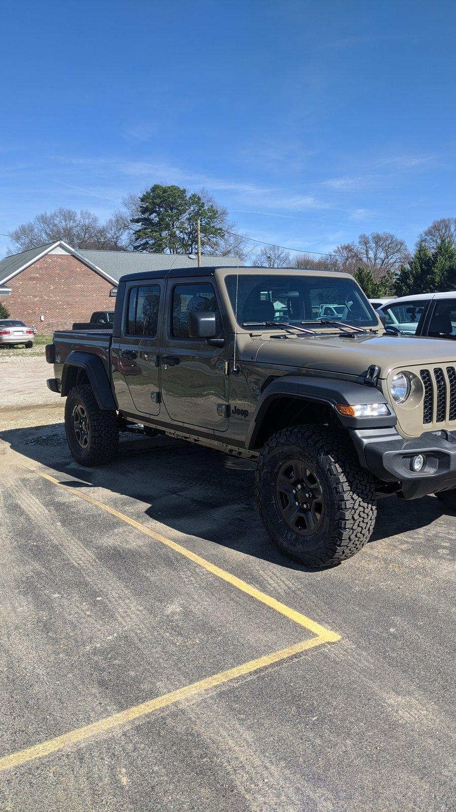

It will not. I have the Readylift SST lift kit installed on mine. The JT already sits higher in the back than in the Front. Once you install that lift kit it will be sitting pretty much level. If you put a 1" spacer in the rear your going to be sitting about 1.25" taller In the back. The JT comes from the factory with factory rake to allow for towing. You will be fine with just that kit.
I included a few pictures of mine with and without the bumper and winch installed to give you a idea. I see your in Charlotte NC, I'm about 20 minutes up the road from you in Kannapolis.
