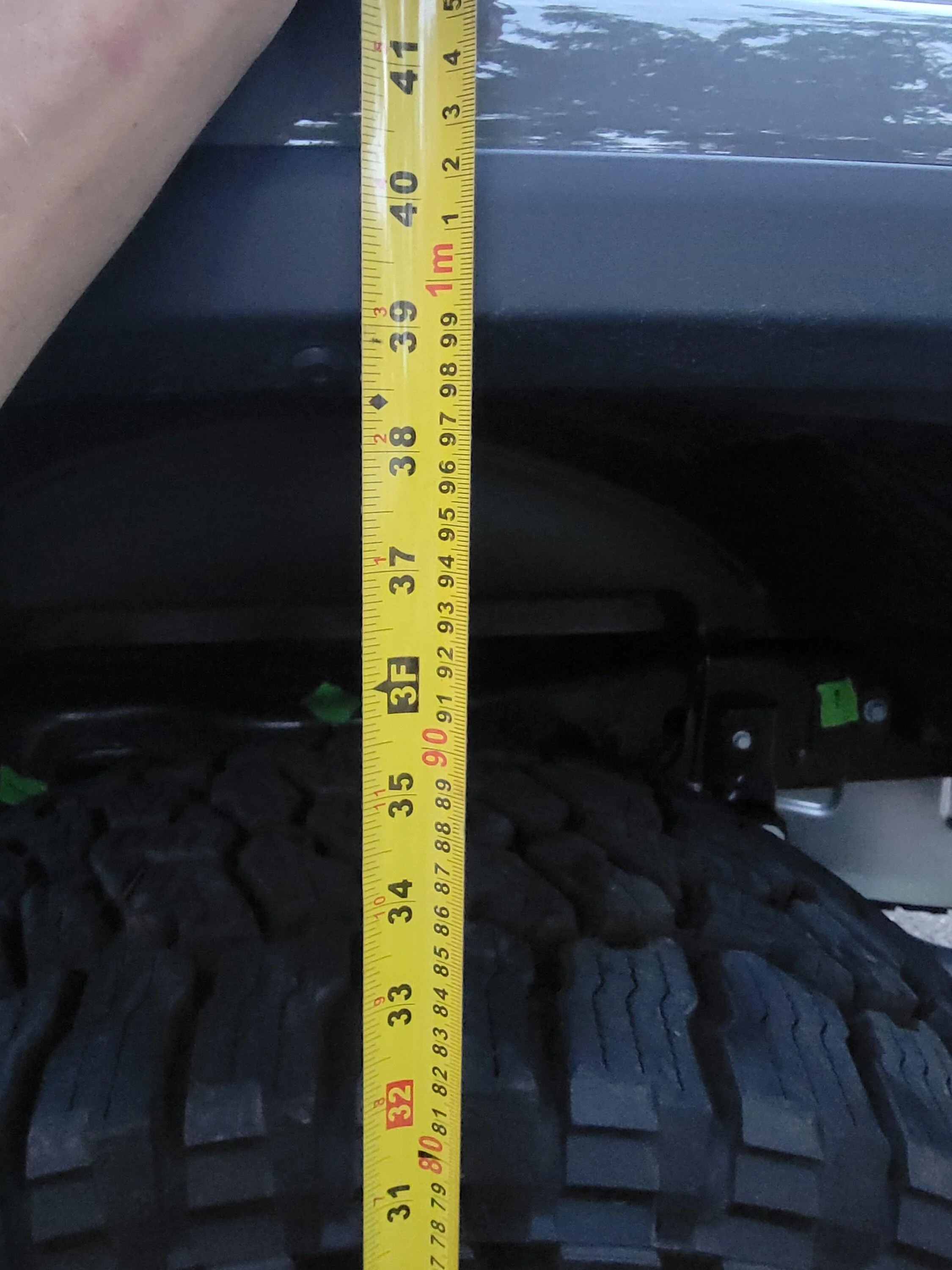

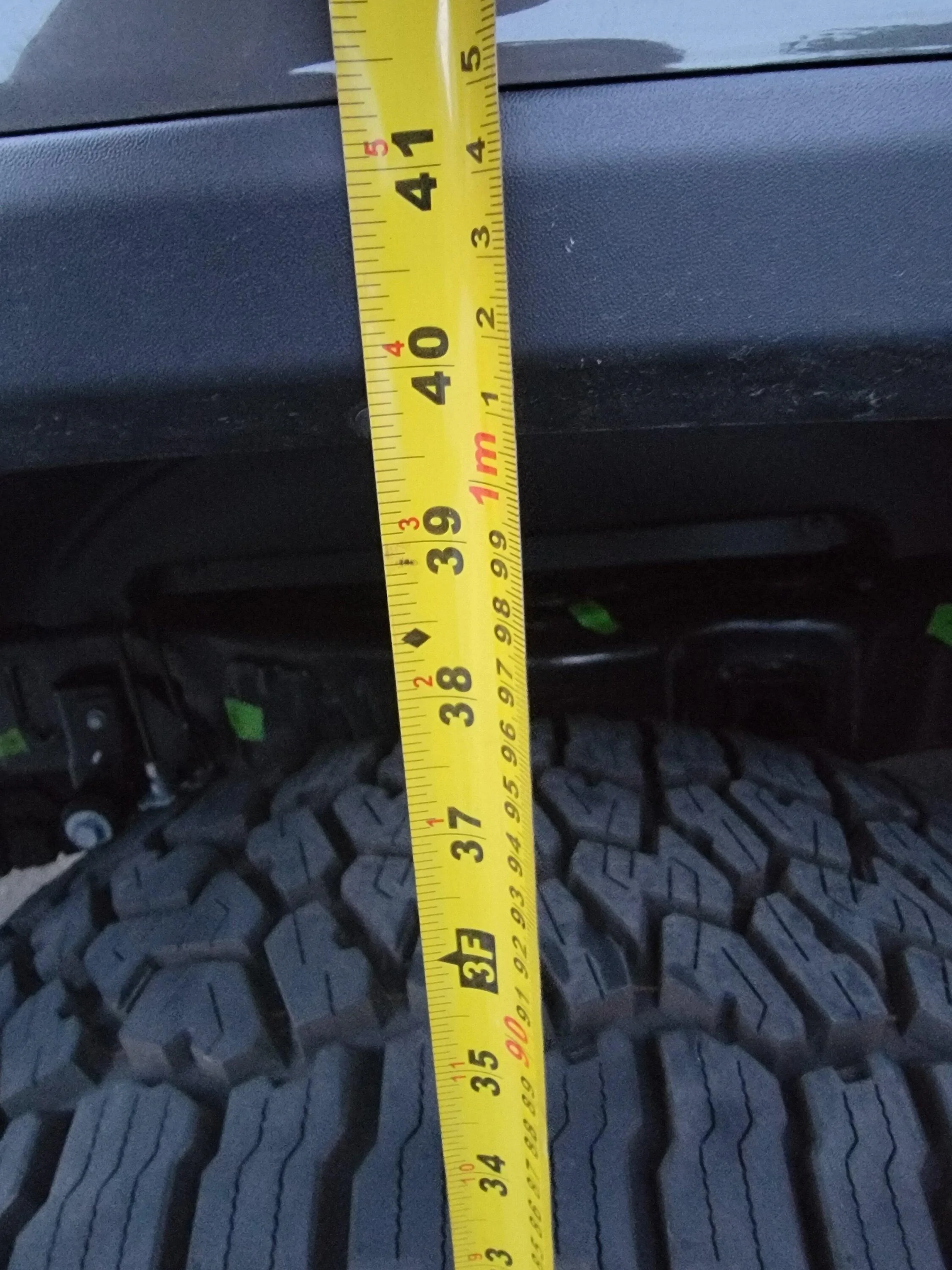

Took it to a Food Lion parking lot. Measured from the center of the wheel to the fender flare on both sides and the measurement was 22 and â…žths on each side. And from the ground to the fender flare was 38 and â…› th on each side.
