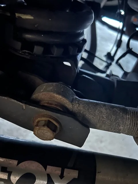

Hello, at some point my jks trackbar came loose and driving it caused the hole on the passenger side where the track bar connects to become larger which causes clanking and steering box movement. A 4x4 shop in my area recommended getting it welded but I was thinking a track bar bracket would do the same. I ordered the super lift track bar bracket but it goes on the driver side. Is anyone aware of a bracket made for mounting on the passenger side? Thanks in advance. Sam

My MC Trackbar relocation bracket wants to be retorqued every 2500 miles. SO this time red loctite and more ugga duggas.
BUT I'm at that point when I have the front axle trussed, I'm having it all burned in and done with it.

Is it actually egged out? Might get away with 9/16" hardware the hole was actually drilled for but they put in a undersize 14mm metric hardware that relies on the clamping force.

Thanks, I'll try this.
