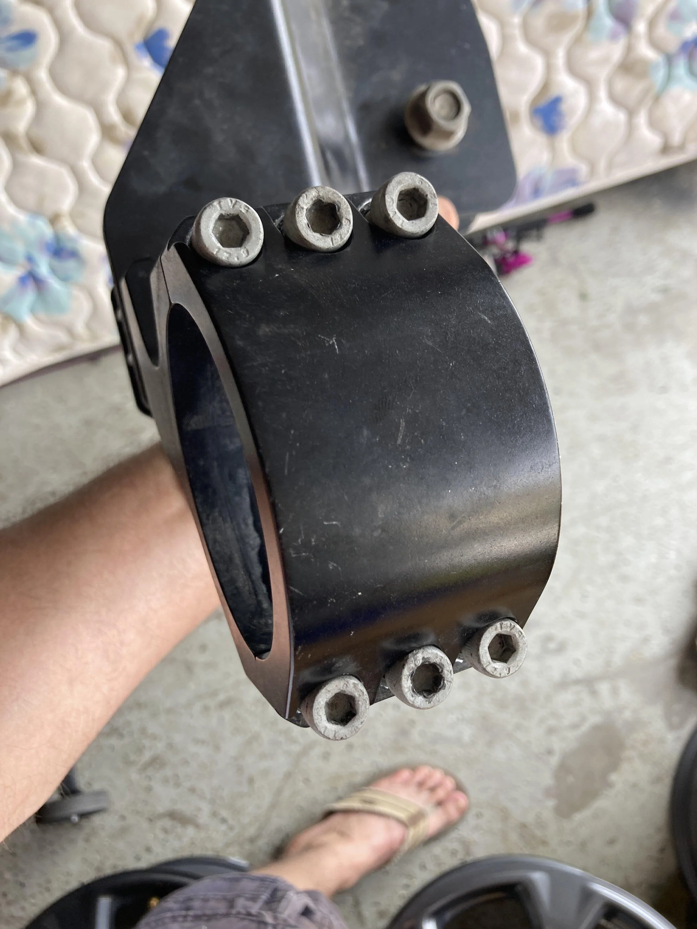

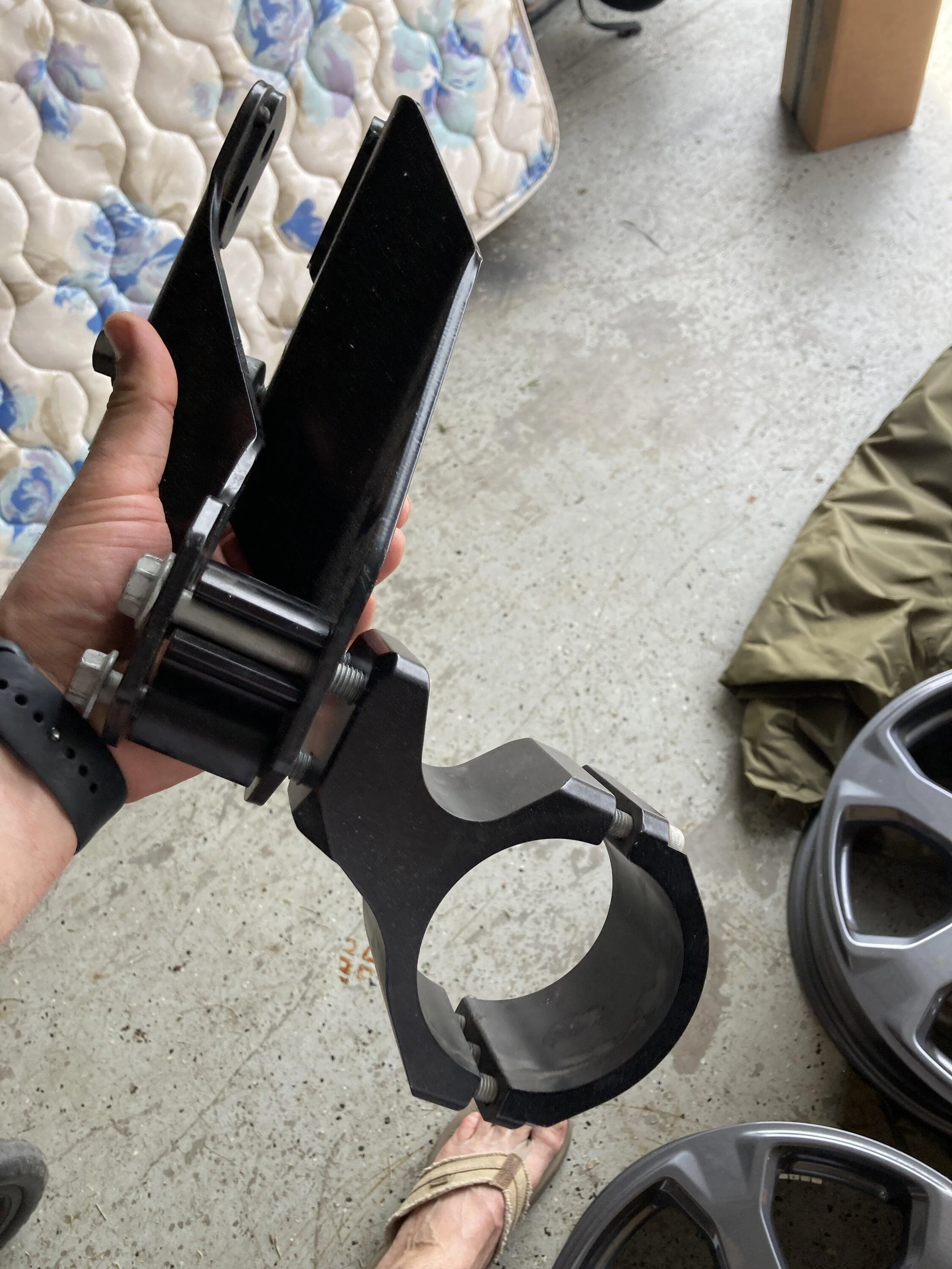

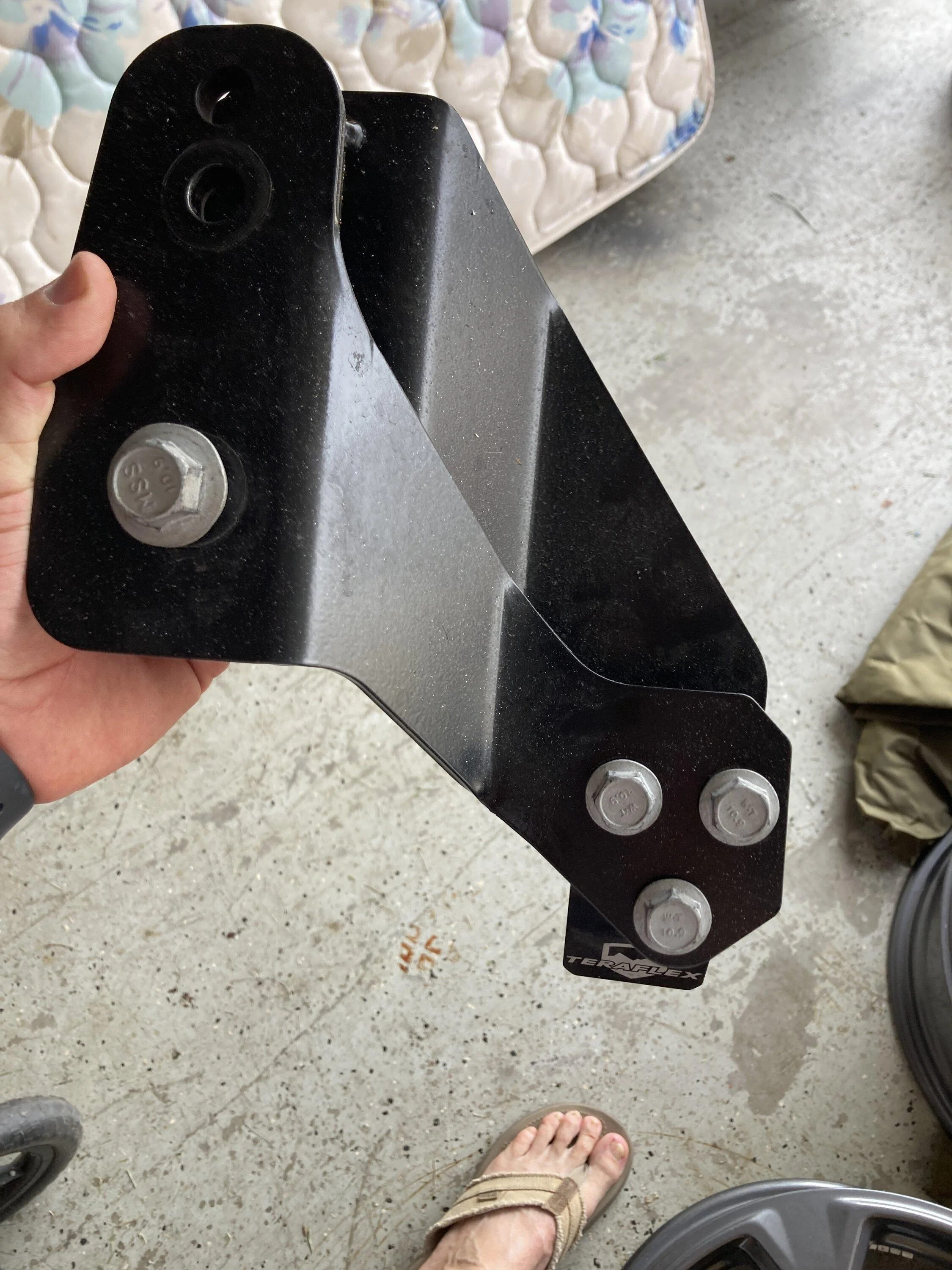

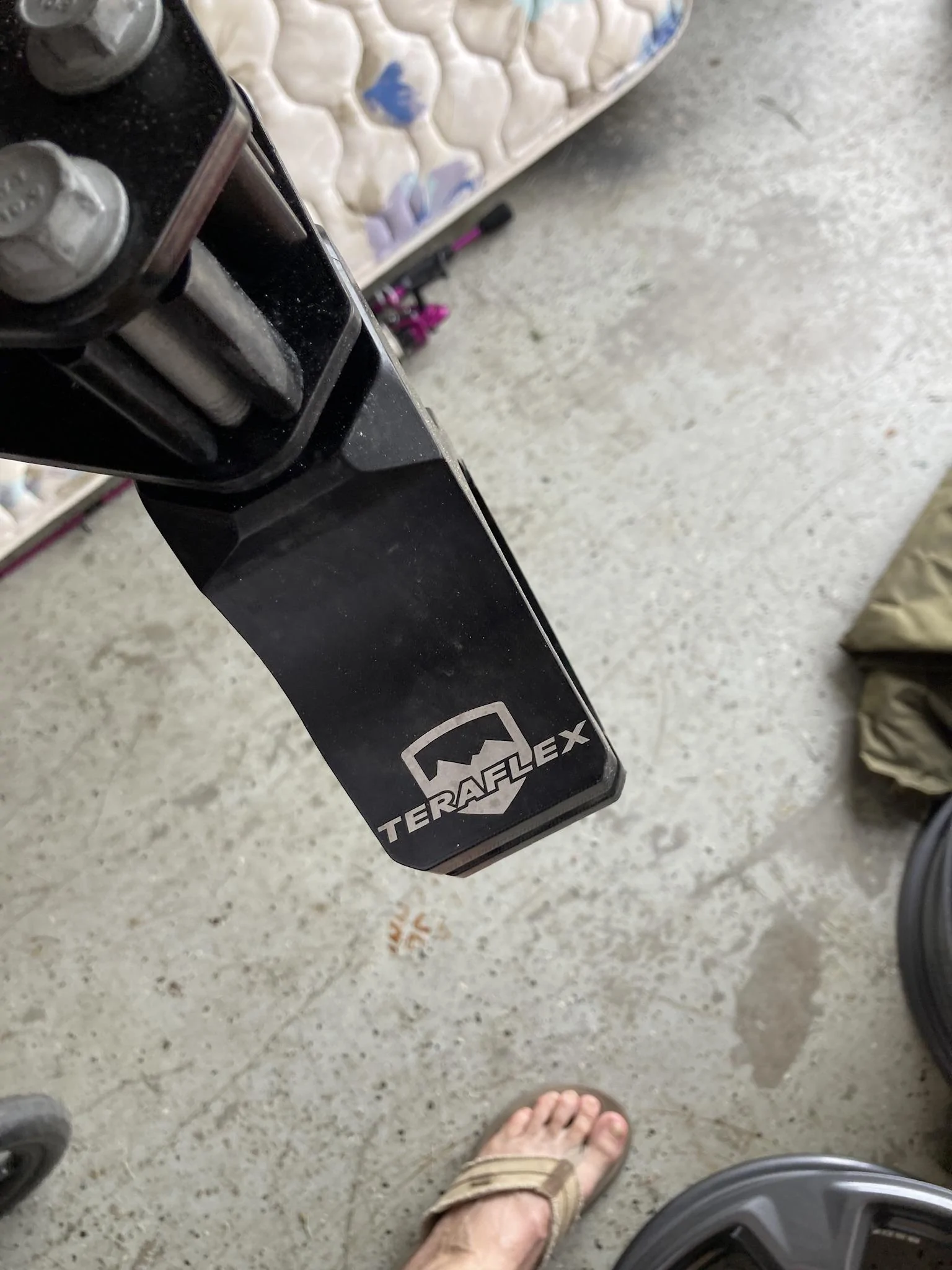

If anyone else is interested I have one I took off.
I only have a 2in lift and the bracket took the bar from a slight downward angle from the tuck to the axle…to the axle ens being a little higher. Not sold it made any real difference for me.
If no one wants it I may chuck it back on..who knows.
