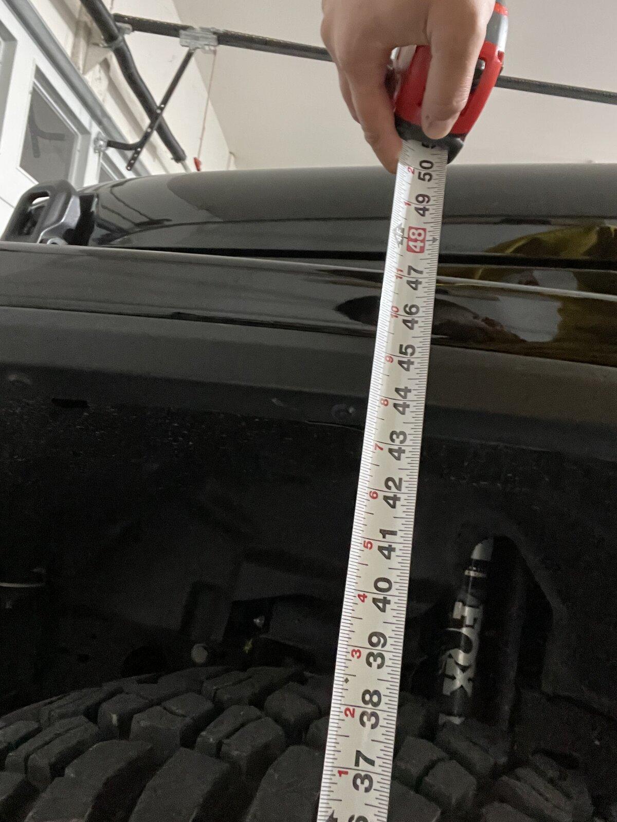

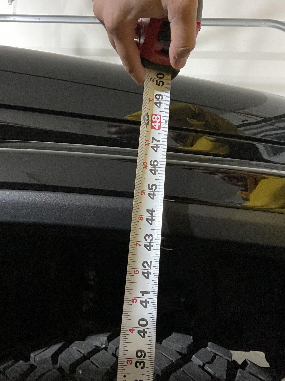

My shop and I cant quite figure it out either. I have a Clayton lift and there is a noticeable lean as well. @Claytonoffroad says there is not a difference in their driver / passenger springs? My shop actually told me they put a 1.5” puck on the passenger side and we are still having a lean. It’s going back in Friday.
Jeep Gladiator Serious lean on passenger side 57EE2A24-995F-4773-8F07-A586DEAEBDAC
Jeep Gladiator Serious lean on passenger side E798110F-07DC-4CFE-A133-B68FD12249C1

Crazy! None what so ever? Ground to fenders is the exact same ?

Any solutions found on this? I am 1" lower on the passenger side with a 2 1/2" Clayton Overland lift.

yep.. same man.. I was told metalcloak makes shims you can possibly put in but I haven’t messed with anything.. I have been told the OEM coils have differences (passenger coil part # is higher than driver side) @claytonoffroad is it possible this was missed when developing these coils?
