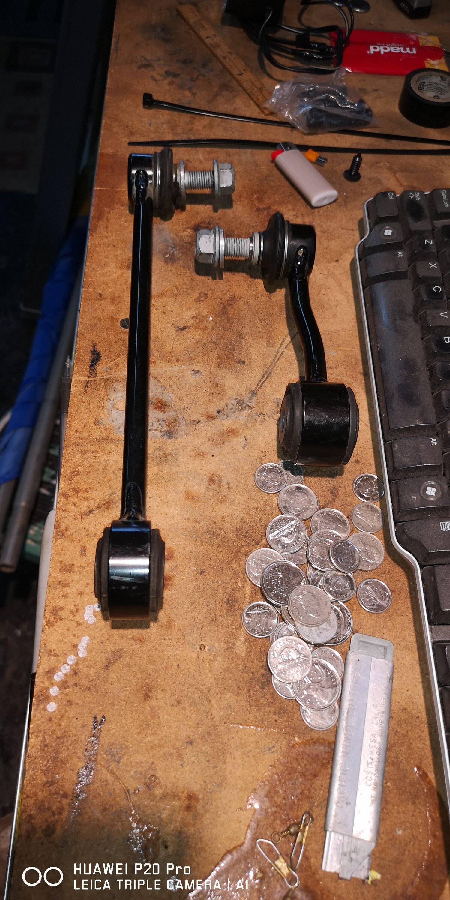

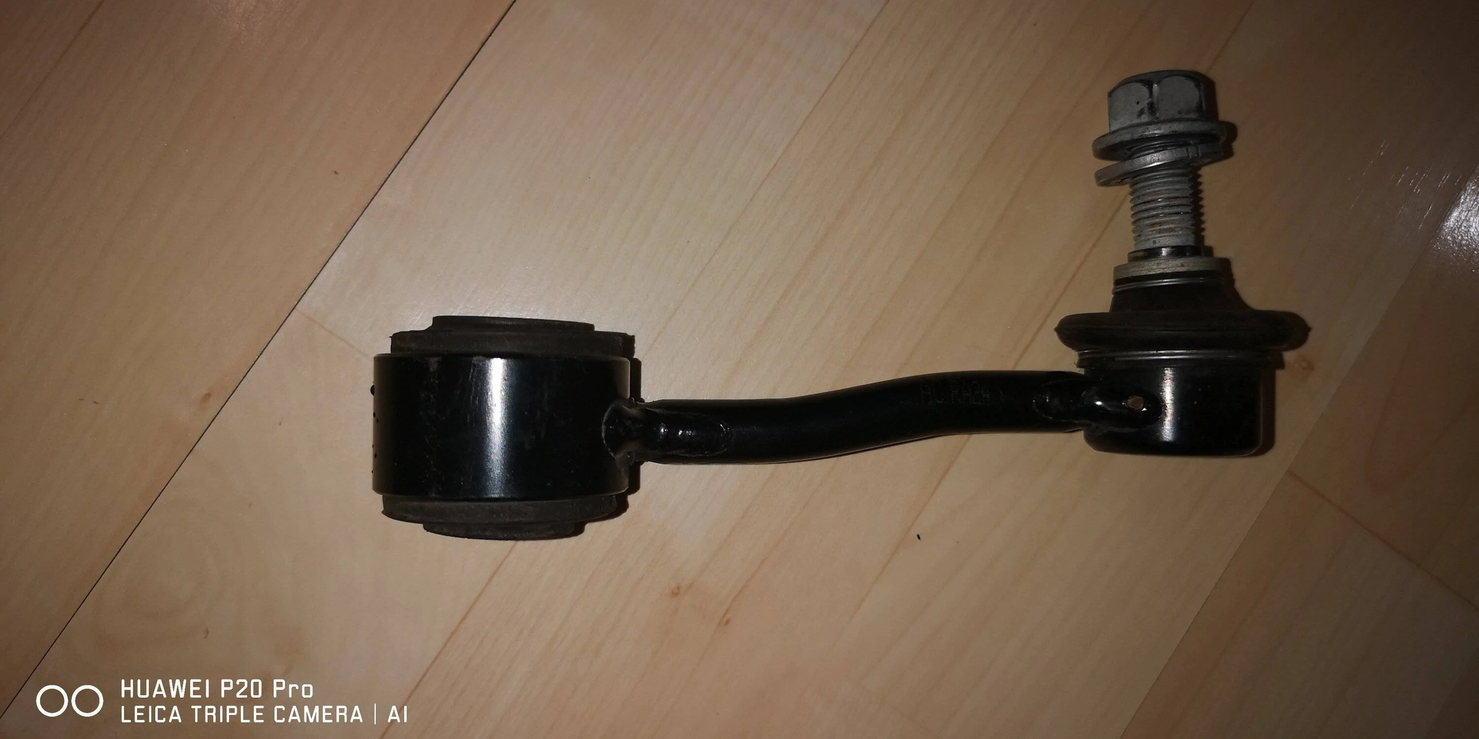

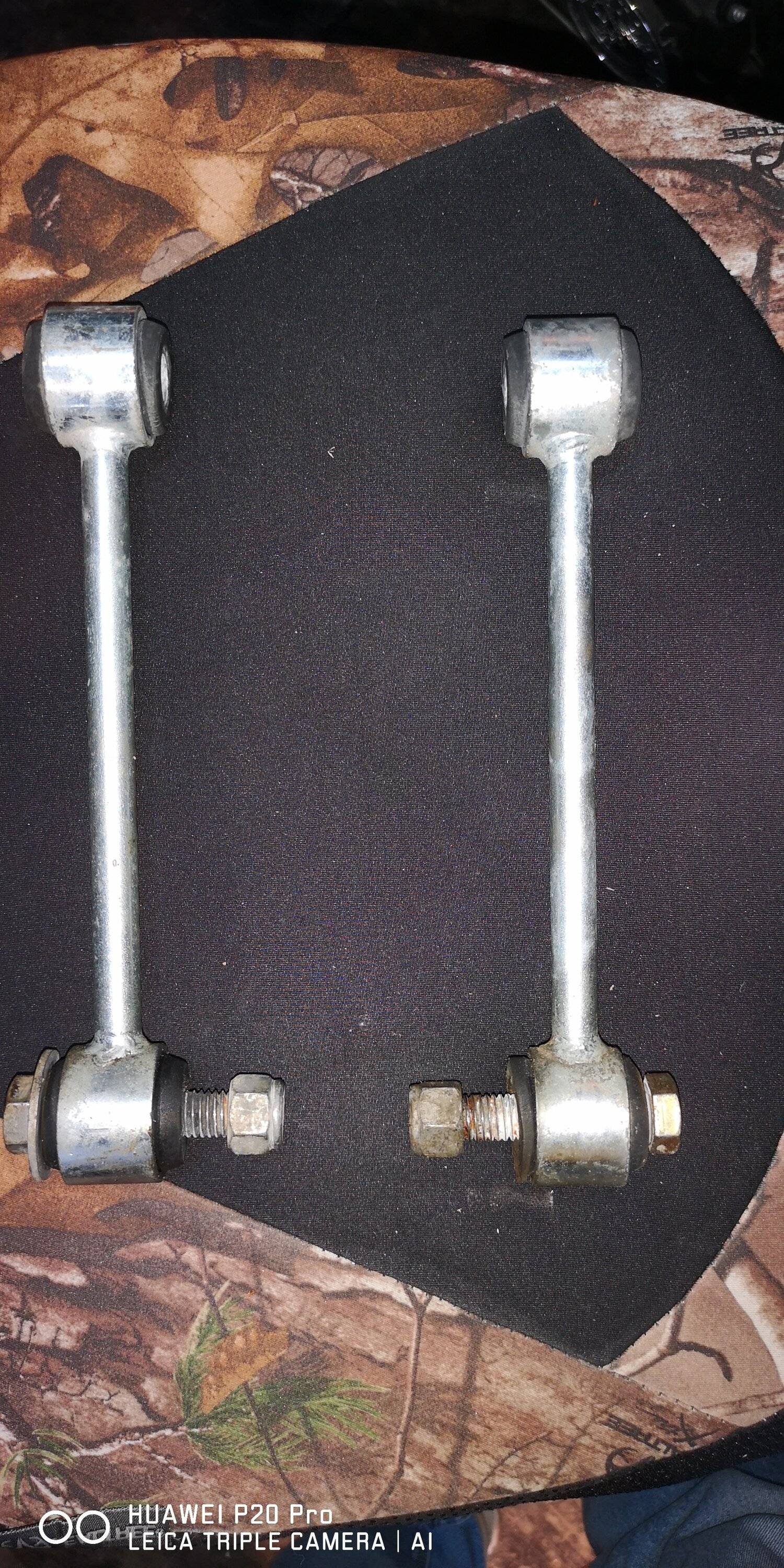

Recently had a Rubicon express 3.5 inch lift (JT7100T) installed on my 2022 Gladiator Sport S at 4WParts in Burlington, Ontario, Canada. Drove home to North Cobalt and a few days later could hear a clicking noise up front. Turns out the front sway bar linkages that came with the Rubicon express kit were straight and the OEM had a slight O/S to them. Emailed Rubicon express and no reply. I think 4WParts in Burlington is now closed. Not sure. No reply from them. Checked on Amazon and found a set of "Rancho" front sway bar links 8.75 inches C/C with a slight O/S.
