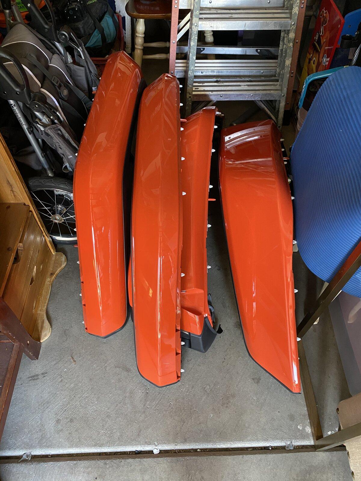

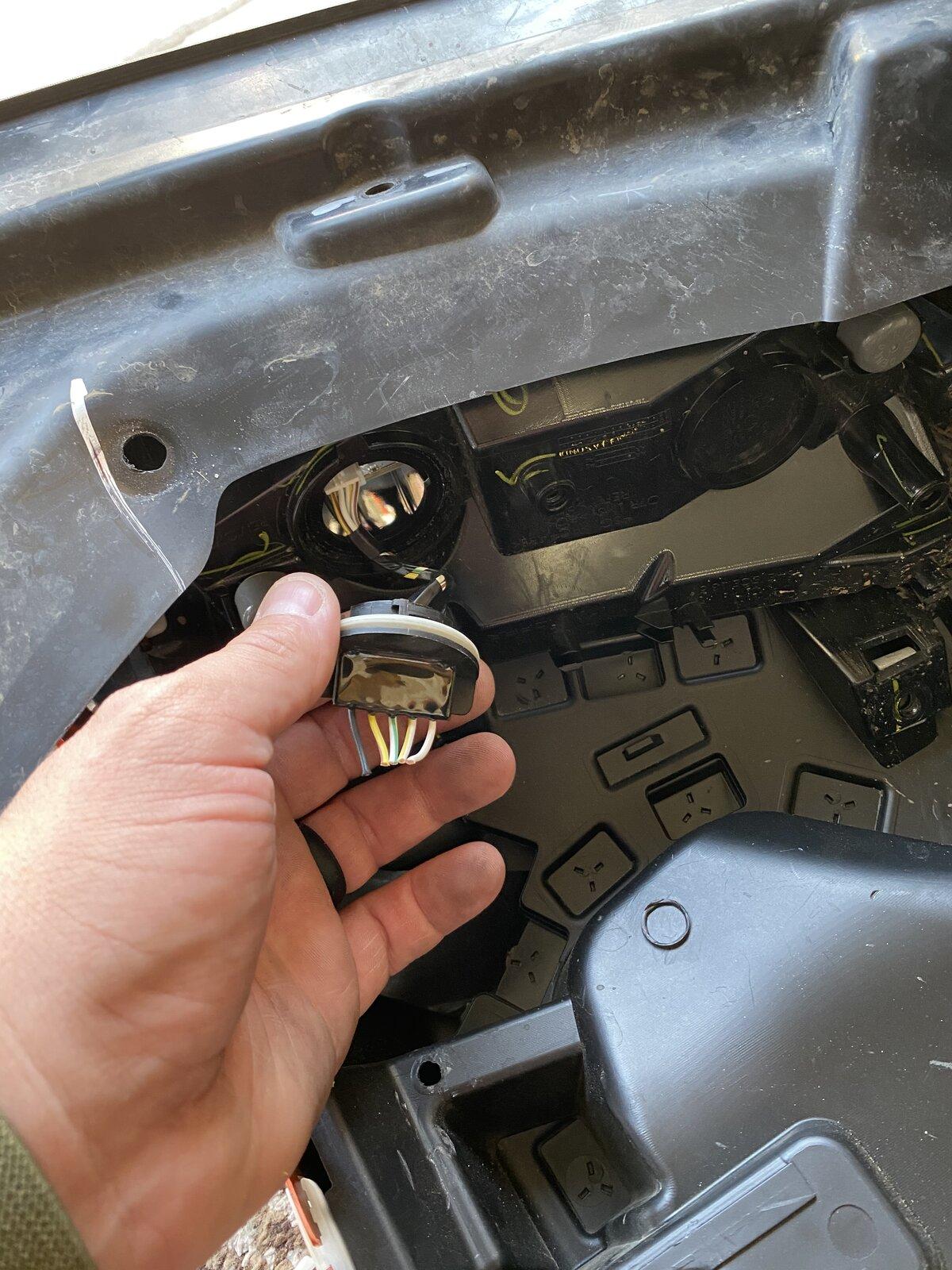

So I was just gifted a set of rubicon flares with the factory LED turn signals. The harness was cut so I’m curious on the best way to wire them so they work like factory. I have the Tazer allready so I can program for the LED. He is also giving me his Factory LED headlights after I help him install his nee ones. Win for me!

Any update? I purchase some used LED DRL's to install on my Willys and when I received them, the wires were cut. Just wondering what you ended up doing.

LAMP-DRL LEFT
Full Repair Kit: 68535912AA
No terminal repair kits have been identified.
End View
Jeep Gladiator Rubicon flare LED turn signal wiring help! 34899-6120
Isometric View
Jeep Gladiator Rubicon flare LED turn signal wiring help! 34899-6120_iso
Removal Tools
A specific removal tool has not been identified.
Pin Information
CavCircuitGaugeColorFunction
1L1450.75WH/OGLEFT SIDE MARKER CONTROL
1L5510.35BG/BNLEFT FRONT LIGHTING FAULT SENSE
2L610.75WH/GNLEFT FRONT TURN LAMP DRIVER
3Z9050.75BKGROUND
4L770.75WH/BNLEFT FRONT PARK LAMP DRIVER
5L580.75WH/YELEFT DRL LAMP DRIVER
6Z9050.75BKGROUND
This is for the drivers side from the harness plug. You can get aftermarket LED lamp assemblies too.
