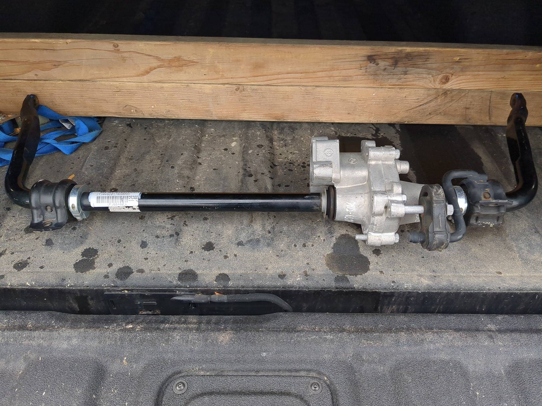

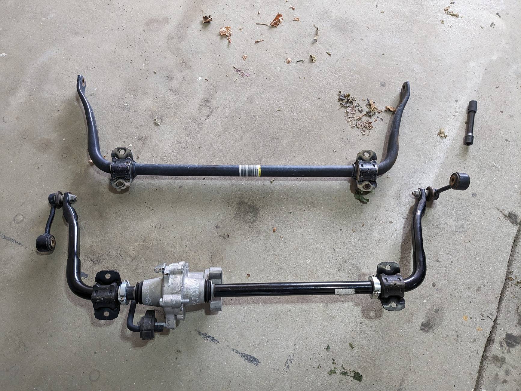

I want to change the sway bar on my JT sport s with 1 from a rubicon. Will a JK or JL rubicon sway bar fit on the JT? Or do I have to use a JT rubicon sway bar? I‘ve been told that a JT will fit on a JL, but will a JL fit on a JT?

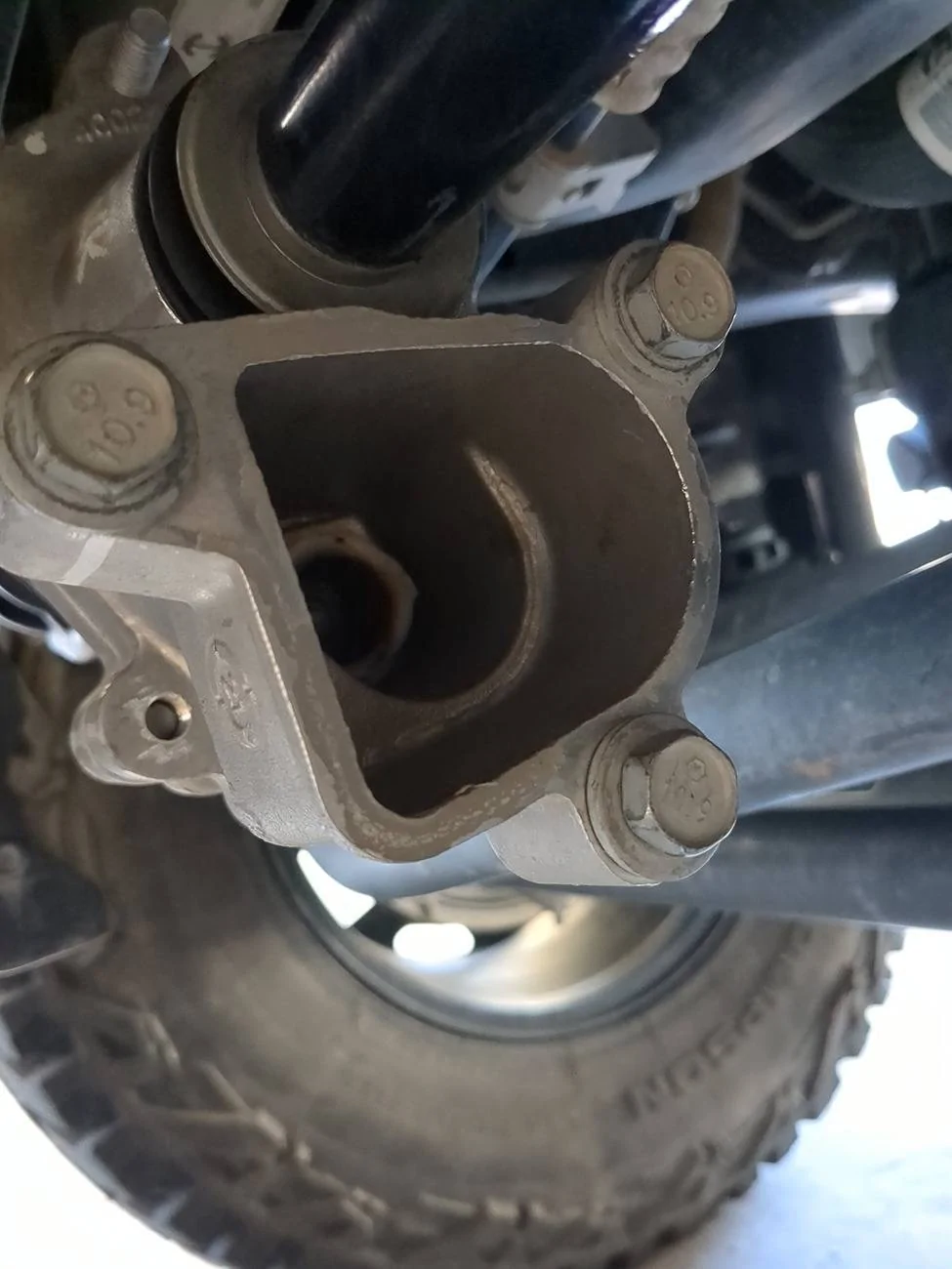

JK will need modifications to the mounting bracket for clearance, it will work, but not a straight easy bolt on. The JL/JLU will bolt up zero modifications needed. Lots of manual knobs to engage/disengage that are under $30.
