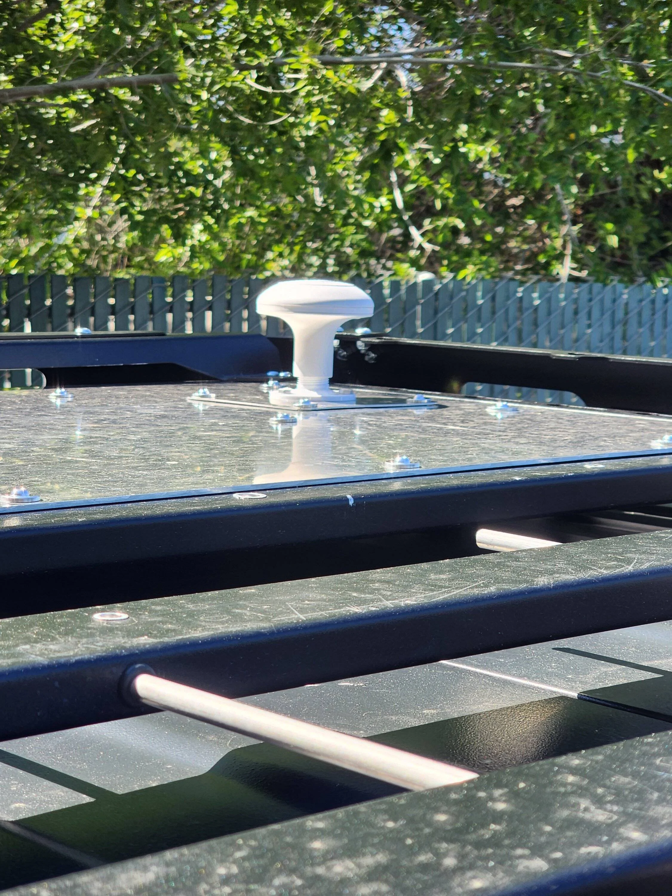

I disconnected the old satellite antenna at the yellow plug like in the other guys thread. I ran it behind the fascia of the sound bar, wrapped the extra length of cord around two pillars in the side fascia of the sound bar and along the covering on top of the door. At the door I ran it onto the overhead storage I have and then out through a waterproof hole I had drilled on the driver's side freedom panel. Then back through aluminum tubing I had installed through the cross bars of my roof rack back to the antenna.

Aluminum tube carrier for antenna wire.
Jeep Gladiator Sirius/Satellite Antenna 20230701_173522

Nothing has leaked so far. It was a longer process making backing plates for the glands so that I didn't have to rely on screws in fiberglass to hold them on. They are backed with rubber washers and sealed around the bolt holes with silicone as well.
