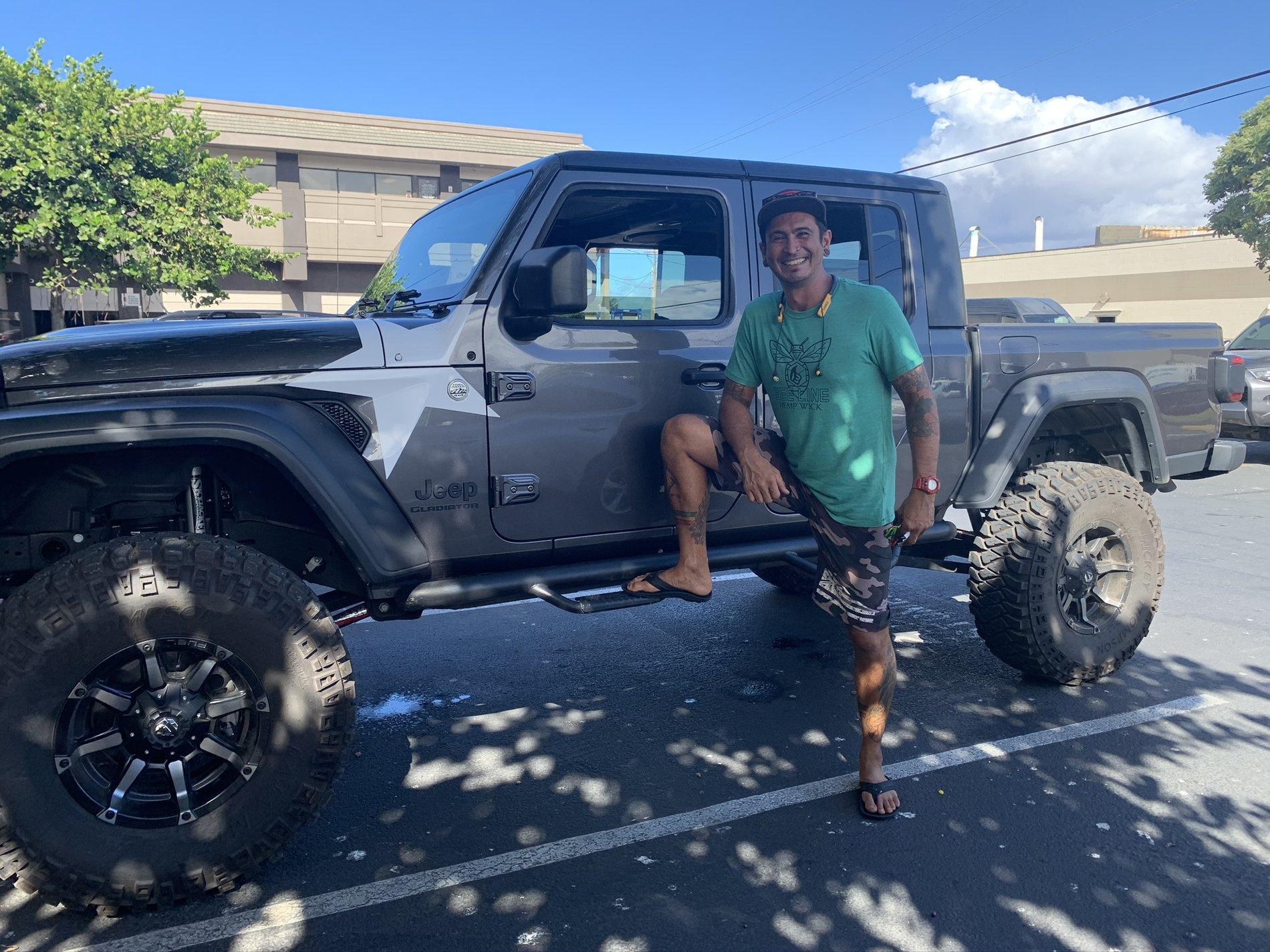

Alohas, I have been noticing a lot of clicking coming from what I think are the coils shifting. I live on really rough mountain road and don’t want to damage anything but is this common with skyjacker? The company who did the 6” lift only told me that they had no problems before it left the shop and it’s up to my driving. C’mon it’s a $50k brand new Jeep. Any input?
Jeep Gladiator Skyjacker 6” lift clicking a lot in the front. 812A0611-B609-4557-8E4F-B3AE4EBB7485

- Is it coming from the suspension or is it from the wheel? Could be a joint on the wheel if you have 40's (kind of looks like you have 40's but idk?)

Yep! With a 6” lift, there is going to be a needed supporting cast and crew of other parts to keep the geometry ship shape
