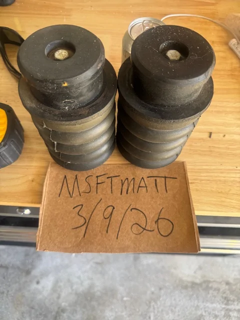

Does it matter if it's lifted? How much additional weight do they support? Actual part number?
Does it affect shock performance? Or the need to adjust shocks? Running 2.5 to Fox Elites
Hey bro, down below is the link to the product website. I do not believe it matters on lift other then making sure your shocks don’t fully compress prior to hitting the bump stops. No shock performance changes. I realized I do not run enough weight for these so when I did hit the bump stops I was t heavy enough to make it soft as intended. I swapped out with a softer sumo spring to better match my weight and am very happy with them.
https://superspringsinternational.com/product/ssr-407-47-sumosprings-rear/
